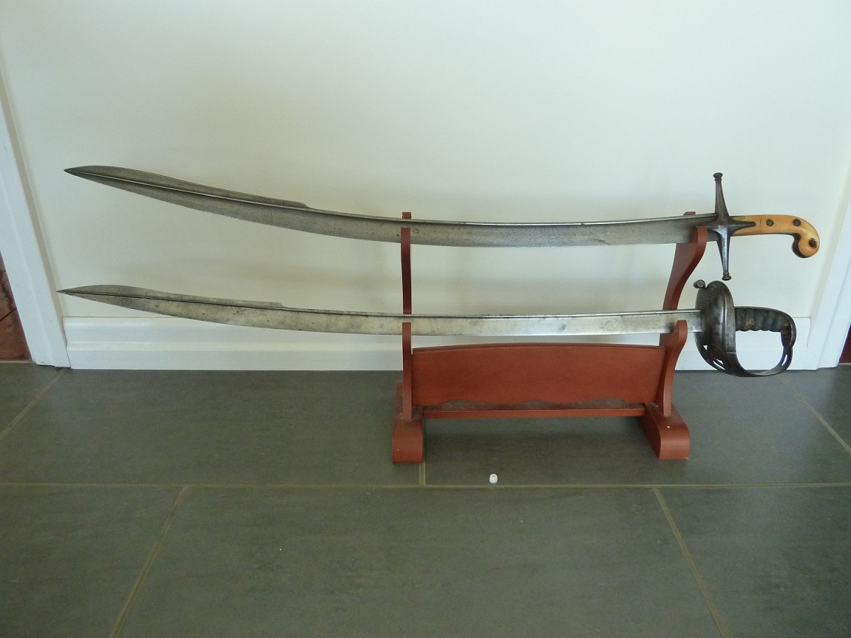

G'day Guys,

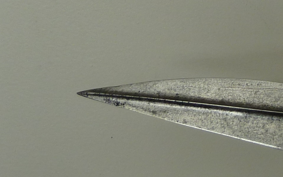

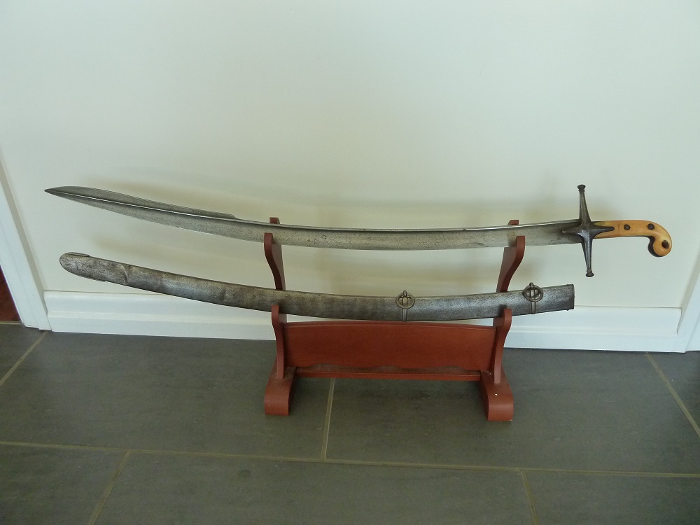

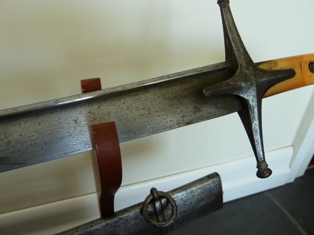

I am a sword collector based in Australia. My main area of interest is British Napoleonic era swords. Last year I acquired a sword which has a feature I haven't come across before and I am hoping that someone here may be able to shed some light on it for me. The sword is a British mameluke-hilted sabre with what is known as a "quill-point" blade. "Quill-points" are pipe-back blades which feature a prominently raised false edge. They were popular among British cavalry officers in the 1810-1820 period. This particular sword appears to fit into this period.
What is unusual about this sword is that the blade is made of steel which is meant to look like wootz. I have seen other swords of this period with mechanical Damascus blades and also blades which have been etched to resemble wootz, but never anything like this. Unfortunately there are no markings on the sword or scabbard to help identify who made it. It is difficult to get good photos of the patterns in the blade, but I am hoping that someone here might be able to tell me what sort of steel this is.

Location: Austria
Posts: 1,918
Very interesting blade indeed! Thank you for opening this very interesting thread!
However, I seriously doubt the European origin of the blade and I am inclined towards Turkey or the Caucasus area.
I will certainly follow this thread with much interest.

Hello Bryce,
your blade looks like a 19th ct. British or German Pipe-back blade.
The blade seems made from Syrian Sham-Wootz.
Roland

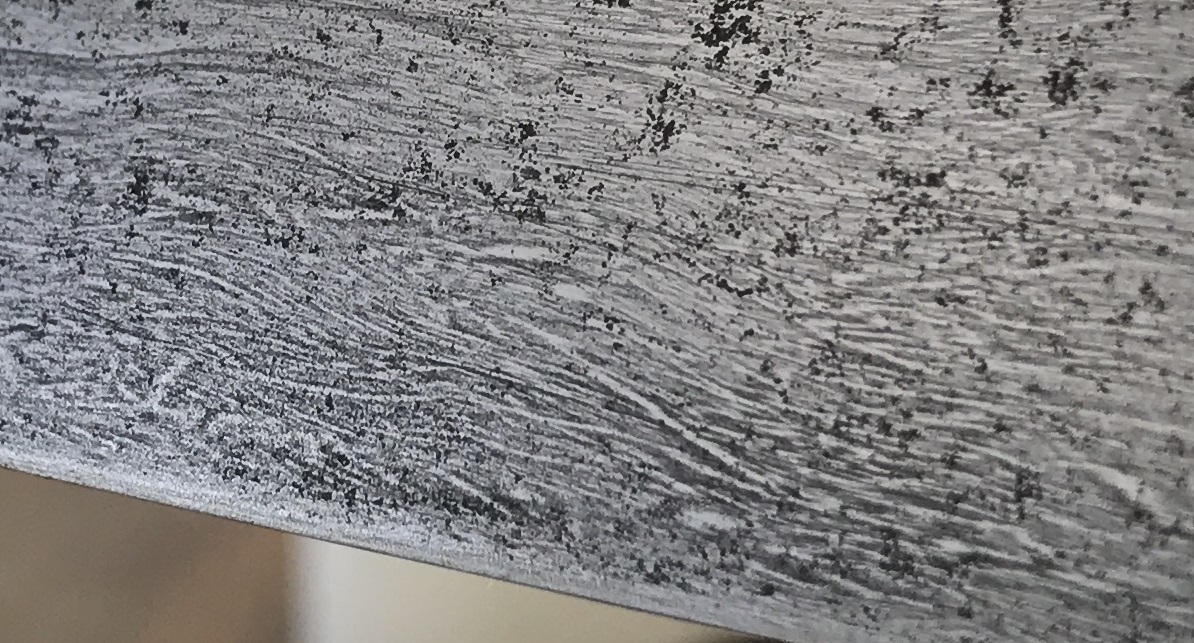

Question

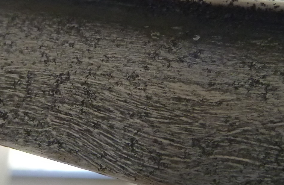

I don't know - this would be the most active/bold sham I've seen...
I was thinking about shear steel which can resemble sham, too. Again very bold though!
It seems that the corrosion is not really following the pattern which seems odd for any type of patterned steel, isn't it?
It depends on the way how the blade was stored, within the scabbard or not, dry or wet conditions, oiled or not. In most cases the front of the sword is most corroded.
The pattern is of importance for the corrosion if we have a rough grain with openings. If we have a fine grain without openings, the corrosion sensivity is much lower.

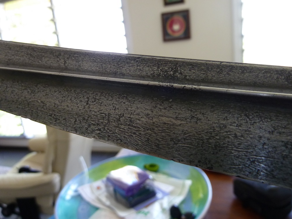

G'day Guys,
Thanks for your feedback. This blade type seems to have been particularly favoured by British officers serving in India. I was thinking that this sword was a special order from an officer who had served in India and had seen wootz blades and wanted something with the same look. I have read that European swordsmiths were trying to recreate wootz blades around this time. Maybe this is an example of their attempts?
Most quill-points are relatively straight. This one is slightly more curved than normal. Below is a photo comparing it to a more regular heavy cavalry example.
Agree with Kai. Sham and shear steel can be very close in appearance. This one appears to be shear steel, of European origin.

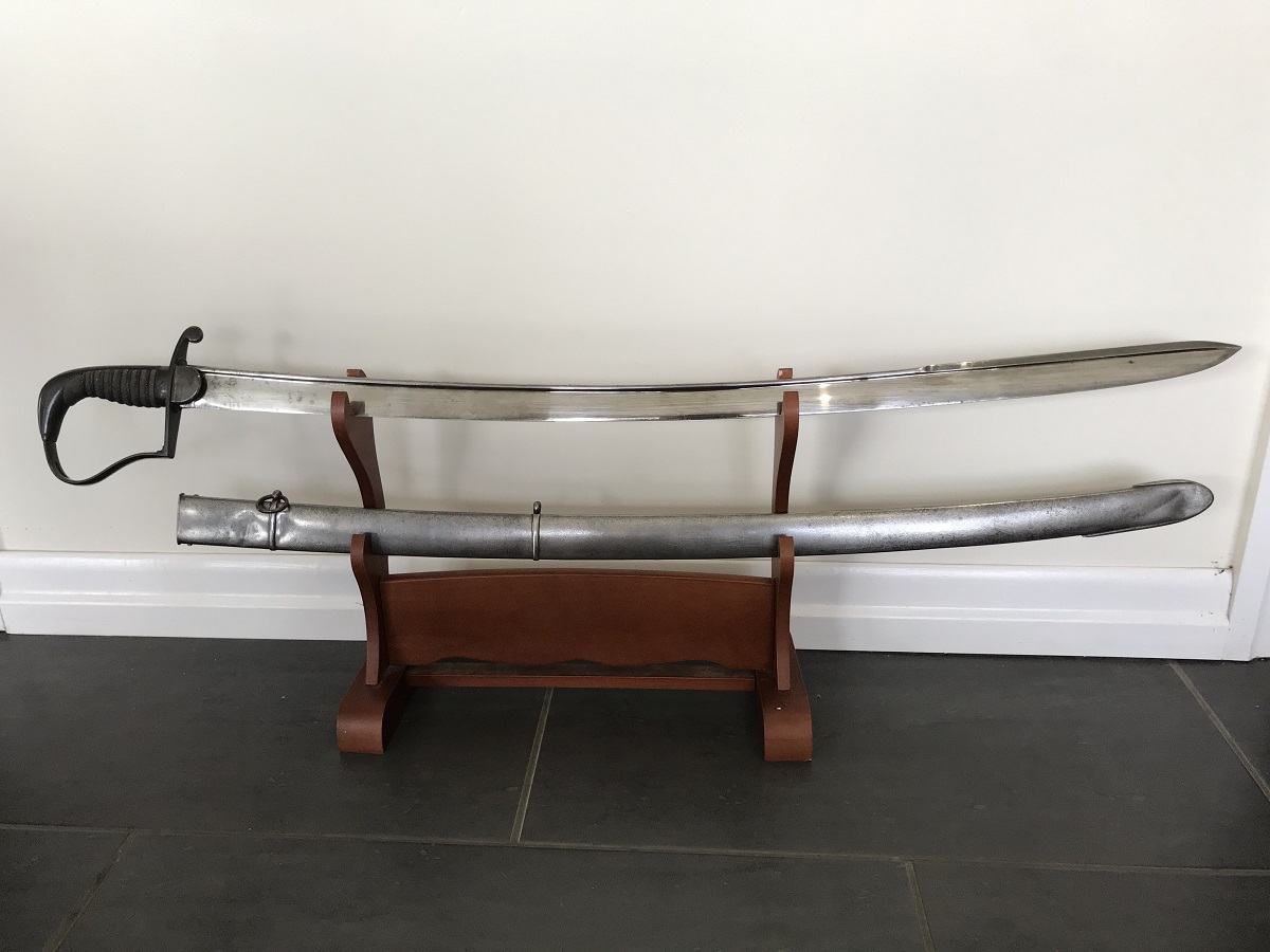

G'day Guys,

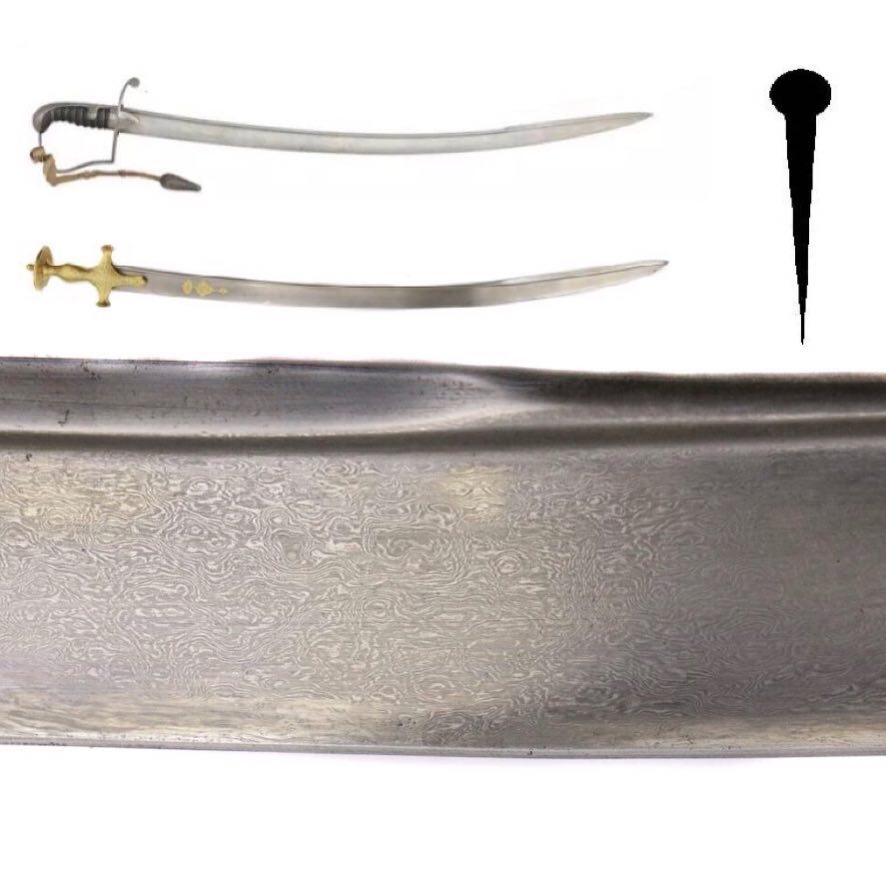

I recently came across a photo of an Indian tulwar with a pipe-back blade in the British style, which appears to be wootz. Perhaps my quill point could be some sort of wootz after all? Below is a photo of a British 1796 light cavalry officer sword made around 1815 to compare it to.

Looks to me like it could be shear steel. Here is a ling to a knife made with it.

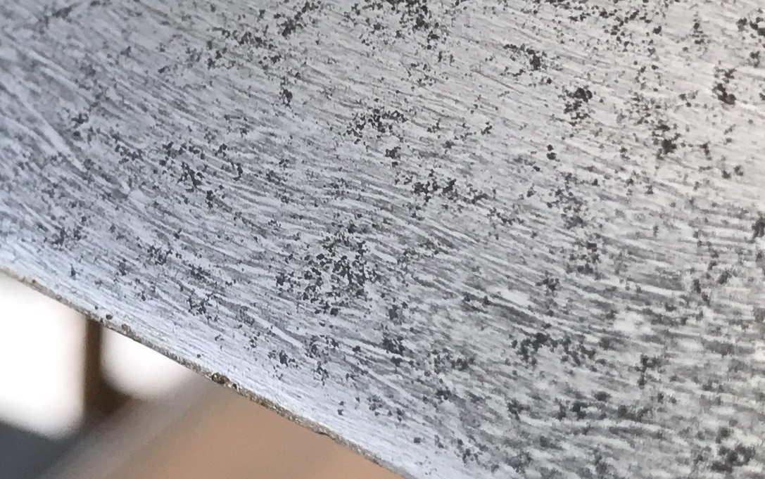

Thanks mate. It could be shear steel. There are quite a few threads on this forum discussing blades with very similar patterns to mine. No body seems to be able to agree whether they are some sort of wootz or some sort of shear steel. Microscopic examination may be the only way to tell for sure.
