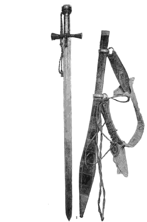

The British museum has a very good example with an at least early blade.
http://www.vikingsword.com/vb/showthread.php?t=16814
The Met has a quite interesting example with a Persian blade.
I can't recall a specifically medieval one. However nobody thought they existed in takouba either and I'm happy to say that changed... There might be a few others out there with at least 16th century trade blades.
