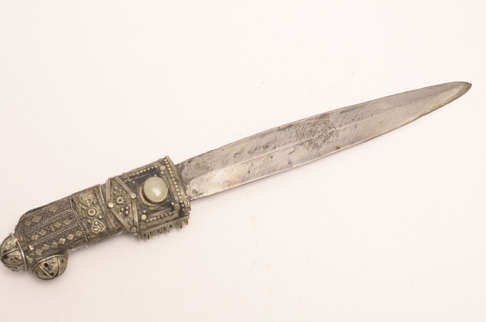

I've had this about a year, and still don't know for sure if it represents a known style/form of knife. I learned that the script is Arabic, in the Moroccan or Algerian dialect, and approximately reads, "be merciful to the ones around you [neighbors]".
Both sides of the hilt are adorned with metal. The back of the sheath is simple leather. On the reverse from the script is a depiction of an elephant. This is the strongest indication to me it is for a tourist that would view an elephant as exotic.

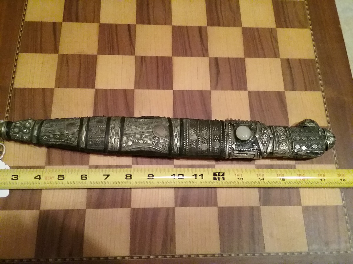

For scale, the squares on the chessboard are 2"x2"
So, any feedback on the form, and is it one that represents a legitimate knife style from a particular region? As always, thank you for your insights

Hi Shayde,
I do not recognise the particular type of knife, but the silverwork looks to be Yemeni or South Western Arabian. Nice piece......I like it very much. Others no doubt will comment in due course.

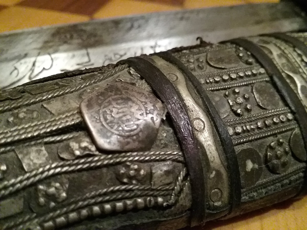

One more thing, I am attaching an image of what appears to be a coin on the sheath. It is 5-sided, but it may have been cut into that shape. Does this coin help with identifying?

I'm very much with Stu on this, and this seems to be likely something innovatively fashioned in Yemeni or Hadhramati regions. I would 'guess' low grade silver fabricating this pastiche, recalling other silver repousse hilts from many remounted sayf.
The demonstrably crude inscribed Arabic type script and the six point stars (star of Solomon, an Islamic symbol as well as other) seem intended to intimate a better quality blade. The elephant probably loosely intended to suggest Indian source for blade, as these were highly regarded in Arabia.
Most interesting piece from dynamic and intriguing regional circumstances of perhaps 60 or more years ago.

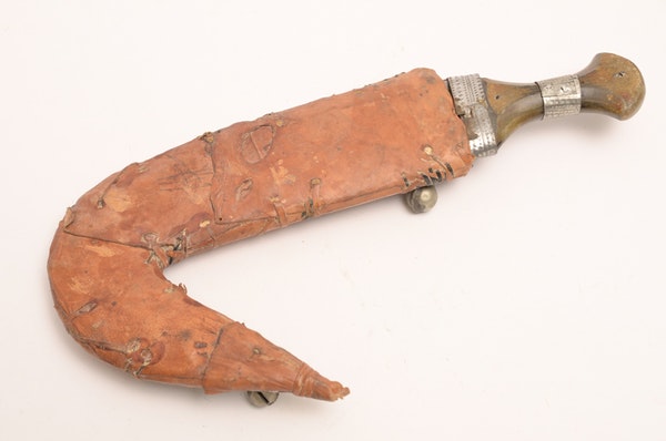

It occurs to me that the leather backing of the scabbard is rather reminiscent of the jambiyyas from Yemen and Oman, which may be another pointer toward origin.
I speak from the very depths of lack of knowledge, of course.

I think the "coin" is dated " .368", if my eyes are still what they used to be ???? years ago:-)
If so, - 1948-1949. I think it fits well with the crispiness of incisions on the blade.
But Jim is correct: the "coin" could have been attached to older knife or might be older than the knife itself.

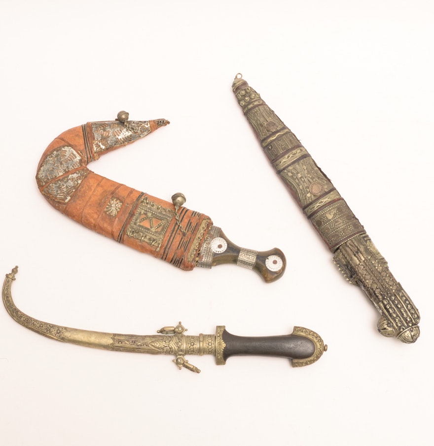

Agreed. I am attaching a picture of the original lot, of which this item was a part. It may help suggest an origin if the other pieces are easier to identify. There are three pieces; a Moroccan Koummya, a Jambiya, and this knife. The leather on the back of the piece in question does resemble the jambiya, but I was told the inscription is in a Moroccan/Algerian dialect...so somewhere in between?? Or not related at all, and the estate seller just lumped the 'pointy things' all in one lot.
Old 17th August 2017, 11:34 PM   #13
Bob A
Join Date: Feb 2014
Posts: 472
I'm inclined to believe your pointy-thing conglomeration.
The ring attachment method on the koumaya would seem to indicate a mid-20th century date, from what I've seen, but again, I'm no expert.

There are two Yemeni coins. A 1/8 Riyal and 1/10 Riyal. I would bet this is newer than the coins. Could have been made in Ethiopia or Eritrea but I'm more inclined to think this is more recently put together in Yemen since the 1970's.

Here's a coin I found similar~ 1372 AH, Yemen Arab Republic, 1/8 Rial, Islamic Arabic Silver Coin. Denomination : 1/8 Rial. Dated : 1372 AH (1952 AD). Calendar : Islamic. Shape : Hexagonal With 5 Sided. Composition : Silver.
like this below
like this below
That would be Pentagonal :P

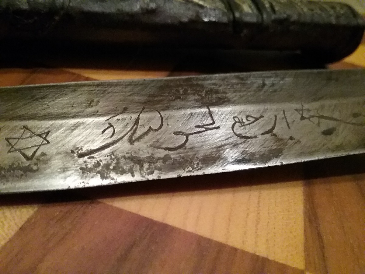

I've just remembered...I never received feedback regarding the inscription:
Does it indeed read "Be merciful to those around you"?
And, is it in the Algerian/Moroccan dialect?
Any help with translating this inscription? I never got feedback from anyone on this site about this, and am uncertain if the initial translation suggested to me holds true.

I am far from sure, but I think this is, slightly misspelled,
ارجع لحولك
irja' li-hawlaka
This is the name of a popular song in the Yemen. These pieces seem to be mostly inscribed with the texts of poetry and songs. Please ask Ibrahim if he agreees and how he would translate it
