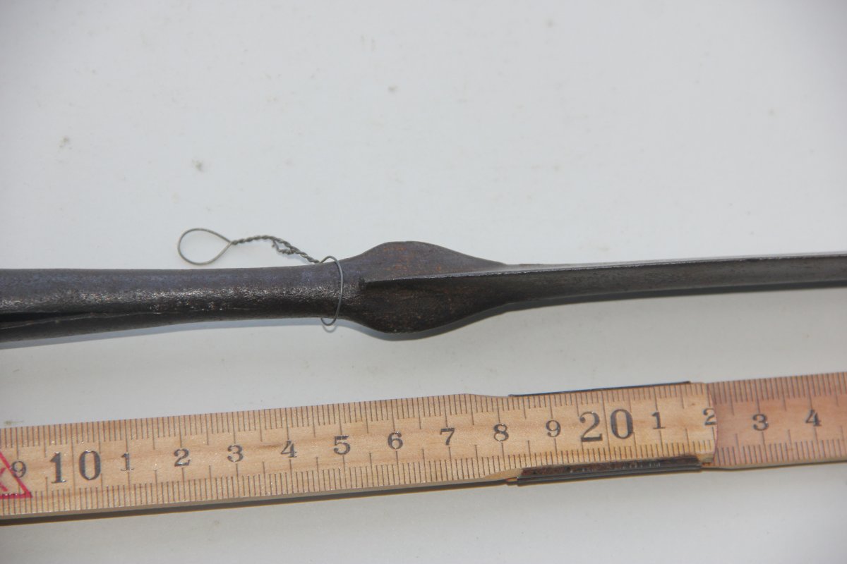

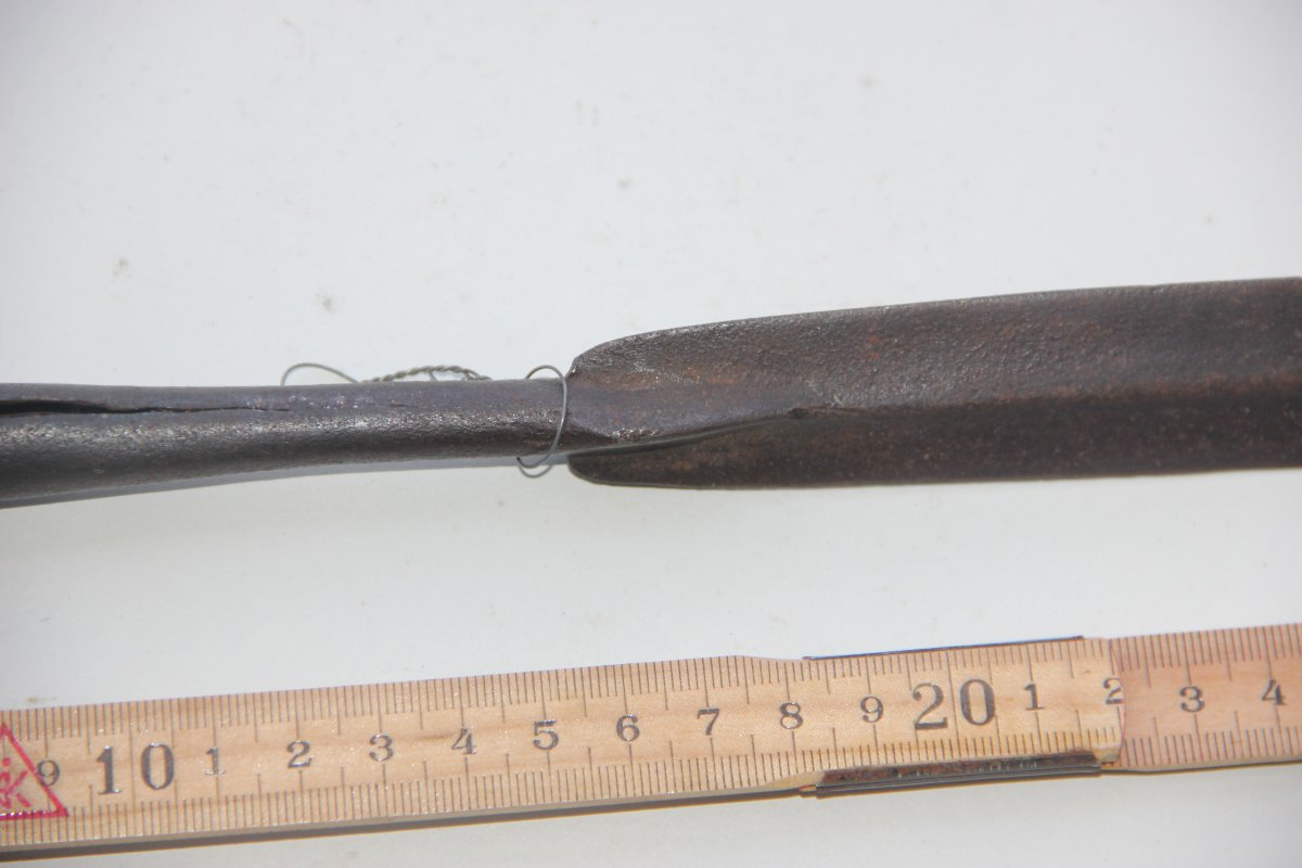

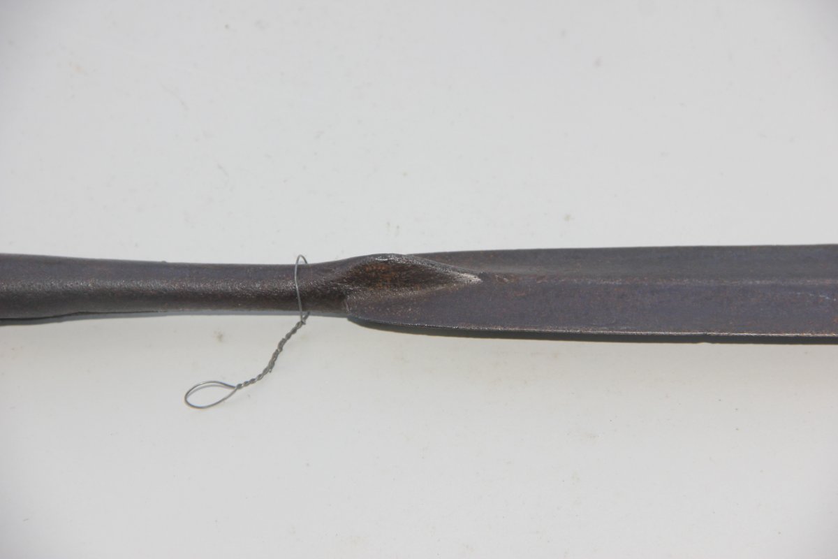

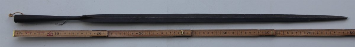

Dear group / fellow collectors,
I recently at a local auction found this very long spear point, which I guess is of African origin. I am not familiar with African arms and therefore would be very happy for any information about the possible origin and age.
Full length: 79 cm
Socket length: 16 cm
Blade length: 63 cm
There is an interesting detail/reinforcement/structure at the beginning of the blade.
Please see the attached photos
Best regards
Kasper

Hi,
Here were several discussions about this kind of spear. I cannot find all the links - just one.
http://www.vikingsword.com/vb/showthread.php?t=12999
It is, most probably, comming from the North Nigeria.

Originally Posted by Martin Lubojacky
Hi,
It is, most probably, coming from the North Nigeria.
I agree Martin, this appears to me to be another example of a well made cavalry lance, design for use on horseback within the Islamic emirates of Northern Nigeria or the Bornu Empire.
Both the size and construction are consistent with other examples, a very nice piece! Similar lances can occasionally still be seen in parades and palace events within tradition emirates in northern Nigeria or Cameroon.
