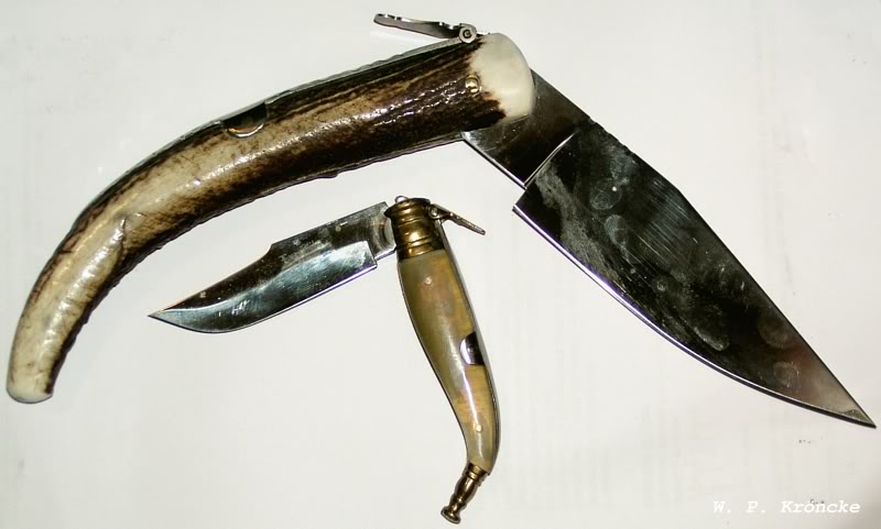

couple for illustration, the stag one is quite large (and noisy).
...and some ring pulls, they are mostly in the same family
there is a saying that the sound of the navaja was the last thing many people heard.

kronckew: Nice collection!

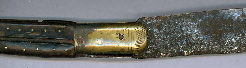

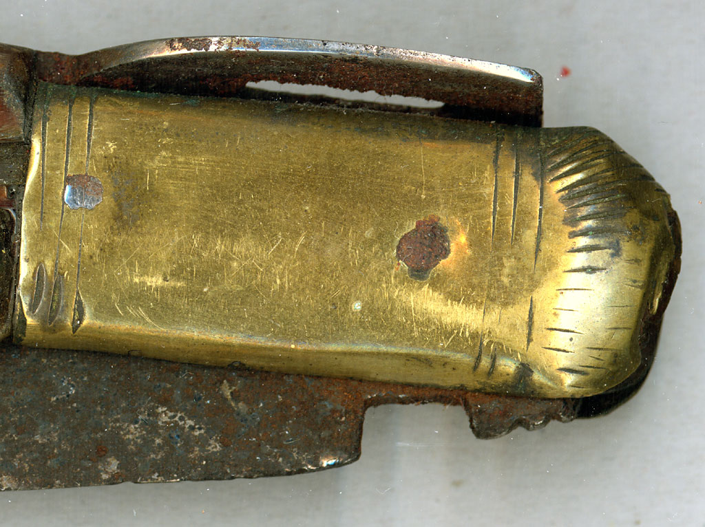

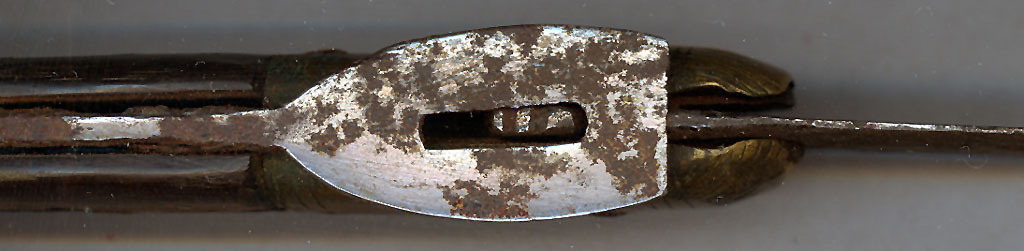

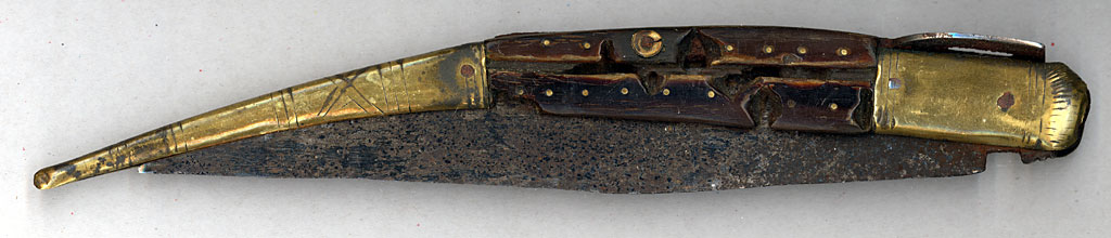

Wink A very well worn and nibbled upon navaja from Brimfield
Here is a very well worn and nibbled upon navaja that I bought last year at the Brimfield flea market for $25. I have been using it to open envelopes. It is about 9½ inches long closed and the blade is about 7¼ inches long. It is loose enough now that you can close it without lifting the latch, but each ratchet point does engage and give some resistance. Put your thumb over the latch and fingers naturally around the horn scales and the blade is securely open. I prefer this design to the pull ring clasp style that was reputedly derived from it. I'd welcome any comments as to how long this old knife may have been around.

Lee:
Your navaja’s style is consistent of those made in the 19th century in the city of Albacete. It has what we call a pick-lock, meaning that the backspring has to be manually lifted upwards to disengage from the lock notch in the blade. These were superseded by the ring lock around 1875, so yours is earlier.
An excelent example Lee; a genuine one for an amazing price. I guess the pull ring clasp version ended up giving place to the 'the last of mohicans' of these mechanisms; one certainly made for purposes more directed to tourists other than villagers. Another system was that like the one of your example but with a lever to easier operate the opening. This was the system that i got used to see around since my youth; the main weakness was that the lever was rather feeble and worn out very quickly.
