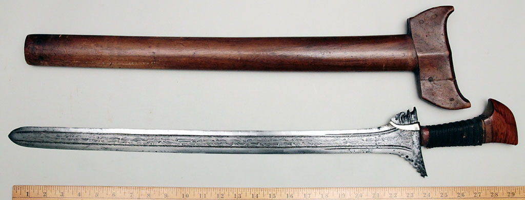

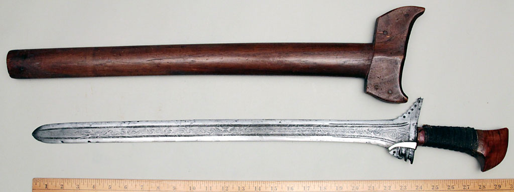

Default Pattern Welded Straight Kris

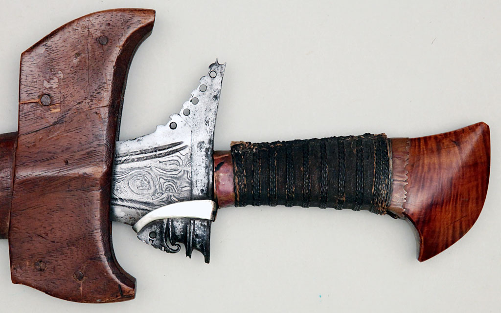

I had mentioned elsewhere on the forums that Moro and Sulu arms will often show pattern-welding reminiscent of that seen in European early medieval arms and that I would present this kris. The blade is just under two feet (60.7 cm) in length and is relatively straight (it is difficult to be sure whether re-honings might explain the slight concavity of the forward edge, though there is probably a very slight opposite convex curve on the opposite edge so it may be intentional. Most of the blade shows two bands of twist-core pattern welding in the central panel on each side between narrow fullers. Having it in hand, it appears that the same two rods are seen on both sides such that about 15 to 30% of the overall original rod thickness remains (thus around 35-40% ground away and lost to oxidation from each face). Where the blade is widest at its base, there are three rods, one of which appears to end in a swirl seen on both sides.
I acquired this example for the pattern-welding and I have suspected that it is one of the earlier examples in my collection. I am most curious for the opinions of members as to the origin and age of this kris.

Hi Lee:

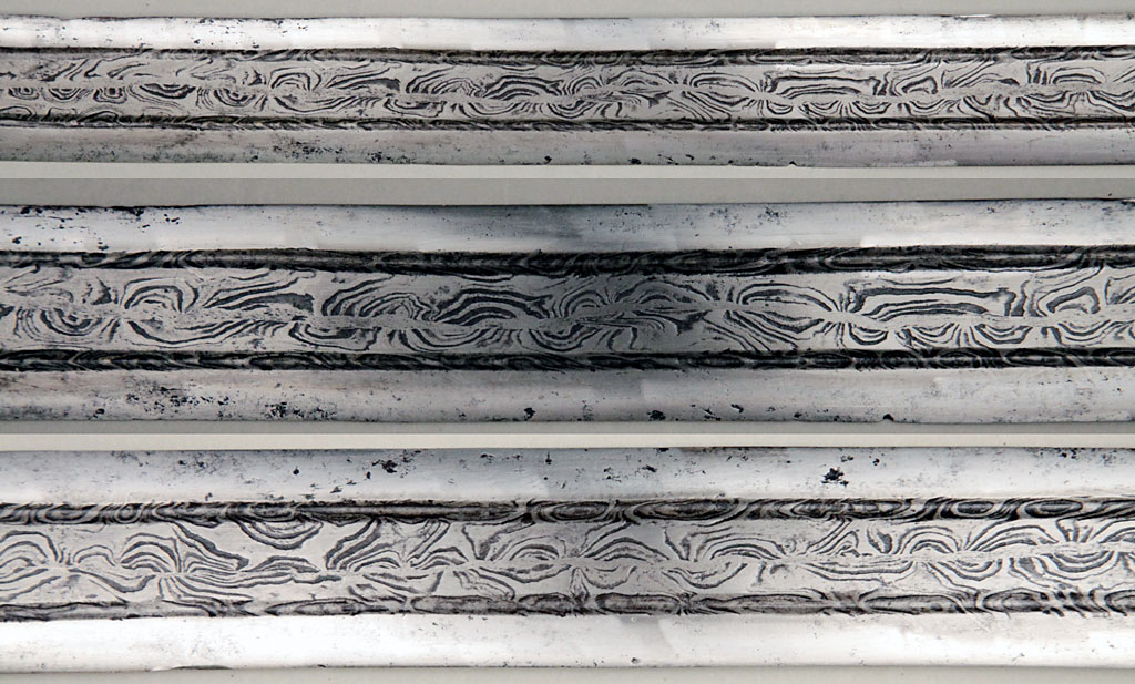

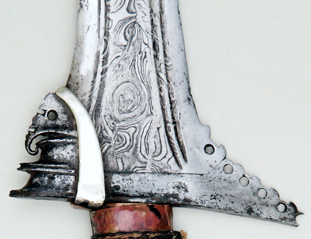

What a lovely kris and I really like the complex twist core pattern on the blade.
If we believe Cato, then this appears to be a Maranao kris (based on the elephant trunk area). The shape of the scabbard would support that attribution also. The blade is a little slimmer than many Maranao examples which makes me think it is likely to be an older one, say early to mid-19th C. The hilt seems more recent, as does the scabbard which has been nailed rather than glued or wrapped.
Very nice kris.
Ian.

Superb pattern weld! I believe it is the most beautiful I have seen in a Moro Kris.

Lee, that slight curve in the blade is put there on purpose.
A very nice kris!

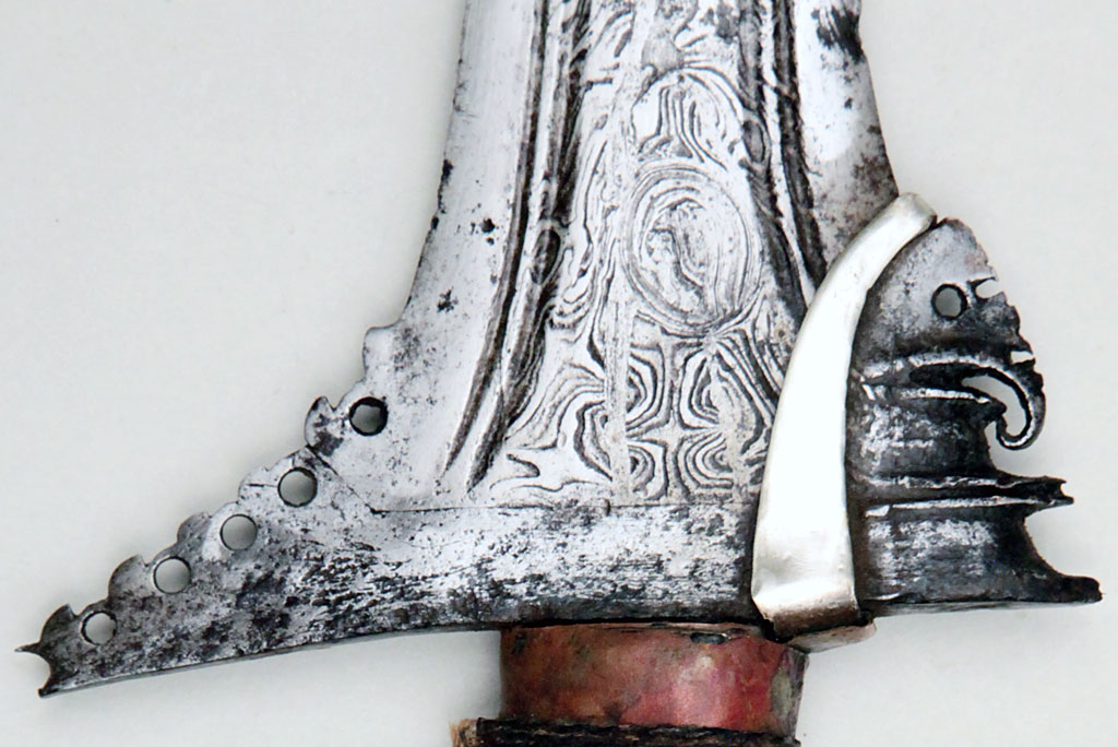

I also think the swirl at the base on each side of the blade has meaning.

Yes, I see the elephant - now that you mention it - and it is not even demanding too much imagination!
I think that you are correct about there being a slight deliberate curve. The photographs exaggerate this a bit as there is very slight 'fisheye'.
Those are wooden dowels holding the two halves of the scabbard together.

The question that arises for me when looking at this kris (I'm pretty sure it has been rehilted) is are we seeing a pamor feature that is talismanic in nature, much like Javanese patterns?
I'm probably late to the party here, but it is new to my experience.

Hello Lee,
Congrats, that's certainly an exceptional piece!
I'm with Rick & Co. on both counts:
The slight forward curve of the blade is intentional and not rarely seen with "straight" kris.

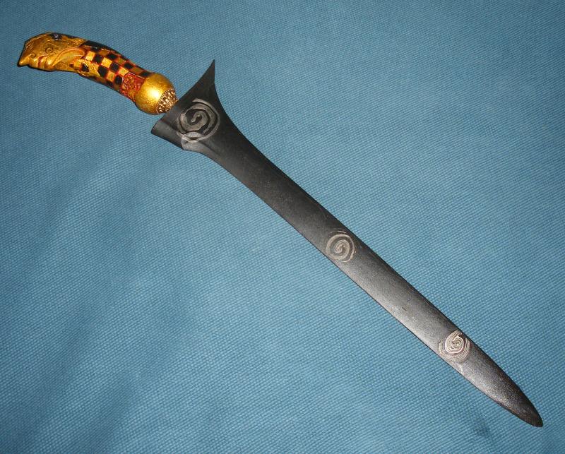

And the swirl at the base of the blade is an additional pamor motif (kul buntet in Jawanese) - something I haven't seen before with any Moro kris! Could you please add a larger close-up of both sides of the base of blade?
A top view on the gangya would be great, too!

Kai, I have noted your interest in a top view of the gangya and added it to the photo queue. Meanwhile, here are the requested close-ups of the base of this blade:

If this represents batu lapak then according to Tammens book DE KRIS it is a royal pamor.
Tammens notes that kul buntet is essentially the same, but it's character may be stronger.

The hilt looks typical Maranao work, especially with the crenalated metal ring just below the pommel, while the "elephant trunk area" does not look like Malay examples I have seen previously.

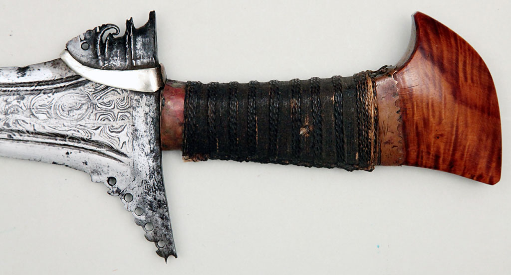

Posts: 7,418
Ian I was thinking that this could be Maranao or perhaps (more likely IMHO) Maguindanao based on the front of the ganga and on the pommel.
Also can the hilt looks like it could be later (though not as certain as the tribal affiliation).

A little bit late but this is a very nice kris blade! And like Jose I think that it is a Maguindanao kris but frankly said I have my problems to distinguish between Maguindanao and Maranao byself! I only know that it is a Maguindanao kris from this thread: http://www.vikingsword.com/vb/showth...highlight=kris since this kris from my collection has a very similar pommel and in the provided thread is also a discussion about this pommel form.

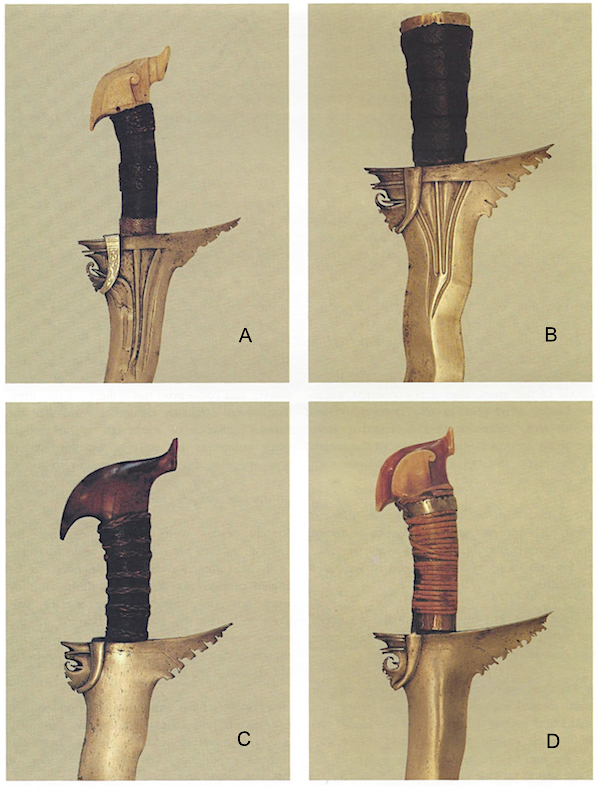

As I noted in my initial response, Cato describes the shape of the "mouth" of the elephant on Lee's kris as being Maranao in origin (see B in attached pic from Cato). I agree that the pommel is similar to those seen on a number of Maguindanao kris, but the same style is also found mounted on blades that have Maranao characteristics. So we have a possible mix of tribal influences in the case of Lee's sword.
I think the hilt is not as old as the blade. Perhaps we have a Maguindanao remount of a Maranao kris, but I can't rule out an entirely Maranao sword. This raises the question, what determines the tribal designator for a Moro kris--is it the blade or the dress (hilt, scabbard, etc.)? And a corollary, if a Moro blade is refitted by another culture, say the T'boli, is it still a Moro kris?
Ian.
A. Sulu
B. Maranao
C. Maguindanao
D. "Crossover"

excellent question, Ian. Based on Cato's classification, I'm with you on the blade style that of Maranao origin.
with that said, i would like to add this: a lot of pandays travel from town to town. this has always been the custom from time immemorial. so if a Maranao panday travels to Sulu and decided to stay there for awhile, would his blade be considered Maranao even tho it was commissioned by a Tausug?

Those are wooden pegs holding the two halves of the scabbard together. There were also wooden pegs securing the end of the scabbard, but one is absent and the other broken (and the rubber band that has usurped their purpose was removed for the photographs).
The scabbard is made of relatively soft wood and it is bulkier than many of the kris scabbards I have encountered. The photographs are not optimal for showing a glued repair of the mouthpiece on one side and several cracks on the opposite side in the same area. Would this scabbard have stood up to a generation of regular use - I seriously doubt it. I even wonder if this was made as a 'resting' scabbard.
