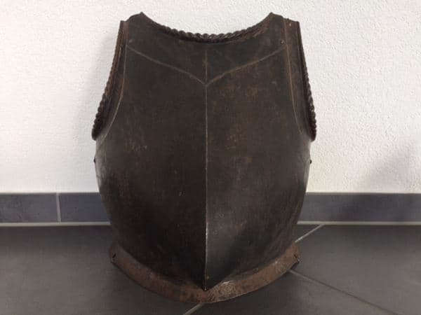

Default Breastplate for comments

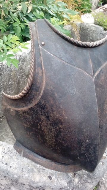

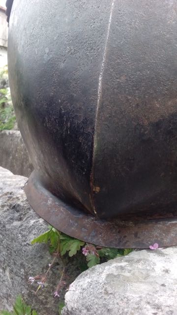

What about this ?
Old 28th May 2017, 01:22 PM   #2
A Senefelder
Join Date: Jul 2009
Posts: 214

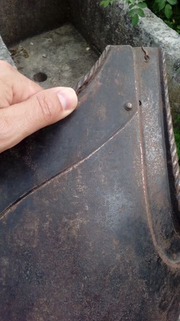

More pics of both inside and outside would be of great assistance with this piece as well. The gussettes at the arm openings ( the articulating plates that allow the breast plate to be wider than if it was made of a single piece due to their ability to compress ) is a good sign, these were almost never done on Victorian copies.

Old 29th May 2017, 05:48 PM   #3
francantolin
Join Date: Sep 2014
Posts: 973
Thank you !

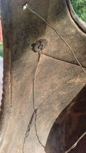

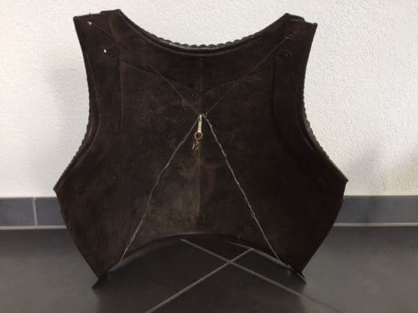

Here some more detailled pictures, just received the breastplate !
Old 29th May 2017, 05:49 PM   #4
francantolin
Join Date: Sep 2014
Posts: 973

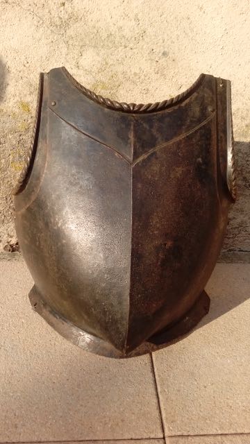

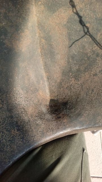

And this one
Old 29th May 2017, 05:57 PM   #5
francantolin
Join Date: Sep 2014
Posts: 973
Not heavy and quite small : 6 pounds weight , 14 inches high.
German ''picquier'' model ?
Old 30th May 2017, 09:48 PM   #6
francantolin
Join Date: Sep 2014
Posts: 973

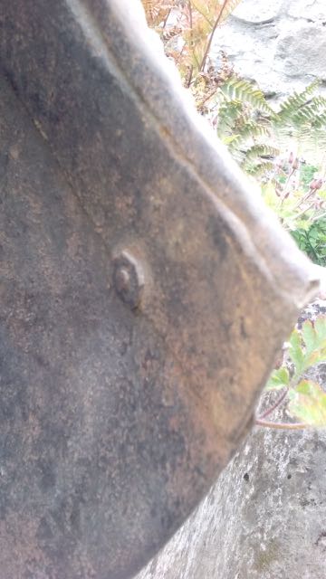

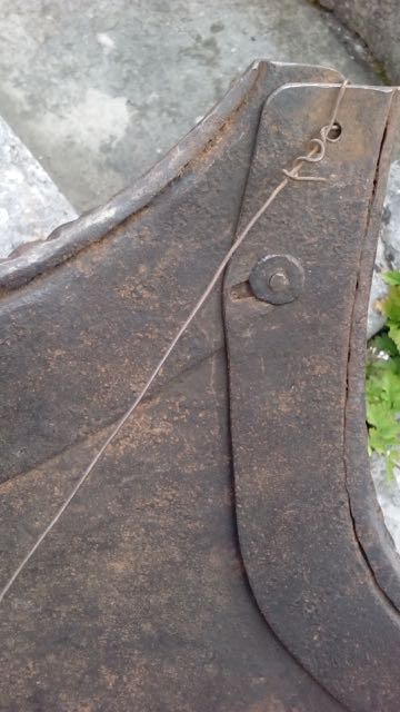

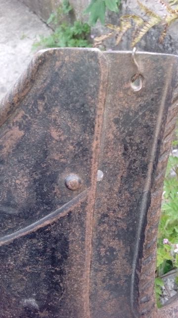

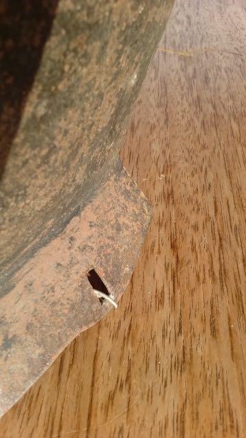

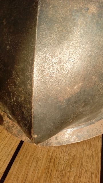

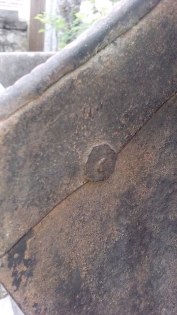

Other pictures,
some comments ?
Seems not too bad ?!
Old 1st June 2017, 01:46 PM   #7
ulfberth
Join Date: Jul 2014
Posts: 447
Hello Franco,
The breastplate could be German indeed, I can't say much more for sure other than it is very beautiful !
kind regards
Ulfberth

Old 3rd June 2017, 02:07 PM   #9
A Senefelder
Join Date: Jul 2009
Posts: 214
Based on what i'm seeing constructionally i'm inclined to believe this piece to be original. While the gussets are a good sign, the edge beveling around the arm openings is as well as the slot rivet channels on either side of the flange of the breast plate to carry the first lame of the fauld that once existed there. All of these are constructional details are almost never done on Victorian copies. The somewhat uneven plate edges where the neck and gusset plates have been rolled over is also a good sign. The peascoding is a bit more pronounced than the more munitions Graz examples but this does not rule out a possible German origin, although without some sort of identifying makers or city control stamp it is tough to assign a country or origin as the style was in use throughout western Europe in the second half of the 16th century. My feeling is that this is a good original example, based only on photos of course, having the piece in hand may cast a different light on it.
A Senefelder is offline   Reply With Quote
