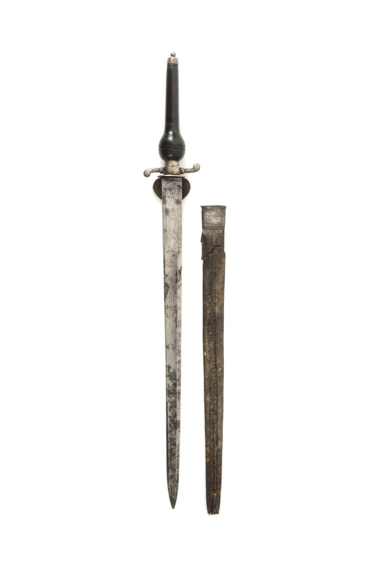

Recently I have been focused on collecting weapons that fall into the ethnographic category but today I participated in an auction of European weapons from the Berger collection), so I would greatly appreciate comments, especially related to age and origin of the four pieces I won. To make sure that the photos stay in register with the texts provided by the auction site (and the Google translations) I will post each one in this thread separately.

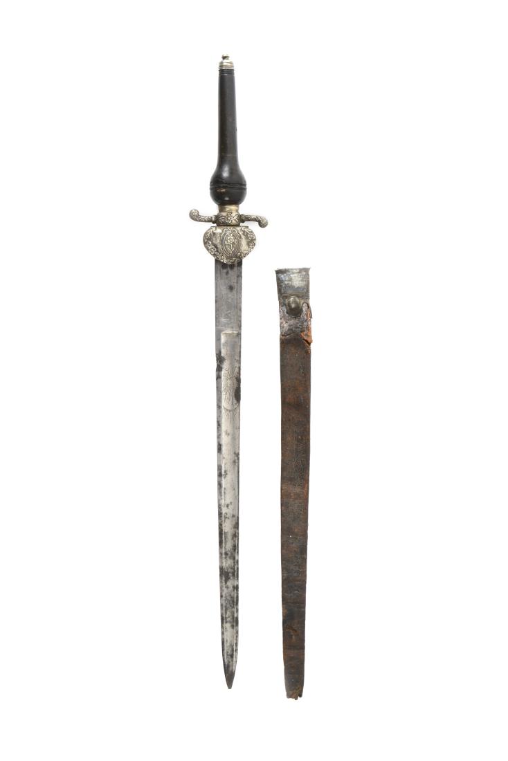

Item 1
(a plug bayonet, I assume)
Lama incisa con scene di caccia e trofei (ossidazioni), eleganti fornimenti in argento, impugnatura in osso. Ottime condizioni, manca il puntale del fodero._x0000_ L. 56 cm.
Blade engraved with hunting scenes and trophies (oxidation), elegant silver plating, bone handle. Great condition, missing the tip of the sheath._x0000_ L. 56 cm.

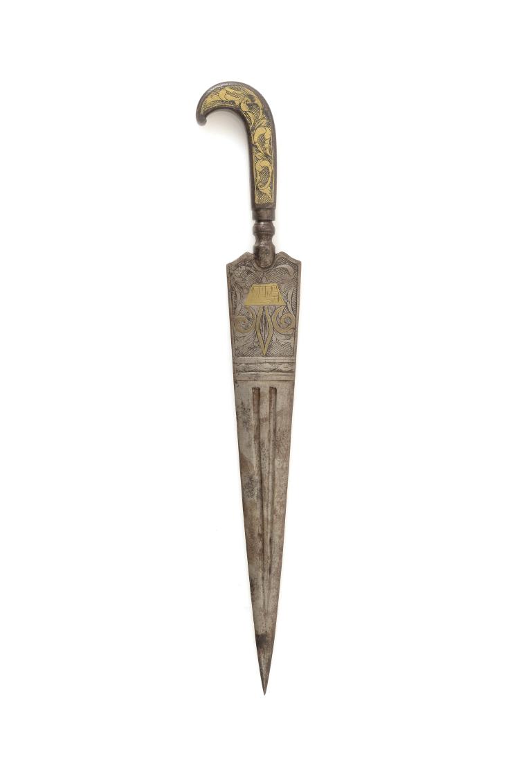

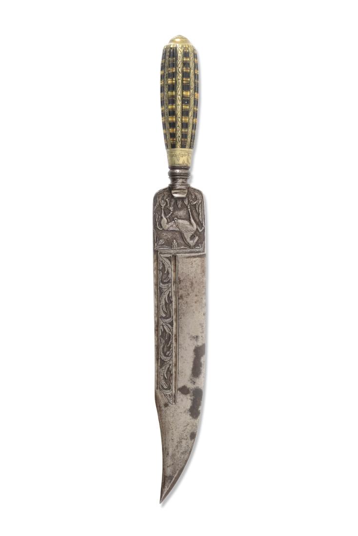

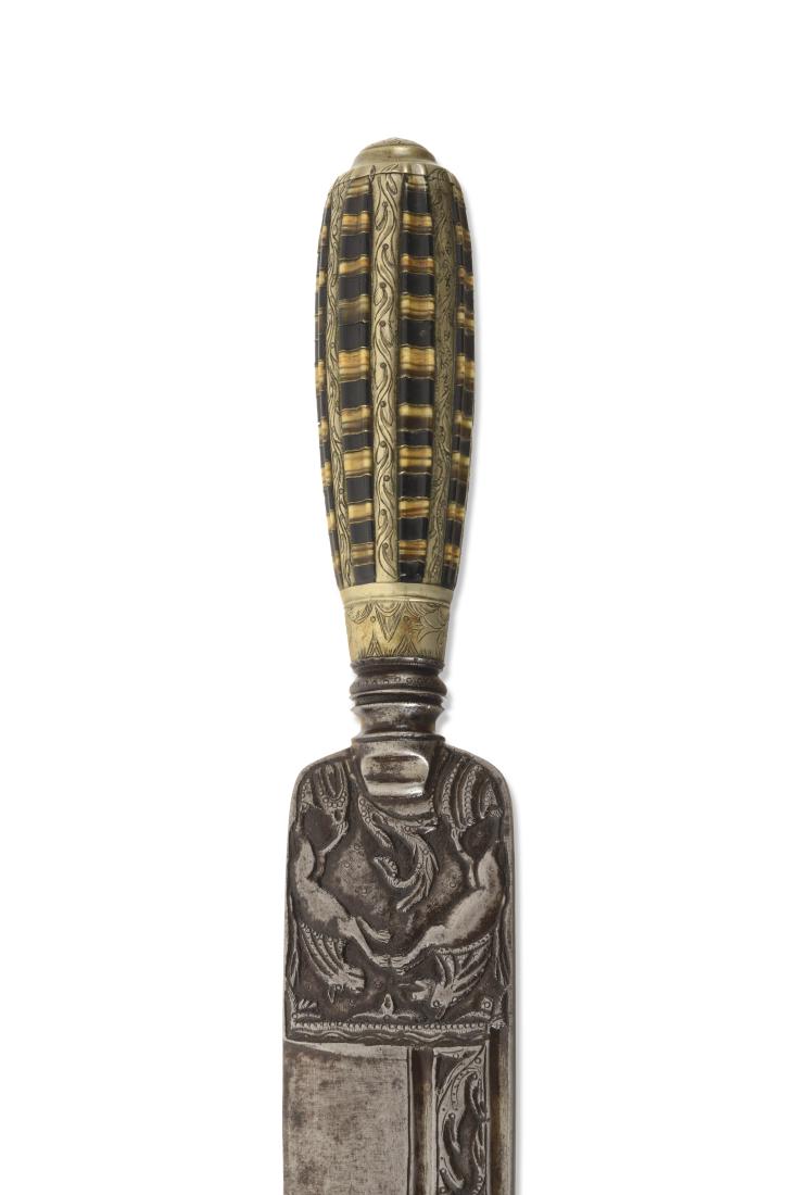

Default Item 2
Lama ad un filo e mezzo sgusciata al centro e cesellata con fogliami e figure di cavallo e leoni al tallone, impugnatura formata da dischi in osso di diverso colore, ghiere in metallo bianco incise. Eccellenti condizioni, lievi ossidazioni._x0000_ L. 40,5 cm.
A half-and-a-half threaded blade in the center and chiselled with foliage and horse figures and lion on the heel, handle made of bone disks of different color, engraved engraved metal rings. Excellent condition, slight oxidation._x0000_ L. 40.5 cm.

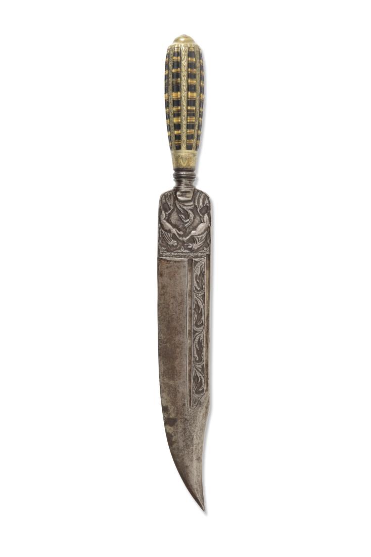

Default Item 3
Lama a doppio filo scanalata e incisa al tallone con rimessi in ottone, impugnatura anch'essa decorata a placche e girali. Ottime condizioni, lievi difetti._x0000_ L. 34,5 cm.
Double fluted blade, engraved on the heel with brass rims, grip decorated with plaques and balls. Good conditions, slight defects._x0000_ L. 34.5 cm.

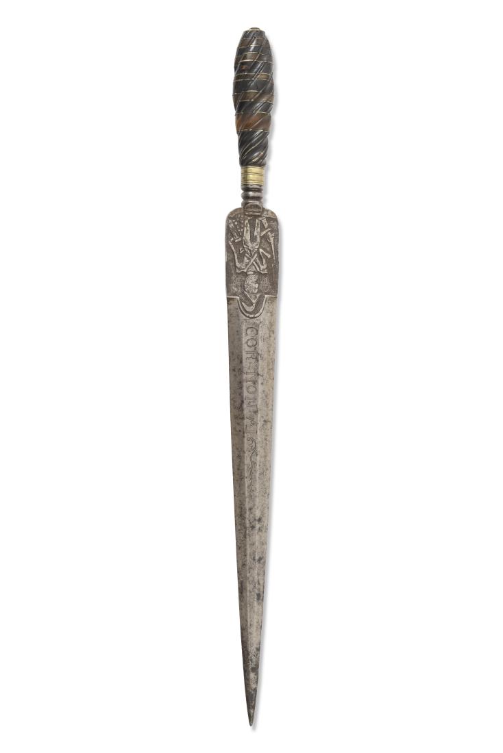

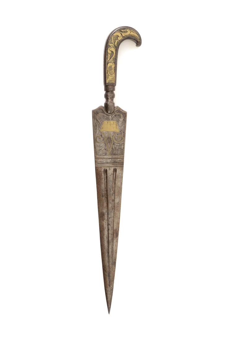

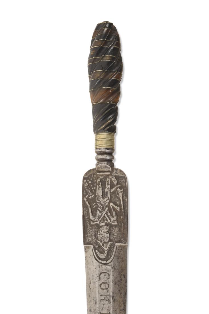

Default item 4

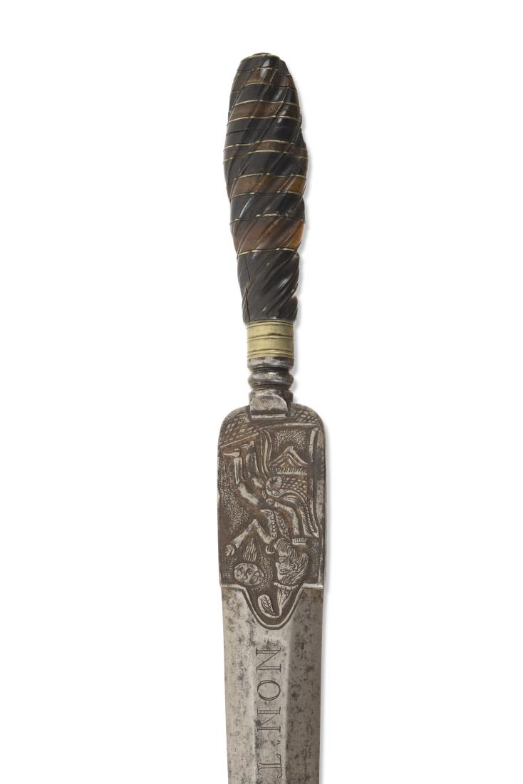

Lama a doppio filo decorata con la scritta "NON TI FIDAR DI ME SE COR NON AI", tallone inciso e cesellato con figure di militari e in cartiglio le sigle "GGV", impugnatura tortile in corno con ghiere in metallo bianco. Eccellenti condizioni, lievi difetti._x0000_ L. 50 cm.
Double threaded blade decorated with the inscription "DO NOT FIDAR ME IF COR NOT AI", engraved and chiselled heel with military figures and cartouche the "GGV" markings, horn torsion grip with white metal ring. Excellent conditions, slight defects._x0000_ L. 50 cm.
Marcus is offline   Reply With Quote
Old 2nd May 2017, 07:32 PM   #5
Hi Marcus,
My atempt ...
First one a nice plug bayonet, in principle Germanic, due to its typical shell guard. Would be nice to see close up pictures, specially of the guard. Could it be XVIII century ??.
Second one a typical hunting knife from South Italy. I have a similar one. Beg. XIX century.
Fourth one a bandit (?) knife, with a motto probably with a couple misspelings… or in some Italian dialect. It could mean something like “don’t trust me if you have no heart” … but don’t trust my translation either. Also nice to see close ups of the guy in the blade ricasso.

In my opinion item 2 to item 4 came from Liguria/northern Italy. This typ of daggers came up in the 17. and 18. century in Genua and was to be found on the isles (Sardinia/Korsika) and partly in south eastern Spain.

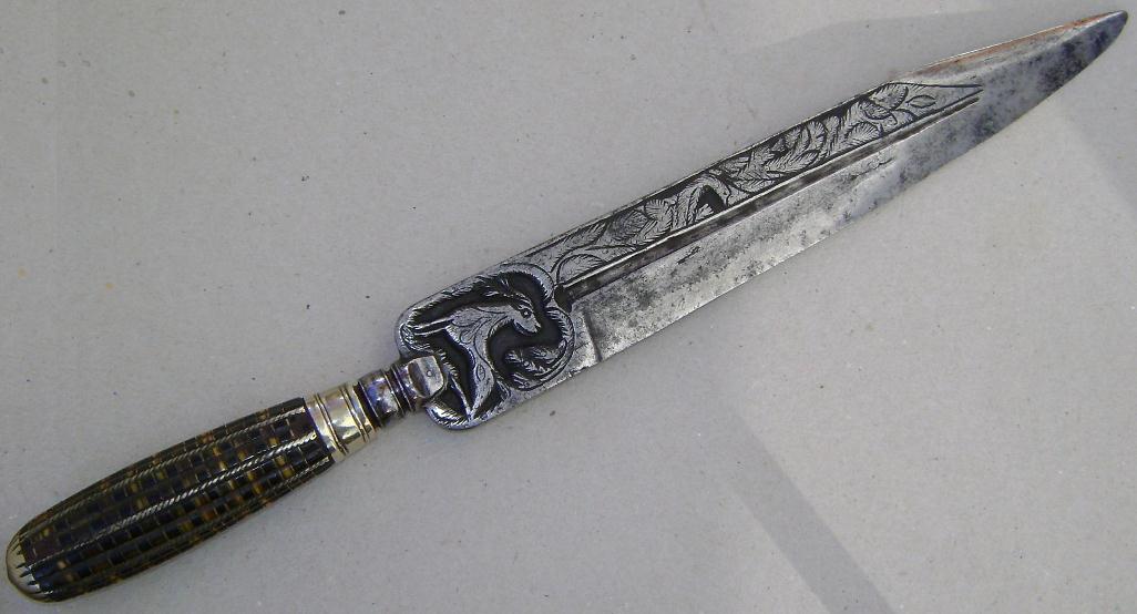

Old 3rd May 2017, 08:30 PM   #9

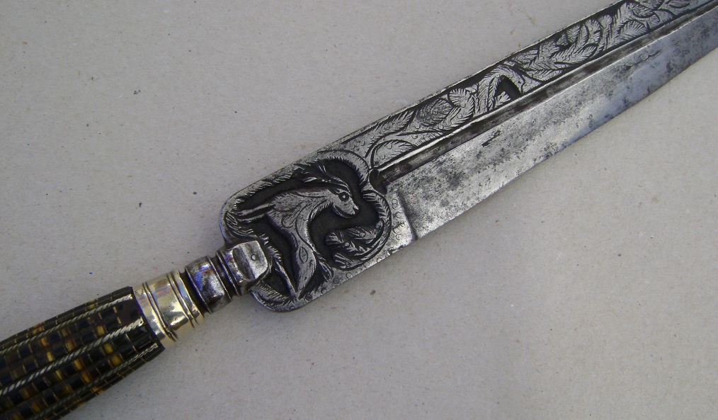

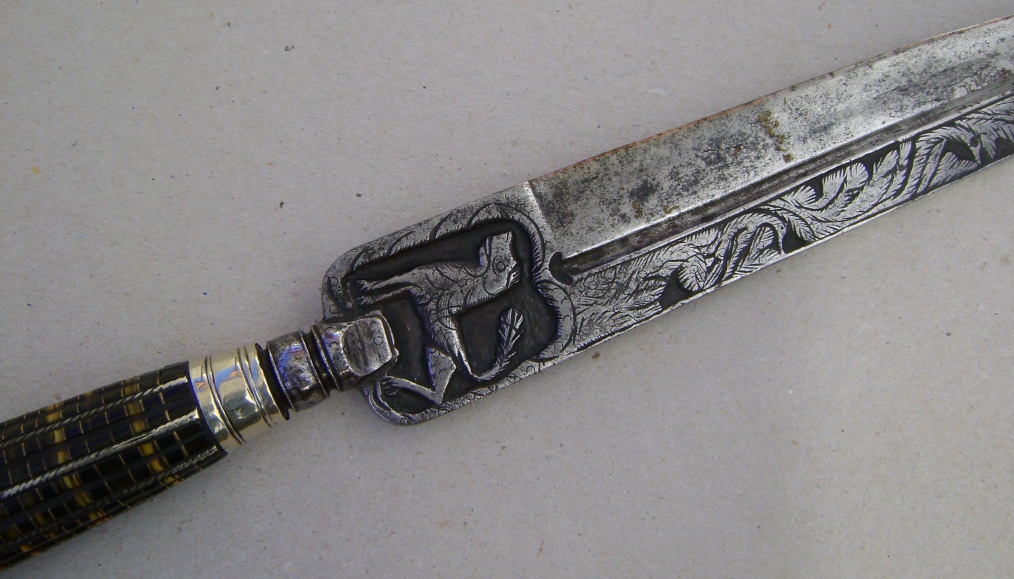

As i said, when i acquired mine, it was assumed to be from Meridional Italy.
I am aware of these knives being also credited to Liguria but, according to known Italian websites (and not only), they are attributed to Southern Italy. I ignore whether there are similar works from both regions with only slight variations or this is a dispute between opinion sources. Let them both be happy .
Here are pictures of mine, if Marcus doesn't mind .

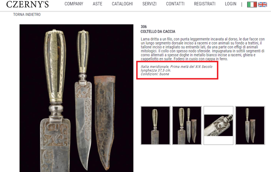

Old 4th May 2017, 12:20 PM   #11

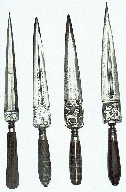

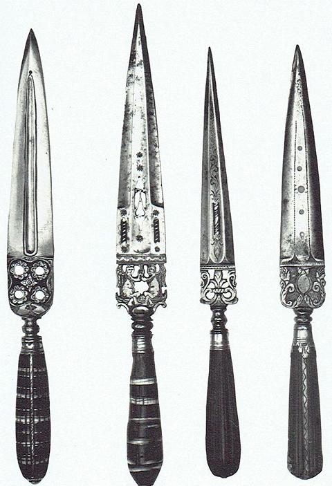

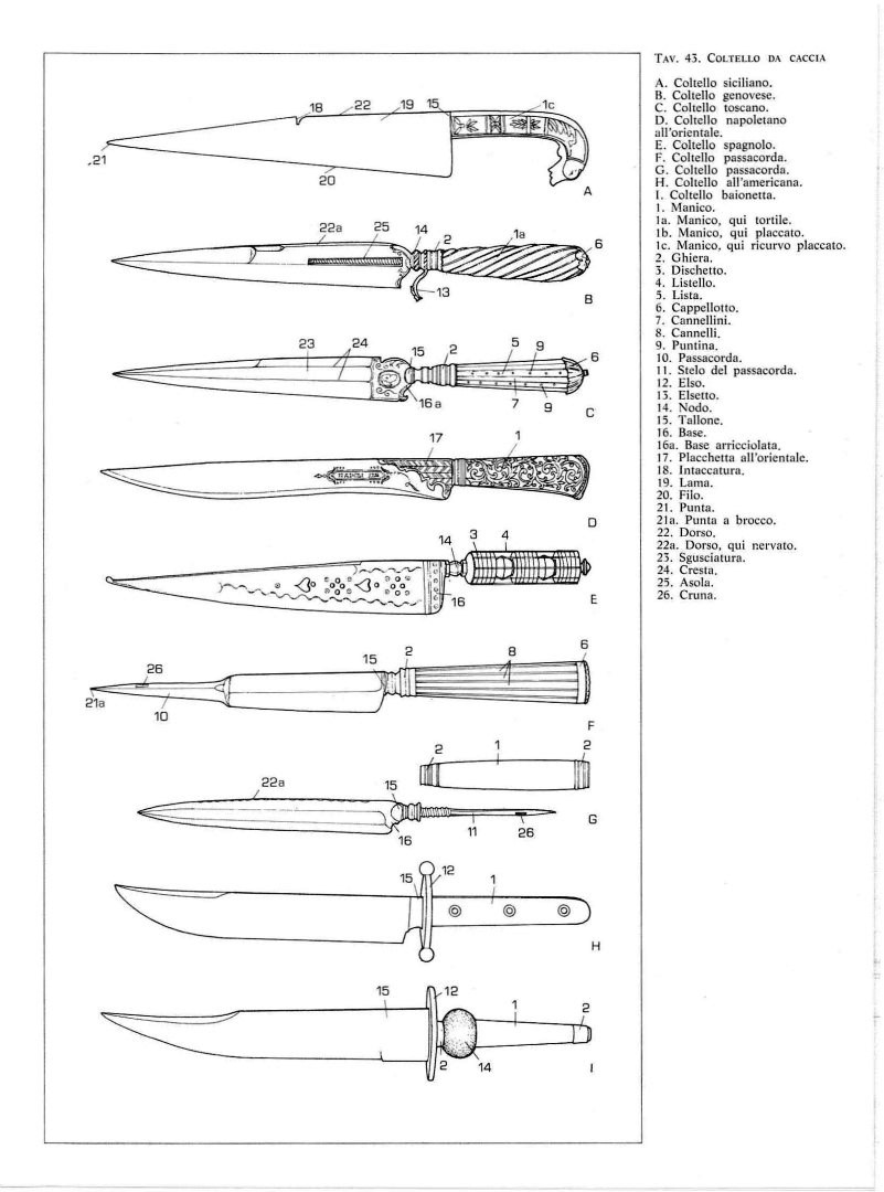

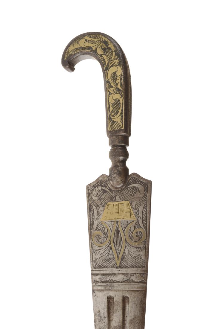

I should be nice to learn how to distinguish Ligurian (Genovese) knives from those of the South. Interesting to note that Sardinia, where the Genovese type seems to have reached (per corrado), is so Meridional as Southern Italy mainland. Actually another Italian auctioner also from the North (Czerny's), from where my example (indirectly) came, treats these types as Southern, while other sources calls them Meridian, a similar regional attribution. A pity that in "Armi Bianche dal Mediebo all'Eta Moderna" (post #17 of Marcus quoted thread) both Marcus item #2 as well as my example are not shown in their true shape... at least to my eyes .
BTW
Spanish (Albacete) knives, those that so many people out there confuses with plug bayonets, are different animals, of course.
Old 4th May 2017, 02:01 PM   #12

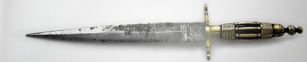

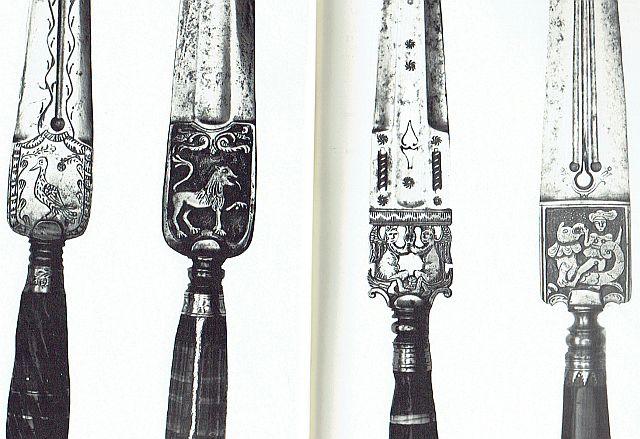

Another example
Old 4th May 2017, 07:16 PM   #13

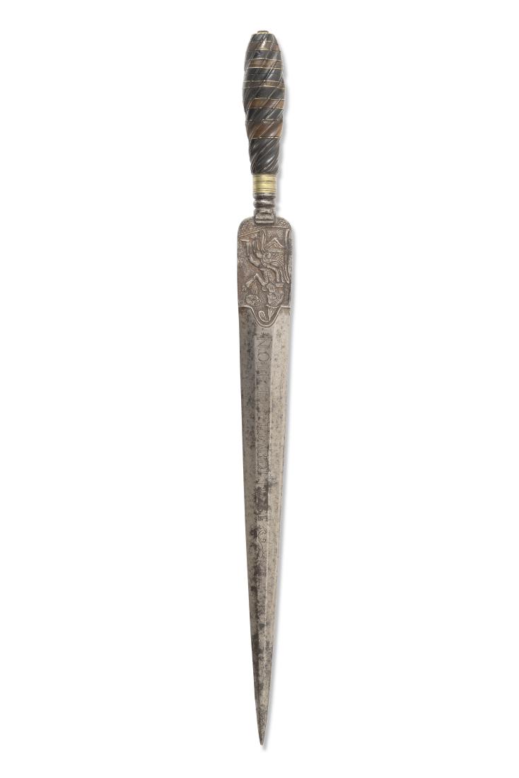

Norman McCormick
Norman McCormick's Avatar
Posts: 1,651
Hi,
This knife of mine is from the very end of the 18thC, European manufacture for the South American market. The similarities with E on Fernando's chart, the Spanish knife, are easy to see. This form appears to have had a relatively long life span.
Norman.

Posts: 1,260
The Czerny designation is absolutely correct for this type of knife/dagger, but the dagger shown differs widely from the daggers of Genua origin in my post!
corrado26

However corrado, the point in question is that, this is the same type as that of Marcus item 2, as pointed out in my post #5 .

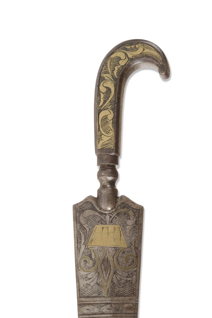

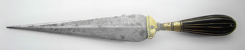

Thank you all for the comments and helpful additional illustrations. I have been traveling the past few days and so have not been able to find time to comment.

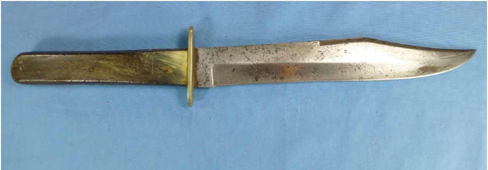

The drop point blade of number 2 puts me in mind of American Bowie knives, many of which, like the example shown, were made in England.
The knife shown by Norman, resembling the Spanish form, is also like those from the Canary Islands.

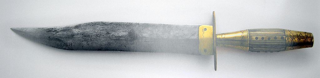

I include also a picture of my Albacete.
