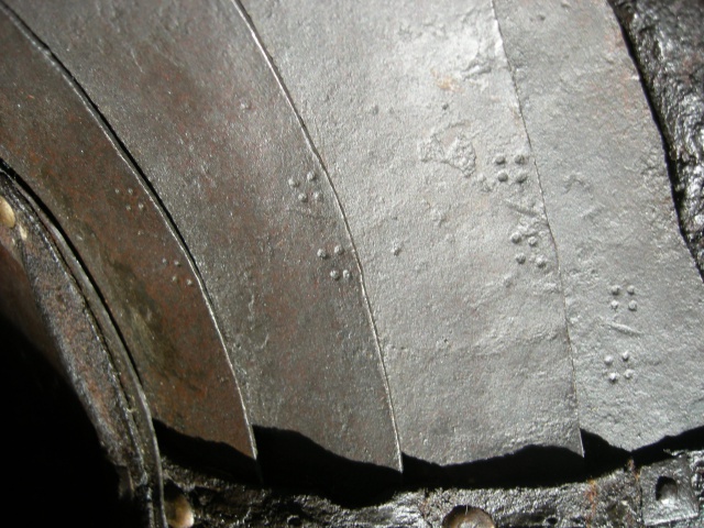

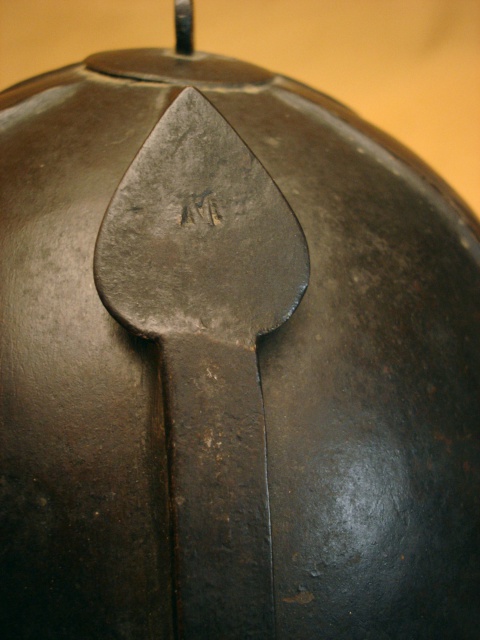

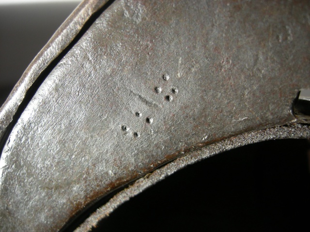

In first, sorry my poor english...I own this helmet - I suppose it's german - and I need to identify marks. M on the nasal and :: / :: what's this last marking ? Thank s in advance for your help.

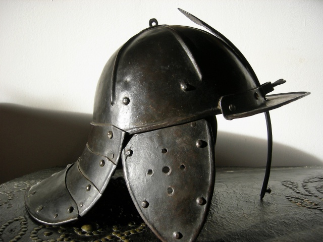

Let us see what the members have to say about your 'lobster tail' helmet.

Hello François,
You have a nice and original lobster tail helmet there , as every part seems to have the 4 dots I think they are simply markings used by the armory to mark parts that were made to fit together for induvidual helmets.

Old 18th March 2017, 02:23 PM   #8
A Senefelder
Join Date: Jul 2009
Posts: 214
What Ulfbert said. These helmets were made in large quantities and in order to keep the plates for each one of a set together this sort of matched punching was sometimes used. There was a second punch method used where it was sequential used to keep plates of an assembly ( usually arms or legs ) in their proper order where some of the plates look similar in sequence. I've owned examples of both over the years and used both punch methods when I used to make armour for a living.

Thanks for the kind words Jim and Senefelder,
Good and complete lobster tail helmets or zischagge's are very hard to find.
Most of them have replaced cheek peaces or nasal bars, that does not mean that helmets with restored parts are no good, of course they are if the buyer is OK with it.
As for the stamps on the parts as on this example this seem more the exception than a rule, but it sure does ad character and history to this nice helmet.

In the thread recently posted, 'a siege weight helmet', I came across the outstanding article in Park Lane Arms Fair, Spring 2005 journal, "What Do Armourers Marks Mean? by Chris Dobson, master armourer.
This article addresses these practices in detail and presents a fascinating look at the systems of stamps and numbering armourers used, giving us insight into these many punched dots, squiggles and other curious marks.

Thank's Jim,
that's great documentation that I have not seen before.
It shows the exact 4 struck point mark like on francois helmet !
