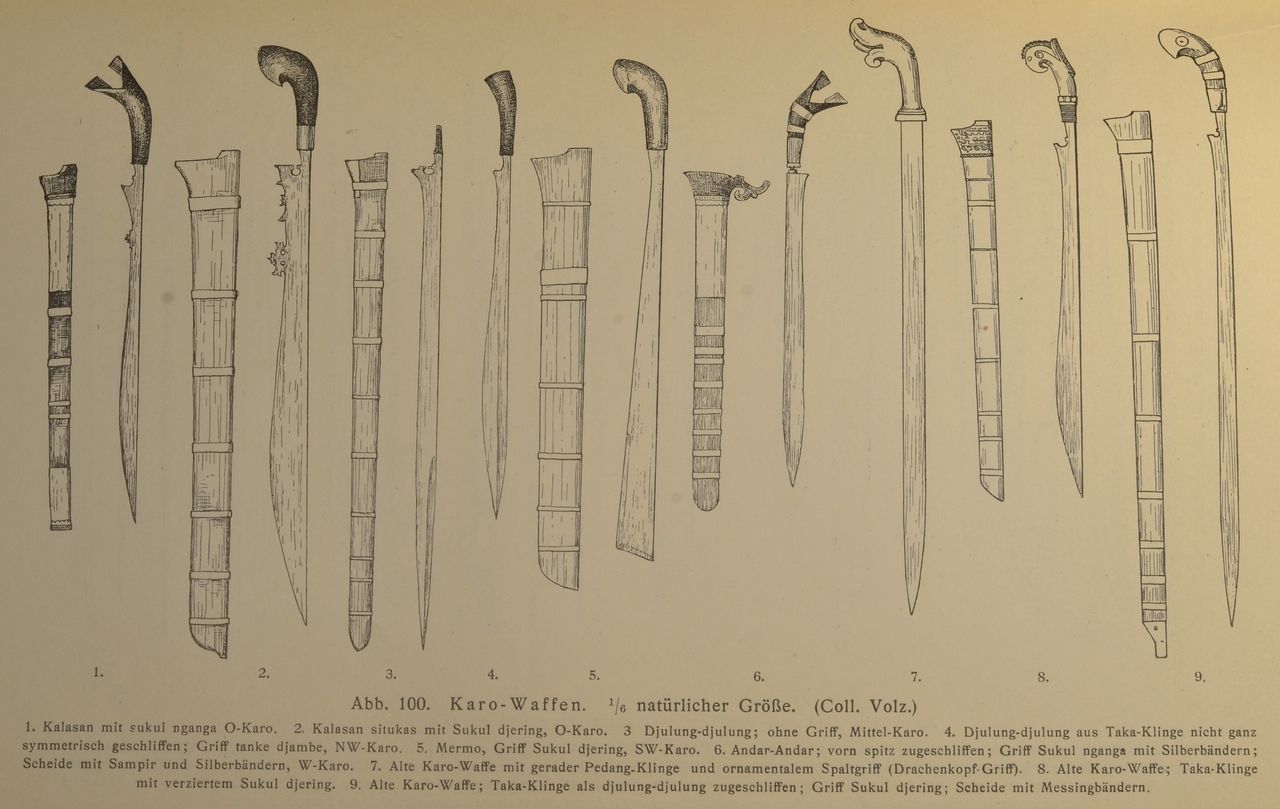

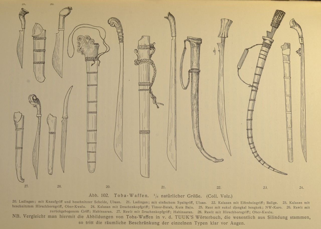

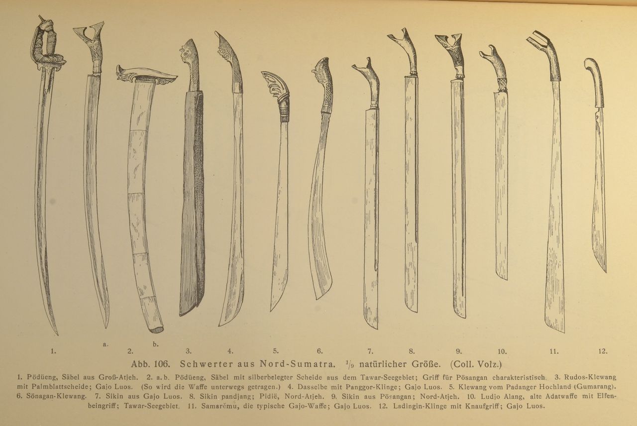

I hope, this pictures are for others as interesting as for me.
This are pictures from a german Expedition book through North Sumatra in 1904-1906.
The informations in this book are invaluable, two books of the nature and human life in Sumatra almost untouched by the western civilisation.
There are only some pages about weapons but they are also incredible. About the origin of the Rentjong for example and many many more.
If someone is interested, i can make some translations.

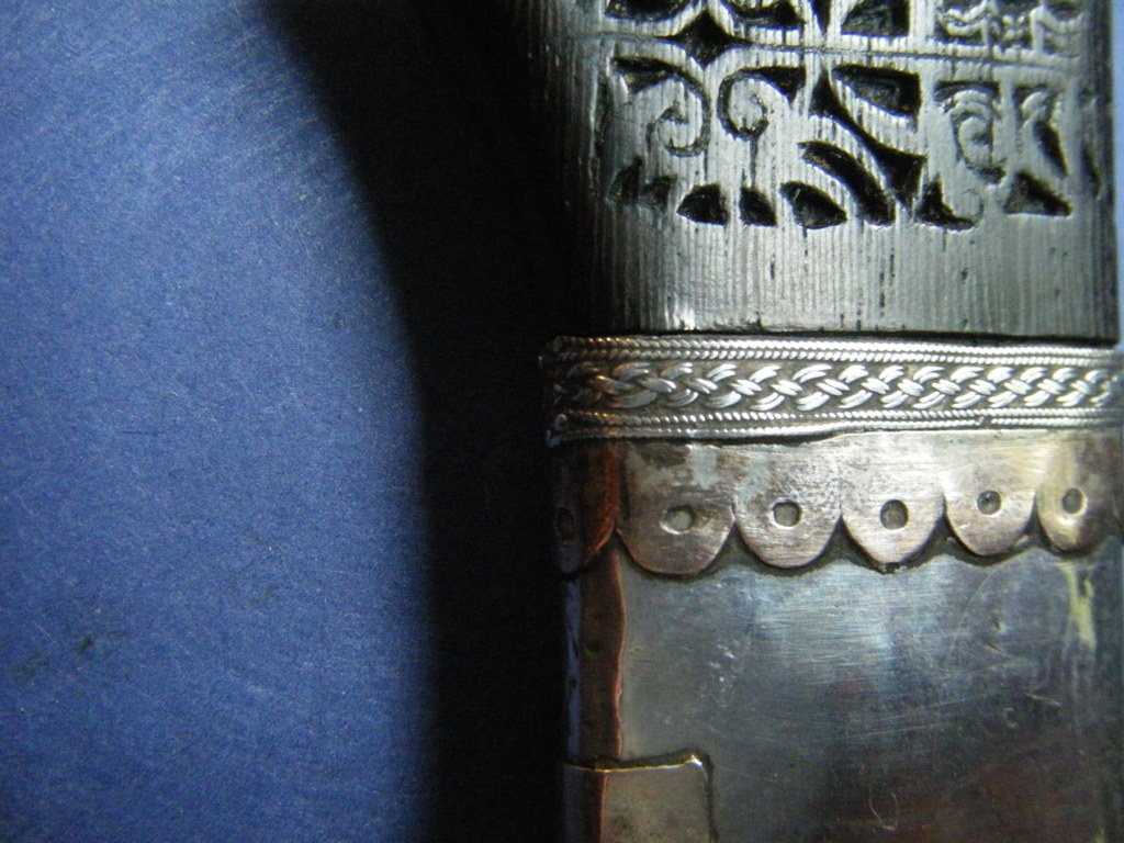

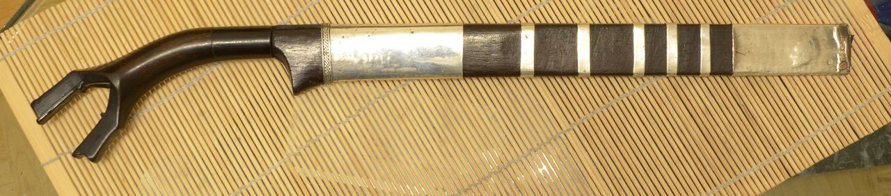

I believe it could be nice to see some real examples. I start with a Batak Kalasan with Sukul Nganga hilt as a dagger with an old high quality Taka-blade.
Best wishes,
Roland

Roland,
This is an absolutely fantastic contribution here! and these are perfectly illustrated examples in outstanding graphics. Though not my field of study, I very much appreciate having this kind of material to add to the corpus of data we archive on all weapons forms here.
As mentioned, comments and translated captions would be wonderful entries from the knowledge core of those in our ranks who consistently add great examples of these weapons here. It really helps to have this kind of an appendix to refer to in research.
Thank you very much!
Old 28th February 2017, 08:53 PM   #4
Posts: 4,749
Roland:
Thank you very much for posting these pictures. They complement other works, such as Albert von Zonneveld's more recent book on weapons of the Indonesian Archipelago. If you have the time to translate the legends to these figures, it would be greatly appreciated.
All great stuff!

Old 1st March 2017, 08:40 AM   #6
Hello Roland,
For those preferring a PDF, Arjan has a file for download here .
The 2-volume book "Nord-Sumatra" by Volz (1909/1912) is indeed a very important early source (and well worth thumbing through even if your German language skill is not up to it). One has to realize that some of these cultures were terra incognita and no go areas till the end of the 19th century or even well into the 20th century until the Dutch managed to grasp firm colonial control (soon to be lost to the Japanese and post-WW2 turmoils)!
I believe it could be nice to see some real examples. I start with a Batak Kalasan with Sukul Nganga hilt as a dagger with an old high quality Takablade.
Looks like a neat Karo piece - looking forward to seeing close-ups and, especially, the blade (preferably pre- and post-TLC)!
I believe it will help the exposure of these nice Batak weapons if examples like this are posted and discussed in a dedicated thread for each piece rather than getting lumped into a thread in coffee table book style which makes discussions rather complex and less focused! (The historic figures show pieces from over 7 quite distinct cultures and the area harbors quite a few more...)

At the latest next weekend I will translate the legends, because they are not just contain the name but also the place of origin in many cases and other useful informations. Maybe I'm going to manipulate the picture-legends.
For example the Peudeung Pasangan (Sikin Pasangan seems to be wrong for the saber type) comes from Tawar-lake area. So I'm very sure, that the hilt symbolizes a fishtail.
Roland

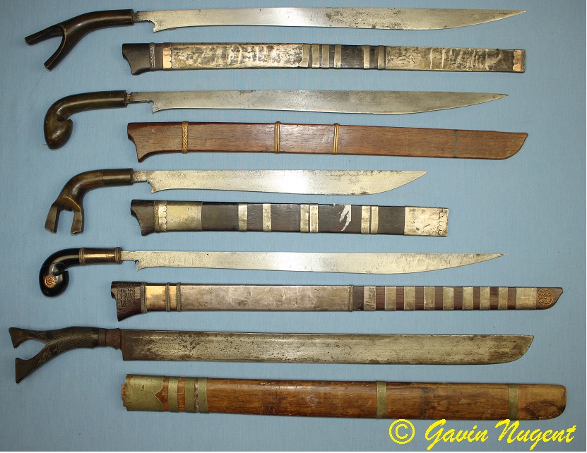

Here are a few example Roland.
I've some Lopah somewhere too...and other pieces laying around...
Gavin

Originally Posted by kai
Hello Roland,
Hello Kai,
thank you and I think I will make a complete thread about the Kalasan in the next few days. I received the Kalasan just five days ago, so the blade is almost untouched by me, at least until now . Seems to have a beautiful hamon.
Roland

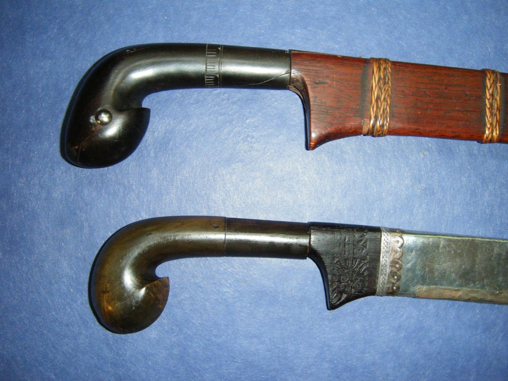

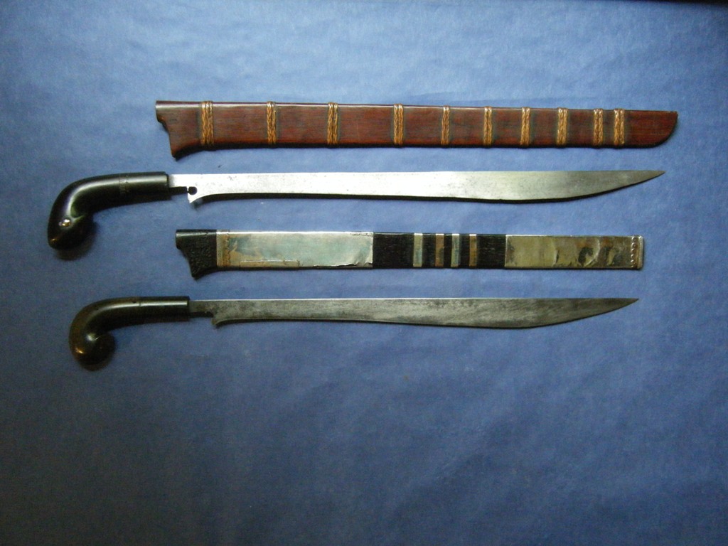

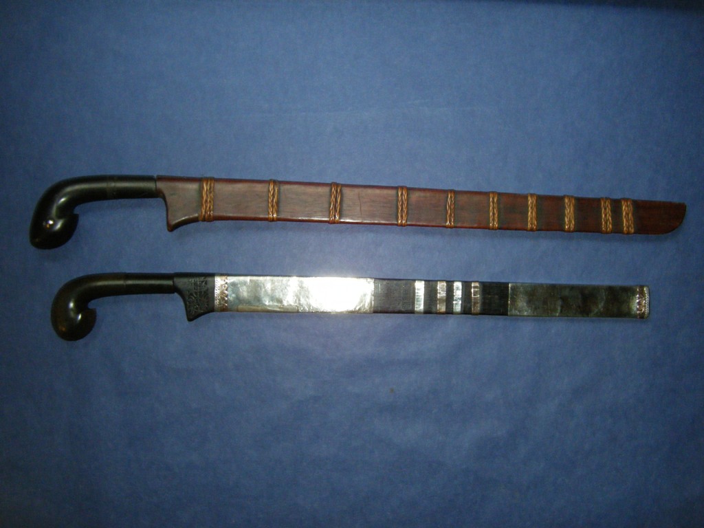

Here some pictures from the both examples of my collection.
Old 24th July 2017, 07:06 PM   #18
Hello Detlef,
Nice examples!
I'd suggest to discuss pieces that are not connected to the expeditions by Volz in separate threads though...
Old 24th July 2017, 07:24 PM   #19
Hello Kai,
yes, they are good honest examples and Roland ask for pictures. I doubt that they are worth for an own thread!?
Old 24th July 2017, 07:43 PM   #20
Hello Detlef,
Sure, any genuine ethnographic piece is worthy of a dedicated discussion - not only high-end stuff!
(BTW, the Karo kalasan with silver/suasa definitely is an above-average example.)
Old 24th July 2017, 08:08 PM   #21
I need better light to take some more and better pictures, maybe I'll start a new thread for them.
Yes, for sure. It coming new to my collection in a poor state, the upper broad scabbard fitting band shows tribal repairs, the silver/suassa sleeve from the handle is missing but the blade is in a very good state.
