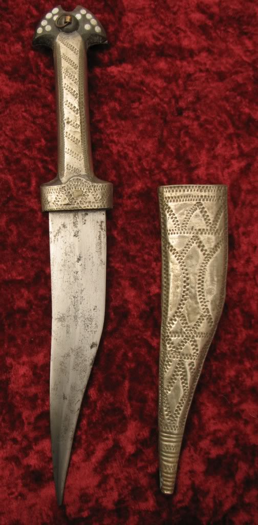

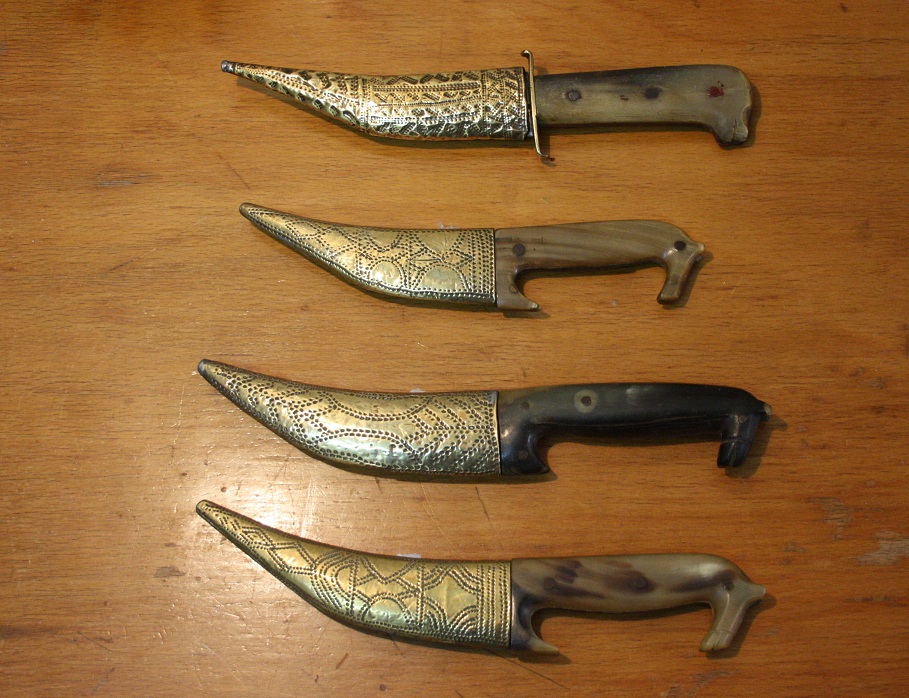

Hello, I want to share these daggers from my collection because they are probably unfamiliar to most of you. In addition, if any of you have a similar one, I kindly ask you to share it with me and others.

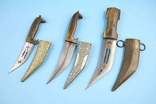

They are very simple village-type daggers made for ordinary people. Artzi helped me to identify the first one and they are known to local collectors as Lebanese daggers. While this might be true, I suspect that most of them originate from within the borders of the British Mandate in Palestine for two reasons. First, the decoration on the scabbard of the lower 3 shows a pattern that is charateristic for Palestine and similar to shibriyas made there (see pic 3). Second, they all come from England and Australia, and 2 were sold as brought-back souveniers of British soldiers serving in the Middle East. Therefore, it is likely that they were bought in Palestine (not Lebanon) during GB presence there (1917-1947). The main reason I like them is personal. They come from the Upper Gallilea, near the Lebanese border, like me, but in another life.

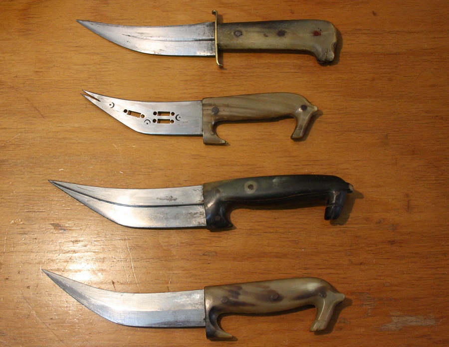

Besides shibriyas, they also show resemblance to some other Southern Syrian/Palestinian daggers (pic 4). They have been mentioned in this forum before in a discussion of Lebanese daggers of Jezzine type, which are more presentation daggers than actually ethnographic items (see http://www.vikingsword.com/vb/showth...ebanese+dagger). Thanks for watching.

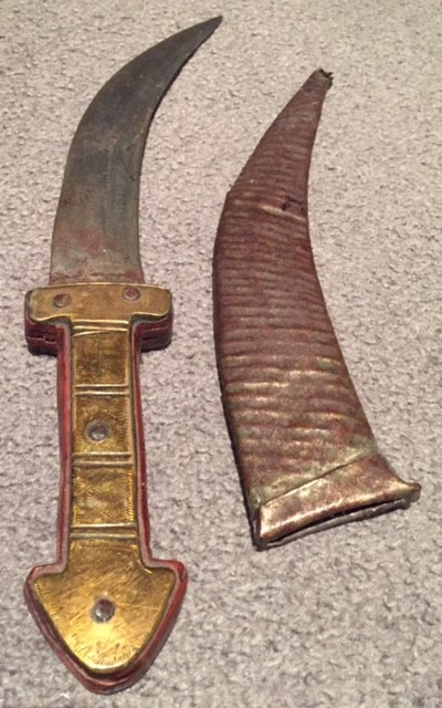

THIS IS THE DAGGER WHICH I HAD POSTED EARLIER AND YOU HAD TOLD ME ITS FROM A VILLAGE NEAR GOLAN HEIGHTS
HERE ARE PICTURES AGAIN
REGARDS
RAJESH

Hi Rajesh, Thanks for posting this. Your dagger belongs to the same extended family of village-made small daggers from Southern Syria, Southern Lebanon and Israel. They all appear around 1900 and I have no idea why. Have there been similar ones before which did not survive? Anyway, there's another very similar one on DaveA's site Atkinson's Swords. Look under type Jabmiya (didn't want to copy photo from his site). Best regards, Eytan

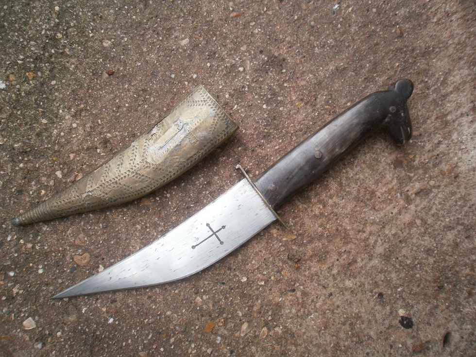

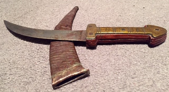

Just bought another one, thank to help from Sajen who put me in contac with the seller. This appears to be a camel head (??). The reason I show it is that it has a cross on the blade, showing that it was probably owned a Christian. Not surprising since Christian Arabs live on both sides of the Israel/Lebanon border, often in mixed villages of Cristian, Muslems and Druze sharing the same language and material culture. So this does not necessarily mean that these are Christian dagges. Still, it is always nice to have any identifying marks on a piece.

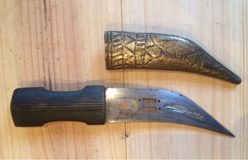

Few more exemplars. All Palestinian with strong Syrian influence. NOT Lebanese (as properly stated by Eytan). Good workmanship and well forged sharp blades. Common in the Northern regions of Israel.

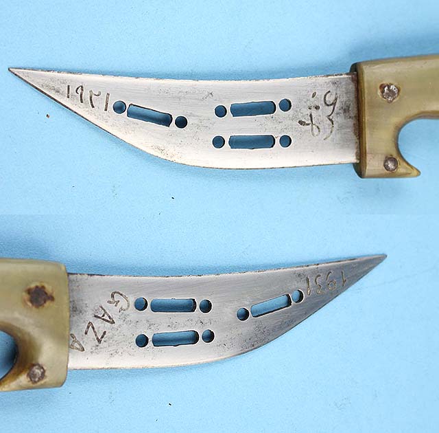

Most interesting is the last one. Small exemplar, signed on the bladse GAZA (In both Arabic and Latin letters) and dated 1931 on one face of the blade and 1921 (In Arabic numbers) on the other face (From the collection of Dr. M. Barzilay). Quite surprise as GAZA is in the far south.

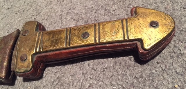

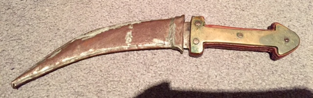

Hello, new member here.

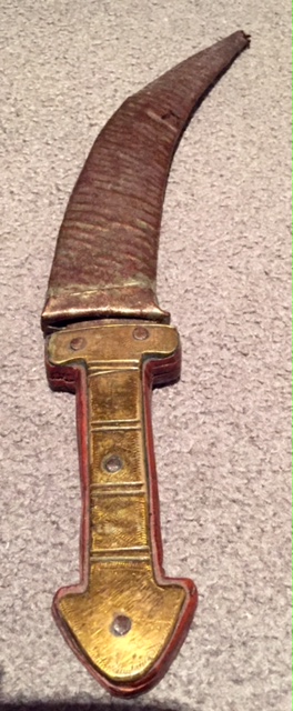

I have a dagger owned by my late father and which I never had the chance to ask him about.
He was an Australian soldier in WW2 and he was in Palestine at some stage.
I have included some pics and would like to know the dagger's origin if possible. It seems to be similar to other pictures in this thread.
Thanks and regards,
Howard

Hello Howard,
Welcome to the forum! Yes, I would say that your dagger belongs to the family of Palestine daggers shown here from Motan. Motan hasn't posted here for a very long time, he would be able to tell you more. But like I said, I would be positive to have such a dagger here.
