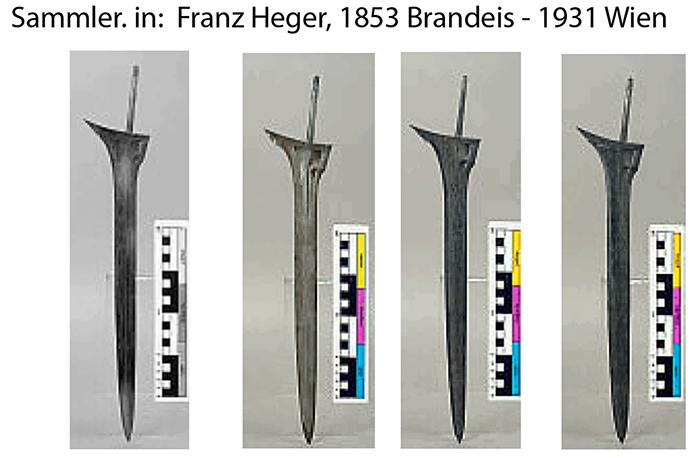

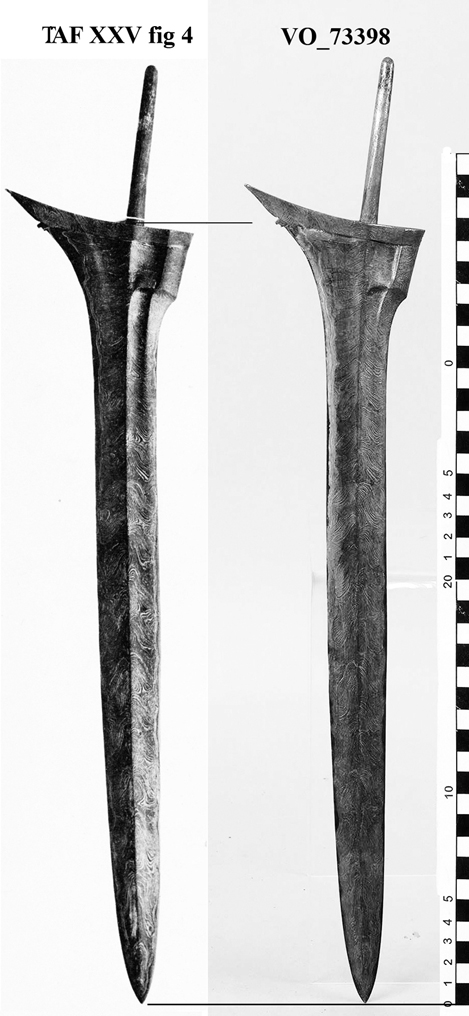

Dr. Groneman mentions in his article quite rough the size of the keris by comparing the dimensions with the size of the pages of the magazine. This was quite vague, so I looked around in the Netherlands to find a “Groneman” keris by collectors and some museums. I found a few and was able to measure them. However I did not find one of the five keris described in the first part of the article of Dr. Groneman.
So I tried to follow a lead to the Austrian Ethnologist Dr. Franz Heger who, as described in the article, had ordered the five keris and had paid for them.

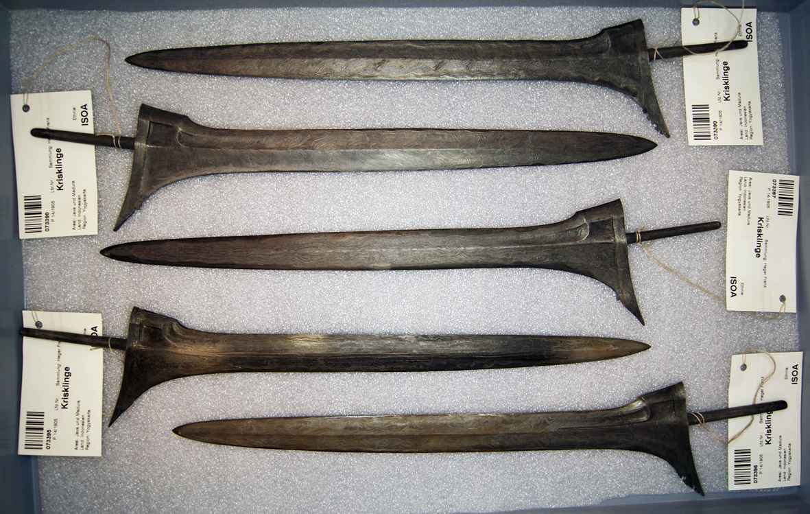

I found out that the collection of Dr. Heger became part of a royal museum in Austria. The museum was eliminated and the collection was divided between two Austrian museums in a later time. The part of the collection with the five keris could possibly have been transferred to the collection of the Welt Museum in Vienna.
After some communication the museum was so friendly to search for me between the about 200 keris they have in their collection and at last and to my big surprise they came up with some very small and low quality photographs of keris that looked very much alike the original five keris.
