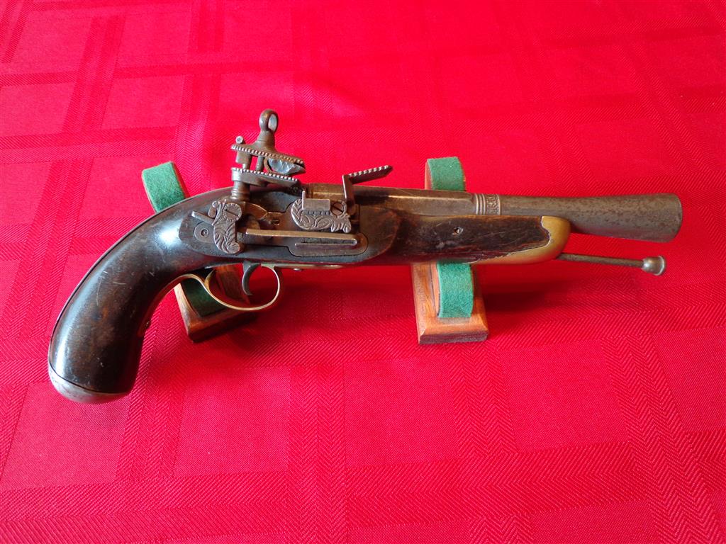

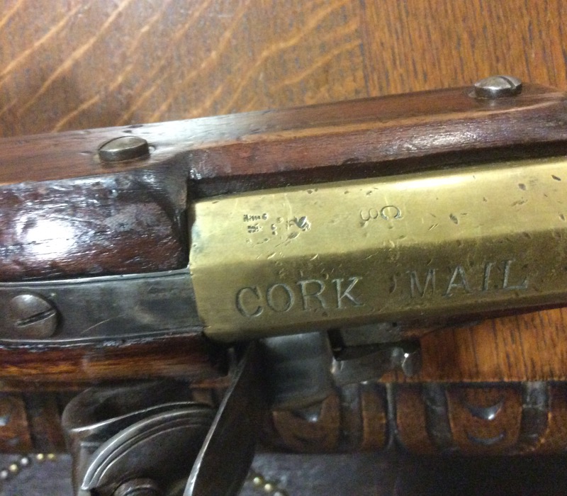

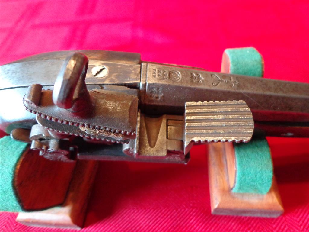

Hi all
Thanks to a pervious post on A York Mail blunderbuss I have saved a good bit of money
http://www.vikingsword.com/vb/showth...ht=blunderbuss

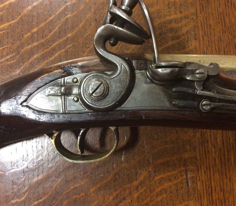

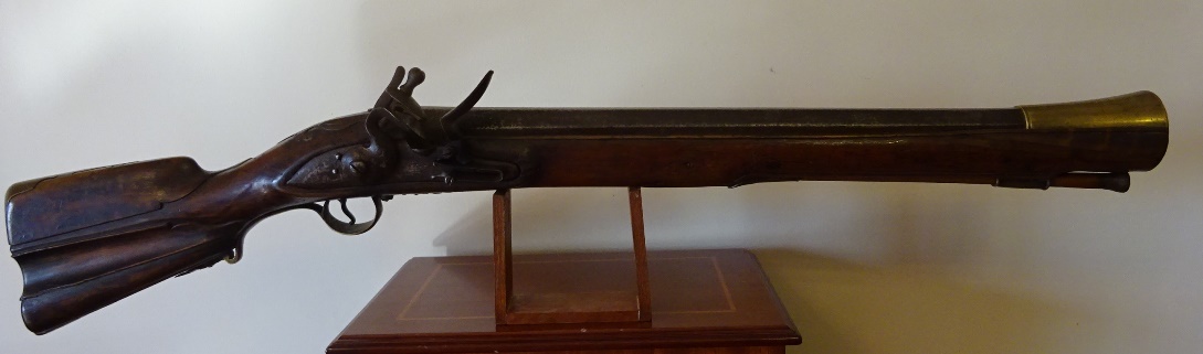

The attached blunderbuss has just sold at an auction in Ireland

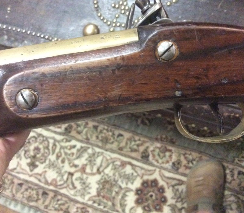

I went to view over the weekend and on comparing the two I was confident this is a recent reproduction as per post above
Things to look out for

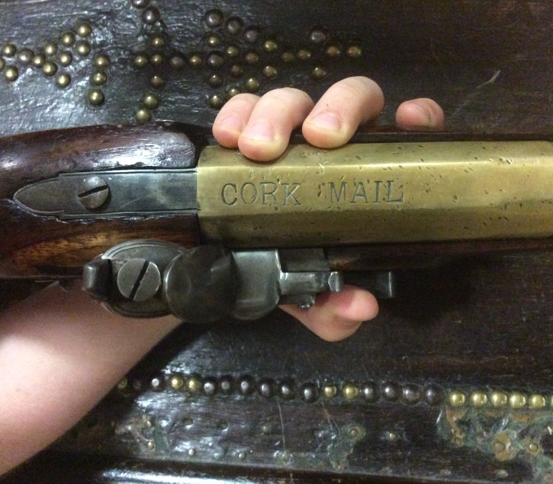

Not one screw was rounded anywhere
Font on Cork Mail not square
No wear on the stock chequering
No makers mark on the lock
proof marks did not make sence
and a few other small things
Incidentally the safety did not work and the sear was not engaging with the nice click noise
With a bit of improving on the workmanship it would be hard to distinguish

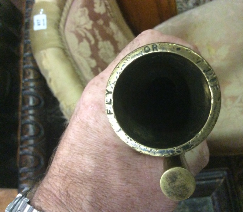

Note also the Fly or Die on the end of the barrel, which shows recent tooling marks on the inside
I hope this thread is appropriate as I just want to alert others to these items
Best regards
Ken

That blunderbuss is well synthesised, unlike the ugly tourist gun. One further weakness is the inletting at lock and tang, which look somewhat worse than any original I have looked at (I am not an expert though). It makes me want to understand who made it and from what. The creation of charming copies for Victorian decorators is well known, and there are known past collectors who have had top-quality copies of rare guns built, ofttimes with no intent to deceive.
This one has to me the feel of a 1950s-60s faker, when top quality craftsmen were less likely to do this stuff and the 'distressed' look was a big part of making new craft furniture 'antique'.
The 'no makers mark on lock' and 'barrel stamp not square' is not at all definitive. We tend to see better-quality retailed pieces or known-quality military standards, but a body like the Cork Mail probably armed their guards from lower-quality trade suppliers, perhaps by tender. The makers would not necessarily pay a quality engraver to mark trade-sourced second tier locks. The Cork Mail stamp is done with old-looking individual letter stamps and reasonably well aligned though not perfect. Letter stamps are more what you would expect in smaller more remote or colonial organisations and consistent with the lower trade quality of the components.
The fly or die is also letter stamps but perhaps newer font, and is the worst feature on this gun I think. The inletting feels like the gun has been made up from two genuinely old but partial guns, and the cock clamp screw and other un-butchered screws are probably new-made.
Overall, I would give it house room if it were not priced too high or for a Cork historic exhibit. Its almost OK, but a fastidious collector or museum might decline to lower the tone of the collection with it.
Just my less-experienced opinion.

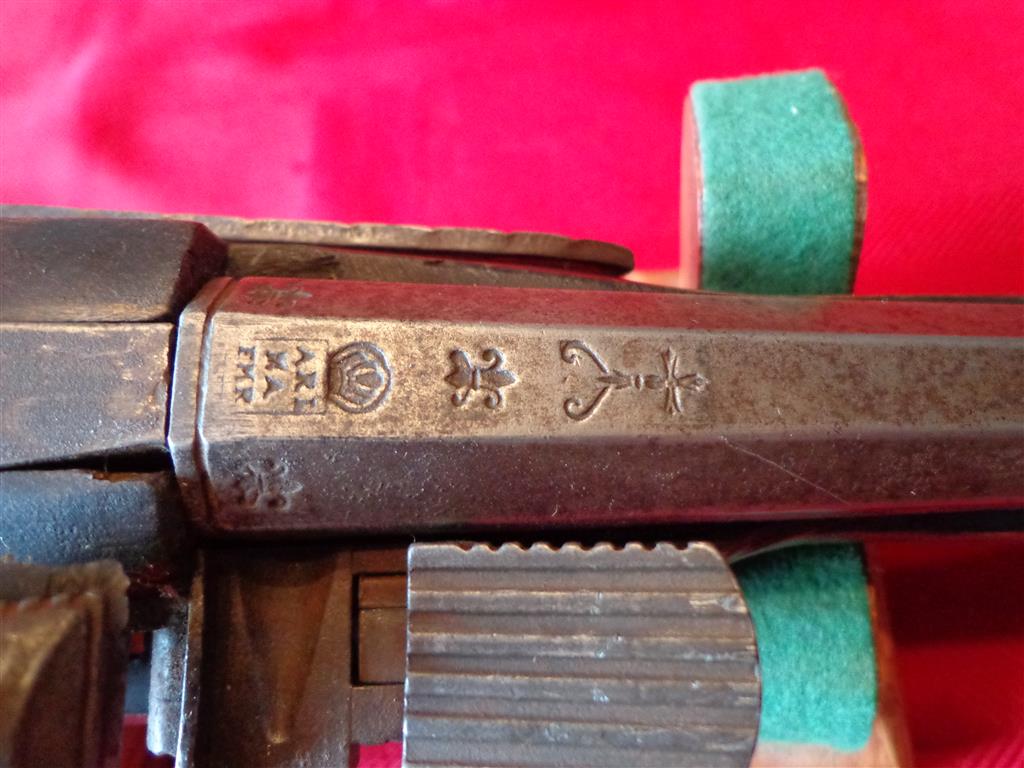

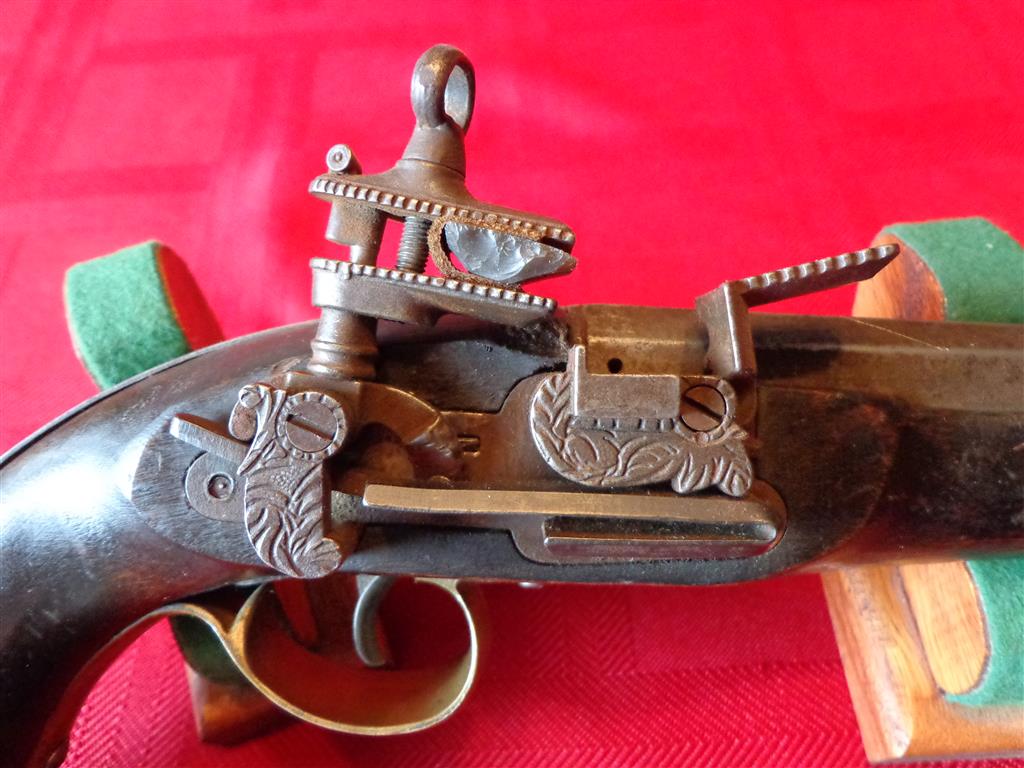

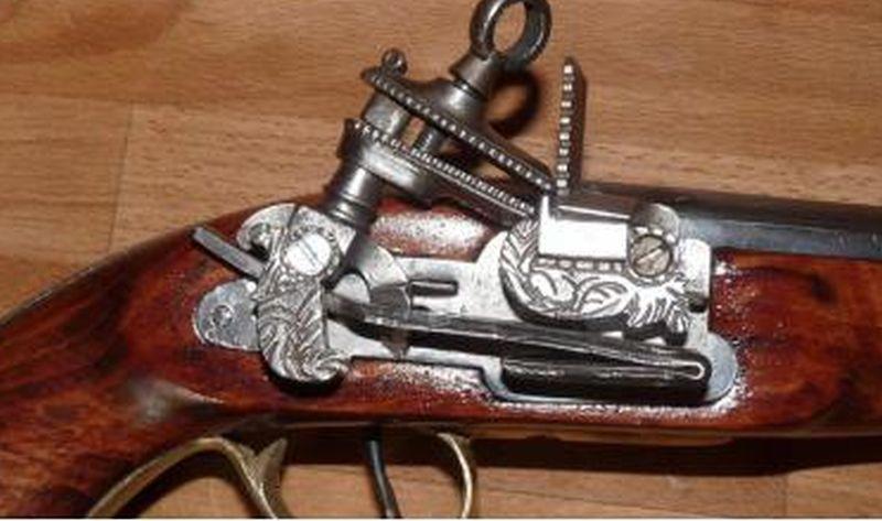

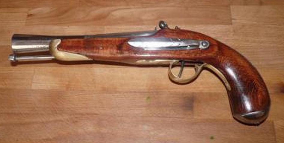

This pistol is a typical Indian made replika of the 1980s. I've added fotos of the same pistol and a foto of another type. Both pistols have exactly the same lock, a fact that is rarely found at original items.
corrado26

I agree in principle
I do think though the blunderbuss is not a tourist item and discussing does enhance the forum by showing what good copies are being made
Without this forum I would have bid north of 700 euro for this gun
A rogues gallery of fakes is a good idea
Ken

The blunderbuss is not real, it not a tourist item though, it is something made to deceive ( my opinion)
But I reckon without the mail stamps and a few other things I am not going to get into on an open forum, this blunderbuss could be made to completely fly under the radar and be purchased for not inconsiderable money as the genuine article.
I have purchased fake items and if is a learning experience
My lesson was not that expensive but we'll learned all the same.
Maybe a thread entitled " my mistake purchases" would be handy as a reference of what is out there.
I am not a regular enough contributer to this forum to start such a thread though as it is not really what the forum is for.
Ken

I could not find evidence of any FLY OR DIE phrase nor any reference to it.

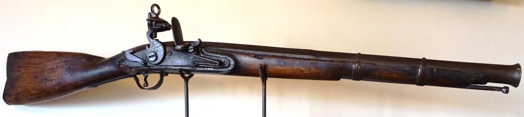

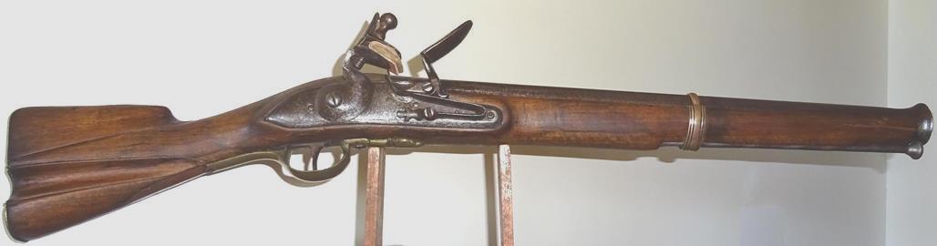

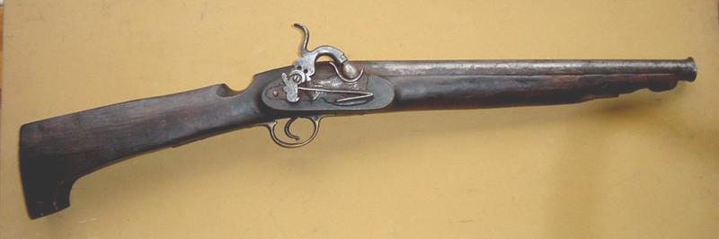

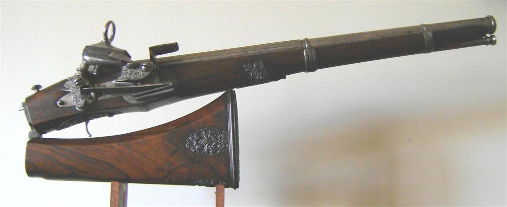

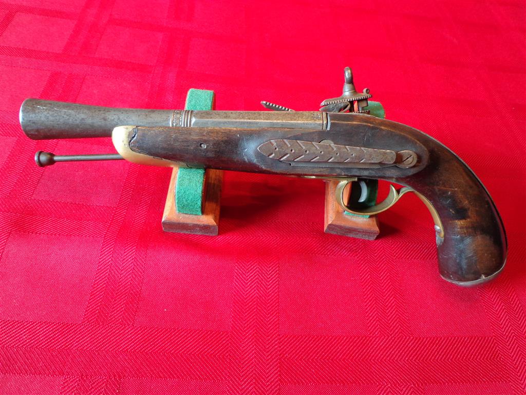

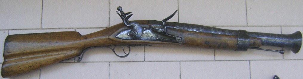

Interesting question, Jim, starting by sorting it by either typology or coloquial terms ... or even by period.
What is precisely a coach gun ?
Does a coach gun have to be the blunderbuss type ?
Do navy blunderbusses have something to distinguish them from those used in coaches ... or those used afoot ... let alone the bronze barrel version ?
How would you classsify the following examples ?

Such a beautiful set of guns Fernando, thank you for posting them, they really brighten my day!
They look very stylistically from the peninsula, are there any you think are Portuguese ?
machinist is offline   Reply With Quote

Thsnk you machinist and thank you Cris.

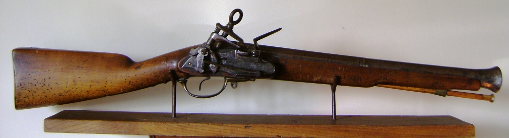

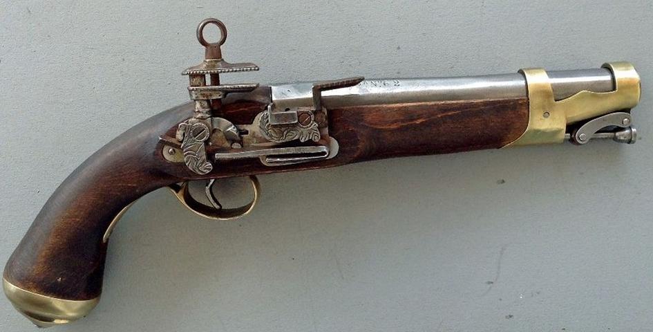

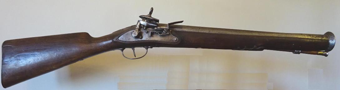

Let me try and 'localize' them ...
#1. An early dog lock system, potentially made in Portugal around 1700.
#2. A luxury engraved example with a typical Portuguese lock, XVIII century.
#3. A miltary style example with a Miquelete lock, made in Spain, circa 1800.
#4. A rather rustic wound steel barrel specimen, with a salvaged Edge lock (1762), made in Portugal in the XVIII century.
#5. A short blunderbuss, with salvaged lock and barrel (Peninsular War), set up in regional Portugal.
#6. A Spanish trabuco with a percussion Miquelete lock, a Catalan stock and a salvaged John Clive barrel, first half XIX century.
#7. An Îtalian luxury 'Scavezzo', to be carried in coach door pockets, made in Brescia in the XVIII century.
#8. Another luxury blunderbuss, with a strong octogonal barrel, made in Portugal, end XVIII century.
Note; all provenances indicated are not categoric, only based on common sense; always susceptible to be corrected.
In a note to Jim i was trying, maybe without success, to evade the steryotypes without evading the fact that some guns are more suitable or even typical to use in coaches, this not necessarily being an exclusive attribution. Coach guns are, as i see, usually connected with Anglo American terminology, like those of Royal Mail and Wells Fargo, while i was wandering in a wider range, as these mail/passenger transport facilities (diligencias, malapostas, etc) were used all over. Thus my approach to be more on guns for coaches than coach guns, if youn catch my drift .
