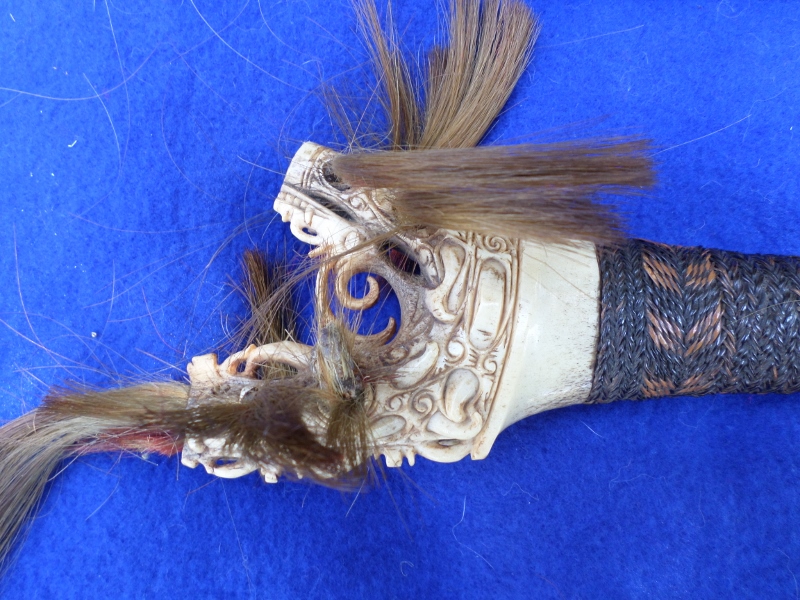

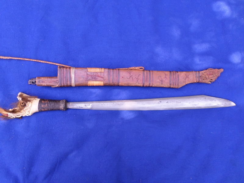

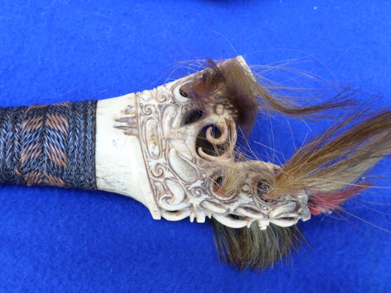

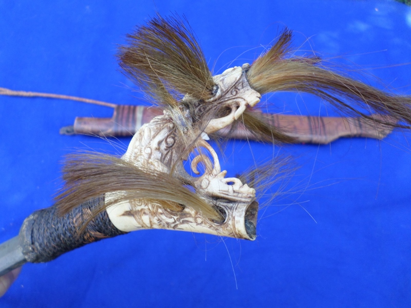

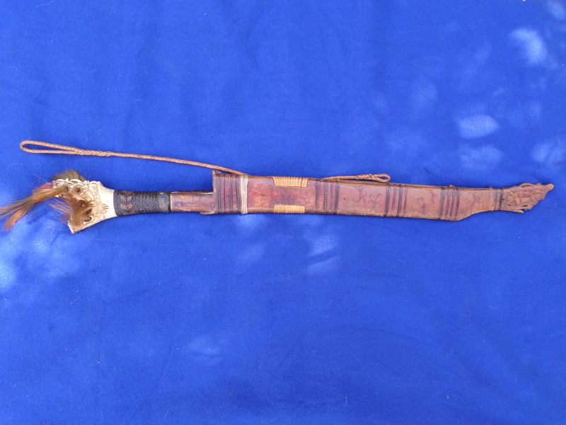

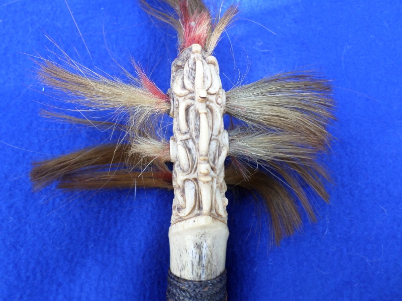

Up for viewing is a mandau with a very ornately carved handle. Of the many mandaus we own ,this has to be one of my favorites. the question i would like to ask, is there possibly a connection between the form of this handle, and the shape of a campilon handle. I realize that this might be a stretch........BUT, given the fact that the camp was also considered a Sea Dyak weapon, might this shape also be carried over to some of the Land Dyak handles. Or is this too much of a stretch of my imagination...........Dave.

Oliver: I don't know. Somehow to my eye anyway, a Murut hilt just does not look anything like a campilon hilt. I'll have to dig out the pakayun i have and take another good look..........Dave.

I THINK THE CONNECTION IS THAT MANY WEAPONS WITH FORKED HANDLES MAY COME FROM THE SAME INSTINCTIVE AND TRADITIONAL WAY MANKIND THINKS AND REPRESENTS THINGS IN HIS ART AND CRAFT. ONE SUCH THING IS DANGEROUS ANIMALS BOTH REAL AND MYTHOLOGICAL ARE OFTEN REPRESENTED WITH THEIR MOUTHS OPEN. DRAGONS, LIONS, TIGERS, CROCODILES AND SUCH ARE MORE OFTEN SHOWING THEIR TEETH THAN NOT. A SWORD POMMEL MAY REPRESENT MANY THINGS USUALLY SOMETHING RESPECTED, FEARED OR BELIEVED TO HAVE SPECIAL POWERS. THE OPEN MOUTHED DRAGON SHOWS POWER AND THE THREAT IT IS GOING TO EAT UP THE ENEMY. NO DOUBT SOME BELIEVES IT GIVES THE WIELDER SOME OF THE CREATURES POWER. IT IS A SIGH OF POWER OR RESPECT AND OFTEN A TOTEM OR SOMETHING RESPECTED AND REVERED BY THE SOCIETY OR WARRIOR. FEARSOME WARRIORS USUALLY DIDN'T FAVOR MICE OR WORMS TO DECORATE THEIR SWORDS.
THERE ARE OTHER DESIGNS ESPECIALLY WHEN YOU GET AWAY FROM PRIMITIVE GROUPS THAT OFTEN REPRESENT HERALDRY, AND SUCH BUT OFTEN FIERCE BEASTS ARE REPRESENTED THERE AS WELL, GRIFFINS, LIONS, UNICORNS AND DRAGONS ABOUND THERE AS WELL AS THISTLES AND FLORAL DESIGNS. THE FORKED POMMEL ALSO HELPS KEEP THE SWORD FIRMLY IN HAND AND FORKED WOOD AND ANTLERS WERE CONVENIENT MATERIALS.

Hello Dave,

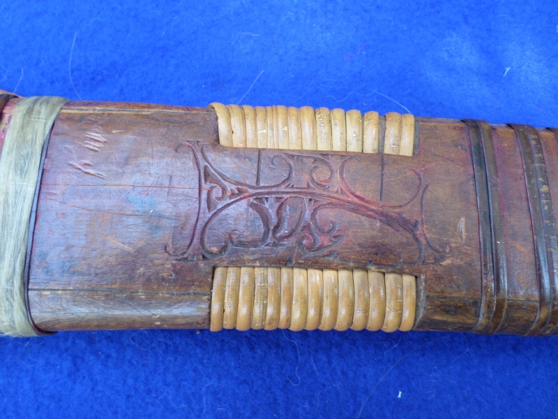

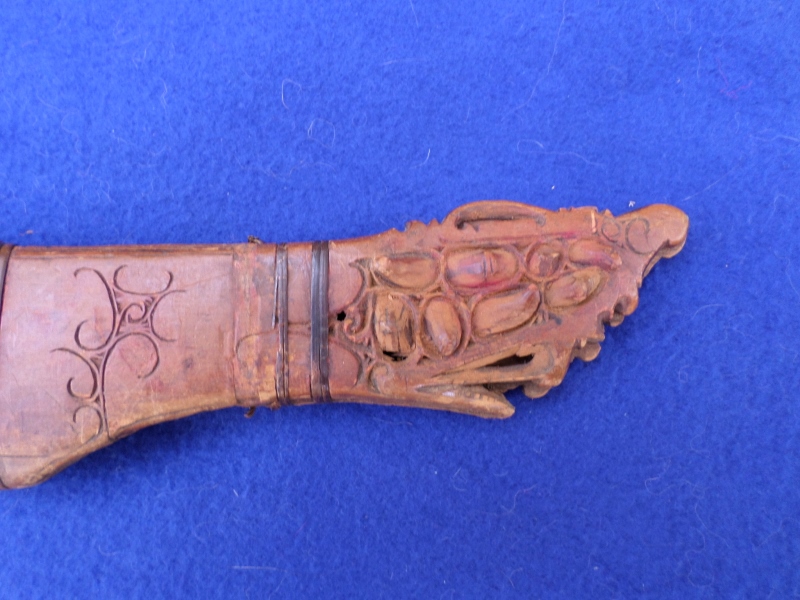

Thanks for showing this unusual hilt! IMVHO quite a bit of workmanship and it does look to have some decent age, too. The scabbard looks a bit younger to me - do you have a pic of the backside, please?
I have never seen a reliable attribution of the kampilan being utilised by the Iban: the single reference was most likely based on a lapsus. The Iban are known for inviting Ilanum mercenaries when organizing larger raids. Even if the extent and historical duration of such cooperation remains unknown, it is safe to assume that these 2 cultures had already been in contact for a very long time. Given this, I rather am surprised how little cultural cross-fertilisation seems to have happened - so, my guess would be that there is no direct relationship between kampilan hilts (note that on northern Borneo the less jaw-like hilt types prevail) and neither your mandau hilt nor mandau hilts in general...
