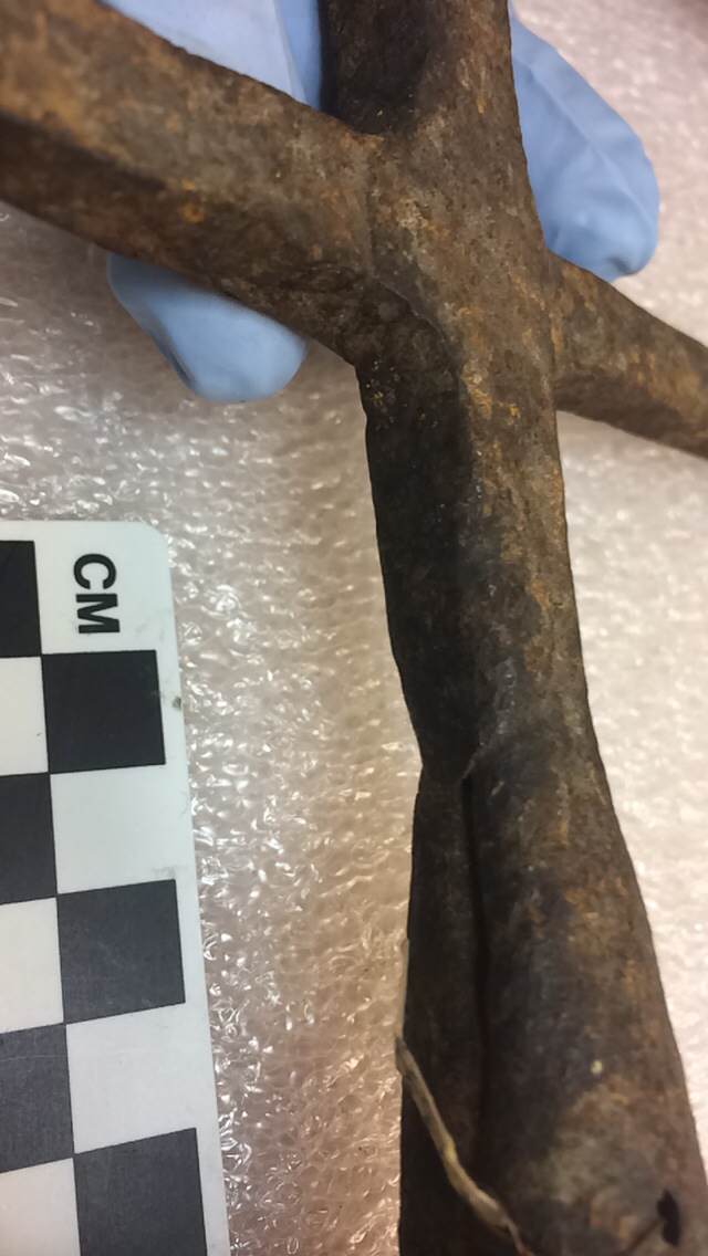

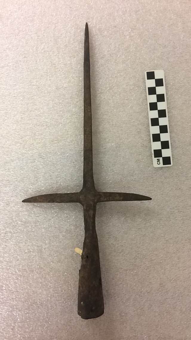

This piece is listed as being found in Germany and is supposedly a lance head from the medieval era. However, I have doubts about this, and I’d like to know more about what type of weapon it is and when it might have been made. It is 35.5 cm long with a 21.5 cm long blade. It has a square blade, with a perpendicular cross guard. It also has a large socket for being inserted on to a pole. It looks like it might have been modified to include the cross guard and socket; you can clearly see the separation of metals where it looks like a sheet of metal was overlapped and wrapped around the end to form the socket. Research has suggested that it’s too short to be an ahlspiess (awl pike), and the long thin cross guard seems unusual for a pole arm. I’m wondering if it might be a modified stiletto dagger (explaining the square blade), or a shorted awl pike (with an odd cross guard since they usually seem to be round). Has anyone come across something similar?

Peculiar piece indeed . Surely intended to be a weapon, in any case.
Wether a medieval setup and of what (sort of) typology, let us hope some knowledged member comes up with a perspective.

Boar spear?

That would be a possibility, but a boar spear usually has a sharpened blade and a slot through which a peg is inserted. A spike won't do enough damage to stop a boar in its tracks. Unless something vital is pierced, you'll have one angry, pissed off critter charging you, and you won't get a second chance at it.
But, I think a lot of weapons that do not easily fit into any particular category comfortably are made in an ad hoc manner by local blacksmiths responding to a particular need, materials availability, or specific customer request.
Hard to pin down any date/place of manufacture, but these have always been fascinating to me.

Looks to be some fashion of pike. Though I've not seen anything quite like that. The nearest equivalent that comes to my mind is an awl pike/Ahlspiess (Swiss). But awl pikes have disc guards. Pikes with symmetrical additional spikes are invariably up-swept or up-curved to my knowledge. The same goes for the closely related military fork. So I would say it is a pike. But beyond that it's hard for me to say anything more specific (even hard to say that it is a weapon). It does look cheaply made. So it could just be someones experiment. But new variations of pikes, military forks, halberds, and polearms in general pop up all the time. So much so that every new one makes things harder to categorize.
