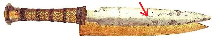

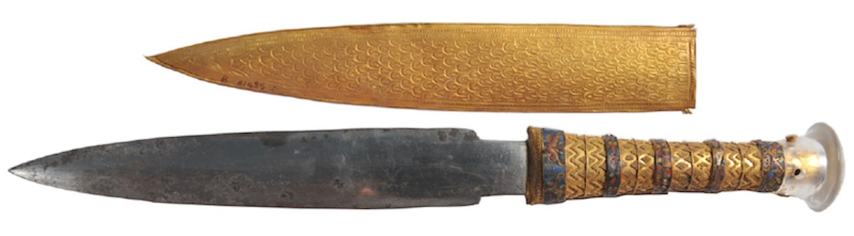

I have two additional pictures.
The picture with the red arrow clearly shows signs of a lamination process.
The other picture looks like that the dagger is differential hardened.
The blade is much too perfect for the first few footsteps with a completely new technology.
Roland
Would you happen to know the carbon content of the blade? The recent XRF measurements appear to have included measurement of the carbon content, but that result isn't given in the paper (other than the statement of "minor quantities").
I'd be really surprised if the carbon content is high enough for differential hardening. A lamination line would be a more likely explanation.
