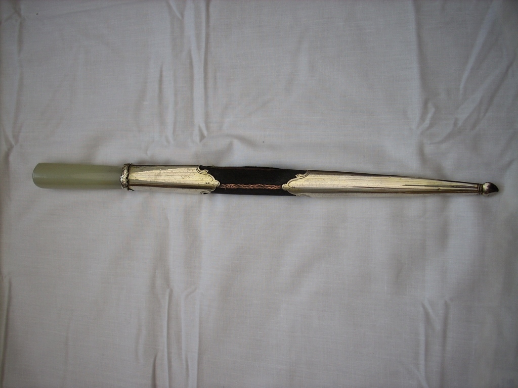

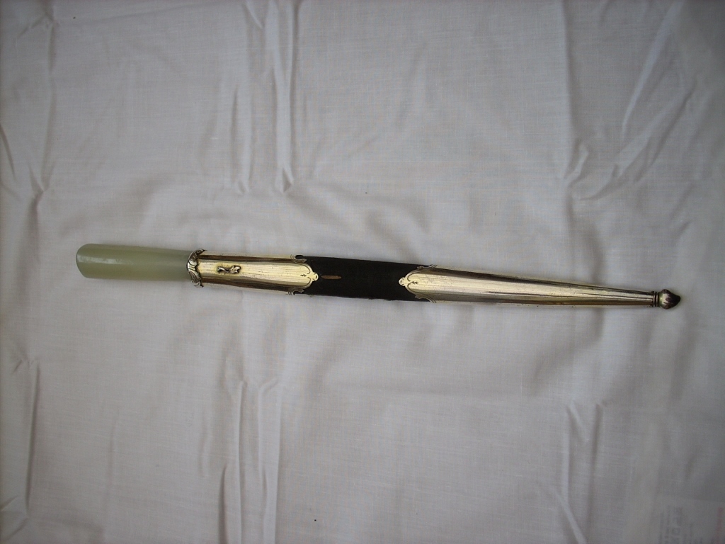

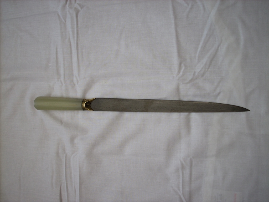

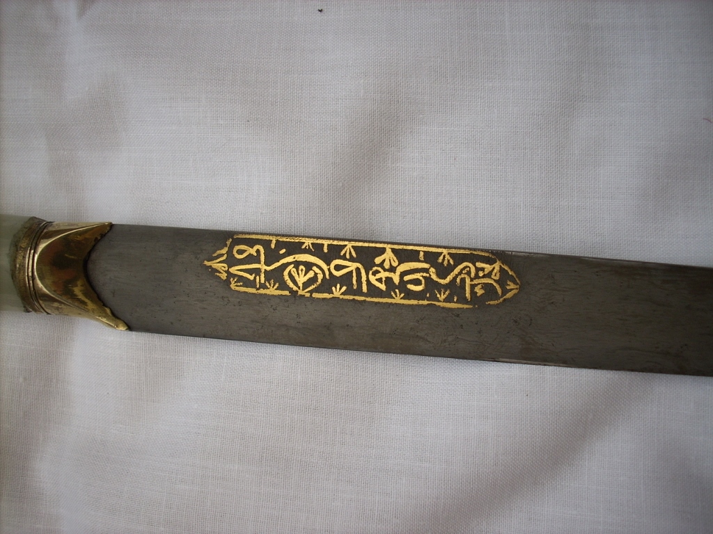

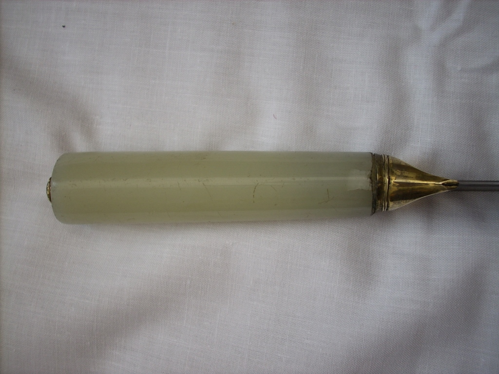

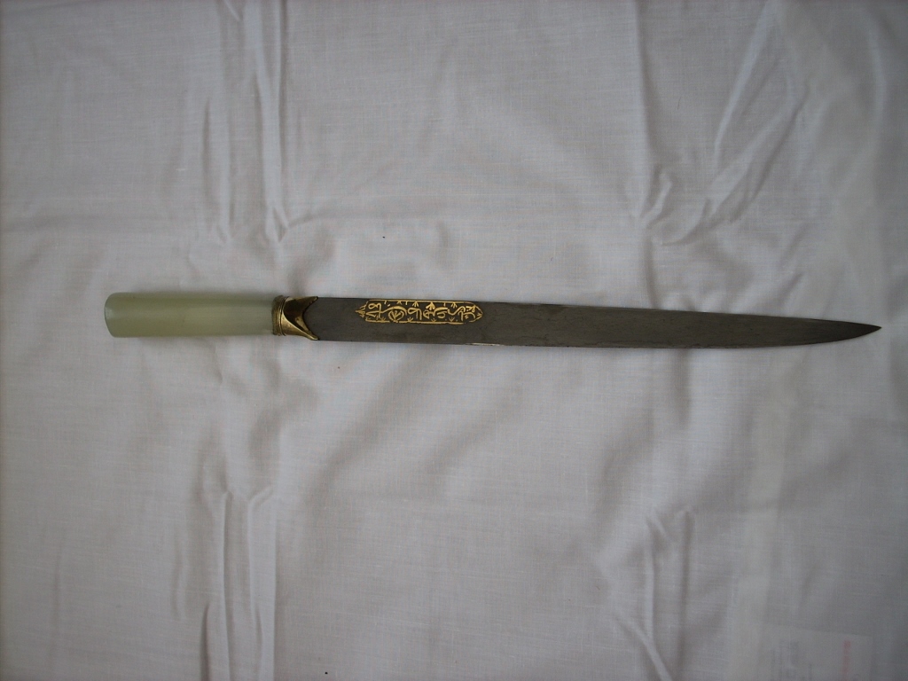

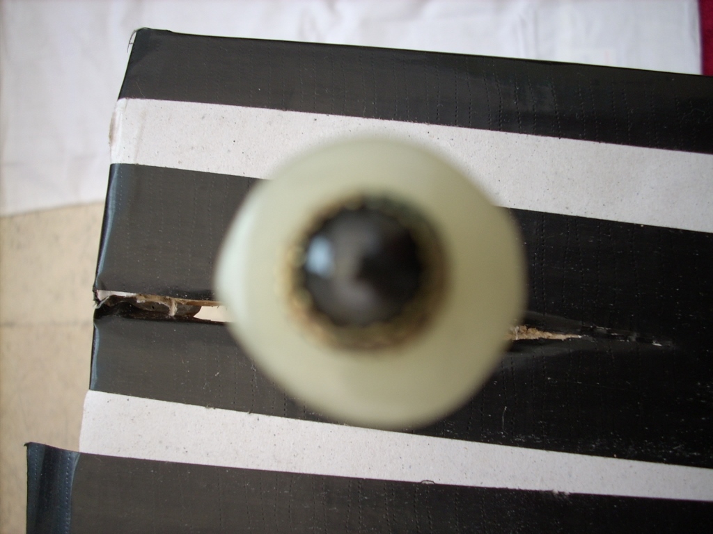

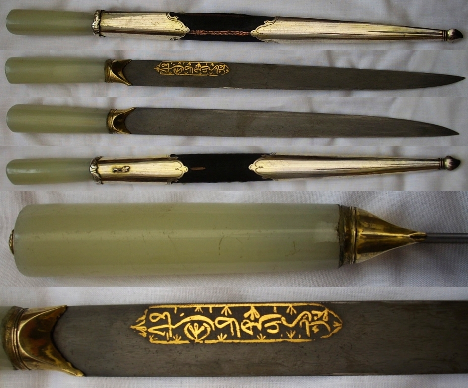

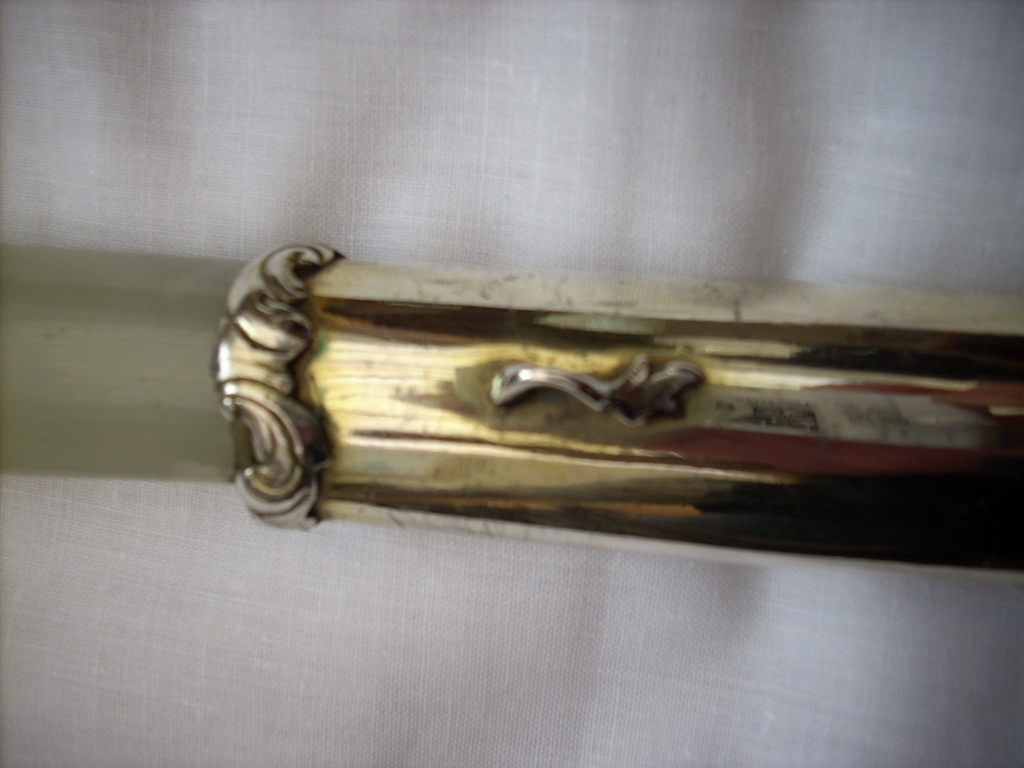

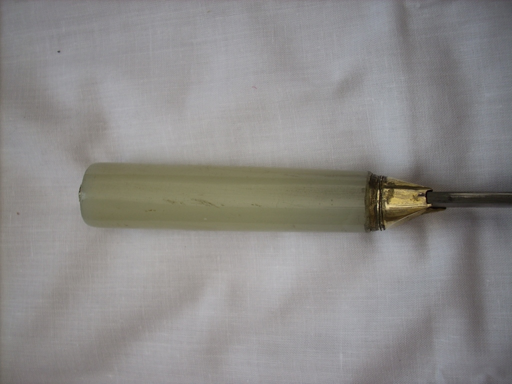

Hello Everyone,
I would like to share some photos of this item with you and hope that you can provide me with more information about it.
I was told by the seller some years ago that it was 18th C and possibly of Kurdish origin. It is a very nice piece and well made. The hilt is of light green jade having a black gem stone in a gold or gilt frame on the pommel with a gilt collar between the hilt and blade. The blade is single edged with a an inscription in gold on one side which I would welcome someone to translate if possible. I believe the blade to be wootz ? but I don't really know.

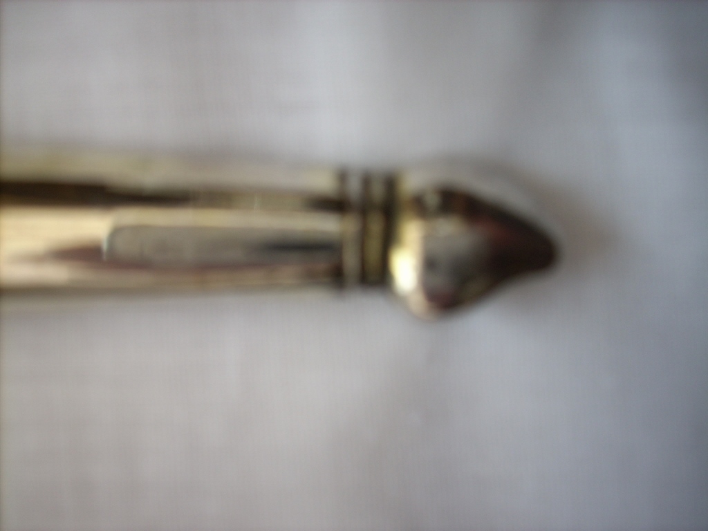

The scabbard is of wood covered with black leather stitched in the Ottoman fashion with gold coloured wire and fitted with silver gilt locket and chape.
Overall length is 14.125 ins with a 10 ins long x 0.875 ins wide blade.
Tirri in his book Maghreb to Moghul shows two similar Kards on page 167 plate 117C which he has put in the Balkan section of the book ?
Thanking you in anticipation.
Miguel

Definitely Ottoman. Maybe Balkan? Does look jade, onyx, gilt silver. And yes looks like Turkish wootz.
I am not aware of these belonging to Kurdish sections of he empire though.
The seam on the scabbard doesn't look traditionally Ottoman but more recent.
What a great piece and thanks for sharing!

Nice kard, the mounts look Ottoman to me, not sure were the Kurdish description came from.

For me its a gorgeous Turkish ottoman kard
Really nice

Thanks everyone for your kind comments and information, I am now pretty certain it is Ottoman Turkish. If it is possible I would be grateful if anyone would mind translating the inscription.

Hey Miguel,
It says "Saheb Taher Omar Bek"
Owner Taher Omar Bek. :-))
Lovely example.

Congratulations for this beautiful piece!
The blade appears to be pattern welded. If this would be the case then it would be most likely Turkey, not Balkans.

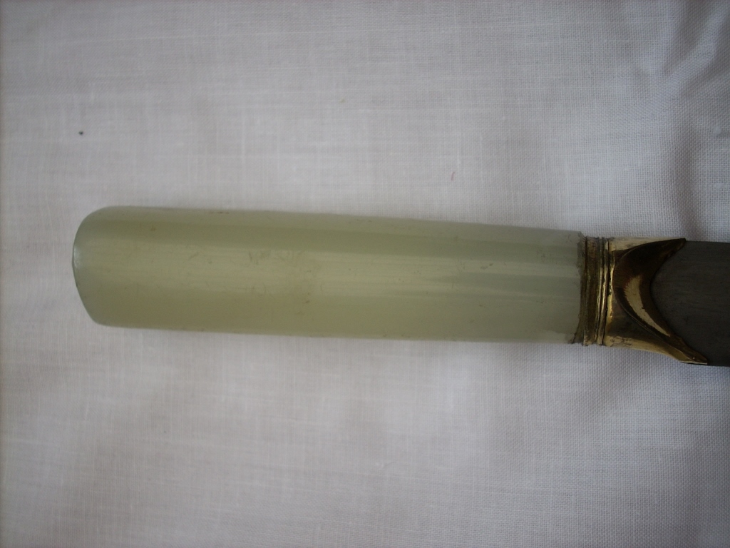

Te grip might be green onyx, which is found in central Anatolia, but is hard to say only from the photos.

Thank you for your comments. I am not sure of the blade pattern it looks like dark wootz to me but not being very knowledgeable on blade patterns I don't really know.
The handle is green jade.
Kind regards

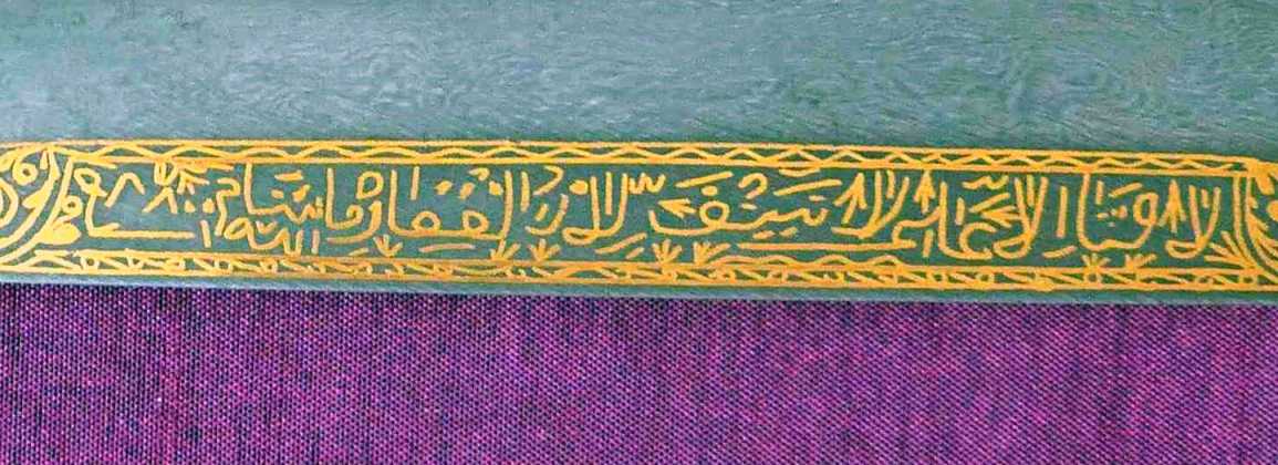

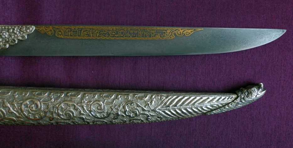

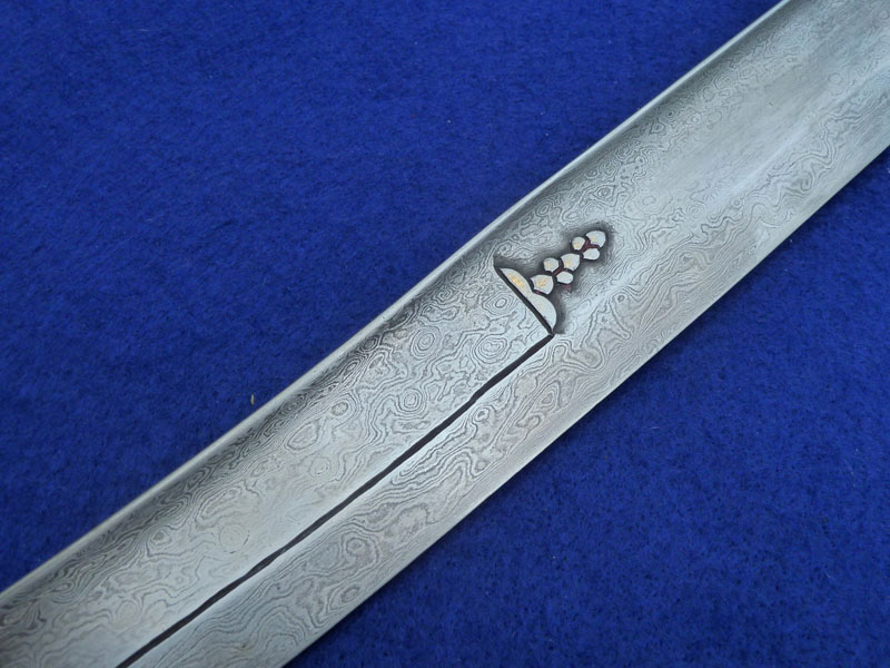

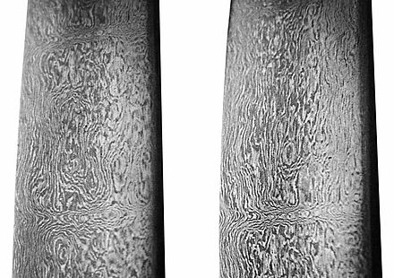

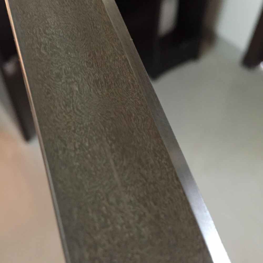

Is is a picture of one type of pattern weld:
Old 30th March 2016, 08:24 PM   #11
Posts: 7,407

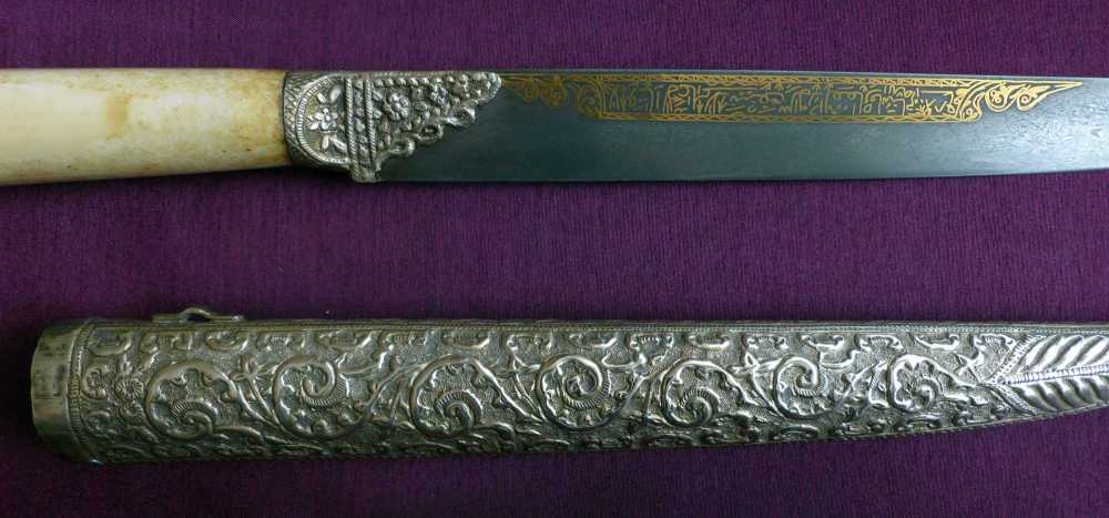

Here is one form of wootz:
Old 30th March 2016, 08:25 PM   #12
Posts: 7,407
After some polishing and etching, I think you will find Turkish wootz (which is low contrast) in your blade.

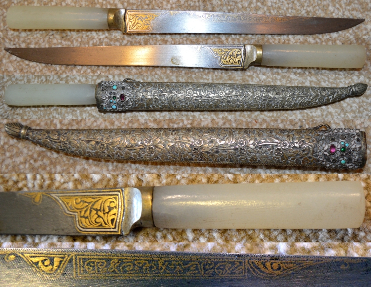

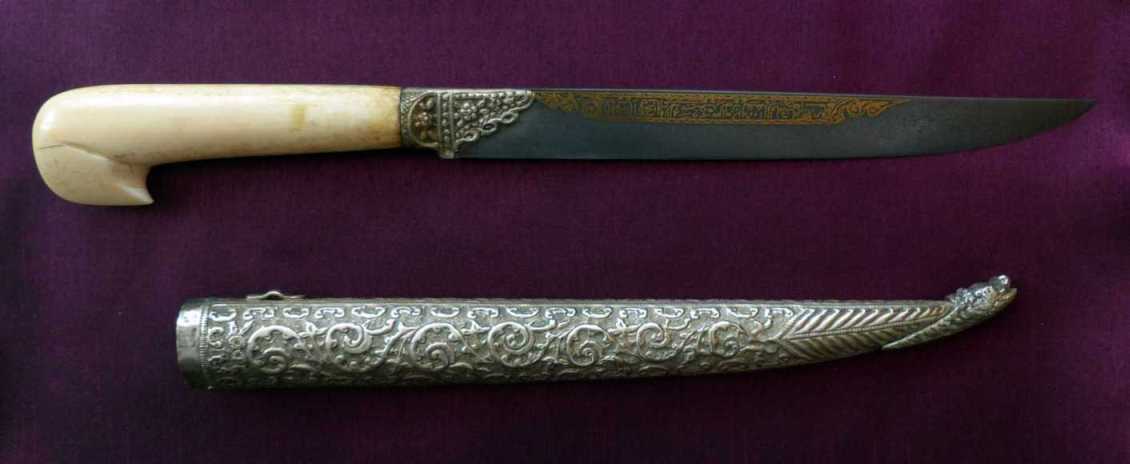

Hello Battara,
I am very interested to learn more about Turkish wootz as I was under the impression that all Turkish wootz blades were actually made in Persia and only finished & mounted in Turkey.
Would the wootz of the Biçak in the photos attached be Turkish wootz?
How do you etch wootz blades?

There was great trade of Persian wootz into Turkey and even into India. Turkish wootz is low contrast, while Persian wootz is known for being a high contrast wootz like what is in this picture. The bichak you have pictured is a lower contrast Turkish wootz.
Rsword and CharlesS can tell you even more about these (as well as Indian) types of wootz.

Might be completely on the wrong track here, but isn't the inscription on the original kard upside down, so as to speak?
Richard
Old 1st April 2016, 03:41 PM   #19
Posts: 7,407
I've noticed that on some bichaqs the inscriptions are written "upside down". I have one also with a jade hilt and wootz with the gold koftgari inscription written the same way.
Interesting isn't it?

PS: I don't really believe that is relevant whether the hilt is Jadeite, Nephrite (these two are known under the generic name of Jade), Serpentine or Onyx as they are very similar and sometimes it is very difficult even for connoisseurs to distinguish them. Yet, for your hilt my bet would be Onyx (it is a Turkish knife and they have some beautiful green Onyx deposits in Central Anatolia).
Just be aware that much of what is called "Jade" is not Jade (namely Jadeite or Nephrite) but Serpentine, Onyx and other similar minerals and sometimes even glass (most of the Chinese "jade" figures you can buy on the net are actually glass).

Here is another small Ottoman kard.

Beautiful! Thank you!
Did you check it for wootz?

Close examination shows no sign of wootz, I have not tried etching but eventually I may try it.
