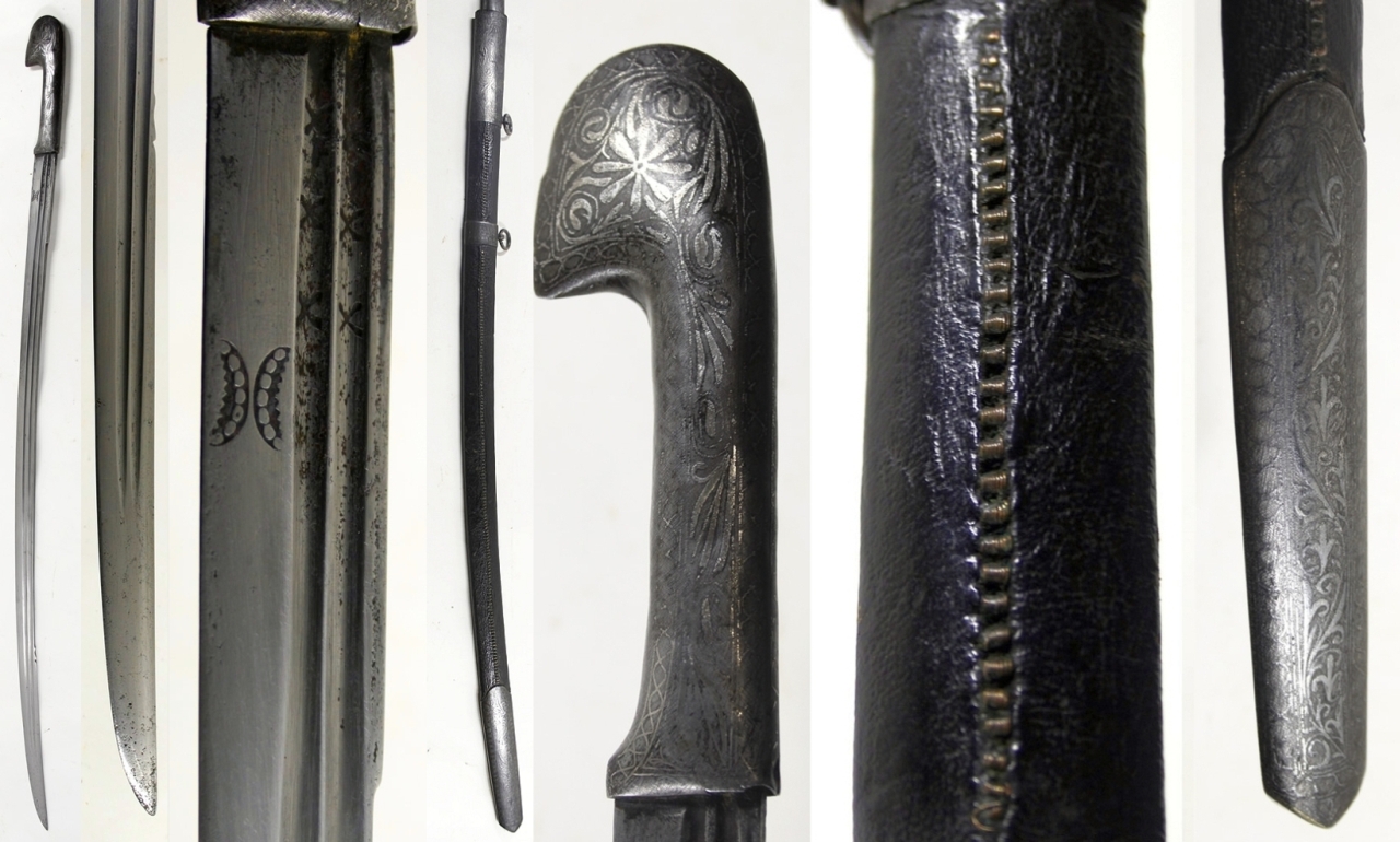

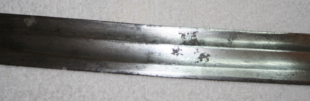

This just arrived. I've had time to measure and photograph it, but not much else. LOA: 40.25", LOB: 35". It is my first Shaska. It is one of the edged weapons on my "must have" list. I took a risk buying it. I don’t know much about these. I do know that you don’t often see them with cross-guards. Or at least I don’t. The hilt is bifurcated and I believe horn, but could also be wood. The blade is stamped on the spine with what looks like a makers mark. It appears to be a “V” and a dot. I keep thinking I see a pattern in the steel, but am not certain. No scabbard. The seller thought it was 19c Ottoman. I'm hoping someone here can help determine it's origin.
All comments welcome and appreciated. TIA!
Harry

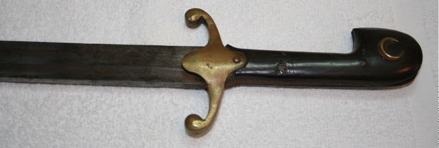

I believe the seller was correct. The guard was taken from a late 19th century Ottoman military pattern, and the crescent on the pommel is certainly consistent with an Ottoman use as well. There seems to have been a lot of variation and leeway in 19th century military patterns in the Empire and it is a topic I am not familiar with at all. There is a book on Ottoman military sword patterns by Branko Bogdanovic, but it is in Russian and not easily available from major online book retailers.

Posts: 10,856
Wow! Harry, good call!!
While of course this is not a 'shashka' per se', It certainly is an anomaly which is likely in the spectrum of variants as Ottoman forces were being 'westernized' as well as the possibility of this being aligned with the Caucasian and Balkan forces of the Ottomans.
The clefted pommel with the characteristic shashka profile as well as the blade, which seems compellingly like East European (often Hungarian) forms which also were often seen on shashkas, suggest possible association in Janissary units (?) or those using Caucasian forces.
As Teodor well notes, the guard, though incongruent, looks like an Ottoman military type.
There have been numbers of these unusual hybrids coming from Ottoman ranks, and one other type I think of is the sabre which for all intents and purposes like a kilij or pala with a stirrup type knuckleguard, and these were 19th century as well.
Excellent example !!!

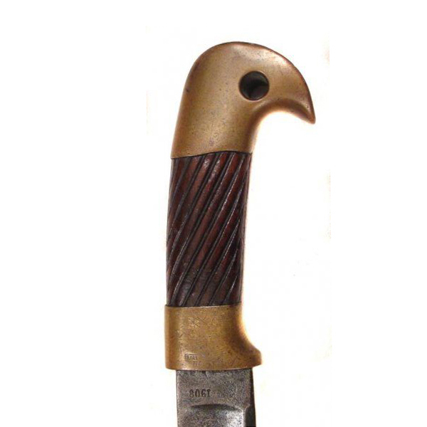

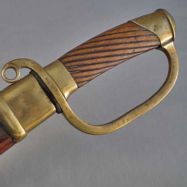

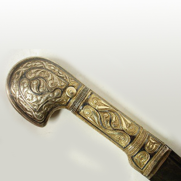

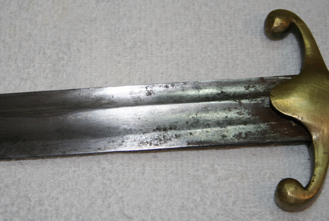

Harry, I was bidding on this one myself, but it got too expensive for me. I was really curious about this one as well and its good that a member of this forum got it so we can discuss it here. For all it's similarities to a Caucasian shashka it was never one. I am basing my opinion on the outer side of the handle: as it can bee seen it has a little bump just before the cross-guard and no shashka Caucasian or Russian has that. This bump is not added, because the blade tang has the same form. In most Caucasian and early Russian shashkas the outer edge of the handle is flat and continues almost seamlessly into the blade. Some of them have a handle that is slightly larger than the blade, but still there are no bumps or protrusions on them. The later Russian and Soviet shashka handles have three parts and put together they are a bit larger than the blade but still follow the same outline. IMHO this sword was thought and made this way and not modified. I think this was an experiment to incorporate a crossguard to a shashka type sword for the protection, as the Russians did with their Dragoon shashkas. Below are the photos of a
1. Caucasian shashka handle (Silver)
2. Russian shashka handle
3. Russian Dragoon shashka handle (with a guard)

Outstanding illustrations (as always) and incredible details.
With these Ottoman scabbards it seems I once knew the terms describing them (the distinct little 'springs' in the gap) but darned if I can find the notes.
It really is interesting to see the kinds of variations in weaponry the diversity of ethnicity in Ottoman forces brought.
Arsendaday,
VERY well observed!! and that did not even register as I viewed these pictures!
That unusual 'flare which sweeps outward to correspond to the guard is also congruent with the tang suggesting of course that the blade and hilt was an intended match, rather than a reworked shashka.
As you have well noted, on Caucasian shashkas this feature of the tang is not really normal.......nor why would it be?
This of course lends to the idea that perhaps this could be a prototype or one off form intended for ethnically oriented units in Ottoman forces, and that would make this a particularly exciting sword .

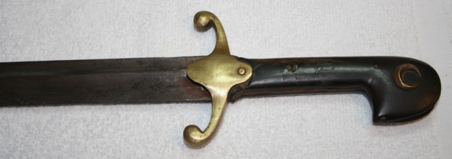

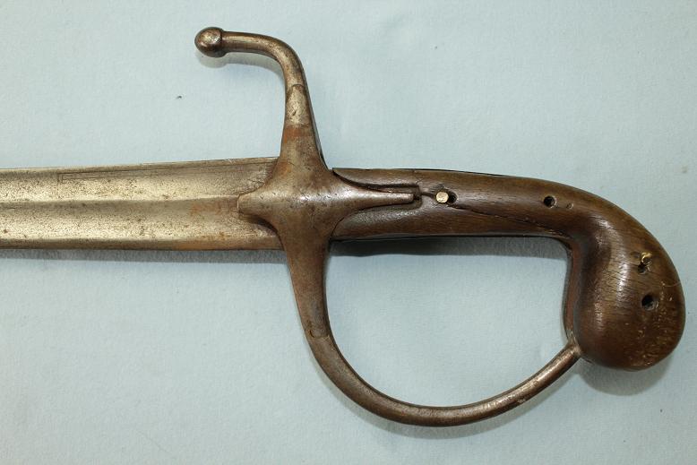

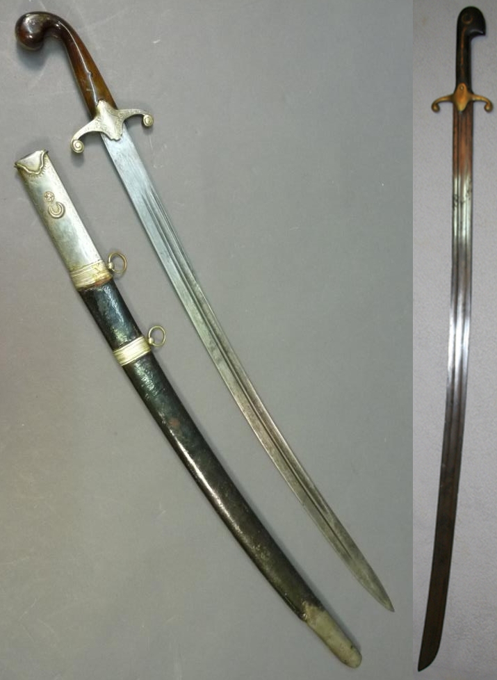

In my post #3, I mentioned unusual sabres with Ottoman grips which had a European style guard and knucklebow, which seemed pertinent here as we consider these rather hybridized forms. This one Gav had some time ago and the photo is of this form. It seems to have had Hungarian associations as well of course as Ottoman influence, and I wonder if perhaps these might have been involved with Ottoman forces, perhaps in Balkans .
There is a sabre with the pistol grip hilt and crossguard with elliptical langet/quillon block with alternating quillons but no knuckleguard which is attributed (noted probably in reference) to Hungarian light cavalry early 19th to mid. ("Edged Weapons: Sabers of the Habsburg Empire 16th-2th c" Konopisky& Moudry, 1991, Prague, pp.68-69), but this only suggests that pistol grip hilts were not unknown in Hungarian context
Returning to the 'shashka' type example in discussion, it is tempting to suggest the cleft may be related to Ottoman yataghans, but the hilt and cleft features are more of Caucasian shashka style.
It seems quite possible for this example attached here to possibly be aligned with Ottoman presence in Balkans (the blade here has the familiar sun and moon inscribed as on Hungarian forms).
With the wide influences of the Ottoman Empire diffused through these many countries and regions it is a challenge to determine just what classification to set on these hybrids.
* Gavin Nugent photo

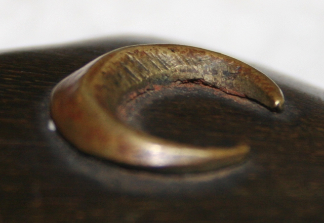

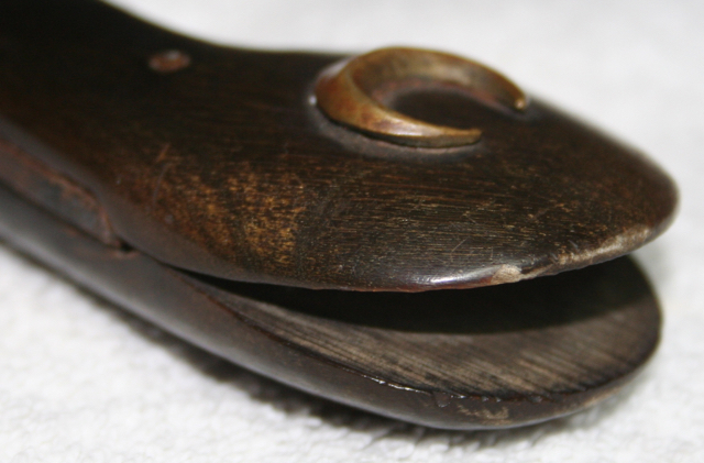

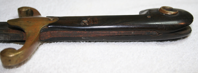

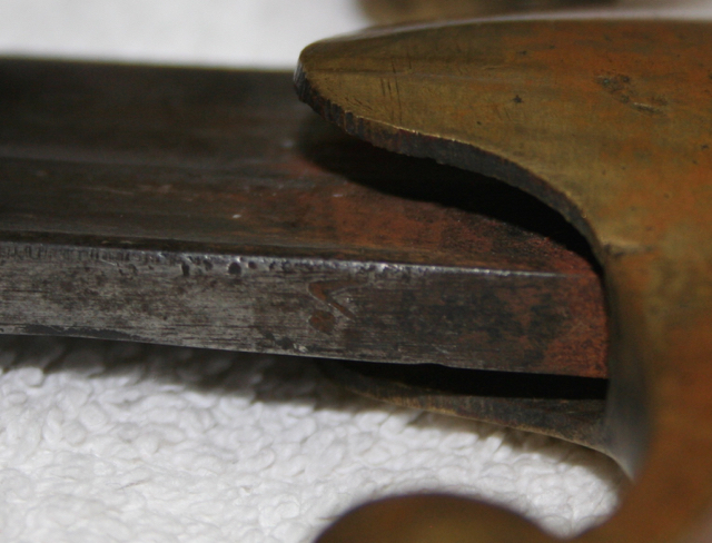

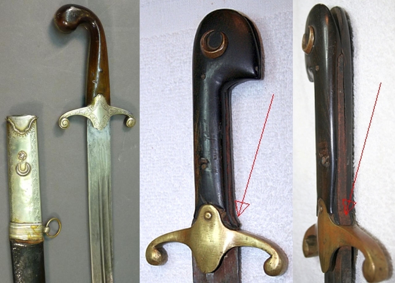

I have placed red arrows showing the area I think you are talking about. You made an astute observasion. So the question is...would you still consider this to be a shashka? There are several thoughts on how this sword ended up being created, an Ottoman sword maker creating a shashka for Circassian troops but adding an Ottoman embelishment is one way I can think of. The other is that this was a kilij that was altered with the addition of a shashka hilt.

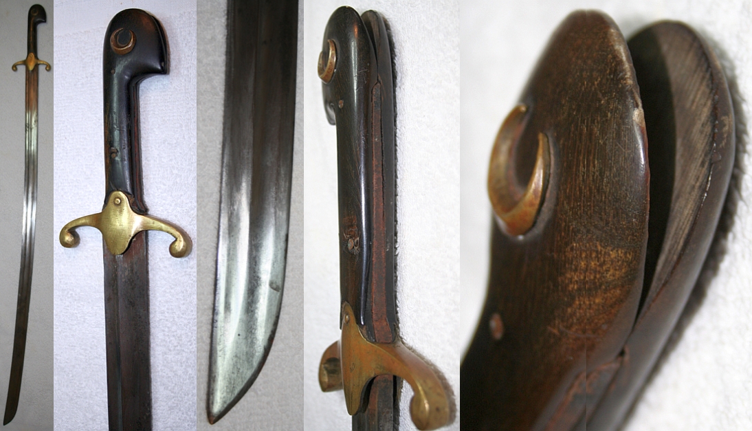

That is exactly what I meant. BTW Your second guess is more possible. The Circassians were a stubborn bunch (no offence meant, using the word as a compliment) and I don't think any one of them would agree to have "Shashka" with a guard. And the blade, despite of all it's similarities to a shashka blade is different nonetheless. Since I think that this blade was initially meant to have a crossguard (not sure about the hilt) one had to order it made this way. And for sure that ONE wasn't a Circassian. (After all only a shashka is a shashka, and everything else is not)
If this is not an experimental weapon altogether, than I think the handle/hilt is a later addition. One of the reasons it could have happened, as you said, the original (kilij type) handle broke and since the smith, who was fixing the sword (not necessarily the one that made it initially), did not have enough tang to put a kilij handle, just replaced the handle and put something that would work just as fine with a shorter tang.
P.S. The reason I think that the handle/hilt has been replaced, is quality of the crescents on it. They differ a lot from the quality of the workmanship of the cross-guard. I think the original handle had crescents on it, which were lost as well, and that the (new)owner just wanted to have them.
arsendaday is offline   Reply With Quote

Conversely, in this conundrum, are the number of kilij (pistol grip Ottoman style) swords which have the crossguard removed, and seem to have been worn or used in this way. I cannot offhand recall the dates, but we have discussed them here, and I think some have been seen in references.
Old 6th March 2016, 08:17 AM   #25
estcrh
estcrh's Avatar
Join Date: Jun 2012
Location: USA
Posts: 1,492
Jim, is this what you were referring to?
Old 6th March 2016, 04:25 PM   #26
Posts: 10,856
Yes!!! ) Well done!
While some of these are the intended form as in the Indian short sword and dagger hilts, some of these seem to be Ottoman hilts sans guard, and left that way by intention.
Thank you so much.
Your skills at finding these illustrations are uncanny, and superb
