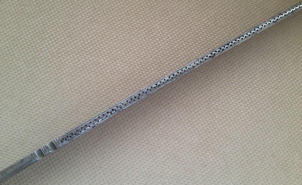

Default Dagger from Crete (?) - for comment +translation plea

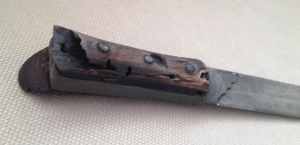

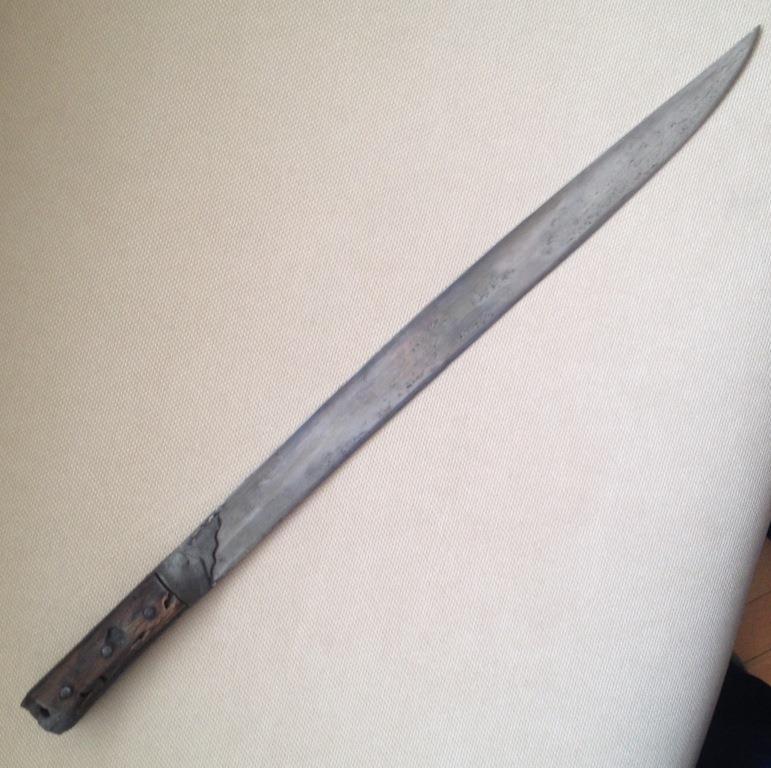

I would appreciate any comments - this kind of daggers was not/is not my field.
The dagger is 57 cms long now (the tip was broken and I adjusted it). The pictures are from the middle of restoring process, the blede was extremly rusty (I also used tanin). The blade is made of laminated steel, nicely springy.
I think it comes from Crtete, but I did not see so long Crete knife till now (but I do not have literature about such weapons).

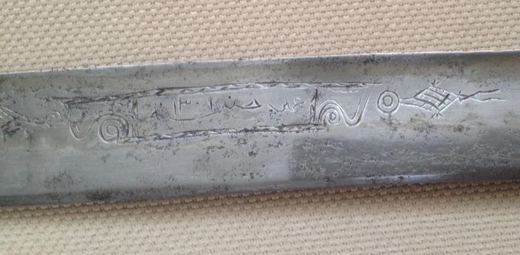

Any idea about the text on the blade ?
Thanks,
Martin

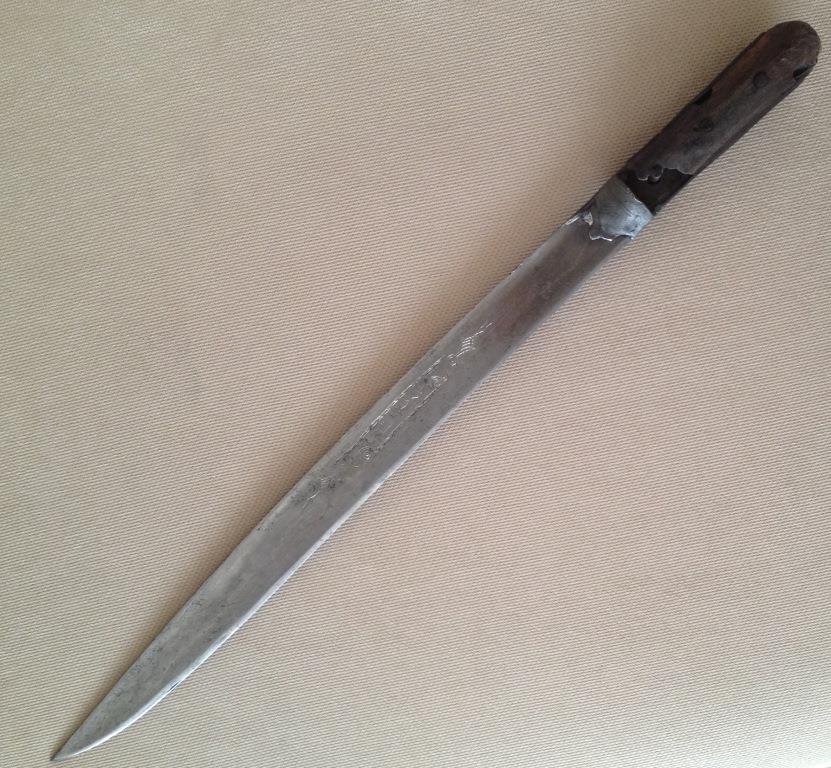

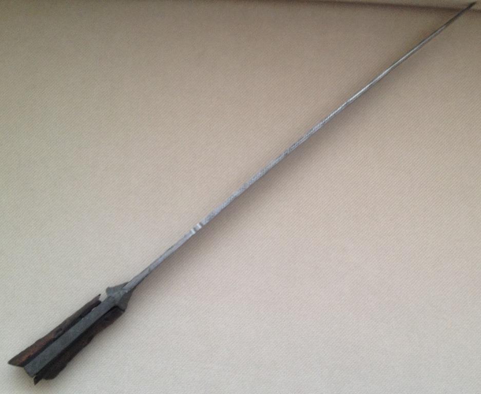

Default Dagger from Crete (?) - for comment +translation plea II
just addtinional picture

addtitional info:
Original length could be cca 63 cms, collar on the blade is made of lead

Martin,
Cretan daggers that I know always have a specific engraved ornament ( large, convoluted, floral) and are signed in Greek. This one has neither. It seems to me that there is a date, 1301(????), that would not be consistent with the already independent Greece. Also, it is yataghan-ish.
I would guess it is a Turkish or Balkan Muslim yataghan bichaq.
Having cleaned it up, you might consider stopping with further restoration efforts. IMHO.

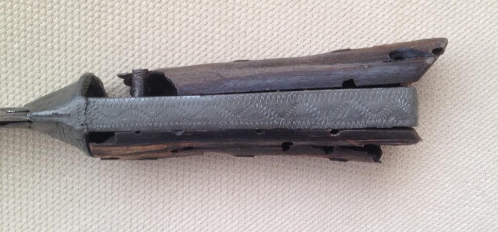

Posts: 1,242
Interesting.
The scracthes on the blade a re very crude imitation of the usual yataghan inscriptions. The blade profile is very similar to the Ahmed Tekelu yataghans
http://vikingsword.com/vb/showthread.php?t=2072
The punch work on the spine is similar to what is seen on Laz bicagi / Black Sea Yataghan. Considering the population exchanges with Cretan populations and the Pontic region, this might explain the Cretan connection.

Islamic 1301 is equal 1884 Gregorian. That time Crete was under the Ottoman Empiry (I apologize if I am wrong). I think that determinant for the place of use is the style of the handle (more or less generally). Could it be, that it was produced by Turkish artisan in Crete ? (I think there is written Ali on the blade, but this still nobody confirmed ...)
Salaams Martin Lubojacky It appears to say.. Ali Hussain...and then the date...
Ibrahiim al Balooshi.

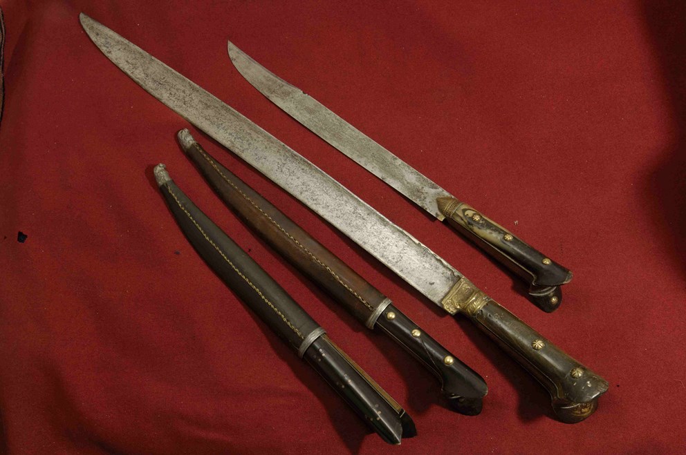

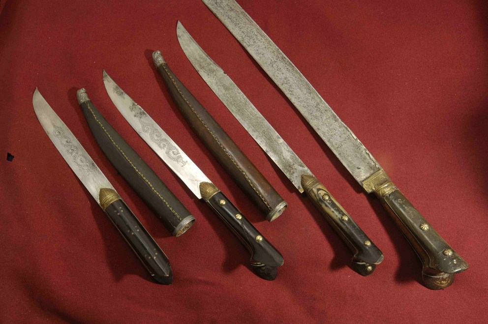

Ariel mainly is the shape of the handle as you see it in this photo
Old 29th February 2016, 11:30 PM   #17
eftihis
eftihis's Avatar
Location: Chania Crete Greece
Posts: 517
But have in mind that cretan artisans made various types of blades. These 4 are from the same artisan.

Dear Ibrahiim,
I just consulted with expert on osmanlı writing. He said there was written "Osman Han" (which is the name) on the blade ...
Martin
Old 9th March 2016, 08:27 AM   #19
Ibrahiim al Balooshi's Avatar
Join Date: Jul 2006
Posts: 4,408
Dear Ibrahiim,
Martin
Salaams Martin Lubojacky... It is arabic and its says Ali Hassan or ali Hussain and it is dated ...Under the date it says sennah or year and above that line is the date 1301.
Old 9th March 2016, 09:22 AM   #20
Martin Lubojacky
Join Date: May 2008
Location: Czech Republic
Posts: 862
Thank you once more Ibrahiim al Balooshi
