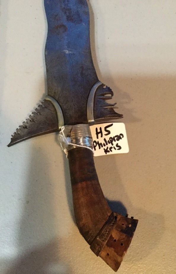

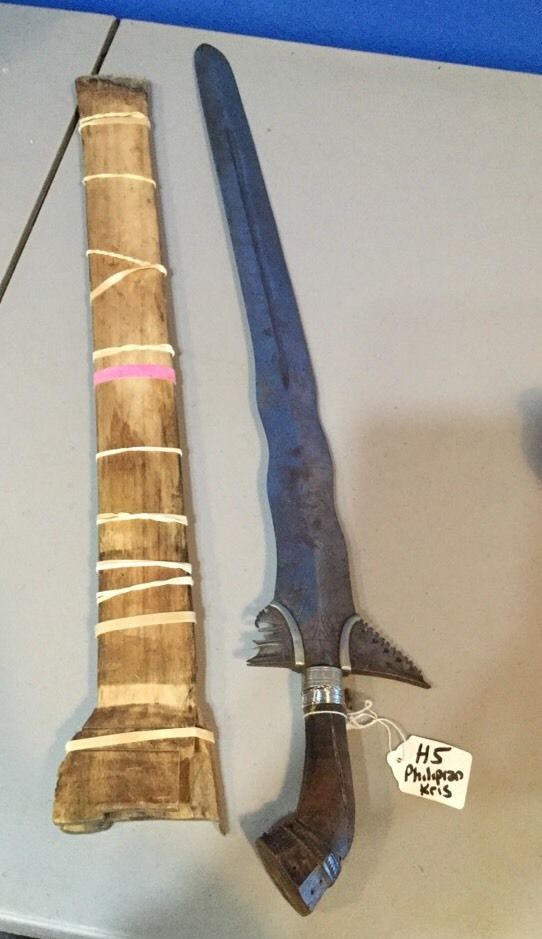

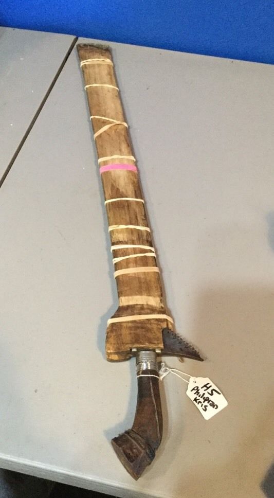

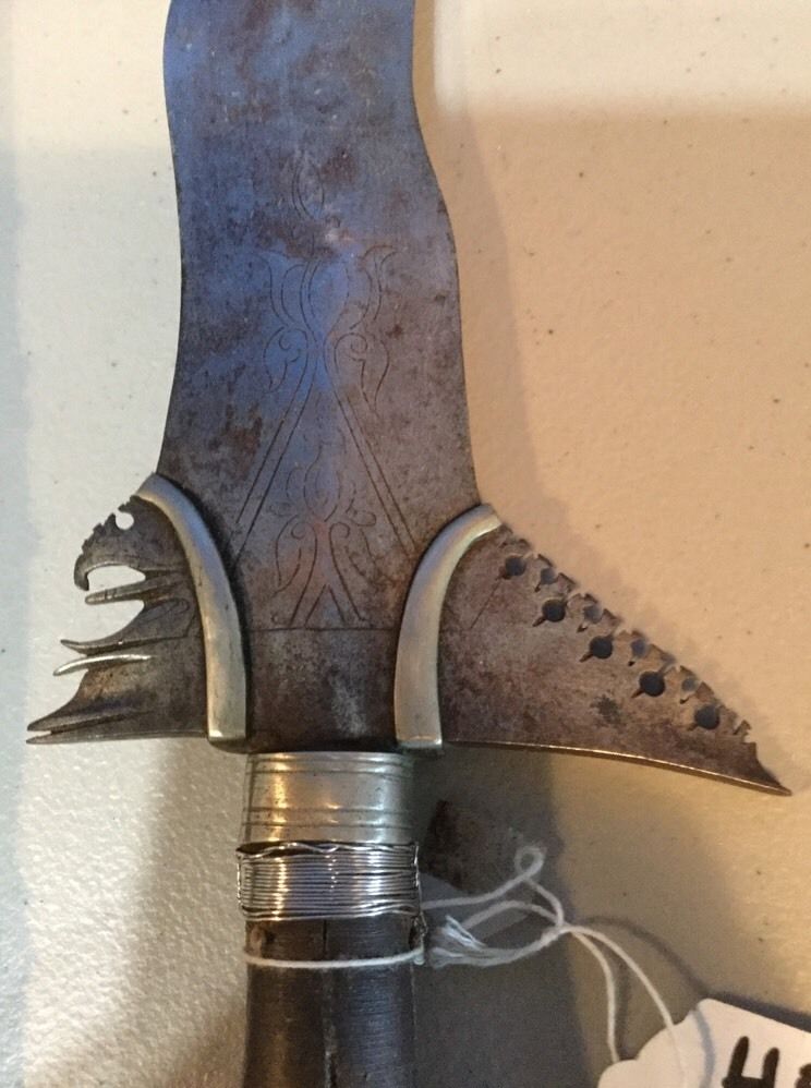

Hello this is my first Kris, as I was told an old Philippine Moro Kris. I would like to hear some opinions from the experts about this piece. Thanks in advance.
P.S. I bought three more krises recently and I will post some photos as soon as I receive them.

WELCOME TO THE MORO KRIS COLLECTING GROUP. YOU HAVE A NICE KRIS FOR A FIRST ONE. IT HAS WHAT WE REFER TO AS THE HORSE HOOF STYLE POMMEL WHICH WOULD HAVE HAD MOTHER OF PEARL SECTIONS WITH DESIGNS ATTACHED. THE PEGS APPEAR TO BE THERE BUT THE PEARL SHELL IS MISSING. THE BLADE IS OF THE PART STRAIGHT AND PART WAVY FORM WITH UNUSUAL DESIGN CUT INTO THE BLADE. SOME OF THE MORE KNOWLEDGEABLE MEMBERS WILL BE ABLE TO FILL IN A BIT MORE INFORMATION.

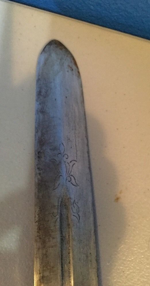

Old 26th February 2016, 12:16 AM   #4
Posts: 7,415

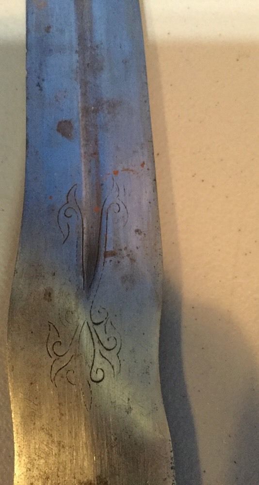

This kris looks like it may be from the Maguindanao region and was made at a later date, perhaps the 1960s?
The ganga line is engraved and is not separate - meaning that it is not from the turn of the 20th century or earlier.

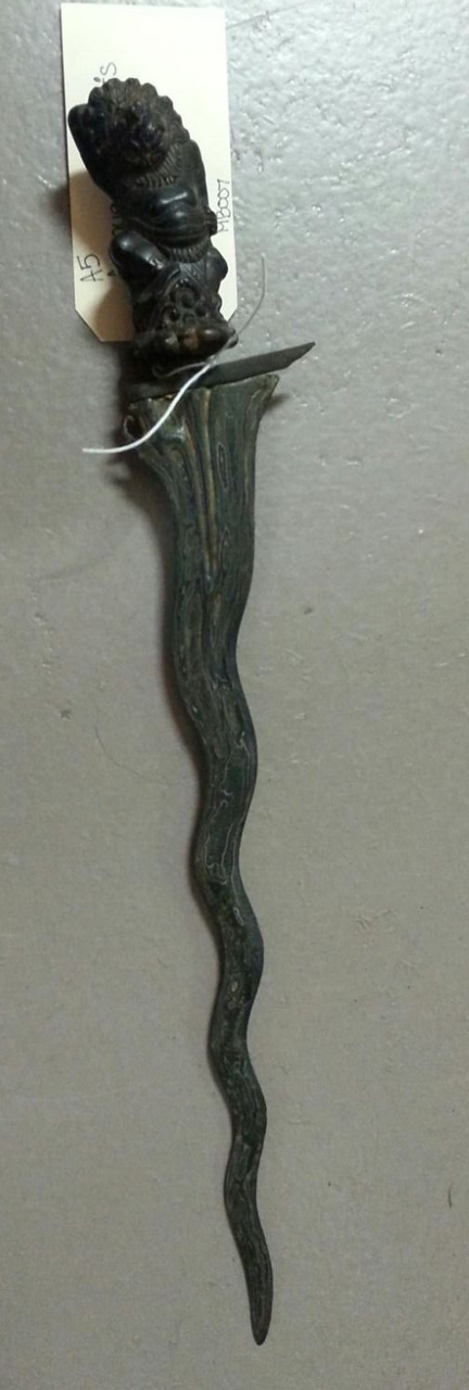

Default The rest of Them

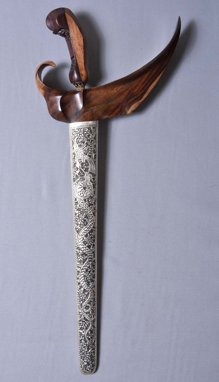

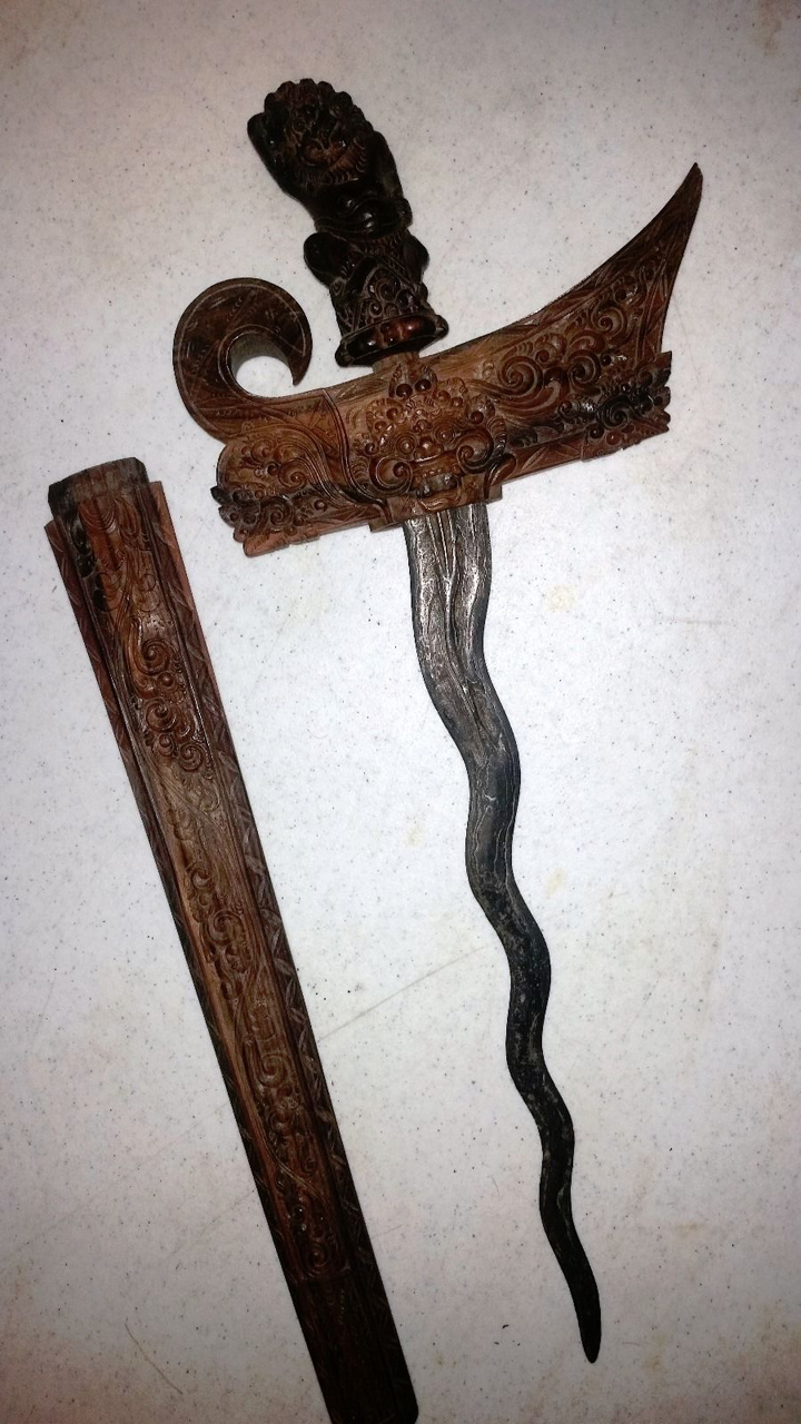

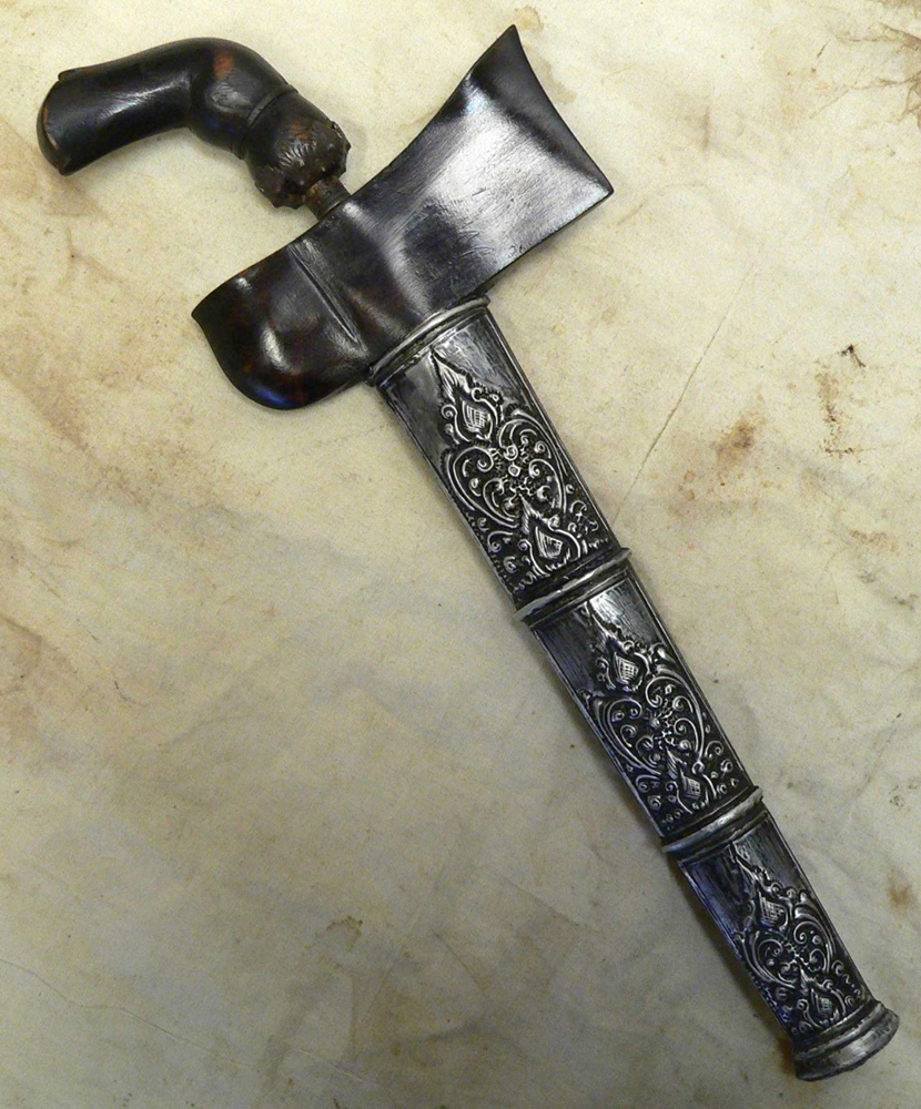

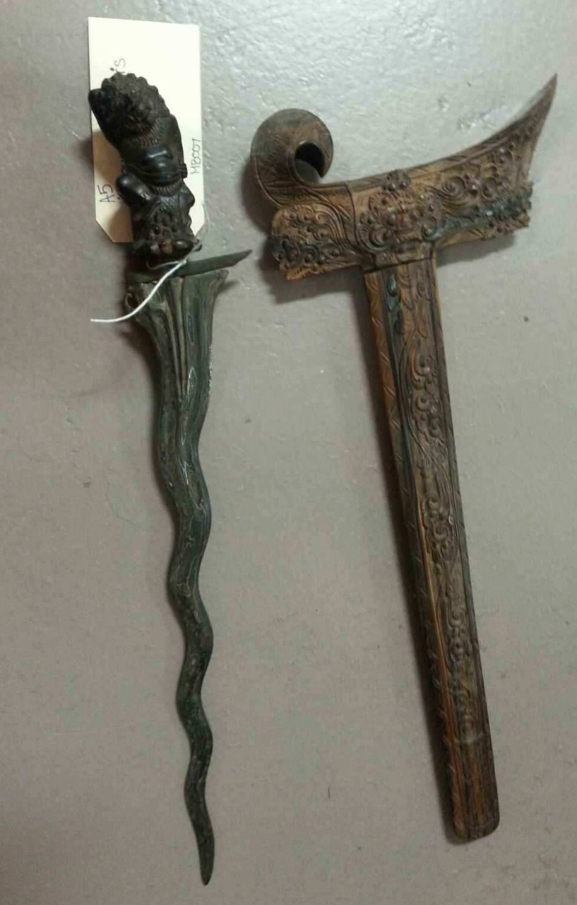

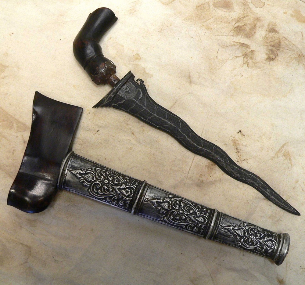

Here are all my krises. One is an old Bali one, the others are new from Sumatra and Jawa, as I am told.

You have to differentiate between the short sword KRIS sundang from the Philippines, and the KERIS dagger from the Indonesian archipelago. Your first piece is a KRIS. Your other 4 are KERIS. The Balinese one actually doesn't looka that old.
The KRIS sword blades should not take a set, while the KERIS daggers might, as they're lower carbon-content and softer.

You will remember that i originally shifted this thread to the Ethno forum because the kris you posted was not an Indonesian/Malay keris. Well, now you are posting Indonesian keris and these need to be discussed on the keris forum, not here.
While this two weapons have an overall similar form (the Indonesian keris being the ancestor to later development of Moro kris/kalis forms) they are from different cultures and operate differently as weapons (stabbing vs. slashing). If you want to talk about these Indonesian keris please post them on the Keris Forum.
While keris are usually hardened (some more recent ones perhaps not), they are more likely to be softer (lower carbon) than their Moro cousins. But honestly you baffle me a bit here. Why on earth would you want to bend an the blade risking irrevocable damage and possibly breaking these blades? I am afraid i just don't understand that.
Old 1st March 2016, 08:11 PM   #15
Posts: 7,302
Emanuel, the "Bali" keris posted here is probably the oldest of the lot and in fact seems to have some considerable age. The dress for it is late 20th century, but the blade is fairly old and looks to be to perhaps be of Javanese origin.

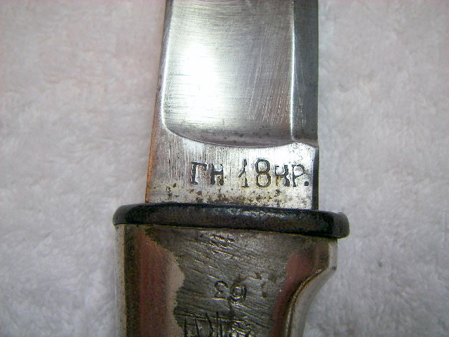

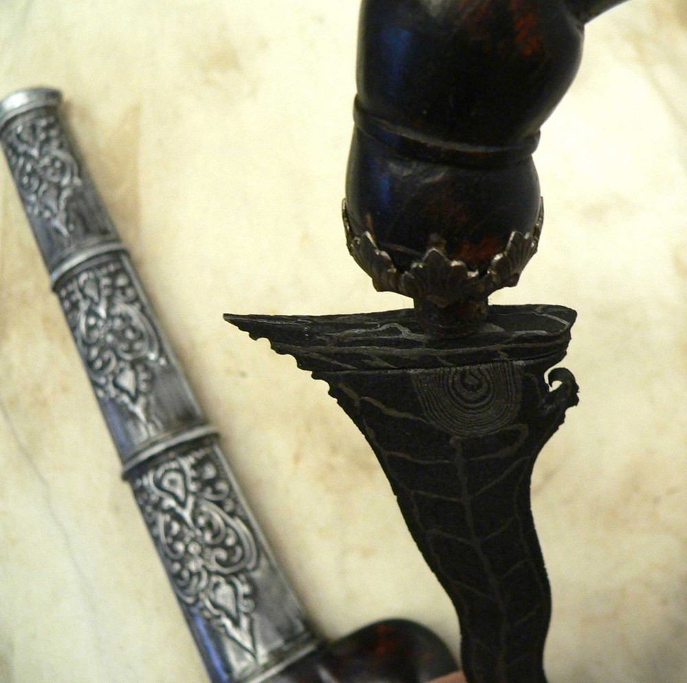

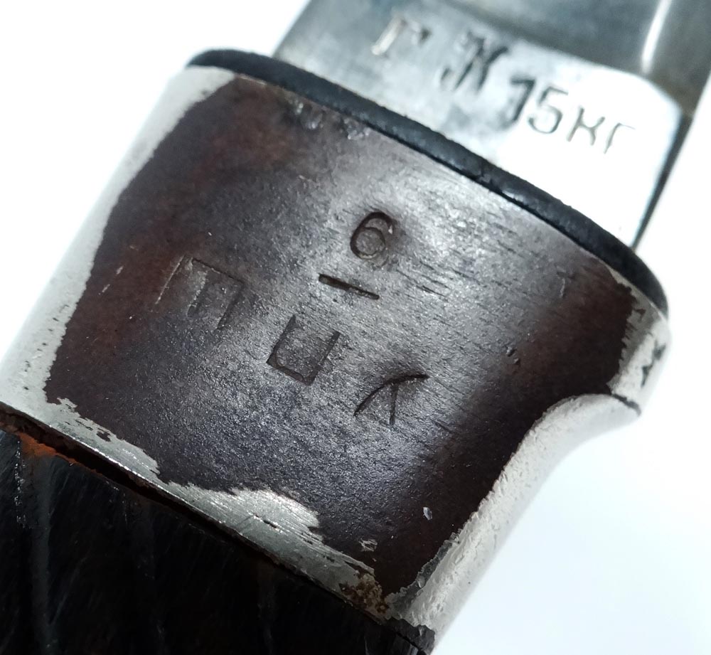

P.S. Here are some photos of the markings that I was talking about. The first one is a real mark of a 1927 NKVD Shaska, while the second is a fake Shashka with a wrong mark, because it reads 18KP which doesn't make any sense.

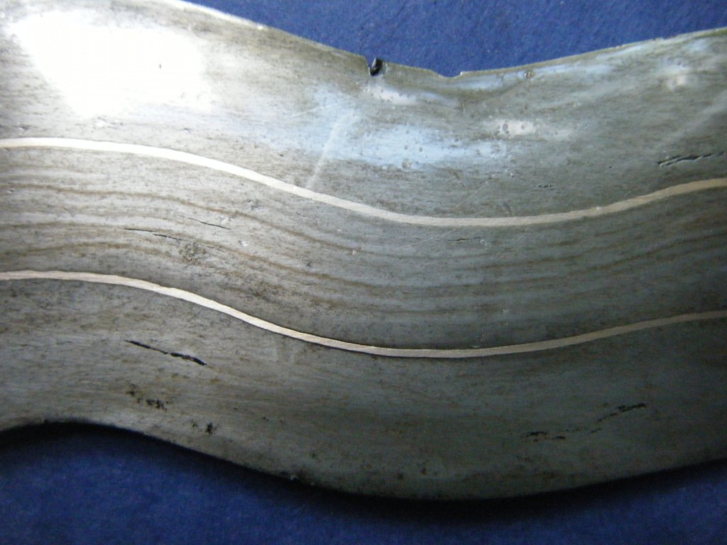

Originally Posted by Battara
Moro kris were more slashing weapons and not stabbers.
Arsendaday,
agree with Battara, here is a close-up picture kris from a kris of my collection which has seen serious fights, the edges have a lot of nicks as sign of this.
