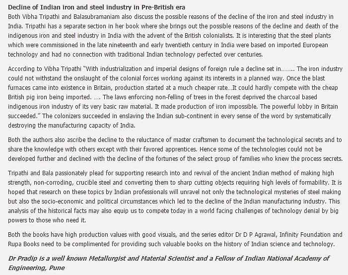

Here is an interesting essay, from what I have previously read and am reading now, it seems as though the real center of wootz steel production was in India. While blades may have been made in Persia/Syria it does not look like the raw materials were produced in these countries. The steel was produced in India and traded to sword making centers in other countries.
When Europeans recognized the superiority of Indian steel making technology they went about trying to creat a way to mass produce the same type of steel made in Indian so they could bypass the Indians. Many years of research into making high quality of steel by the Europeans eventually led to the modern steel making process that was directly responsible for the decline of traditional Indian steel manufacture.
Between the British desire to subvert the Indian steel makers and the now abundant supply of much cheaper European steel the Indian steel makers simply could not survive. The decline seems to be in the early mid to late 1800s.
http://www.ghadar.in/gjh_html/?q=con...eel-metallurgy
estcrh, thank you for an interesting essay!
But here again just what think our contemporaries....
Strange situation. Bulat ( wootz) in India disappears. However, none of the Indian researchers (and we know that the British researchers had enough) does not noted this fact. But it does not bother anyone. And we are from the standpoint of modern man argue that wootz disappeared in the middle of the 19th century. But at the same time using only circumstantial evidence
Guys do not you think that this is not scientific?
mahratt is offline
Old 5th February 2016, 05:49 AM   #20
estcrh
estcrh's Avatar
Join Date: Jun 2012
Location: USA
Posts: 1,492
The authors from the essay I posted are both Indian, or am I not understanding you?

Posts: 1,042
• Marvels of Indian Iron through the Ages by R. Balasubramanian (2008)
• History of Iron Technology in India – From Beginning to Premodern Times by Vibha Tripathi (2008)
estcrh, thanks again for article links. Maybe I was not very attentive. But I did not see in these articles to their authors appealed to the documents of the 19th century ... I always thought (although maybe I'm wrong) that the difference between the popular and the scientific article is just that in the scientific article, the author not only express their thoughts (referring to the well-known historical facts and drawing conclusions on the basis of their), but also provides links to documents of the time of which he writes (19th century in our case). If the references to historical documents (studies, books, articles) - no, the article is different from our conversations here in the forum only because it someone has published in some magazine
We all know the book by Lord Egerton. He started collecting Arms and Armor in 1855. A book was published in 1896. Maybe I did not read his book carefully ... then please correct me. Is Egerton writes in his book that the wootz in India in 19th century stopped producing?
Or is there someone else from scientists in India in the 19th century, who wrote this?

OFTEN THOSE WHO FORGED STEEL WERE VERY SECRETIVE AND GUARDED THEIR KNOWLEDGE AND TECHNIQUES VERY CLOSELY. ONLY A TRUSTED APPRENTICE WOULD IN TIME BE TAUGHT AND THOUGH FOREIGNERS AND OUTSIDERS OFTEN TRIED THEY FOUND THE SECRETS OFTEN COULD NOT BE BOUGHT. WHEN THE WEALTHY STOPPED BUYING FOR THEMSELVES AND THEIR ARMORY'S.
DEMAND AND PROFIT DIMINISHED AND GOOD APPRENTICES COULD NOT BE EASILY FOUND. SO THE MASTERS OFTEN TOOK THEIR SECRETS TO THE GRAVE WITH THEM. IT HAS HAPPENED IN MANY FIELDS NOT JUST SWORD MAKING. THIS IS A POSSIBLE EXPLANATION BECAUSE MAN'S LIFE SPAN IS SHORT AND MANY WOULD RATHER TAKE THEIR SKILLS AND KNOWLEDGE TO THE GRAVE THAN TO PASS THEM ON.
VANDOO, secrets - it is always interesting and exciting. This creates a certain mystical aura. (By the way, that is what I love the movie "X-Files")
But let's look at the facts. And the facts are that even now in the 21st century, we see a large number of wootz items (swords, swords, daggers, knives and spears). If you count all wootz items in our collections,how many items we get? A few thousand? In addition, several thousand in private collections in Russia. More thousands wootz items in museums in the world. Do not you think that is too many items to talk about some secrets?

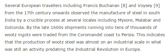

Thank you, estcrh. This only confirms my words that wootz steel production was not such a great secret.
It is interesting, how could you have so many steel manufacturers making a product for so long and yet people were said to be scurrying everywere to find out how exactly it was made.....and then the method was seemingly lost?????
estcrh is offline

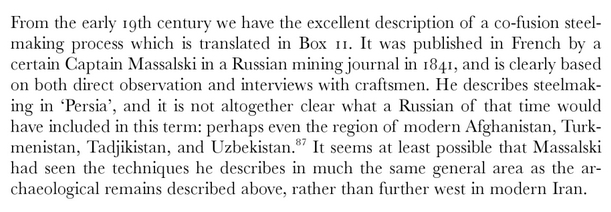

My friend, this is an error - assume that Anosov sought "secret of wootz", traveling to India or Persia. Anosov was - researcher. Anosov studied samples of wootz steel samples which were brought from India, Persia and Central Asia for him. And on the basis of the studied samples of wootz, he developed his own method of smelting wootz steel.
Moreover, note that Ariel wrote:
Originally Posted by ariel
... in 1841 captain Massalski published full description of the process he observed in "Persia" ...
It says that in 1841 continued to produce wootz and it was not kept secret.
There are records of many people besides Anosov that were seeking methods of steel manufacture in Indian and elsewere, as for captain Massalski, what exactly did he see/report and were did he see it, was he talking about wootz steel or another type of steel.
Science and Civilisation in China: Vol. 5, Chemistry and chemical technology ; Pt. 11, Ferrous metallurgy, Volume 5; Volume 11, by Joseph Needham, 2008.

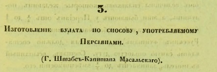

The captain Masalsky writes about of Bulat (wootz) steel smelting. And the smelting of wootz steel exactly the Persians.
I do not know that someone wrote in 2008 Article Masalsky published in 1841:
