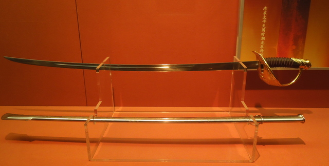

The sword below is a modern parade sword, but it aroused my interest and inspired the above question as it was specifically made for a woman's army unit.
Unusual enough in modern times but very unlikely that there were historical examples so I'm thinking more of personal protection - concealed knives, augmented jewelry perhaps. Any suggestions?

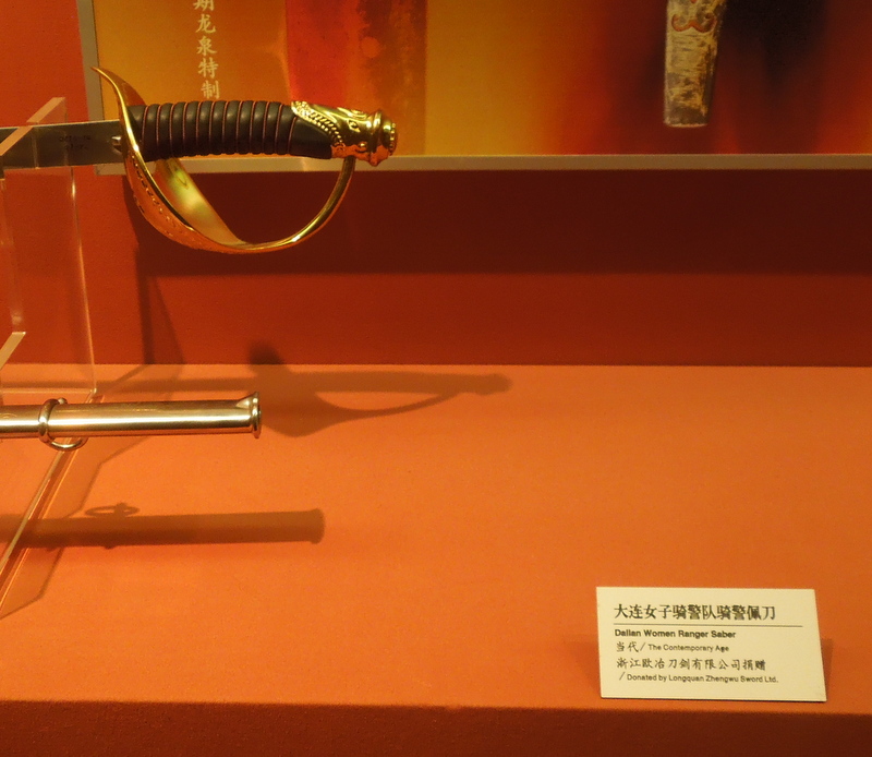

It looks like, CC that, the sabre in exhibition is not different than that for a man. What distinguishes it would be the fact that it was made to equip a women's army, but not a sword with women's specifications. Am i right ?
Also according to Roland's link the tendence for women performing battle actions would not imply in using female weapons, although on the other habd and as Rich says, some models were designed specificaly for women.

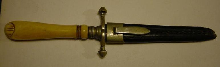

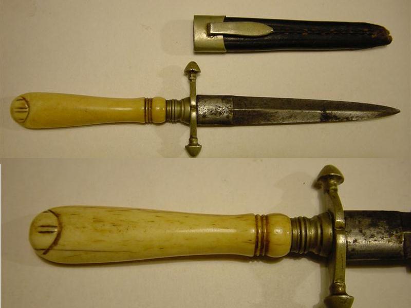

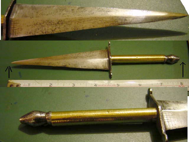

And you have one other area, that of weapons not specificaly designed but still preferred by women, those for protection as you well suggest; the favorite one being the dagger, easy to conceal inside the bodice or tied to the leg under the dress; or even inside the boot.
Amazing the name that the French gave to these weapons: dague de pute (whore's dagger).
The examples attached don't have to historicaly be woman's daggers but, that's how they were.

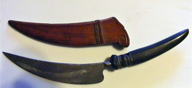

In Sumatra, the siraui is easily concealed in the hair of women or folds of clothing. It is both a working knife and a self defense weapon. I do not think it is specific for women; merely one that is preferred.
Old 25th November 2015, 07:17 PM   #23
Hello Dave,
the shown knife isn't a siraui, we still look for the correct name of this knives. For a real siraui look here: http://www.vikingsword.com/vb/showth...ghlight=siraui
