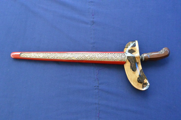

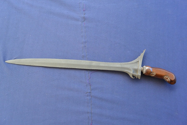

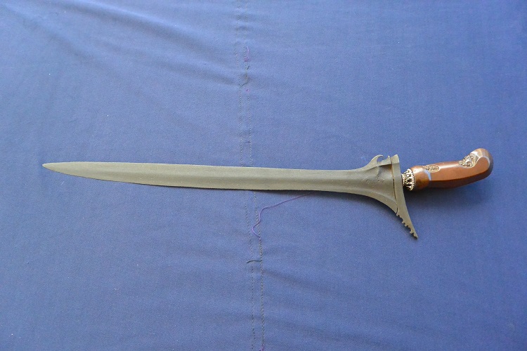

i buy this keris a fuw days ago the pamor is kelengan ho can help me with the dapur
thanks semar

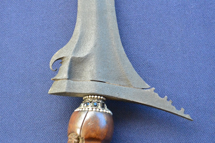

Hello Semar,
As far as I can see the ricikan include an ada-ada, kembang kacang, jalen, lambe gajah, pejetan, sraweyan, and greneng. According to the EK the dapur should be Kanda Basuki but with ada-ada as exception. No similar dapur is shown in the reference book "Dhapur".
Any idea about the estimated age or maker of this blade?

Hello Semar,
Yes, it looks in Mataram style indeed and the greneng is worn-out so it should have age.
