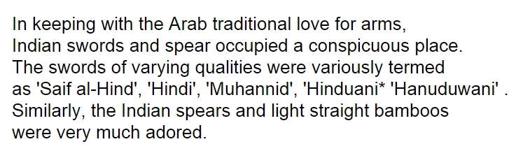

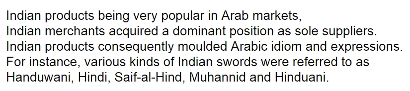

Originally Posted by AJ1356
So historically in the Persian and Arabic world, what I think might have been early forms of wootz swords were called shamshir e Hindi or saif e Hindi, meaning Indian sword or sword from India.
While I have not seen "saif e hindi", I have seen "saif-al-hind" mentioned as the Arabic term for Indian swords.
Cultural Forum, Volume 8, Special Number On Mussology, India, Ministry Of Education. (left quote)
Sind Quarterly, Volume 10, Mazhar Yusuf, 1982.(right quote)

Jens, for you.
