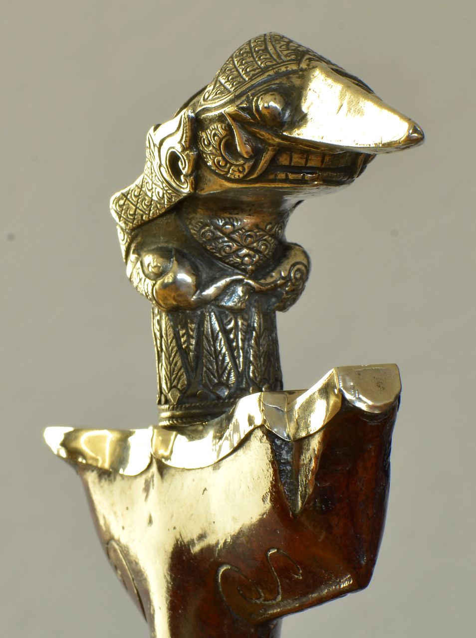

Hello all,
Here is another member of my Keris family.
Recently acquired and after some hours of gently removing the thick black patina a high quality figure appeared.

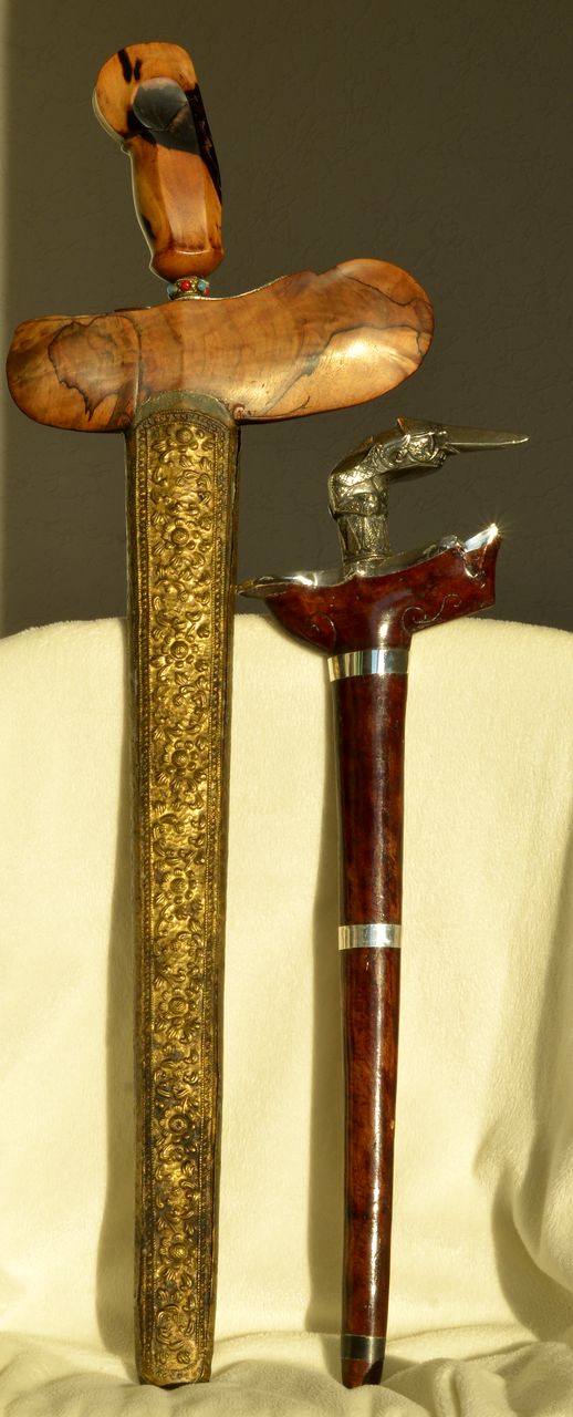

I added one picture together with a beautiful Bali Keris to demonstrate, how small the Coteng is.

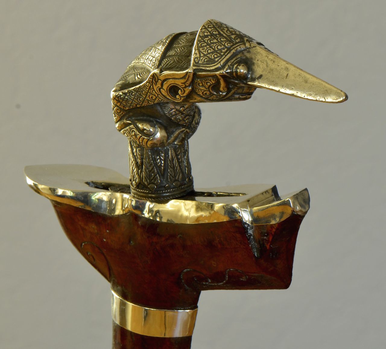

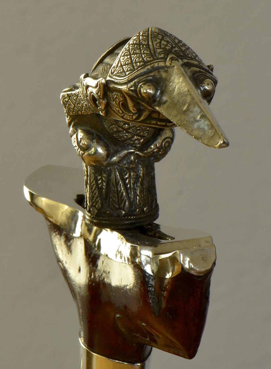

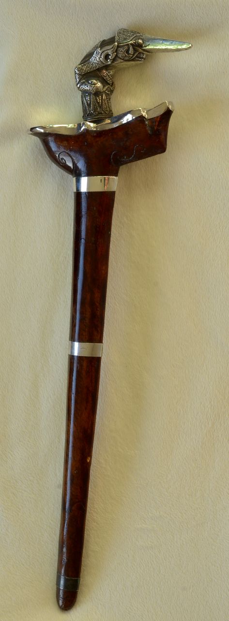

Parts of the figure and scabbard are obviously non original. The lower part of the figure and the silver on the mouth of the warangka (with a thick black patina) are result of a very old restoration. I believe, this is a European restoration from the 19th ct. or earlier and the maker had no idea and no model, so we probably see a very well made European interpretation of a Keris. This increases the historical value of this Keris for me.

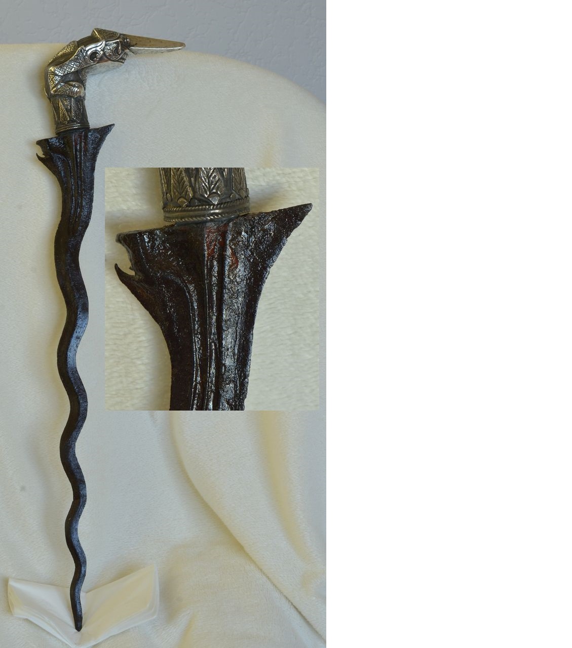

The blade is another very exciting part of this Keris, it is obviously very old, the Ganja is lost. Despite the fact it is a quite thick blade, the opposite side of the Gandik is thin like paper and rusted through.
This blade furthermore have 3D waves, they are bended also in the z-direction, similar to a Keris Pejetan.
I have problems to count the number of luk on this Keris, I count 10 luk, which must be wrong. Which number is correct, 9 or 11? Or is it an extremely old blade with an even number of luk?
I would be happy, to see some comments, especially to my theory about the restoration and the blade itself.
Thank you for reading; I hope it was not too boring and many thanks for every comment.

To me this blade clearly has 11 luks (the tip is worn-out) and it looks javanese, may be in Pengging style because of the deep luks. It is a pity that the ganja is missing!

I suppose the hilt repair is done locally.
The Sogokan are a bit long for a Javanese blade.
Nice hilt, even with a repair.

A very nice silver coteng hilt. The sheath repair is well done, but i really couldn't comment as to whether or not it was a local or European repair. Not exactly a "restoration" as missing pieces of the sheath have not been restored, but it has a nice quality look over all.
It is a shame about the missing gonjo. I personally have a hard time getting too excited about incomplete blades. You might be able to commission a replacement if the keris is an important one for you.
On luks i would count this as 11. The tip had obviously suffered some erosion to account for the confusion on your count.
I am afraid i don't understand what you mean by your comparison to Keris Pejetan. I see nothing in your blade from these photographs that looks like impressed fingertips.

And a very good observation from Gustav, the blade don't need to be a Java blade, it look more like an old Palembang blade IMVHO. To bad that the gonjo is missing.
David, I think that Roland mean with the comparison to pejetan that the blade has a sinus like wave along the length, I have seen this before and think that there is name also for a blade like this.

In respect of blade origin:- I can see nothing in this blade that would militate against a Javanese origin. True, the sogokan are a little longer than usual for Jawa, but I have seen innumerable examples of variation from the norm in Javanese blades, and Balinese also, for that matter, not only in sogokan, but in all possible ways. Personally, I'd be happy to accept this as Javanese until it could be shown to be other than that.

Thanks for all the comments. Detlef (sajen) explained very well what I tried to say with "curved in z-direction".
There are 11 luk, thanks.
I investigated the blade with a microscope and it is very deeply corroded but the tip itself seems to have its original length. Hard to judge.
I will leave the blade as it is, it is too late for a repolishing.
My guess about the European restoration is because I believe, a silversmith in Indonesia knows how a Keris Coteng must look. Whatever, it is a felicitous restoration in my eyes.

The sheath here was obviously damaged and is missing parts of the original wood. I don't believe that an Indonesian silversmith would have been capable of making a repair that returned this sheath to its original and intended shape as a coteng sheath. So i'm not convinced that is evidence of where this repair was actually done. It could still be Indonesian work as easily as European IMO. In most cases, if the owner of this keris had the money, a new sheath would have been commissioned. It this case it would seem they did not.

My simple opinion is, that the blade is older than the hilt and sheath. The blade fits very exactly in the sheath, so I think it could be the original blade for this Coteng.

"In most cases, if the owner of this keris had the money, a new sheath would have been commissioned. It this case it would seem they did not. "
David, this makes sense.
But the quality of the silver work is on a high level, I almost think, a new sheath would be cheaper than such a silverwork.
The upper ring was lost, I gave the sheath to a jeweller and he took ~75$ for only one silver ring.
All I can say for sure is that it is a quite old restoration because of the thick black patina, the surface of the silver is full of tiny pitting.

Some additional pictures of the blade.
I think the curvature in both directions is good to see.

Thanks for the extra photos Roland. I can see now what you mean about it looking like a pejetan blade. This doesn't seem to me to be the type of blade that would get a pejetan treatment. For instance i have never seen a keris pejetan with a strong ada-ada like this blade has. So perhaps these bends are coincidental or accidental.
