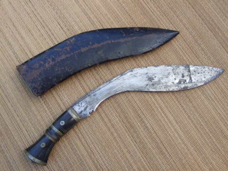

For a while now , over a decade in fact , there have been many posts on this & others forums regarding the incredibly prolific kukri found generally very cheaply at every car boot & junk shop in England generally known as the ring grip kukri labelling it as an official WW2 Indian Army issue kukri. Myself & many other kukri collectors have disagreed with this, due to lack of any factual evidence. Just unreliable hearsay & blurry pictures.
Heres an example of such a kukri....
[see below]
They have a a pair of brass or white metal rings adorning the handle & quite often have nickel plaited blades... {Rather similar in design to the infamous tourist/export lion head kukri & indeed the fake ww1 mk.2 kukris one see for sale so often.
Sadly on occasion, this viewpoint of them being WW2 Indian Army Issue kukri to Gurkhas, has had the effect of artificialy inflating there price for collectors {Mostly from the USA.} to artificial levels based on false premise that . its a genuine ww2 Gurkha issue kukri.
It is known & accepted in the kukri collecting community that these were being made & for sale in India {Dehradun to be precise.} in WW2, Many Officers & men bought them. It is of course traditional in the British army for Officers to buy there own uniforms & equipment.
Here is a provenanced example... Carried by.Captain Arthur Russell Stuart Holmes of the Royal Engineers during 1944.

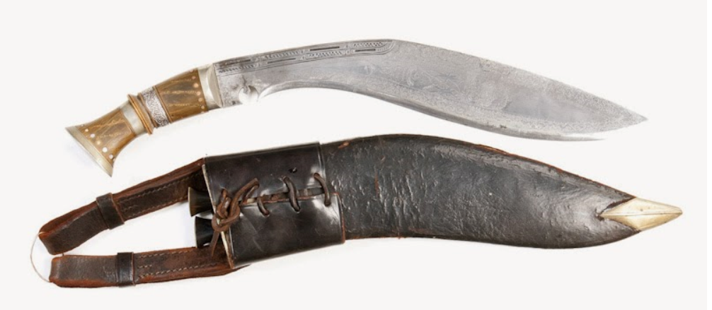

These kukri in India are known as Garhwali kukris after the Garhwallis who made them.. I should add kukris with silver rings on the hilt probably date back to WW1. And were probably purchased privately by & for Officers. But there a very different beast.
Silver ring grip kukri. from 4th Gr.
[see first picture below]
And one from the 10th GR.
[see second picture below]
The legitimate known ww2 versions of these have steel bolsters. Those made later have steel, brass or white metal bolsters.
