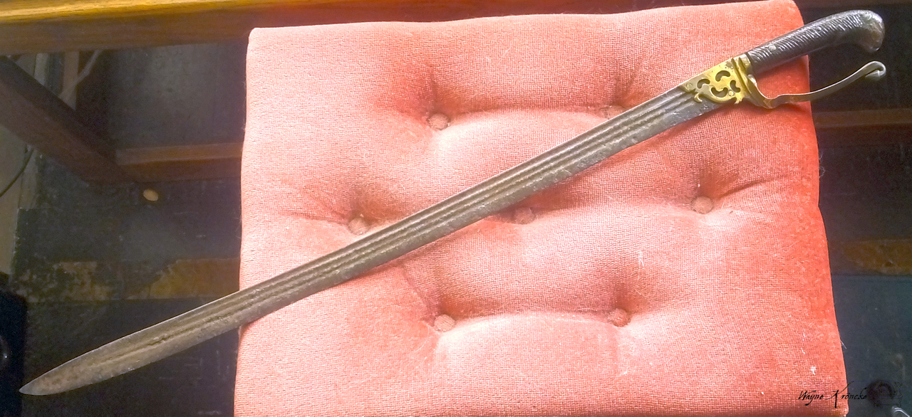

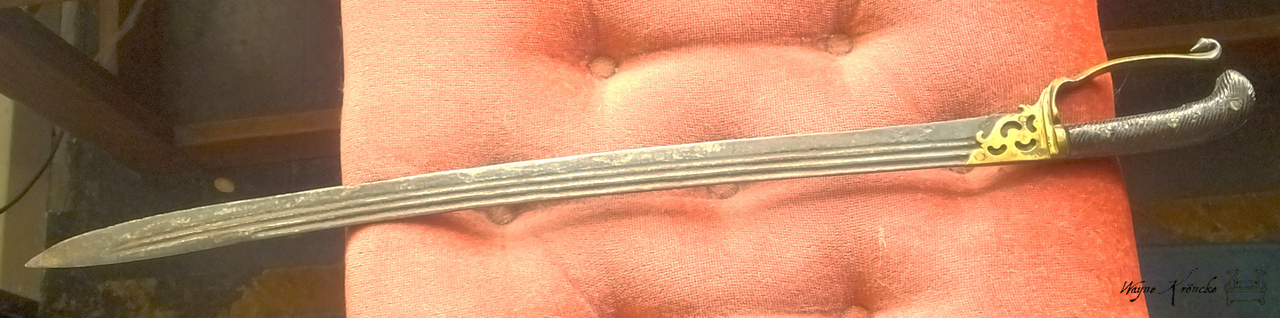

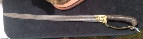

just got off the phone with one of my friends whom offered me this sword, he suspects it's 18c or earlier southern india. anyway, it's mine now & will be with me shortly.
does anyone have any suggestions as to what it really is, when where it might be from? thanks in advance for any info.
no details on length/weight etc. yet. grip scales are horn of some sort, look riveted on, small gap between the guard & scale i assume from shrinkage. not sure if the guard is polished or gold plated. probably the former. more info/better photos on arrival...

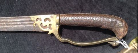

Hard to tell from the pictures but it looks like the blade was mounted up with this guard when the blade was in its current condition. The rust/patina of the blade continues on undisturbed beneath the guard. If it had been there a long time you would have expected the patina to follow the outline of the guard and the holes and not be continuous from the exposed blade portion. Not to say the handle and blade haven't been together for awhile but the guard seems a much, much later addition. Still, an interesting piece that one wishes could speak to us.
Old 5th July 2015, 09:20 AM   #7
? - i would expect if anything, the patina and corrosion to be worse under the brass & roughly the same in the exposed holes, exposed to the same corrosive conditions. brass in contact with steel would set up a galvanic corrosion cell if not kept oiled. steel is higher in the galvanic series than brass and thus will corrode preferentially.
anyway, if trade blades were common at the end of the 18th c. it's possible an old patinated blade still in working condition may have been rehilted in the early 19th. as it appears to be shorter than the normal european blade, it may have broken off & the owner had it rehilted as a full exposed tang hanger/cutlass, thus the fullers extending under the filigreed brass. waste not want not
i suspect some bright spark thinking he'd increase the bling value has cleaned it & polished the brass recently. will know more when my supplier returns from france early this week 7 posts it to me so i can supply better photos.

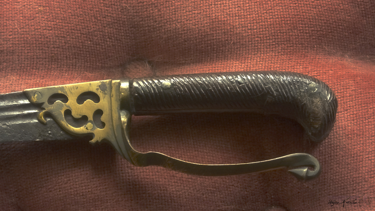

my supplier returned from france monday (strikes in france & illegals storming the tunnel & ferries have been a nightmare last week or so) & posted the item. finally arrived a few minutes ago today.
blade is 61 cm - 24 in.
LOA is 73 cm. - 29 in.
weight is 476 gm. - 1.05 lb.

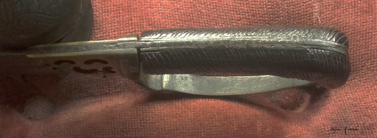

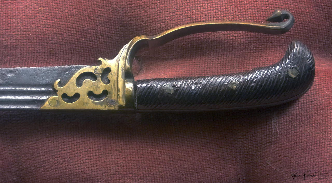

the flexible blade is fairly thin, 5mm at the grip, distal tapered to the point. sharp false edge about 6 in. the brass filigreed part is integral to the rest of the guard and tight to the blade and down into the fullers, the corrosion appears to follow the outline of the brass but not under it.
it is a full exposed tang with brass grip liners, separate from the brass of the guard and horn grip slabs pinned to it via brass rivets. some of the brass is worn bright tho tarnished, some has a deep dark patina. inside the bow it is almost black, as are sections of the brass grip scale liners.
there is a small 1mm gap between the front of the scales & the guard that looks like a missing shim or spacer.
i suspect that this hanger was made from a much longer broken blade.
the shiney brass polished look i noted in the earlier photos must have been an artifact added by the suppliers phone camera logic.
will take a few pics for posting here later after i walk the dog and have my breakfast.

today's photos - didn't turn out as well as i'd hoped. light wasn't right. bit overcast. may try again when we have a sunny day.

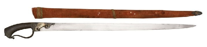

it does look like a variant on these afghan short swords i googled up a minute ago: no upper guard projection on mine tho, no sign there ever was one that broke off either. the end is also not touching or fastened toi the pommel like the afghan ones.

Kronckew, those curious military swords were what came to mind when I saw Afghanistan mentioned. These are actually a quite different 'breed' though, and last year Mahratt did a brilliant study on these. These are apparently a regulation type sword produced at the Machin Khana in Kabul, a British subsidized factory dealing primarily in firearms.

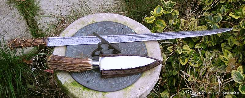

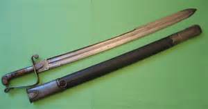

discussing hilt grip materials on another site, we got into stag, which reminded me of the attached (upper) short sword that i now compare to my new one. another trade blade? (posted here earlier in a discussion on scottish skians)
