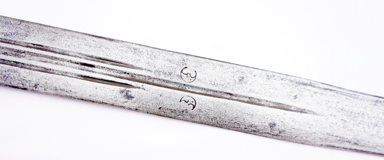

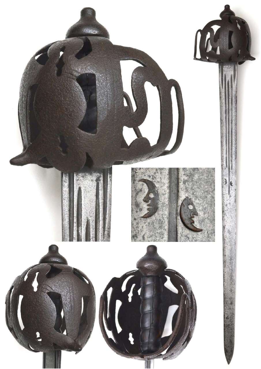

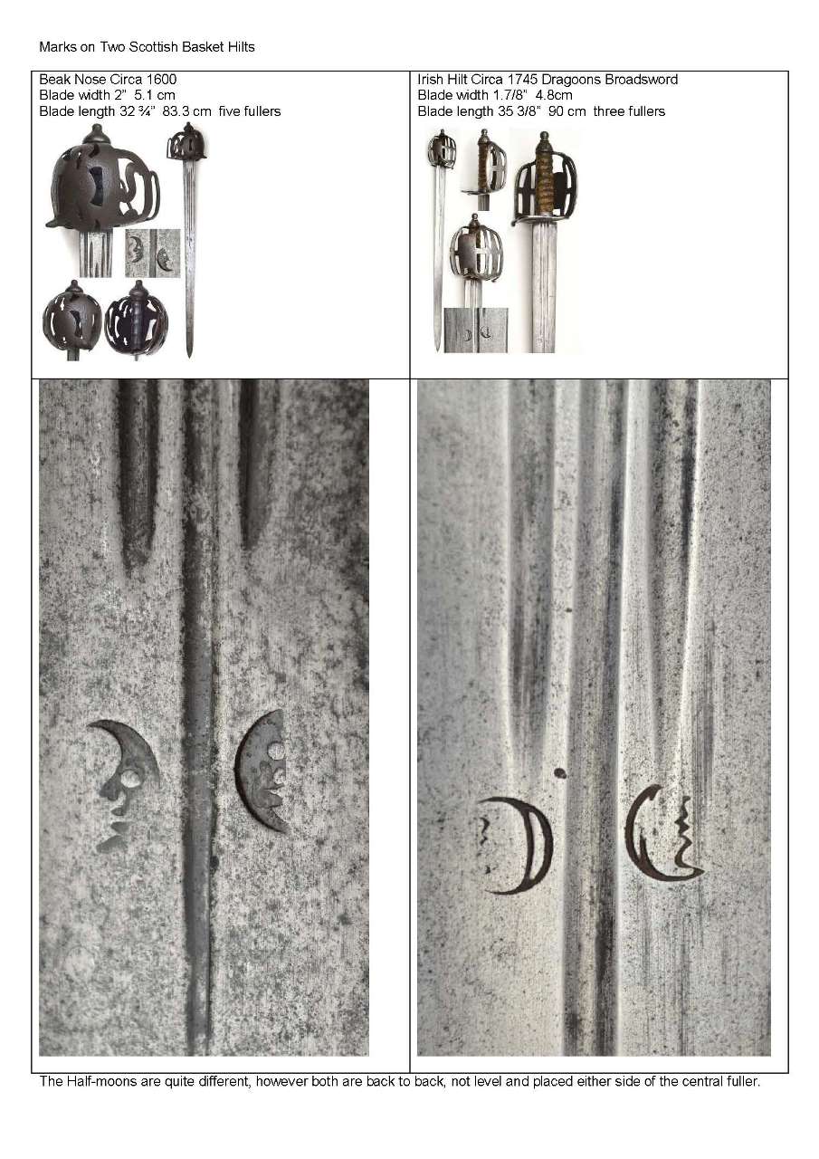

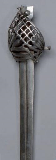

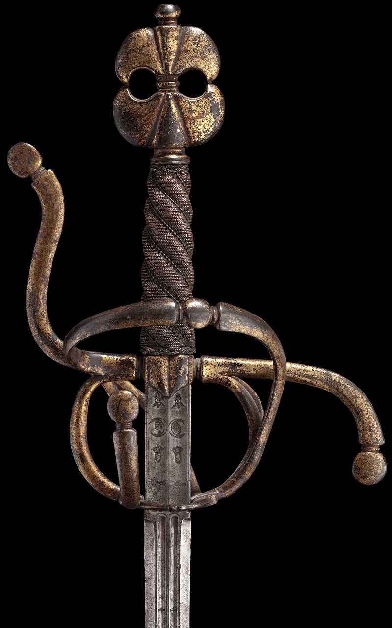

In the images I borrowed from the other thread, on the left is a basket hilt with triple fullers and paired moons c.1600 posted by Cathey. In my opinion this is one of the strongest cases for European use of these moons. It will be noted that at the blade root flanking the central triple fullers are two flutes. The moons are more in the character of European astral images used in motif, and blade is entirely of early Solingen types destined for Scotland.
On the right is a basket hilt c.1745, also shown by Cathey, an outstanding Anglo-Irish hilt. The blade however has paired moons more of the character seen on North African kaskara blade examples. While there is of course the possibility this is a German blade, the markings are atypical for Solingen forms known, and both degenerated, almost stylized geometric in form.

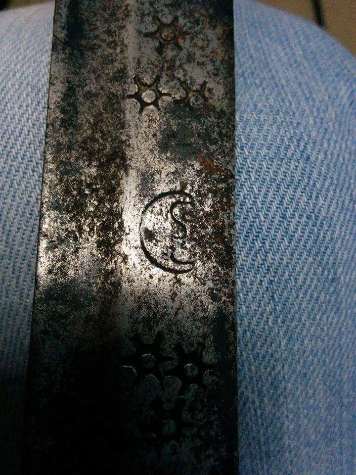

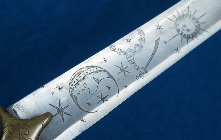

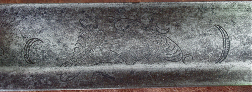

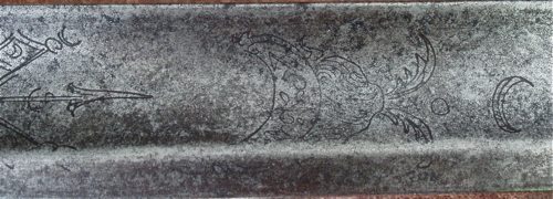

The blade example below posted by Iain illustrates the nature of the variations of these moons and fullers on kaskara blades. Many of these are produced in North African locations and blades with the moons are termed 'masri' (Rodd, 1928) with the moons termed 'dukari' and placed for magical and talismanic purpose.

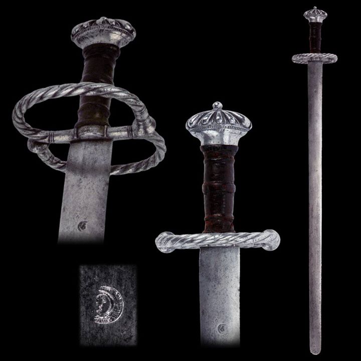

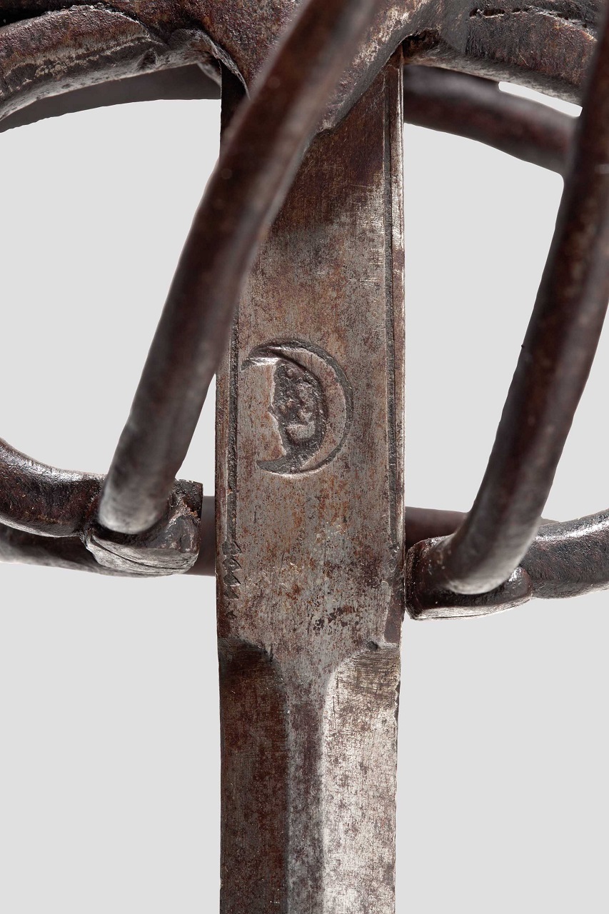

I am hoping that possibly we might look into the use of crescent moons on European blades, and especially instances of their occurrence in pairs facing away from each other as seen here.
We know that the man in the moon type devices occur, usually with other cosmological themes , but looking for the paired examples.
