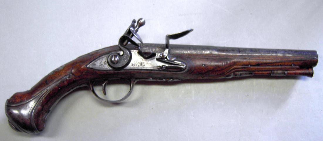

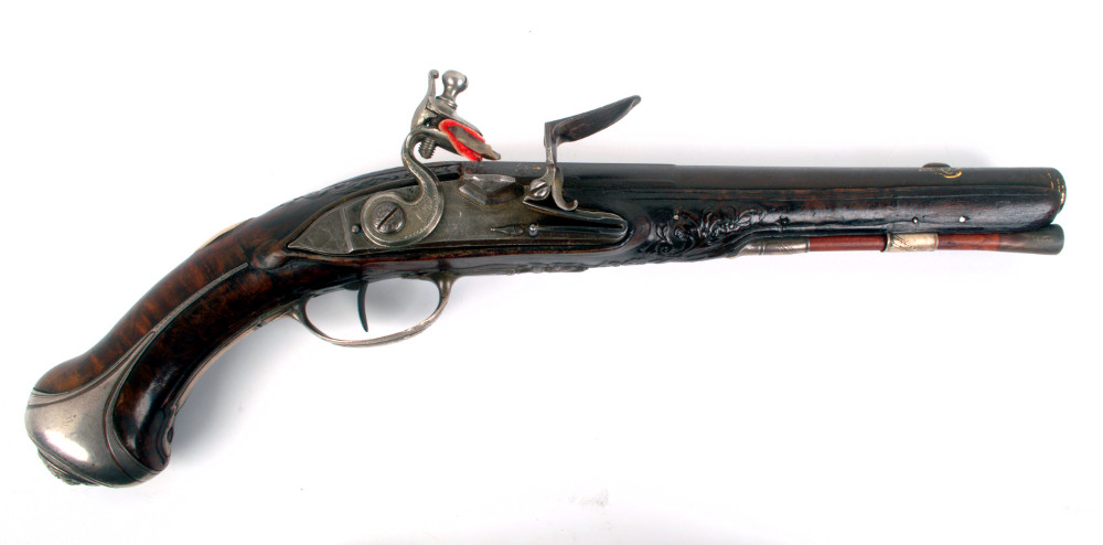

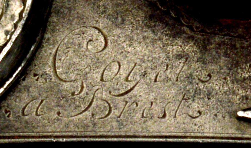

I could use some help identifying the maker of a pair of flintlock pistols. They look French to me. The barrel and lock-plate are marked “Goyel A Brest”, but a lower cased “a” is used on the lock plate. Could this mean Goyel in Brest? I know there can be great variation in the spelling for surnames.

What about Goyet instead of Goyel?
My book by Johan f Stockel states there to be a Goyel in about 1690s. This pistol is not from that time but Goyel could have been working after this as well.
Brest is a city in France so "a Brest" is indeed the name where this person worked.
Style of this gun would be 1720s i think.

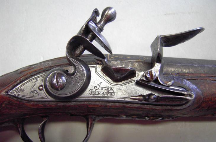

The pistol is certainly made in the years about 1740. A pistol of very similar style made by Jean Giraud of St.Etienne in my collection is made in these years.

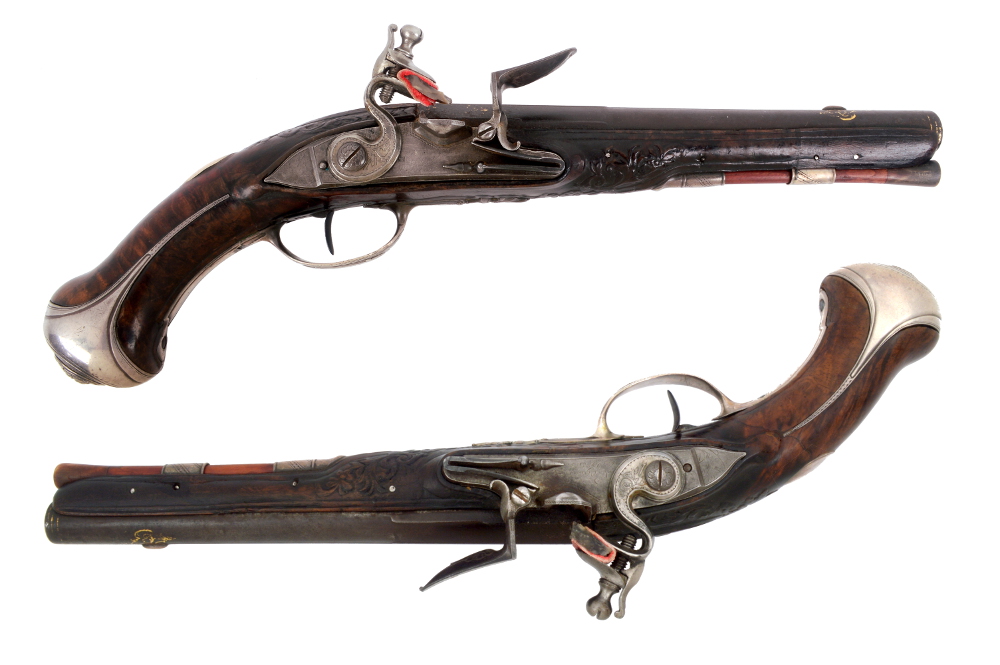

Here is a photo of the pair together.

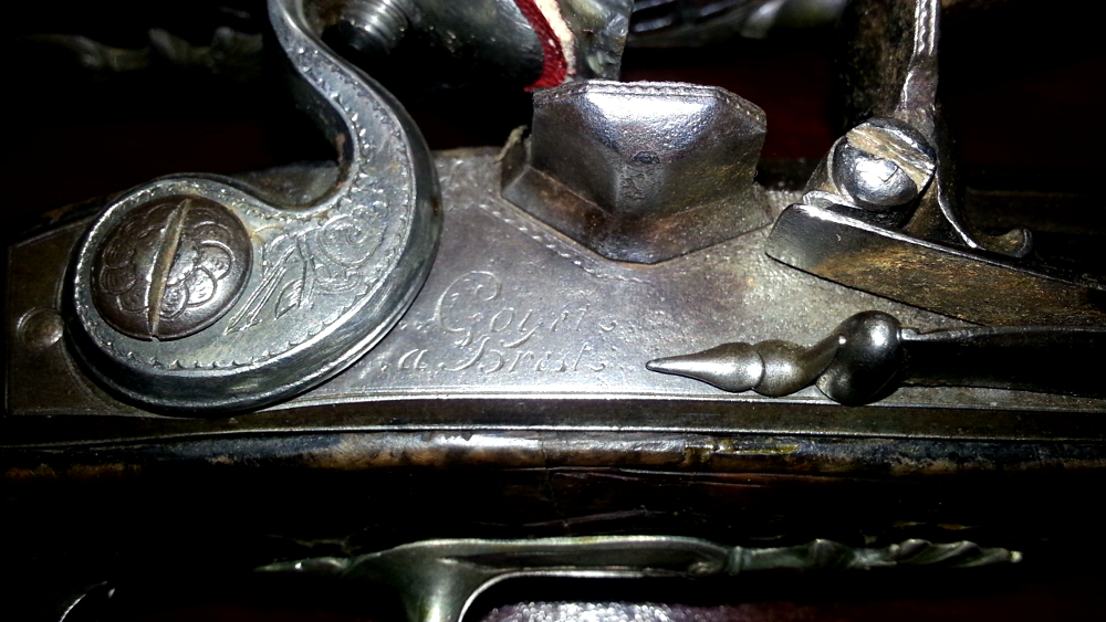

The shape of the lockplate of Dana's gun is still more curved in the traditional "banana" shape. This form was already obsolete in the 1730s. Also if i look closely at the name on the lockplate i would swear i see GoyeT with a t (or a l with a scratch trough it?)
That could be Marcus den toom, but I don't think so. I'll post a closeup of the best lock plate in high contrast.

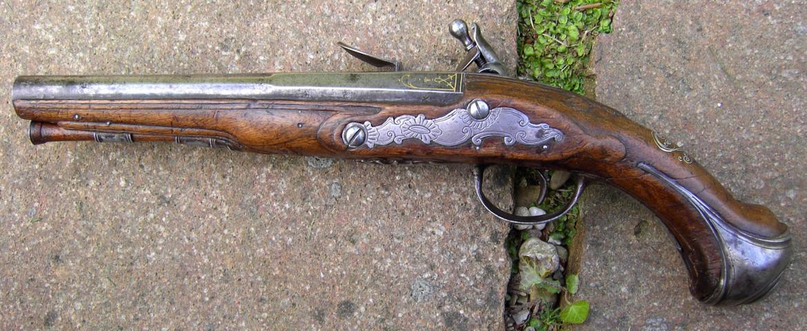

A few more shots. I've almost given up finding the maker.
