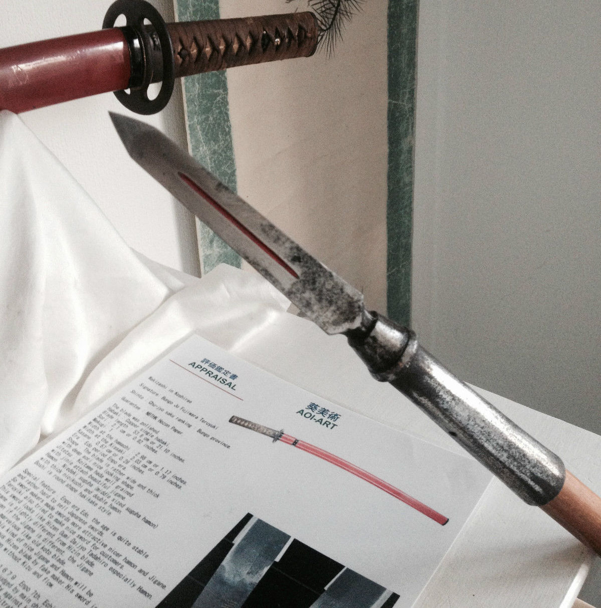

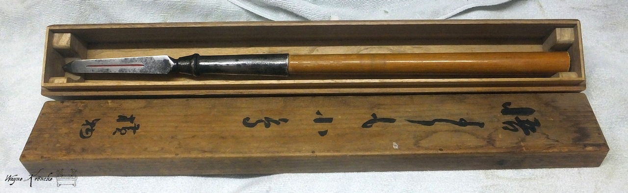

picked up this yari head via ebay last night a lot cheaper than i expected. it is shown in the picture on a three foot dowel of the wrong size. after earlier conversations with the vendor, i learned it was not tanged like most but socketed, which was as far as i know a bit unusual (?). anyway, i will order a 2 meter pole for it when i measure the socket & black lacquer it, etc.
i seem to remember that naganata and yari hafts had a flat area near the grip to aid in edge alignment, i would assume vertically for the nags and horizontal for yaris?
thanks in advance for any info, these are somewhat outside my past area of knowledge.
A yari with a socket instead of a tang is called "fukuro yari", they are not that unusual, if you do a search using that term you will find other examples.

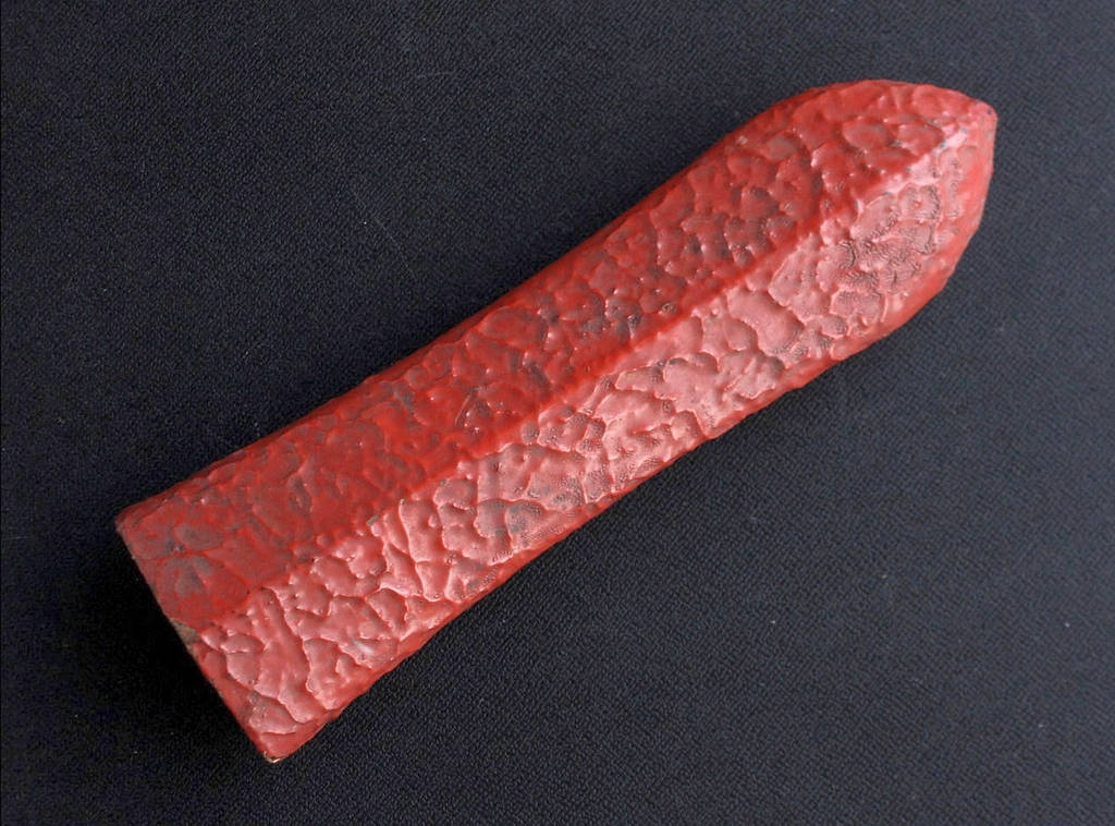

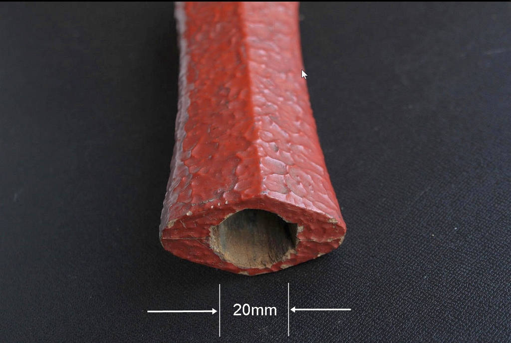

Here's an Edo period socketed kikuchi yari: http://www.e-sword.jp/sale/2013/1310_4035syousai.htm ; compare with fukuro naginata and you see a clear difference: this yari has a round socket, and fukuro naginata have oval sockets.

the yari head arrived late this afternoon.
232 grams, 23.5 cm. long over all, 11 cm blade of equilateral triangle cross section. the last 1.5 cm. tapers more abruptly to the sharp point.
there is a 6 cm. x 2mm. fuller on each flat, with a red inlay (lacquer?
the OD of the socket base is 2.5 cm. there is a 3mm. hole in the socket 5.5 cm. from the base in line with one edge and on the centreline of the opposite flat. some black rust, small pitted areas on two flats. some sign of stoning on a short section near the base of one flat. all rust is black, not red.
edges are sharp, but not tomato slicing sharp. the edge is perfectly straight from base to point including the truncated section. (armour piercing?)
no signature marks i can see. it came with a short piece of what looks like a red oak bo stuck in the socket, but not far enough to reach the securing pin hole.

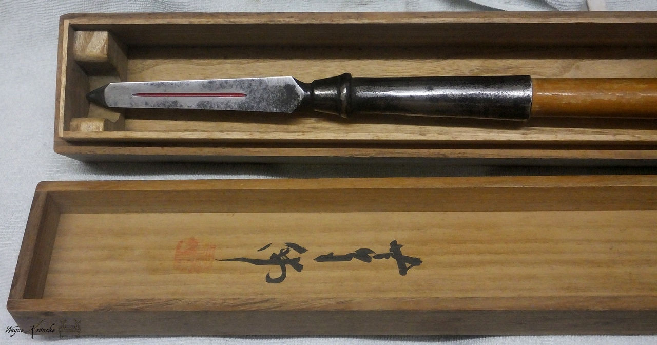

as a surprise, the point and the bo tip came in a nice japanese wooden plain un-lacquered box that looks very old and stained. there is calligraphy on the box lid and one character on the inner surface of the lid with a red chop mark. the ends of the box have semi-circular cradles for the point & short wood section. the wood box joints are all perfect. i initially couldn't see where the box came apart. wyou can't tell where the joins are by feel. made by a darn good box master. heck, the box is probably worth more than i paid for the point. the point is worth a heck of a lot more than i paid, i'm fairly certain.
It is a Japanese scroll box, they are quite good for storage, I have a couple that I store tanto and yari in.
