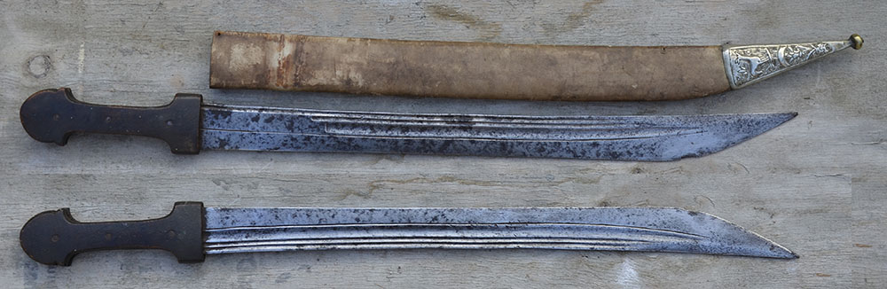

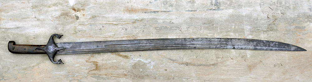

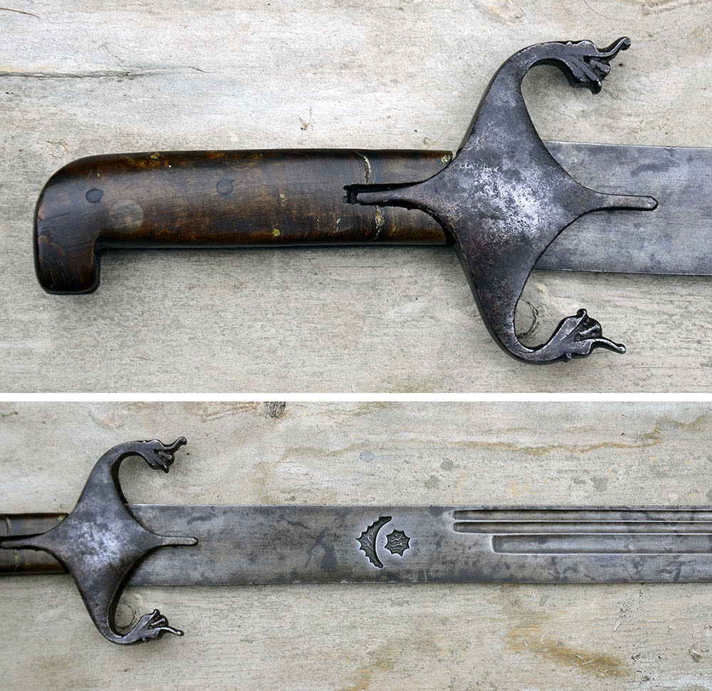

After a google search I presume it is a shamshir and turkish
The cross-guard is different than most I see on the web.
96 cm long.
I would appreciate your comments about the origin and age.
The cross-guard is loose, is there a way to fix it?

It's hard to say where this sword is actually from because it's a combination of parts. The blade is good Caucasian work, probably made in Tbilisi c. 1850. The guard is Persian, and considerably earlier; this type with recurved quillons is rare. The grips are more or less recent. It was probably assembled for use in the early 20th century.

Dear Oliver,

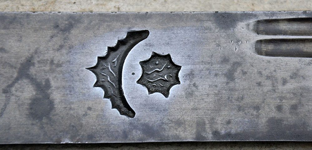

Are you sure that the blade is Caucasian?
I have a Persian Qadara with the same stamps...
The blade looks Persian for me.
Kubur

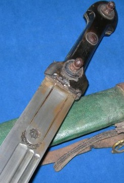

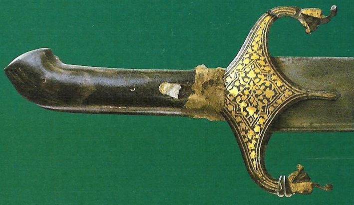

might be due to shrinkage of the wood grip scales. you could try soaking the hilt in linseed oil to swell it a bit, as long as the scales are not also attached with an oil soluble glue; that might however let you disassemble the hilt easier & tighten it back on cleaning and re-assembling it. injecting a modern filler like epoxy steel into the gap is likely to be frowned on & reduce it's value. a big blob of goop like the last photo would also not be a good idea. some middle eastern swords have that area wound with wire, which might be something to try first. it at least will not be a permanent repair that might lessen the item's value.
adding a pin thru the guard like that thru gold koftgari is also not a good career move. i do note in my photo above there was some sort of glue, possibly cutler's cement under the wire which came thru a bit. might even be silver solder. not my weapon.
this one shows the outline of the guard grip languet under the wire a bit better.
i recall someone posted instructions on reconstructing a turkish hilt here somewhere that might help.

Kubur, why not post a pic of your blade so we can compare them.
Congoblades, the original treatment, and also the most conscientious form of restoration, would be to fill the aperture between the guard and blade with a water-soluble paste or putty.

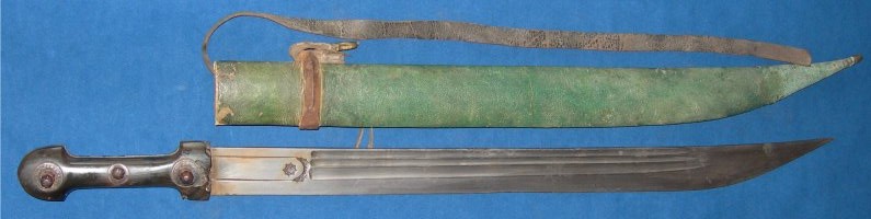

Old 5th December 2014, 06:42 PM   #8
Kubur
Kubur's Avatar
Posts: 2,145
Voila
Very similar...

May be the blades were produced in South Caucasus, I have no idea about that...
Old 6th December 2014, 12:14 PM   #12
Kubur
Kubur's Avatar
Posts: 2,145
Plus the coins on the rivets of the grip are Qajar
The scabbard is Qajar...what else...
We need an expert for the stamps on the blade...

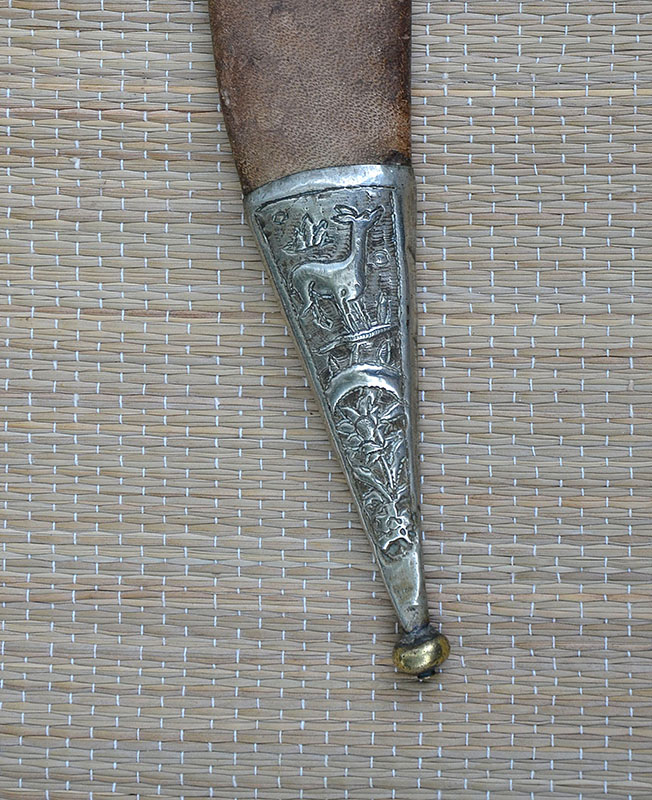

Have also this one, similar fullers as the sword. Will probably be of the same region. The decoration on the tip of the sheath is a bit strange. Looks more like german or austrian??

The lion with the sword or the gazelle on your scabbard are pure Persian motives.
For me, your sword is Persian from A to Z.

Yes of course, chiseled panels, inscriptions and koftgari could be, and often were, done at virtually any time after the blade was finished. Note that these techniques are typically found on areas of the blade which are subject to less hardening in the heat-treating process.
Ariel, what was used in Persia in period was a combination of borax and other constituents, applied in a paste and allowed to harden. I know a couple of restorers have mentioned that patching plaster, the sort you mix with water, is effective. I imagine it's available at any hardware store. Bear in mind that while this pretty well duplicates the color and texture of the original when dry, it's only intended to stabilize the guard, not to make the sword combat-ready... ;0)
