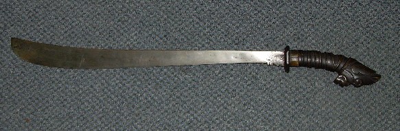

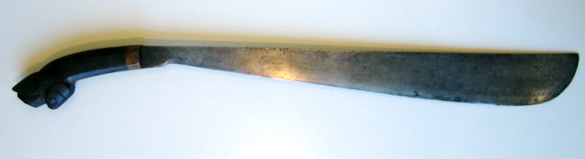

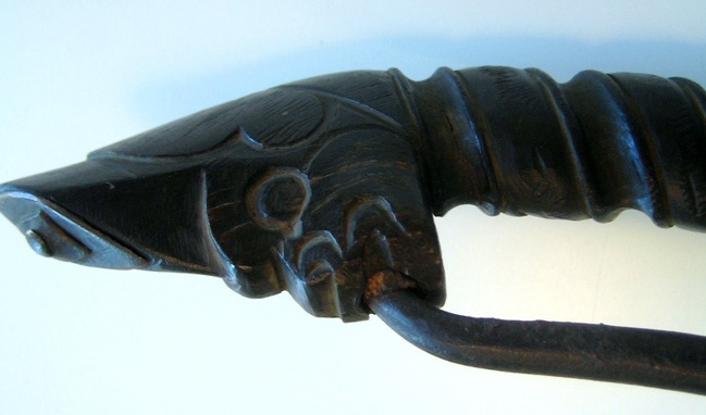

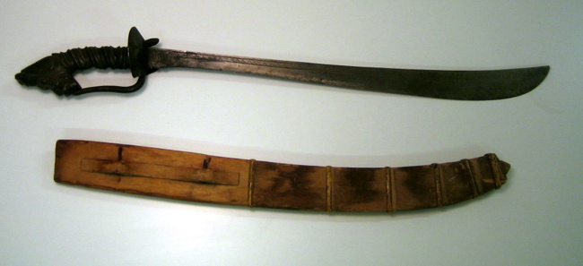

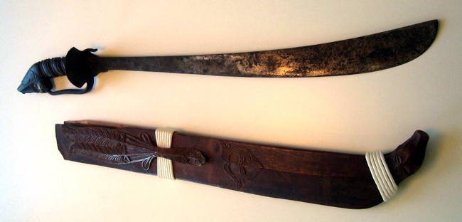

Hi all,
This beauty arrived today.
According to Stone p.482 this is supposed to be a variation of the Parang Nabur.
Tirri p. 429 says the same.
In Charles Buttin pict 898 there is a slightly resembling sabre (mix of this one and a "traditional" Nabur) that he describes as a Malay demi-sabre, probably Borneo Dayak.
I haven't found any references to this variation of Nabur in any of the Indonesian or Borneo weapon articles and books?
In the huge collections of f.i. Leiden there are lots of different Nabur, but none even slightly resembling this one.
To me it looks much more Visayan than Borneo.
Could this be a mistake by Stone?
Does any of the Filipino specialists recognise this sword?
Michael
PS The scabbard also looks more Visayan than Borneo to me?
Old 20th February 2006, 08:16 PM   #2
Posts: 5,997
Yummy, how old is this. It looks as if there is a lot of European hanger influence. Tim

Greetings Michael,
Now I know who it was that out bid me on this. Congratulations on your win!!! I'm just glad that it was someone from the forum that got it.(That way I get to see more pictures of it) My vote is that it is a Parang Nabur probable dating from the 19th century. Could the animal depicted on the hilt possibly be a bat?

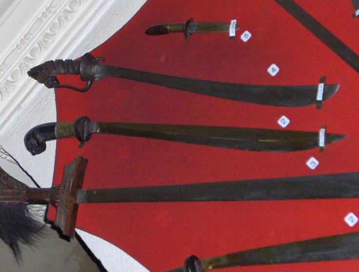

My guesstimate is also 19th C - early/mid.
I have no idea what kind of animal it is on the hilt?

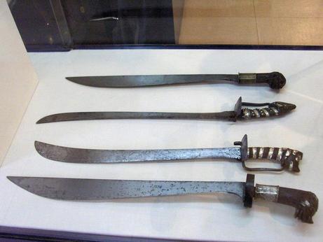

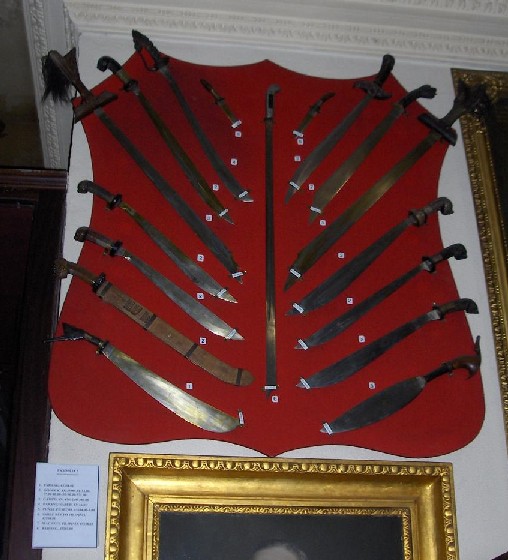

I revisited this great reference thread on PI weapons in Spanish Museums.
http://www.vikingsword.com/vb/showth...Spanish+Museum
What's interesting is that this kind of sword is part of the Filipino collections of the two Madrid museums together with other Visayan weapons.
I have enclosed the relevant pictures below.
Michael

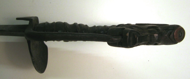

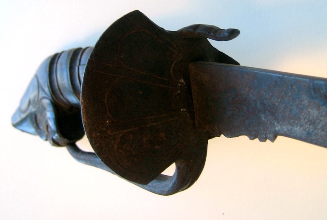

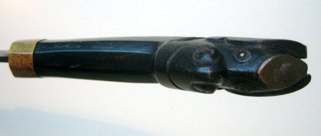

Great sword. Is there anywhere in the Visayan Islands that peaned the tang? Is that a coin the tang goes through? Can we see a picture of the engraving on the guard cup?
Bill is offline   Reply With Quote

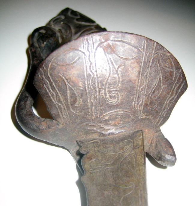

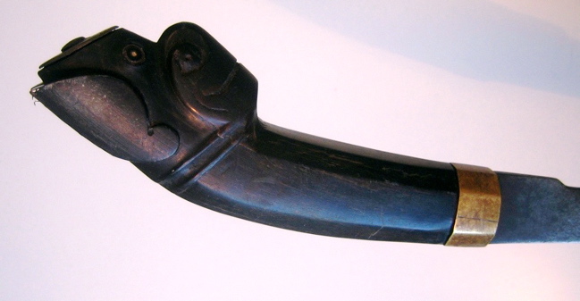

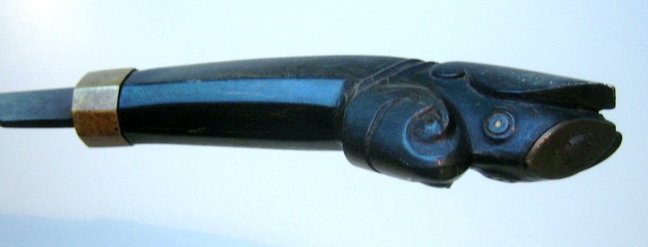

Bill,
Here is a close up of the guard cup.
Probably the piece on the top once was a coin but as you can see there
is nothing left of any identification on it.
Michael
PS Sorry about messing up with your head Shelley.
Next time you meet "Uncle" you can ask him...
Old 22nd February 2006, 08:11 PM   #8
Bill
Location: Chicago area
Posts: 327
quite sure that is Picasso's work on the guard.

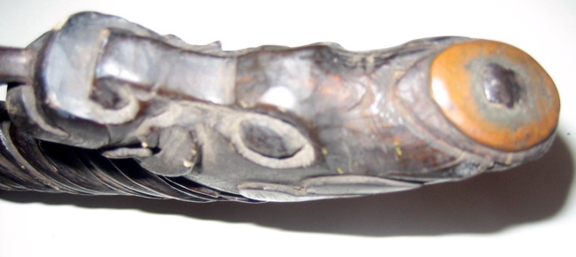

Old 11th November 2006, 01:52 AM   #12
BSMStar
BSMStar's Avatar
Join Date: Jan 2005
Location: Kansas City, MO USA
Posts: 312

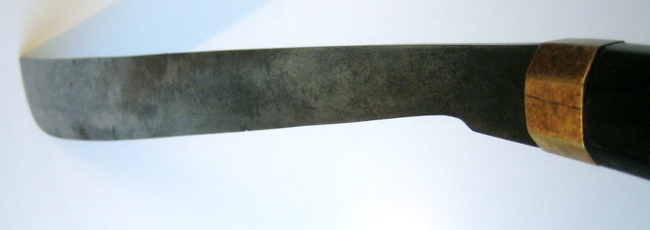

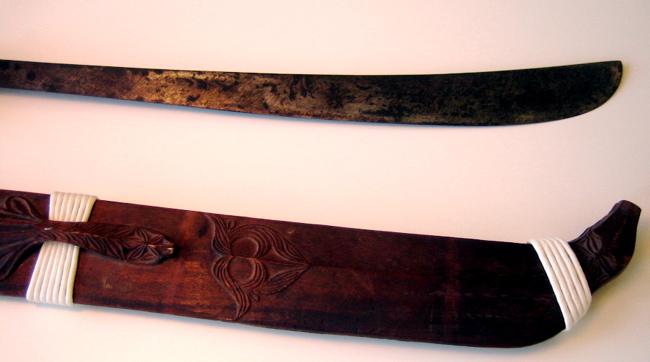

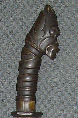

This just arrived today
BSMStar is offline   Reply With Quote
Old 11th November 2006, 06:49 PM   #13
Posts: 7,403
I have been confused by these puppies. However, Erik Farrow has this to say about this type being Visayan:
http://www.eriksedge.com/PH189.html

I agree with Erik that these swords are made in the Philippines, but looking at the blade profile... is it Visayan? I do not believe that Erik makes a direct reference to the sword being Visayan.
If indeed it is Visayan, there should be many other examples of this blade type in the Visayan region... I have not seen any. The closest examples to this sword are Parang Naburs. I think the sword presents a bit of a puzzle.

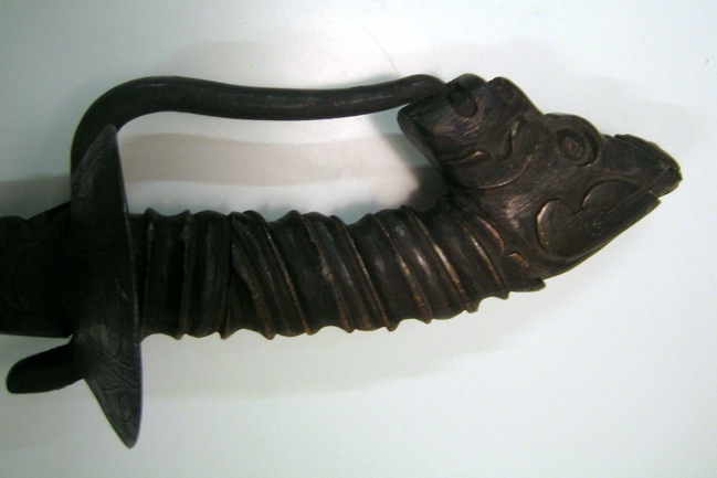

Hi BSM Star,
I agree that the blade and hilt of Spunjer's bolo is a bit different but I still think they are from around the same area.
It also seems like Ian thinks so in the other thread?

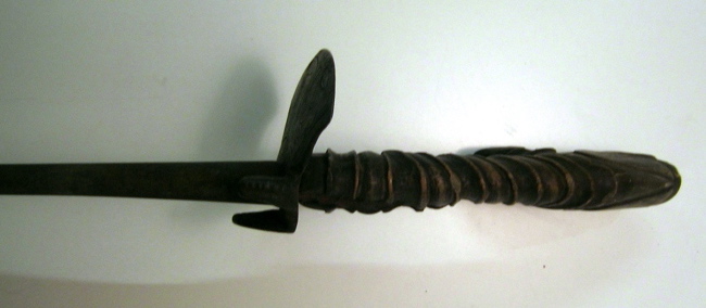

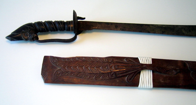

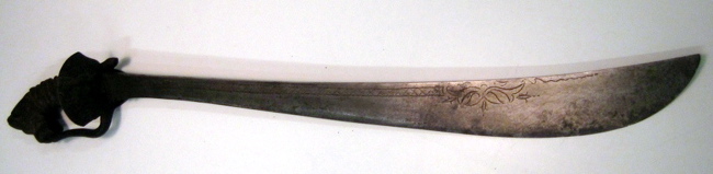

After this thread started I found another one of those bolos and that scabbard (haven't had time to fix it yet) also seems to be of Filipino origin.
Unfortunately I don't know enough to be sure from what region.
Michael

how sure are you that the scabbard is original with the sword? i.e., does it fit well? i'm assuming if you remove the white rattan (j/k) you could clearly see the form where the blade rest.
if this is original to the blade, well, another bleeping monkey wrench...
Old 13th November 2006, 07:53 PM   #20
VVV
VVV's Avatar
Location: Sweden
Posts: 1,637
Spunjer,
You are correct that the scabbard isn't original.
I removed the rubber rattan and checked.
Sorry for posting it before I had time to go through it properly.
Where do you think this bolo comes from?
No scabbard, with a resembling hilt made of rhino(!?).
Michael

Hello Michael,
These nice hilts seem to be all related regardless of some stylistic differences.
Does the horn show the rhino microstructure? I'd have guessed at aged carabao from the pics but you can verify with a magnifying glass...
Old 14th November 2006, 05:50 AM   #22

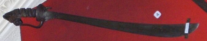

Can we agree to call this sword a Parang Nabur?
This is how the Spanish identified it in the Museum...
