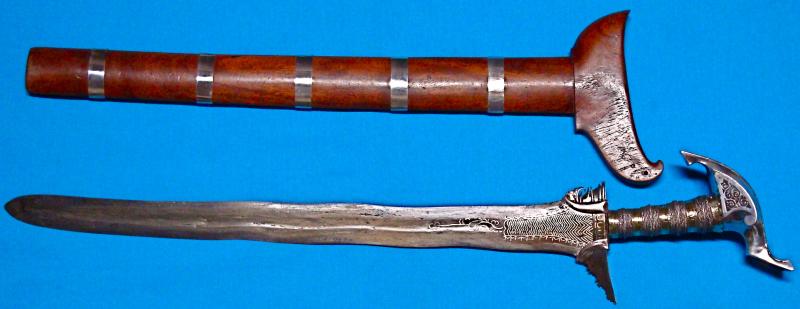

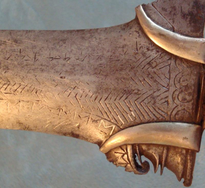

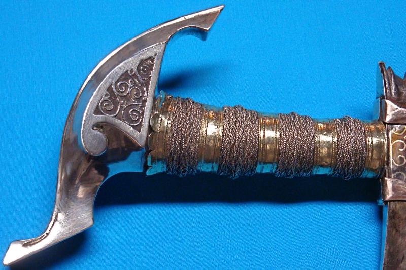

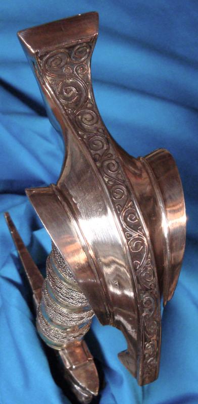

Greetings folks!
I received this kris last year and it has taken a year to fully restore it. The junggayan pommel is tested solid heavy cast silver! Hilt bands are made of twisted silver wire and gold plated silver. I restored the missing silver inlay. There is a plate of silver on top of the ganga and the ansang-ansang clamps are made of low silver.
The scabbard was split and I put it together with a new pin. Down the scabbard are silver bands I replaced (with one exception).
I believe this kris to be Sulu and the 2nd time I have ever seen filigree on a silver pommel (the 1st being CharleS's).

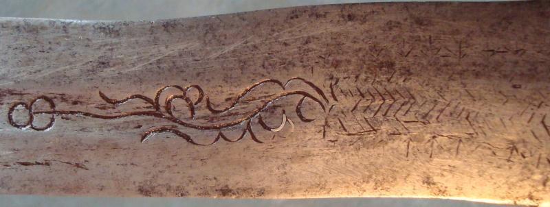

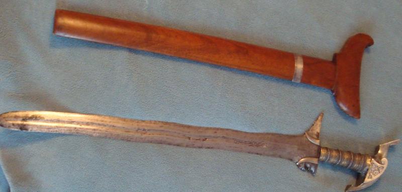

These first pictures are the kris as I got it.
Enjoy!

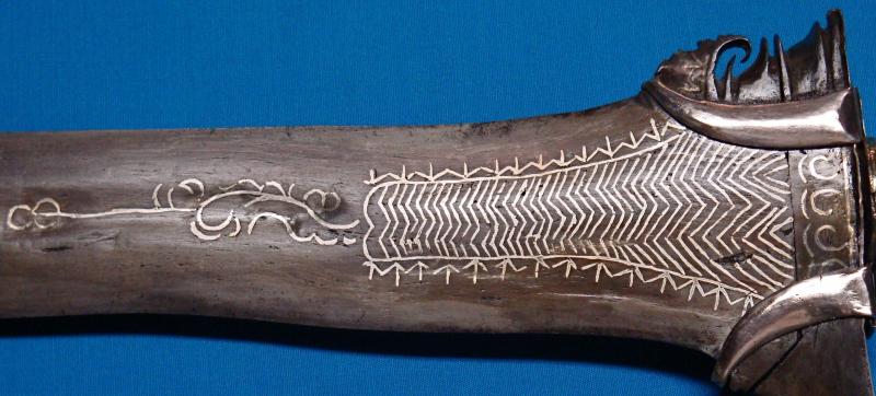

Here are pictures of the piece now restored:

How many hours did the inlay take?

Any idea on the weight of the pommel? I am assuming coin silver for it or do you think it is a different alloy?

You've recut the channels and hammered in the wire beautifully.
Do you have to use an adhesive to get the wire to hold?

Shakethetrees - I lost count of the hours involved, but I do know that it took a year to get all the work done, especially the inlay (based on what was already there).
David - yeah, I felt the same way when I got done!
Mross - I would say a good pound to a pound and a half of solid silver.
Oliver - No adhesive used. I tried once on Ian's barung years ago and it didn't work. You're right, it takes cutting and then undercutting the cut, then cold hammering. This is how the original artisans did it and their ancestors all over the planet.

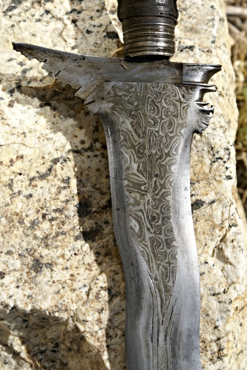

Nice work Battara!

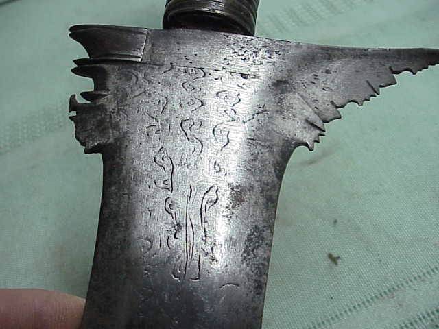

What is the symbolic representation of that inlay, a volcano?
It strongly brought to mind this piece.
Could the complex pattern welding attempt to bring to mind the same "volcanic" symbol, or vice versa, could the inlay be an homage to the twistcore?
Emanuel

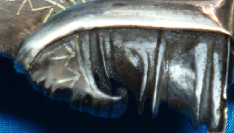

The quality of the silver pommel casting is spectacular. What surprises me a bit is the simplicity of the silver inlay on the blade. The patterns are crude relative to the refinement of the pommel.
Are we seeing a gap in technological skill/talent between casting and inlay craftsmen, or different sensibilities regarding what is important or what requires more detail (ie. the pommel is more visible than the blade, hence exhibits more refinement, the blade is used and hence needs rougher decoration).
Could the inlay and pommel have been added at different times in the piece's life, by different owners, again with different concerns or ability to afford embellishment?

I THINK THE SILVER DECORATION ON THE POMMEL, GRIP AND FERULE ARE JUST THAT, DECORATION TO SHOW STATUS AND WEALTH.
THE INLAY ON THE BLADE IS PROBABLY TALISMANIC AND THERE PERHAPS TO CONTAIN AND HARNESS THE SPIRIT IN THE BLADE THUS MAKING IT A WEAPON IN THE SPIRIT WORLD AS WELL AS IN THIS ONE.
I HAVE NOT HEARD ANY REFERENCE TO A VOLCANO BEING REPRESENTED IN THE LORE OF MORO KRIS. THERE ARE VOLCANOES IN THE AREA SO THERE ARE SURE TO BE OLD BELIEFS AND SUPERSTITIONS ASSOCIATED WITH THEM. IN OTHER MYTHOLOGY THE GOD VULCAN'S FORGE WAS OFTEN THOUGHT TO BE IN VOLCANOES. A INTERESTING THOUGHT.

Often the pommel and hilt, and then the blade, and even the scabbard were done by different craftsmen. Vandoo is right in that what is on the blade is probably talismanic, but what I don't know. I also agree that there is a spirit in the blade.
As far as a volcano is concerned, I am not aware of any connection or significance.

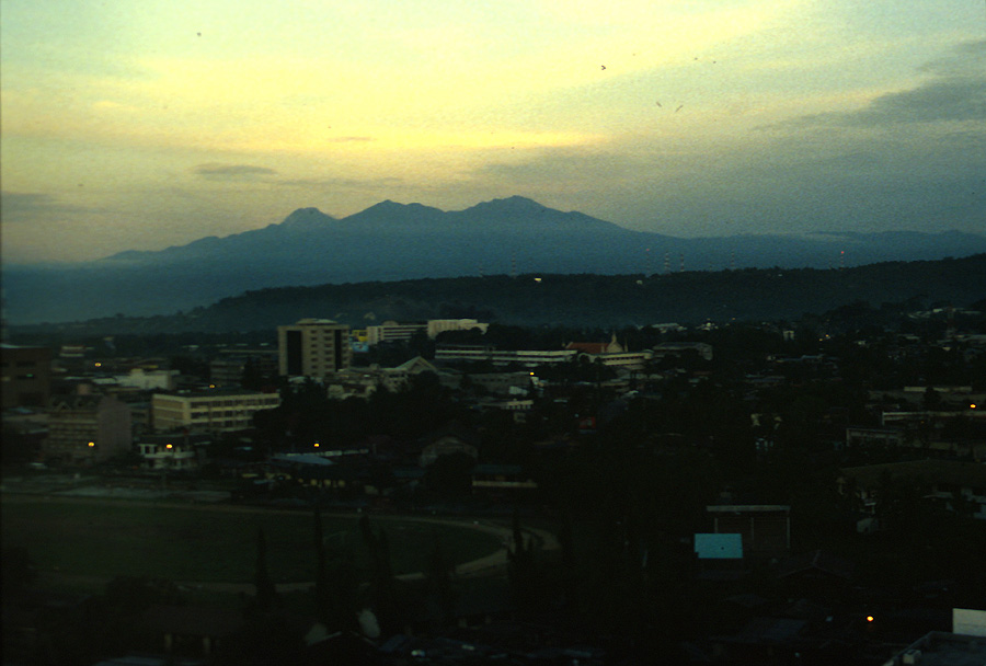

Mt Apo is a beautiful mountain to visit. It is just outside Davao City and looms over that city of over a million people. There is a national sanctuary there for the Philippine eagle.
I had the privilege of visiting that area many times in the late 1990s and early 2000s. It is not really part of Moroland, being located on the eastern side of Mindanao, and more the home of the Bagobo, Tagakaolu, and related tribes.
Jose may be on to something with his reference to Bud Bagsak on the island of Jolo. I believe this volcano has significant meaning to the Tausug, and it was the scene of a famous battle in 1913. A local leader, datu Amil, took his whole population of several thousand people (some estimate 10,000 men, women and children) up the mountain and into the caldera, which was heavily fortified, and challenged the Americans to come and take them.
