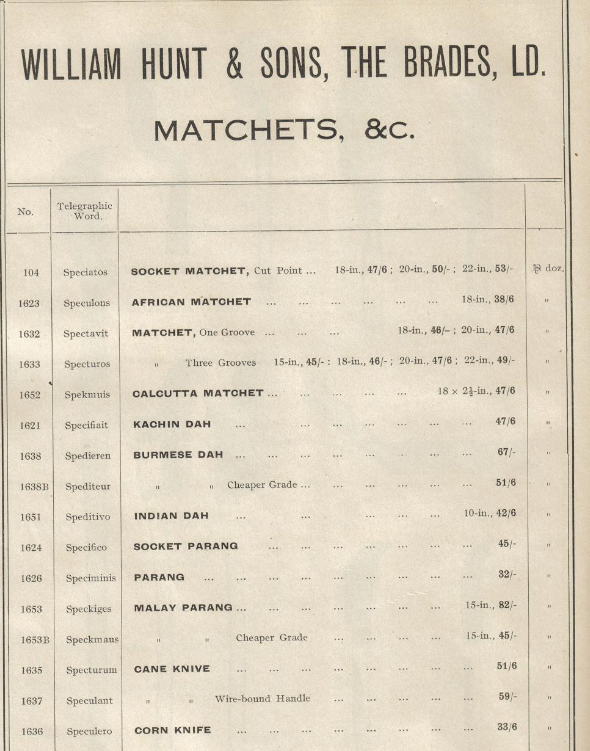

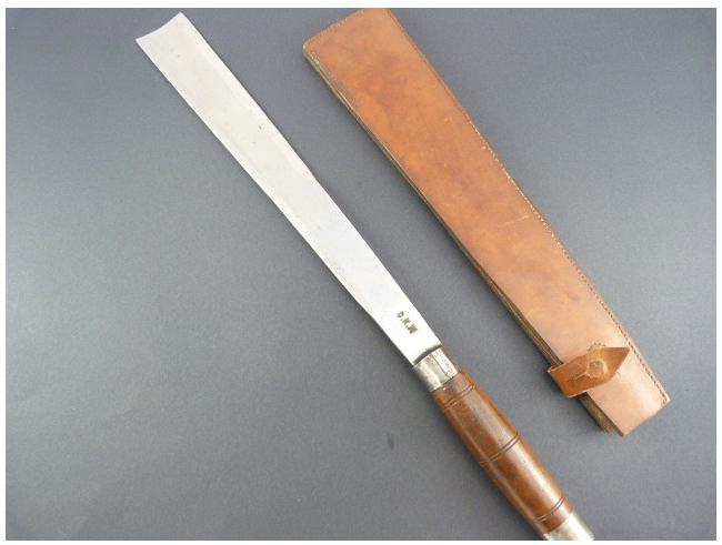

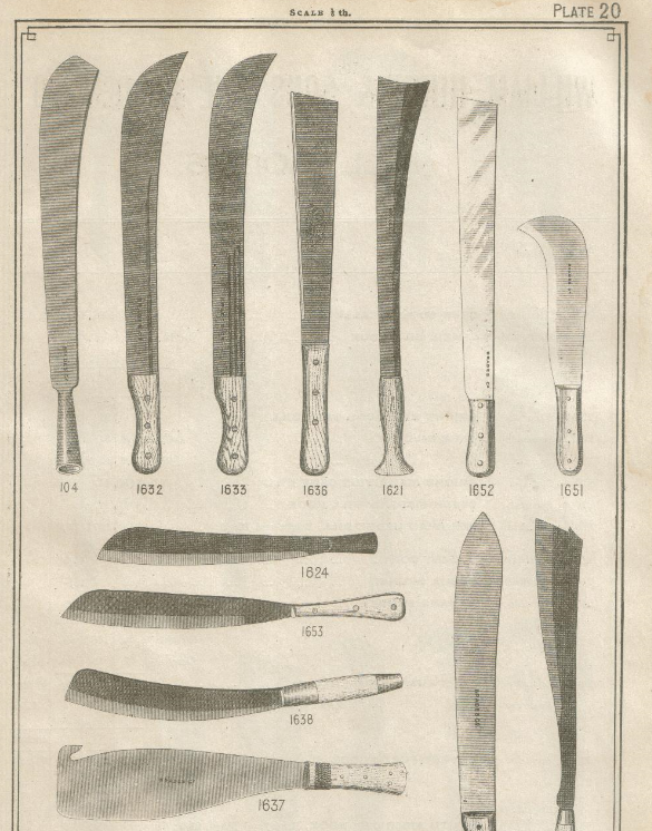

Just came across this old English catalogue excerpt. & I wonder how many of the "ethnographic" mono or shear steel Kachin Dha blades we see {1621.}, were actualy made in a factory in England?
Other stuff as well.....
spiral
Old 6th September 2014, 01:39 AM   #2
Gavin Nugent
Gavin Nugent's Avatar
Posts: 2,818
What a great find J, thanks for posting! Certainly makes for interesting consideration where non hairpin blades are concerned...Is it mentioned anywhere about outfitting Kachin soldiers loyal to the empire?

I'm reposting this old thread about a sword I picked up 10 years ago. British markings...
http://www.vikingsword.com/ubb/Forum1/HTML/002441.html

That's a very interesting old catalog. The prices for these machete seem quite high for the late 19th and early 20th C (when this company was still operating under the name "William Hunt and Sons, The Brade." Apart from the Kachin dha, the other examples don't really resemble the indigenous forms very closely. The Burmese dha, for example, is a short curved chopper with a three part hilt that sort of resembles a Burmese dha hilt. Whether any of these British made pieces ended up in SE Asia is unknown, but the price of purchase in Britain and then the shipping costs would make these items uncompetitive (on a cost basis) with locally produced swords. So these British-made items would likely have been for local consumption IMO, or perhaps bought by British companies for use elsewhere. They should not be hard to distinguish from the locally made forms.
Andrew:
I think your example is exactly what we have come to see in many former British colonies: locally produced arms but to specs that would have been determined by the British. These local items would have to meet those specs before being stamped with the official government marks. To me your example looks like a typical Shan sword and scabbard, circa 1900, with a sturdier than usual hilt and a scabbard bound with metal strips.
Incidentally, during WWII, many of the Kachin Rangers were outfitted with Shan-style dha as military issue, although some probably brought their own dha with them.

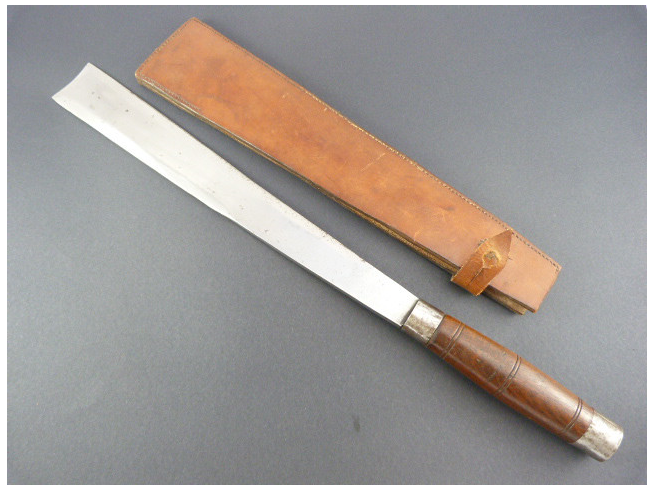

Kachin Dha leather scabbards were sold as surplus, back in the 1980s. Open along the back edge, with English maker marks, broad arrows, and WWII dates.
Yes the standard Indan army pattern "dha" or "chindit " dha scabbards they were, probably not realy Kachin in style? Ive had a few of them & the dha over the year.

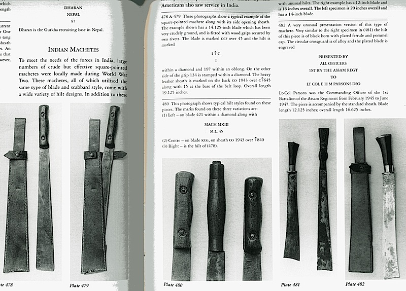

Here a scan from Flooks that shows the commonest patterns.{the ones on the left.}
The nore unusul one on the far right is the type still carried as a sidearm by the Assam regiment today.

With respect to the items in the catalog of William Hunt & Sons, I have done some online research on this company. The company did have a branch in Kenya and there is reference to a catalog for sales in Nairobi, but I have not found a copy of it. There is an online version of their 1941 catalog that shows the various die marks the company has used over the years--you can view the file here. I have never seen any of these marks on items coming from SE Asia or Southern Asia. Unfortunately, I was not able to copy the page with trademarks because of copy-protection on the PDF file. However, you can see by scrolling down a couple of pages into the file.

Lastly, the 1940s-era machetes that you show are, as you say, commonly referred to as "Chindit machetes." I have only heard of them used in relation to the Chindit forces under Wingate. I've attached a picture of one of mine, not sure if this is a MkII or a MkIII with a MkII hilt.

I'm pretty sure that there would not have been a whole lot of these dha sold in Burma. Consider the following economics.
The cost of the Kachin dha was 47s 6d per dozen, or roughly 4s each, in about 1900 (assuming that is the approximate date for the catalog shown above). The cost of a Burmese dha (high quality) was 67s per dozen or roughly 5s 6d each.
One pound in 1900 would be worth roughly 94 pounds per day. So converting the 1900 prices to today's equivalent would mean that a Hunt and Sons' Kachin dha cost 18 pounds 16s 0d in equivalent money today (or USD 30.33). According to the 1940 catalog, foreign shipments cost another 25% on top of the purchase price, so that would make a 1900 Kachin dha equivalent to 23 pounds 10s (or USD 37.90) today. The price for a Burmese dha plus shipping in today's currency would be roughly 32 pounds 16s (or USD52.90).
Recent economic data indicate that the average daily wage in Burma is USD 1.68-2.02, and average monthly wage is USD 50.51-50.61. And Burma has undergone economic growth since 1900, so that comparative wages should be better now than a century ago. Even so, it is apparent that the cost of William Hunt & Sons' products would have been outside the range affordable for the average Burmese/Kachin consumer in 1900 or today.
So who would have bought these expensive quality items in the colonies? Perhaps expatriots for employees on their plantations. Perhaps wealthy locals who had the money to buy them. But I doubt many would have found their way to the hill country where the largely untamed Kachin lived. Given the considerable savings in cost without any loss of quality from locally made dha, I doubt the foreign imports were very successful.
It is perhaps noteworthy that these machetes had disappeared from the catalog by 1940.

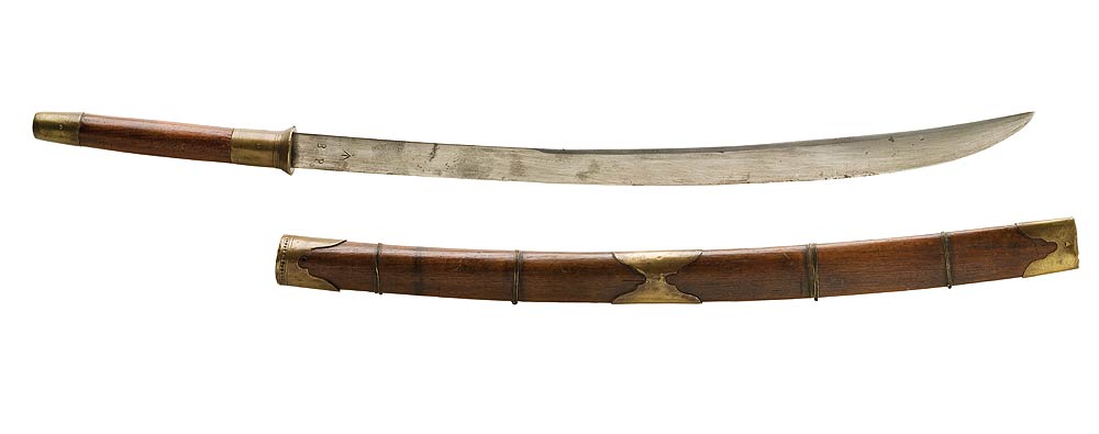

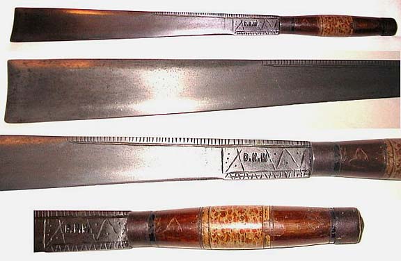

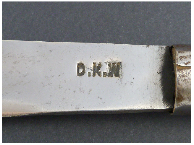

Id say your double edged DKW is a mark 2 myself. But that's just an opinion, Ive never found the paper work for their design.
Heres some pictures of plainer DKW one.
Is the bevel angle different on the spine to the front edge on yours?
Here's some pictures of plainer DKW one.
spiral
Spiral:
From memory, the bevel angle was a little flatter on the cutting edge versus the back edge, but I don't have that one with me at the moment.
