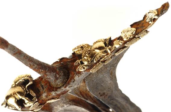

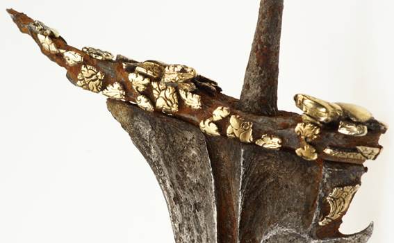

As you can see the rust lay's between the gold pieces
max is offline   Reply With Quote
Old 26th July 2014, 11:19 PM   #15
Posts: 7,255
Yes Max, correct, gold does not rust.
But underneath that gold is iron or steel and that does rust.
What often happens is that over time the rust penetrates to the iron under the gold, and the only thing supporting the gold is rust. The acidic soak also penetrates under the gold and weakens the rust.
My most important lesson came when I saw a highly respected m'ranggi in Solo take a blade out of an acidic soak. When it went into the soak it had been a very beautiful kinatah blade with probably better than 90% of the gold intact; when it came out of the soak it had maybe 20% of the gold still on the blade.
Mechanical clean first, if possible follow-on with an acidic brushing.
Best not to soak.

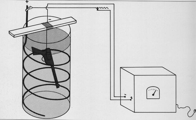

I have read of other methods where electric current is used, but I have no knowledge nor experience of these methods. From what I have heard, cleaning in this way might well be superior to the traditional methods that I know.
I did used the electric system to remove rust. It works but long lasting treatment is required. I think that it would work with kinatah.
Gio
You can use a 12V car battery. The liquid is a NaOH solution.
The process may take 12 - 24 hours with no risk of damage. Only the rust will be removed.

As to the electric de-rusting, my plant is not exactly what recommended in the book, but it works.
I use a rectangular plastic flower pot, on the floor of which I have put a serpentine of iron wire (about 1,5 mm thick). The quantity of NaOH is 1 - 2 tea cups per 5 litres (I think that the concentration has some influence on the time required for cleaning). The rheostat is needed for starting the reaction with a low voltage, increasing it slowly. I do not have a rheostat and I use a car light bulb to avoid a short circuit. The power comes from a 12 V car battery charger. Obviously the piece to be treated should not touch neither the iron wire. I suspend it with some pieces of plastic.
When the reaction starts, I can eliminate the bulb, and the reaction becomes more violent, but I prefer to leave the bulb in the circuit to avoid any risk, particularly when the system is unattended. Of course the current is lower and time needed is higher.
When the process ends the piece is black and it needs to be brushed to eliminate all the transformed rust.
When I am back home (beginning September) I shall send you the original text (from a French book: "Restauration des armes ŕ feu"). If you have any doubts please feel free to contact me again.
Alan

I have made a free but faithful translation of the original text about electric de-rusting (from "Restauration des armes ŕ feu" by Jean-René Clergeau, Stampfli & Cie, Berne 1981)
Electrolysis
This procedure is based upon the reduction of oxides through direct current.
This is carried out in a container for electrolysis where the piece to be de-rusted is the cathode. It is easy to find the necessary material, the more expensive component is a 6 or 12 V car battery charger. The cylindrical container can be of any insulating material (ceramic or plastic-which is better) of a convenient size. For keris cleaning a height of 70/80 cm and a width of 20 cm can be utilized for any size, including Panjang.
The anode is made with an iron bar, of the type used for concrete, 6-8 mm thick, made up in a spiral against the internal wall of the container. At an end the positive pole is connected, while the negative pole is connected with the piece to be treated through a non-galvanized iron wire. The piece must be fully submersed and should not touch neither the bottom of the container nor the anode. The electrolyte is a solution in water (better rain water-I use distillate water used for batteries) of caustic soda in granules in the proportion of 50 grams per litre. This solution shall be filtered from time to time, and the anode cleaned.
On the positive thread a rheostat should be inserted, so that the electric power can be reduced, mainly for starting the reaction, so that the battery charger is not unnecessarily strained. A buzzer can be useful for indicating a surcharge. The sound will warn to reduce the power, and increase it as soon as the electrolyse process starts , demonstrated by the appearance of hydrogen bubbles (this happens quickly). The operation must be left working for 12 to 24 hours, but a longer period is allowed.
The blade, once the process ends, will show a blackish surface of reduced oxides, which must be eliminated with washing and brushes (of bronze, if necessary), until the metal appears clean and brilliant.
CAUTION: THIS PROCEDURE MUST NOT BE USED FOR SPRINGS WHICH BECAME BRITTLE (luckily our keris do not have springs), AND A GREAT ATTENTION SHOULD BE PAID IN CASE OF KINATAH ON VERY RUSTED BLADES.
The illustration transmitted last month should help.

In any case, it seems that an old, degraded keris would be quite safe to de-rust using electricity, but a well preserved good quality keris would be at high risk.

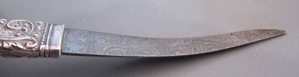

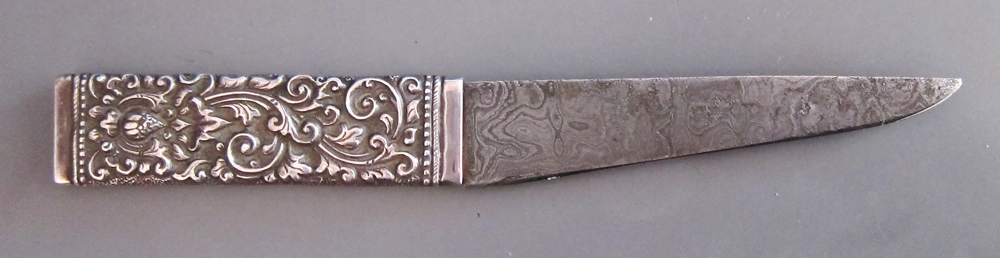

It has occurred to me that some of what I have written in the preceding post could be clarified.
The photos are of my desk knife. It is 01 damascus, I made it about 30 years ago --- in fact, it was the first piece of damascus I made, it was intended to be a 10inch bowie, but it was full of faults that I kept on removing until I finished up with a desk knife.
It has been given a spring temper, that is, it was hardened and drawn to a full blue. This means that it is pretty hard, holds an edge very well and will bend and return to dead straight.
The link will take you to a page that explains the colours that we use as a guide for drawing a temper.
