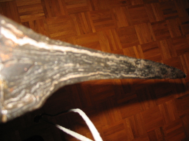

Default My first Keris
I'm not exactly a keris person, actually I do not know almost anything about indonesian weapons, however visiting that wonderful forum I came to like them. So I decided to buy a couple of kerisess and here is the first one. What can you expert guys tell me about it? Age, Origin, ecc. Anything would help. Thanks!

Nice first keris. An oldie and a goodie. Nice, well formed ricikan (carved features). Surakarta dress. Can you do some close-up? It reminds me quite a lot of my first one in many ways. Just a warning. They are addicting.

Lovely 13 luk keris from Solo, Surakarta. For a starter this is a very good keris.
This keris is called a keris bolong. Bolong is refering to the holes in the sogokan. It is said that when the owner is looking through the holes to a woman he wants, he will get her.
Happy hunting

A nice old keris, indeed in a Solo dress. This kind of shape (dapur) with 13 luk was very popular with Maduranese soldiers in service of Solonese army.
So many times we can see a blade made in Madura. The name of the dapur is Parungsari or Sangelat, which depends on a little difference ; If it has 1 or Djalu memet: 1= Parungsari or 2= Sangkelat
sorry cannot translate djalu memet, but i will try make it clear with a photo
example a parungsari:

Default parungsari
example:

Gentlemen, thank you all for your help!
Nechesh, I bet it, as soon I have recived it, I needed at least one more...
Happy hunting
What a coincidence, just the one I needed
Ehm,... Would be just looking to the foto of her enough? I really do not want to scare her....

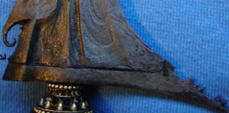

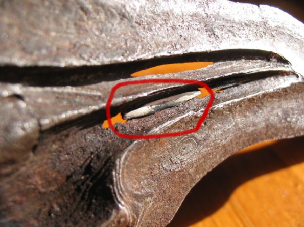

Here are some aditional immages. Simatua, a Sangkelat, I guess? What is the meaning/purpose of that bright metal insert in the Bolong?
Old 12th February 2006, 11:30 AM   #7
simatua
simatua's Avatar
Join Date: Sep 2005
Posts: 69
a sangelat indeed, it has a double djalu memet.
I Dont know exactly what the bright metal insert the bolong means.
I know that manytimes often through the many washings due to the "hormat" = honour given at the keris. The keris gets this bolong at the thinnest places first.
in my opinion there some possibilities:
1. It was there all the time , only this piece of metal (nickel) was more resistent to the arsenic then normal iron, and still stucked there
2.The owner attatched a high value at this keris. rapairing the(starting) bolong with strange iron different than the keris is "not done" , so the reapairing was done with a different metal. Sometimes you see reparations on old kerise done with gold.
3. Its inserted to give more powers at the powers already existed.
in this case i would certainly take this keris to the disco...
....i hope the kerisexperts/lovers can tell more about it
Happy hunting
There has been some serious debate as to whether or not this is "true" bolong (also seen spelled combong and complong). Some will insist that real bolong exist only when it was there from the start as a feature created by the empu. I have seen such keris, though they are somewhat rare. I have heard it argued that calling this bolong it merely an attempt to place a higher spiritual value on what is ultimately a defect in the keris making revealed through years of acidic etching. IMO though, i think when a blade has lasted this long and received constant attention (i.e. washing) that it does deservre some added respect. But i wouldn't set your wedding date yet.
The bit of metal stuck in the hole is curious and interesting. Any idea of it's actual composition? I could, as suggested, be a way of honoring the keris. The idea of a repair seems unlikely to me because i would expect it to fill the entire hole and probably both.
The mendak looks pretty old and tired and has lost all it's stones . You might want to further honor the keris by replacing it with a new one. Nice quality mendaks are available at relatively resonable prices. (see the mendak on simatau's keris).
BTW Martin, why do you think this one is Madurese? And where does your information about Madurese soldiers preferring 13 luk blades come from. I have never read that.
The piece of metal in the hole is not a piece of nickle that resisted the etching. Not a strange thought because the iron of the blade is eaten away while the nickle resists the etching. It is added later and in my opinion you should remove it. IMHO it is not something to honor the keris. By honoring the keris I'm sure something more valueable would be added.
That madurese soldiers prefered 13 luk blades is also new for me. I'm very curious to hear where you got that information.

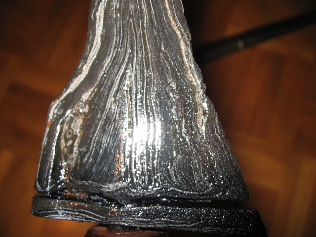

I have a further question. Is there a way of cleaning or treatment to bring up the pamor with no risk of damaging the blade?
Traditionally, to remove rust and clean the keris, coconut water is used (use ripe coconut for better result). Remove the hilt and hilt ring, soak the keris blade in coconut water. Leave it for 1-2 days. It can take up to 3-4 days depending on how thick/stubborn the rust on the blade. Remove the blade approx. every 6 hours, brush gently with a tooth brush and rinse in soapy water. The rust will be removed and you will get the pamor pattern.

Henk, with coconut juice...you'll get a faint pattern. With lime juice, you'll get a light contrasting effect. Most contrasting, would be lime juice with arsenic (but this process, can 'eat' the blade a little), depending on the blade material.
For a blade like Valjhun's, which had worn down, coconut juice is recommended, imo only.

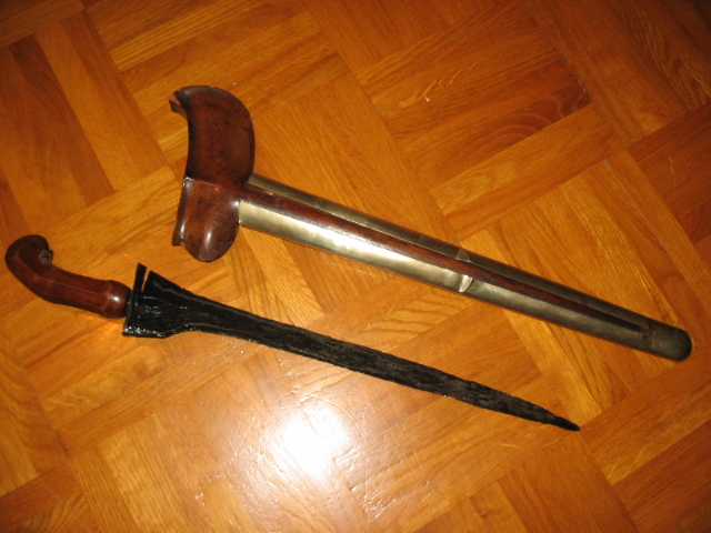

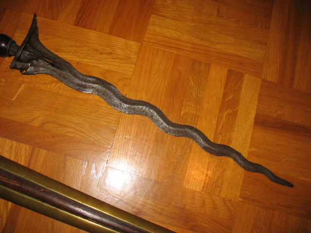

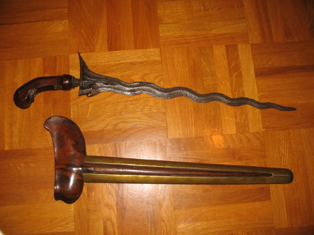

Default My second one...

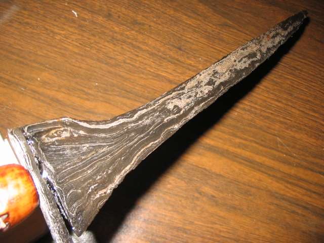

Like Nechesh said, They can be verry verry adictive, so I introduce my second puppy. Not as nice as the first one, I guess (there is no mendak, the ukiran is stuck, pendok damaged) but still a nice javanese(?) oldie with quite nice pamor (tell me if i'm wrong).
As ever, I have some questions.
What kind of pamor is it and what is it bring?
How old is the blade?
Is it constructed of meteorite?
Thanks!
BTW: There's the third one on his way
Old 15th March 2006, 11:22 PM   #25
Alam Shah
Alam Shah's Avatar
Join Date: Jan 2005
Location: Singapore
Posts: 1,248
Hmm...an old blade.
Keris Gayaman Solo, Dapur Brojol.
Pamor looks like a mixture of a few patterns.

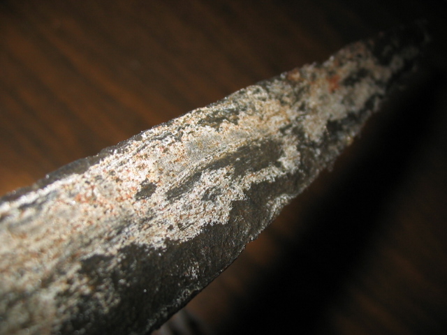

To remove the ukiran, heat the blade a little at the sorsoran area and gently remove the ukiran, in a gentle twisting motion.
From the 3rd picture, it seems that pitch had been used to secure the ukiran, due to some black stain on the ganja and sorsoran area.
The pendok you should be able to remove and do some minor touch-up.

Question Bright Metal
Hi all,
Regarding the bright metal which has been inserted to the blade, I have one example of it. Refer attached photo, the metal is near to the gonjo. Earlier, I did not realized it, but then, while cleaning the blade, the metal appeared immediately and it become much more brighter. Any opinion, wether the metal has been added later by the previous owner by purposed?
Ria is offline   Reply With Quote

Nechesh and the others, thank you for your kindess.
But how old is my second keris?
Nechnes, yes I'm trying to avoid thoose new kerises

Posts: 940
Valjhun, for me the trick isn't to necessarily avoid new keris, just to know what they are when you buy them. I also prefer the older blades, but i have a couple of beautiful modern examples as well and i think it is a good thing to encourage the continuence of the art.
As we have discussed before, dating keris is a tricky thing even with the blade in hand and much harder to do just from photos, even for the well trained experts. Often enough even experts will disagree about the tangguh of a keris and really such dating can only be taken as an estimate. So i am going to avoid making a fool of myself by even guessing on your blade.
I do look foward to seeing your third one when it arrives.
