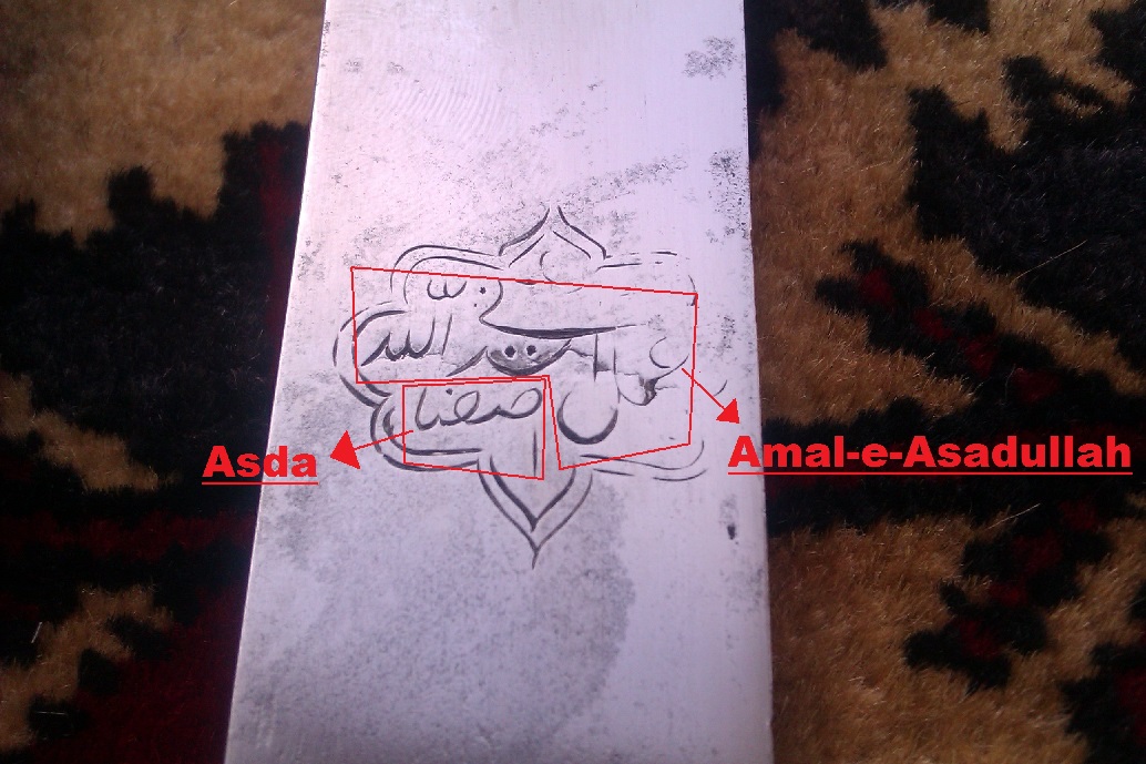

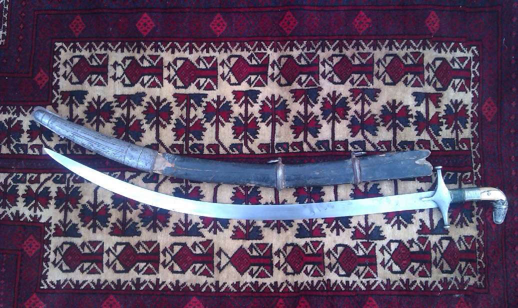

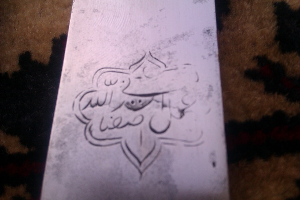

I am presenting an antique sword in original condition, stamped or signed as Amal-e-Asadullah - Asda.

Salam Ahad,
This says "Amal Assadullah Asfahani" or work of Assadullah of Asfahan. This sword is 17th to 19th century most likely so no, it did not belong to Imam Ali (RA)
The name Assadullah is used to this day especially in Iran, Pakistan and Afghanistan.
You have a nice sword, but you are aiming too far in the past with its attribution. I would also point that the inscription is not an authentic Assadullah inscription, its crude so likely made later on the blade. Its still a very good sword.

Default What is the meaning of the word اصضا is?
Assalam, Its my pleasure to joining the forum. Thank you A.alnakkas, AhmedH and AJ1356 for your info and comments, I appreciate and yes I have started reading the web page http://www.vikingsword.com/vb/showt...?t=17804&page=1, for further information, my pleasure and many more related sites.
Can you friends tell me what اصضا stands for? The google translation detected this word as a Persian word but i didn`t find its meaning yet.
Ahad K. is offline   Reply With Quote

Salam Ahad,
It is not اصضا it is اصفهان but the noon ن placed on top next to Assadullah. This is common in calligraphy.

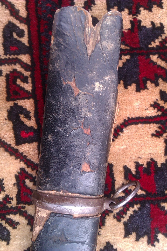

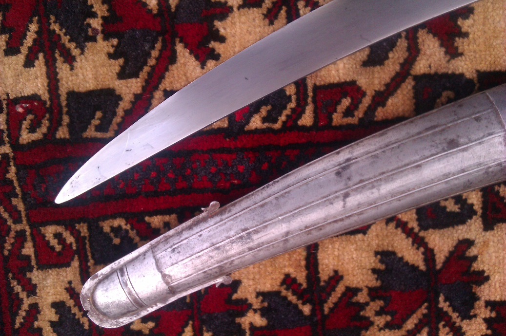

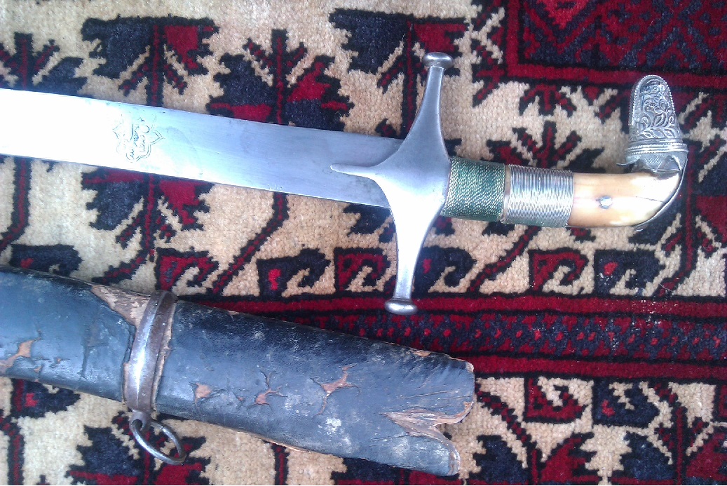

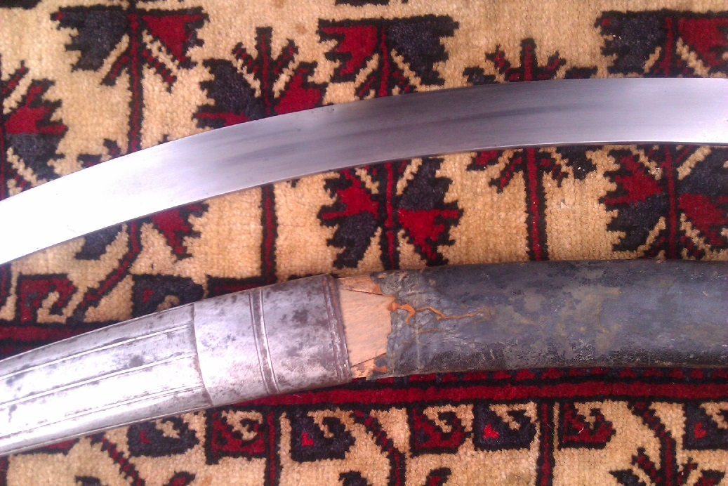

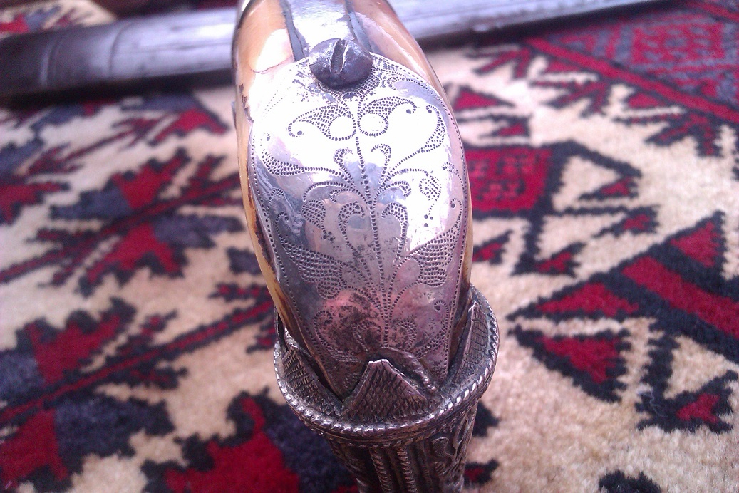

Based on the very long ribbed lower scabbard fitting, I would think at least the scabbard is Afghani, 19th century. The rest is not far from there, IMXO. The screw on top of the pommel and the crudely cut triangular spaces for langets on the scabbard suggest recent renovations and repairs. God only knows what parts were added.

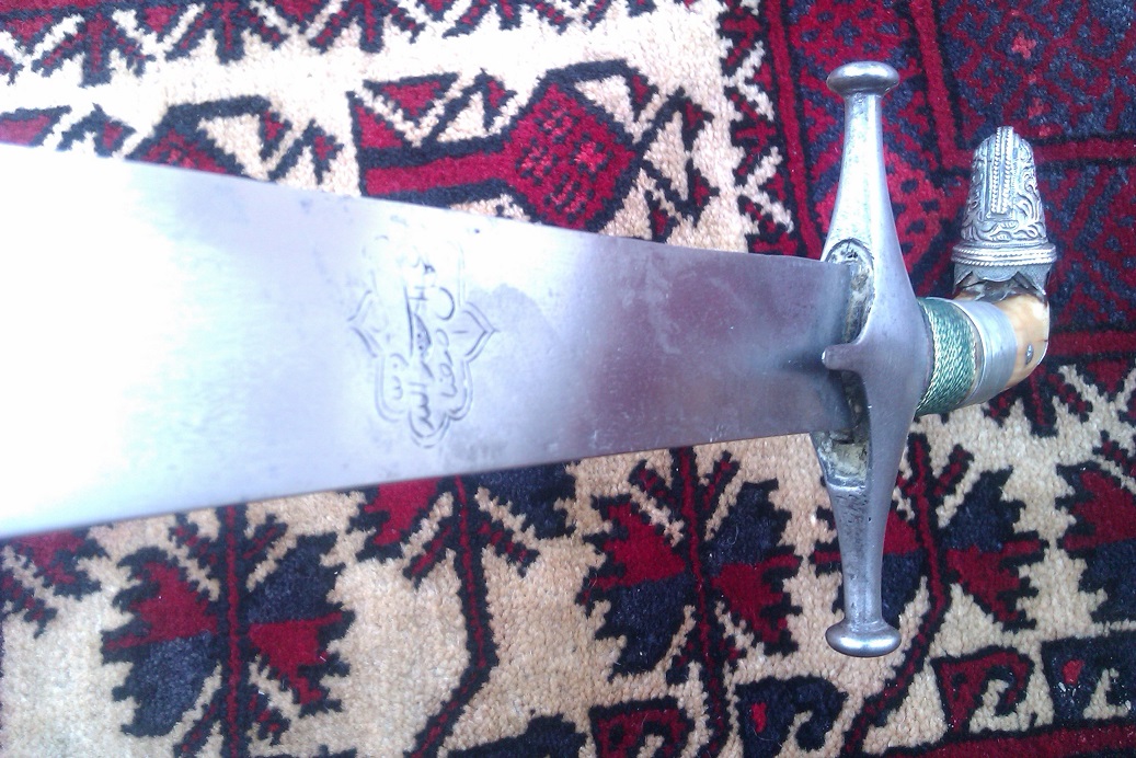

Default It is the work of Asadullah of Isfahan, Iran.
1. Yes I believe that this sword didn`t belong to Hazrat Ali (RA), you are right.
2. but Can you tell us that "What is authentic Assadullah inscription"? I think you only value gold inlaid inscriptions. I hope, if you remove the gold from inlaid inscription, they will look alike (crude etc).
3. I am 99 percent sure that The maker of this sword is Asadullah of Isfahan, Iran, no doubt, the remaining 1 percent remains for Lab certificate.
4. There are lots of Forensic labs which can accurately find out its age and its inscription instead of your comment "its crude so likely made later on the blade"
And why Mr. Asadullah of isfahan, Iran made its inscription crude on this sword, to get this answer i need a time machine to go back to the past.

Well, if you are sure, why would we try to dissuade you? Please continue to believe.

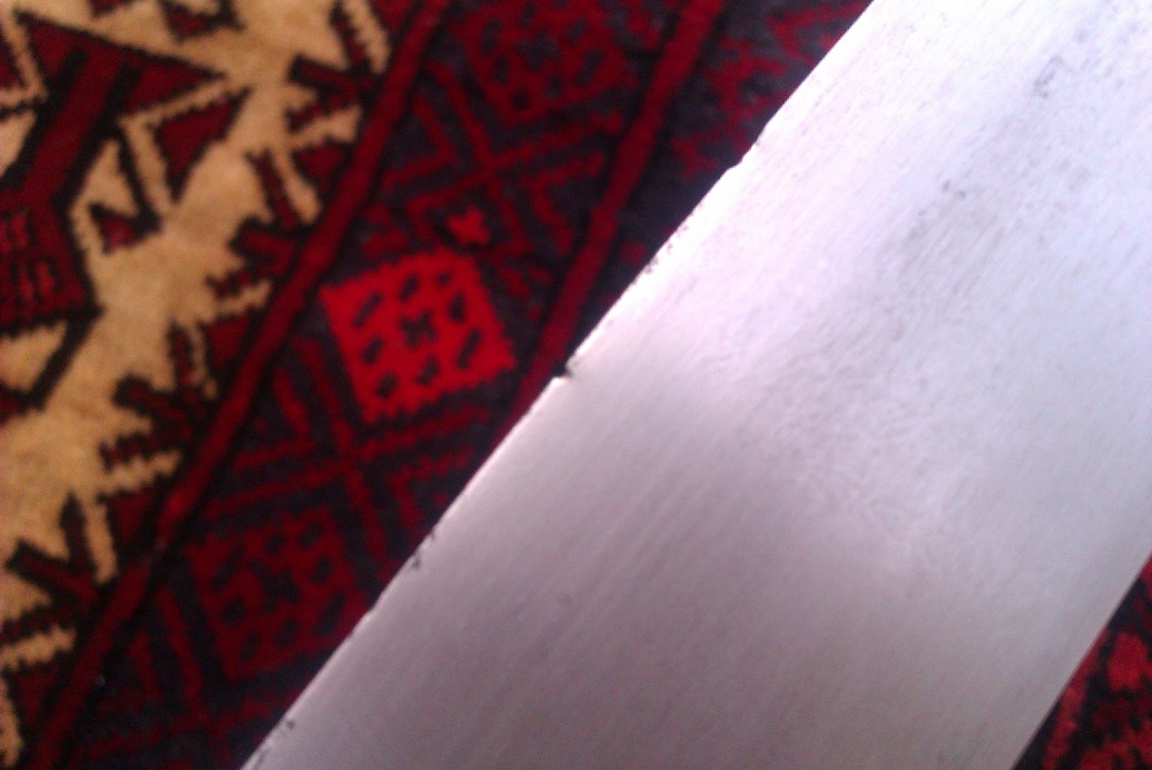

On my end, I know that Assadulla was famous for his sophisticated wootz pattern, of which there is not a trace here; that there are hundreds of blades bearing his name and dated as late as 19th century; and that all blades attributed to the real Assadulla bear extremely elegant inscription, which is not the case here.
You believe it is a real Assadulla, I believe it is a very late imitation. Each one keeps his own opinion. Sounds good?
