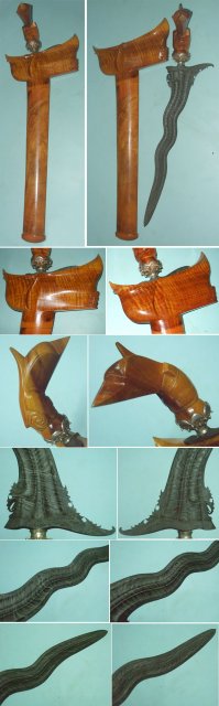

Hello everybody,
This is most probably a composite keris with a very nice hippo handle of Malay origin ( ? ), indicator: the high crest. The wavy blade Bugis / Sumatran. But no clue about the selut and moreover the sarong. It is an old piece with a flashy wood pattern but the shape is odd. Bought as a Palembang keris but the features do not match.

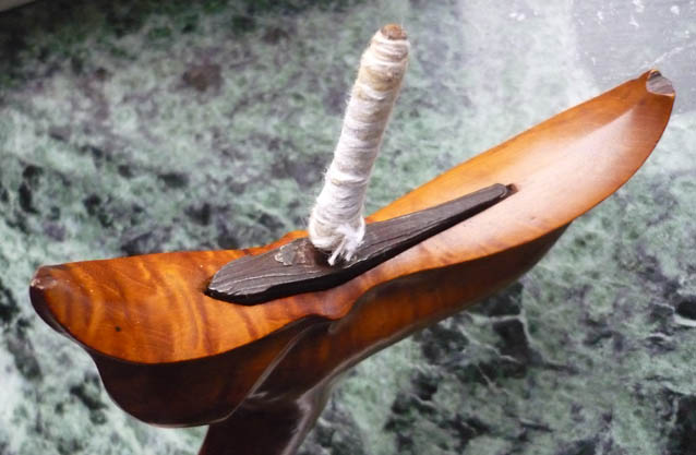

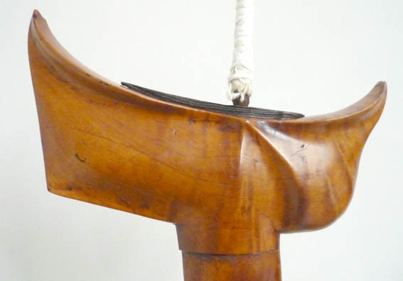

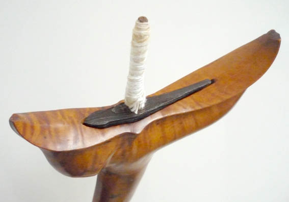

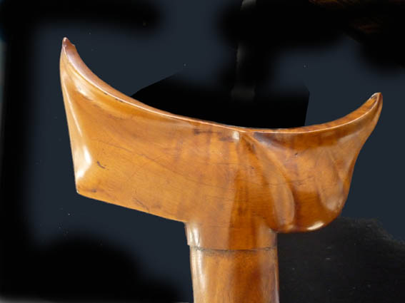

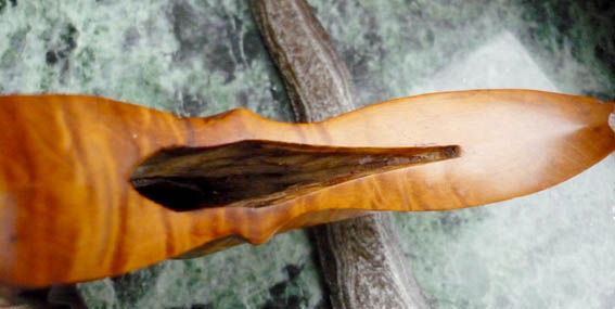

Thanks for the comments and hope the additional pics will be helpful and an invitation for more background information.....
My observations:
The ganja is peeping out slightly but not uncommon.
The tip end of both warangka wings are missing a small chip and the back of the sampir showing very fine haircracks indicating age, so does the dark dusty slot opening imo.
KLUNGKLUNG is offline   Reply With Quote
