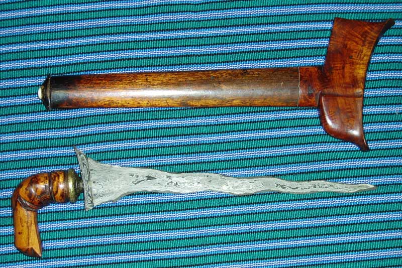

Hello friends, the keris is arrived. It's very nice and i think that is quite old. Tomorrow i will show you some pictures. Thank you.

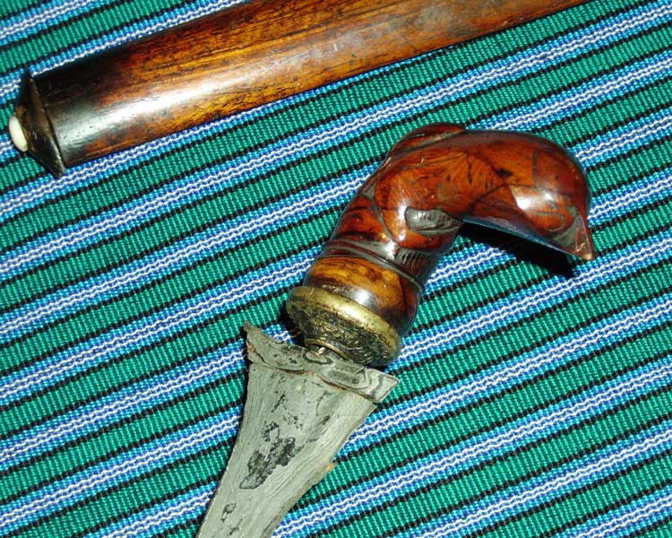

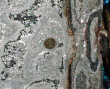

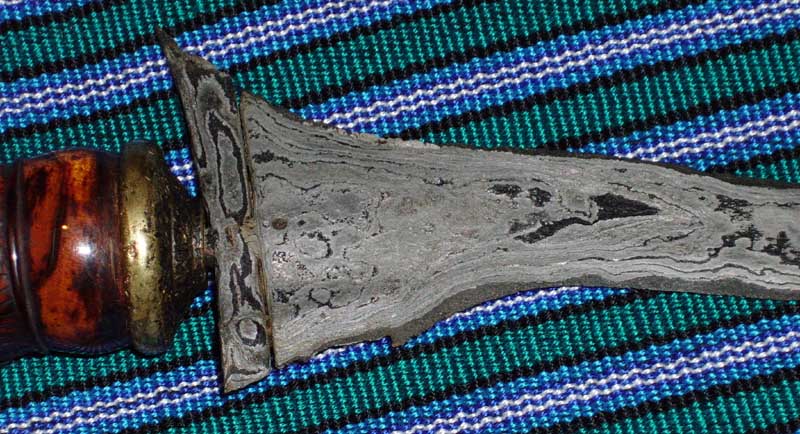

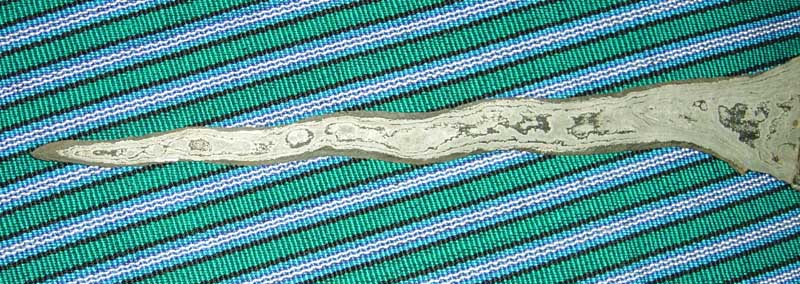

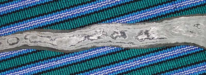

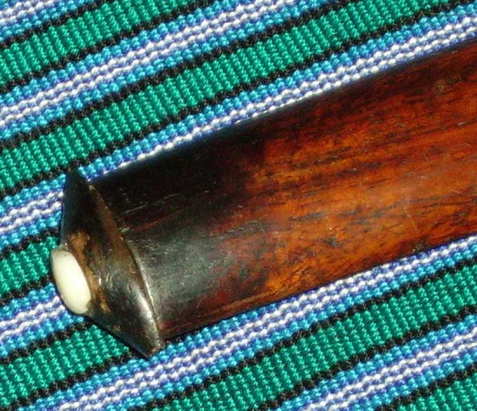

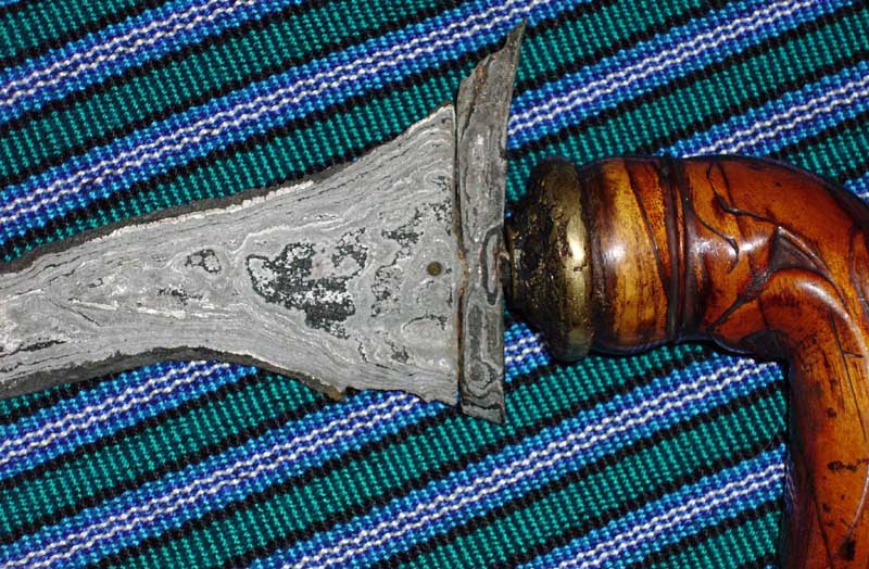

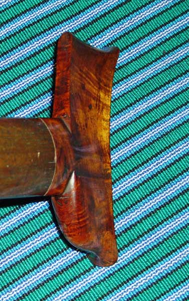

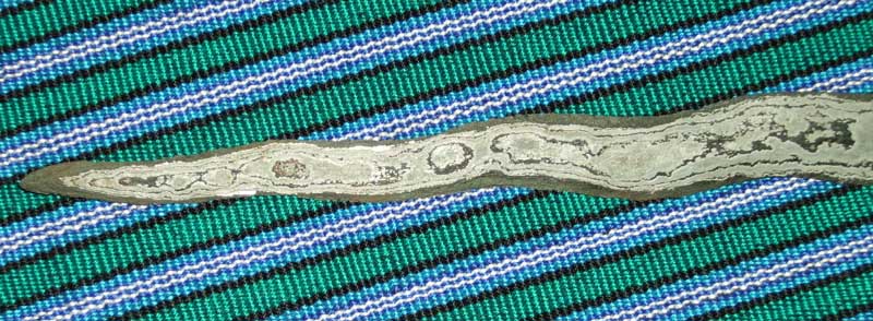

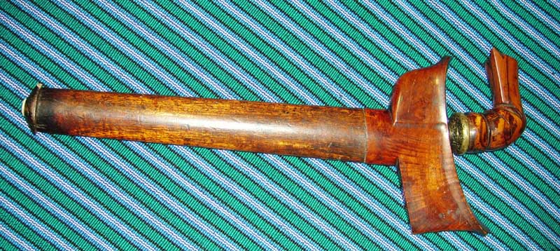

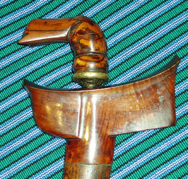

Here are the pictures. Let me know what do you think. About the tip of the scabbard i don't think that is ivory, maybe a portion of a shell. What about the small circular depression near the ganja? Is on both faces of blade, but it is not passing.
