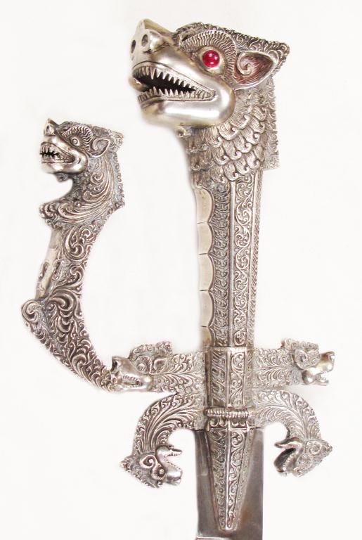

1. Just how old is the zoomorphically featured hilt, and what creatures are represented on its basic forms. While most references typically list the pommel as having a lionhead , which seems to correspond to the name of the people on this island, as well as the island itself (sinha=lion), Sinhala and Sinhalese....there are apparently some variations of the hilt.

I'm not seeing the word 'Dragon' anywhere in the description given:
http://www.caravanacollection.com/?p...kasthane-sword

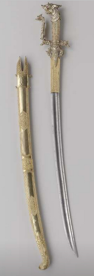

This especially fine kasthane has a silver pommel chiseled as a typical simha (lion) head with a prominent crest made up of an entwined liya-pata motif covered in sheet gold. A narrow, pala-peti design is around the mouth and this too has been covered in sheet gold. The gaping mouth has an orange agate or carnelian tongue that projects right out of the mouth and rows of especially sharp and naturalistically-rendered teeth. The snout on each side has a characteristic 'S' scroll. The eyes are large and distinct and comprise pink sapphires in gold mounts and with magnificently scrolled eyebrows. The ears are prominent and in leaf form.

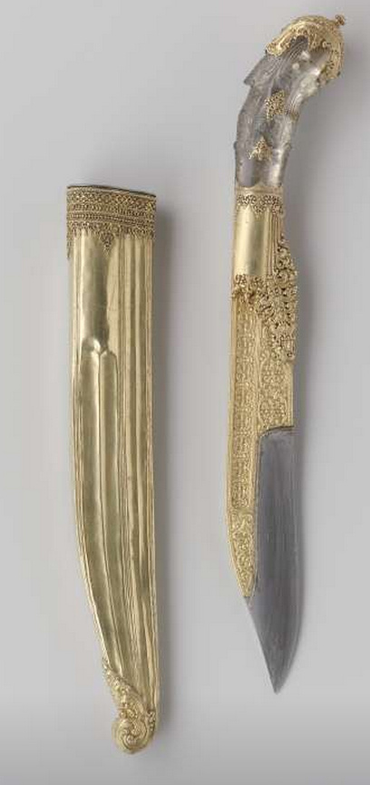

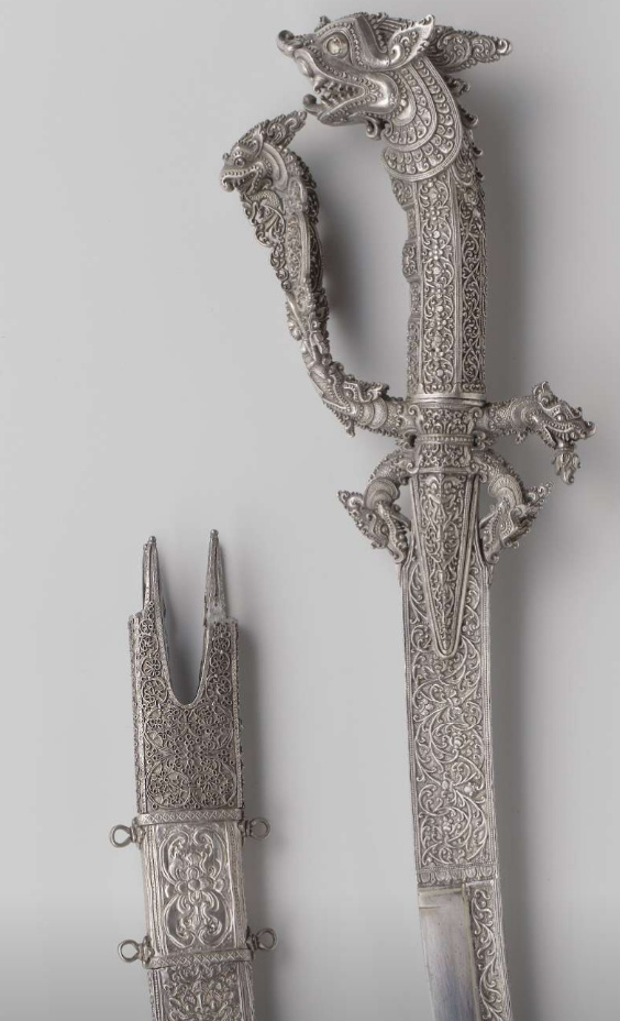

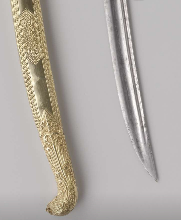

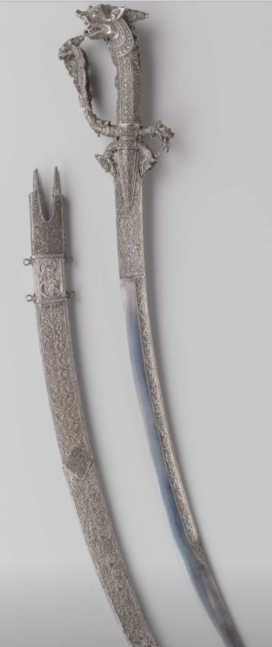

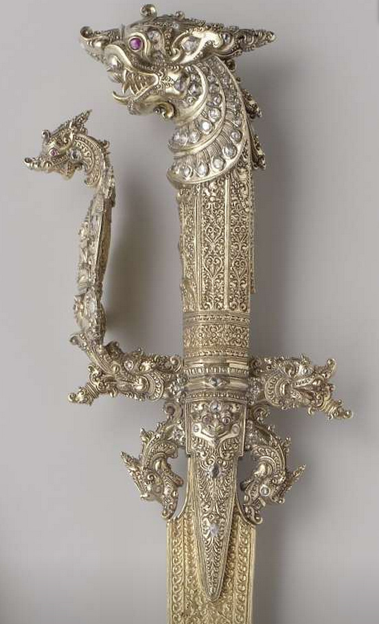

From The Victoria and Albert Museum see http://www.vam.ac.uk/users/node/17494
Quote"Sword and sheath (kastane) with a dragon-headed pommel
Steel, chased and embossed gold sheath
Travancore, Kerala, India
19th century
Museum nos. 2573:1,2(IS)
The kastane is the national sword of Sri Lanka. It typically has a short curved single-edged blade, double-edged at the point. The hilt comprises a knuckle-guard and down-turned quillons, each terminating in a dragon's head. The swords were intended to serve as badges of rank; the quality of ornamentation depending on the status of the wearer.
The establishment of European trading contacts with South Asia by the late 16th and early 17th century led to these swords becoming fashionable dress accessories among European gentlemen. A kastane can be seen in an equestrian portrait of Colonel Alexander Popham at Littlecote House in the care of the Royal Armouries Collection.''Unquote
I'm not in the business of issuing edicts on whether this was a cat or a lizard, a lion or a Makara since it could well be down to artistic licence and as you may know some deities morphed through several phases; The Lion even taking on Elephant form and the Makara or other deities vaulting from one design shape or imagined mythical style to another and at best very easily confused with each other. I leave that with the experts!
One part of the design I did like was the humano/crocodile face on the handguard...most peculiar! Perhaps we can address design features as we progress..and many thanks for the question about the dragon.

Well, i can see why Rick might have been confused by your post Ibrahiim. You write "This description struck me as pertinent…." and then end that sentence with a link before quoting from a completely different source which you do not credit. While i do not wish to imply that you were being purposefully deceptive here i do hope you can see how this might seem misleading to some.

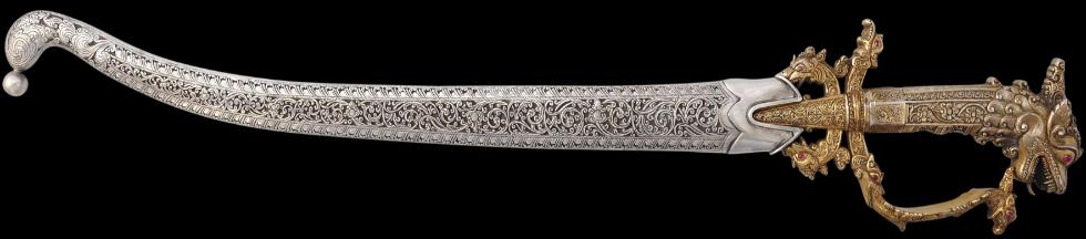

Naturally when viewing the key area of early European involvement it is important to realise that there are three prisms to look through ... one for each invading nation. Getting beyond the 16th C is in itself wrought with inconsistency not least because of the socio-political nature of the beast.(excuse pun)
The Lion Makara debate has been modified; replaced by a more carefully considered, balanced overview and in sympathy with the religious and cultural traditions of Sri Lanka. The fact is we don't know what form the artists were considering at the time nor whether the artists were working alone or with Portuguese artisans on these Kastane. Can you say that it is a Lion? Can you say you are sure what the artisans were doing in the Kotte Royal Workshops 500 years ago? If so, please do prove it.
It may be noted that simply viewing the hilt from the western ideal of Zoomorphic fails to address the full story since some of the Deities are half humanoid; take for example the little face on the hand guard (half human half crocodile at #2 above) thus they take the form more of the demi-god..though that is also a generalization and since many of the deities transform, change and re enter the equation as a completely different monster type... depending upon what phase they are depicting.
Another half humanoid monster "Kirtimukha" sometimes decorates the Kastane Rainguard see http://www.vikingsword.com/vb/showth...=indian+armour at #56.

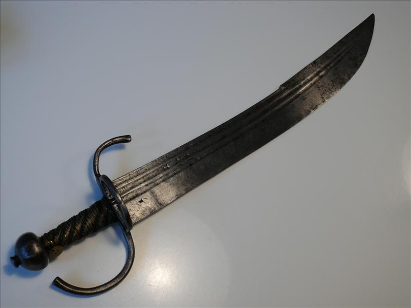

To continue my earlier post from an outside interruption, the point I was alluding to with the mysterious therionthrope in Trois Freres was of course that these curious figures, just as in considerable ethnographic iconography or for that matter even medieval heraldry etc it is often hard to determine what is actually represented . We can of course speculate using known contexts associated with the example being considered, but these things can seldom be proven with any large degree of certainty.
It seems well substantiated that the ancient mythology of Sinhala has considerable focus on the lion, therefore seemed well in place by the time of trade contacts and later colonial incursions. With this it seems quite reasonable to assume that the sinha (lion) would be represented on the pommel of these hilts . As with many forms of Asian iconography, the embellishment and flourishes extend far beyond what western interpretations of various creatures might expect.
Since there seem to be variations on the appearance of the creatures featured on the pommel of different examples of the kastane, we have clearly instances of artistic license possible, as well as potentially other influences affecting the portrayal of the figures on the hilts.
I believe the analysis of these varying forms are more to the artistic aspects iconographically and individual examples should of course be attended to on their own merits and unique features.

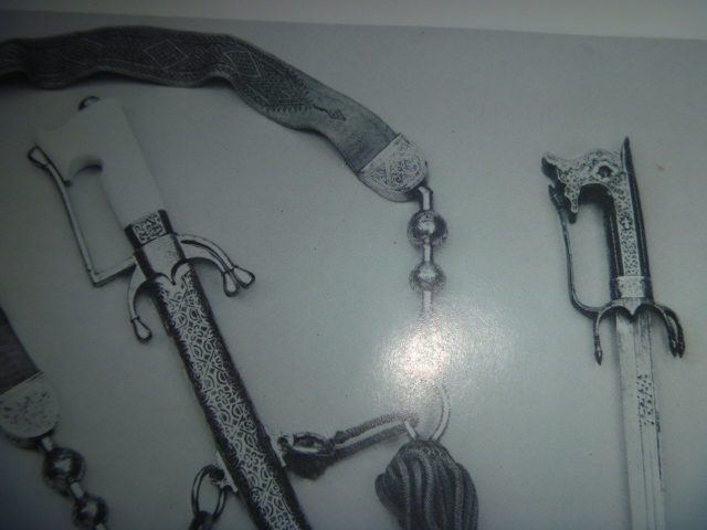

Returning to the larger scope of our discussion, what we are trying to determine is just how long ago the use of figured iconography began its use on Sinhalese swords, specifically the kastane. Just how far back does the kastane hilt as familiar today go back in Sinhalese history?
Until the discussions on the previous thread ('Sinhalese/Sri Lankan Swords) I had assumed the Sendai Museum sword to be one of the earliest examples of the hilt (c.1600-20) but interesting instances farther back were presented by Prasanna. Hopefully we can gain more data and perhaps images of those.

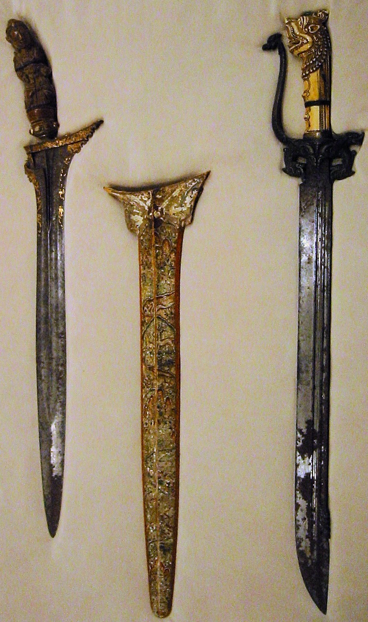

The Sendai (Hasekura) example (Keicho Mission) for Date Masamune of Japan has proven most interesting with the question of exactly where it was obtained by Hasekura. While it was speculated that this sword was acquired from Philip III of Spain while the mission was in Madrid, it is now my understanding that this was probably acquired in the Philippines in the two years Hasekura was there. Rather than being a 'presented' item, this seems to have been more an acquired item along with the kris with it. This seems more in line with the lack of documented narrative concerning these items.
The questions which intrigue me on this particular kastane are more toward the interesting blade, of somewhat falchion form and with the 'monster' head at the blade peak which indeed does correspond to similar creature detail on a glaive type Chinese blade posted by Vandoo. We know of course that the Philippines as a trade entrepot had presence from Sri Lanka, China, Indonesia and of course the major powers .
Could this kastane have been mounted with this blade in the Philippines and been acquired by Hasekura as an interesting novelty to present to the Date?
These are the questions I hope to follow here. The dialogue on the artistic representation on kastane hilts is always interesting, but I think that its subjective nature often creates a certain volatility. Just the same, these figures are of course an integral part of the history of this weapon, and should be approached with a great deal of patience as differing views are examined.

THE KRIS PICTURED WITH THE KASTANE MAY BE CLOSER TO THE EARLY PHILIPPINE KRIS OR MALAY KRIS. IT WOULD BE INTERESTING TO KNOW THE MEASUREMENTS ON THE TWO ITEMS TO HELP DETERMINE IF THIS IS A KERIS OR A KRIS. THE TWO COUNTRYS WHERE THE KERIS BECAME LARGER AND CHANGED TO WHAT WE NOW CALL THE KRIS WE BELIEVE WERE MALAYSIA AND THE PHILIPPINES. LIKE THE KASTANE THE HISTORY OF THE KERIS IS UNSURE WITH MANY QUESTIONS UNANSWERED. I HAVE A VERY OLD KRIS SIMULAR TO THE ONE SHOWN THAT HAS BEEN DISCUSSED ON THE FORUM BUT MORE QUESTIONS CAME UP THAN WERE ANSWERED.
Old 8th February 2014, 11:21 PM   #18
Posts: 7,303
Barry, i wouldn't want to derail this thread that is specific to the kastane with a discussion on keris, but i don't think there is much doubt that the keris in the Sendai museum is indeed an Indonesian one. There may be some room for debate about it's exact origin (Bali, Jawa???), but it has too many tell-tale features (including kinatah which i have never seen on a Moro kris) of Malay work. I has been described as being 511mm in length, which i believe includes the hilt. A very detailed description of it can be found on this thread (post #40) link below, which i believe Ibrahiim has previously provided a link to and i would suggest that you revive that thread if you would like to discuss the keris so this thread can continue with it's specific investigation into the kastane. http://www.vikingsword.com/vb/showth...t=sendai+keris

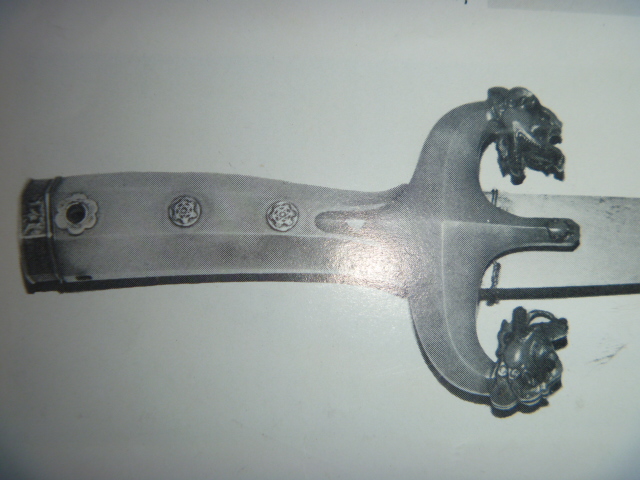

Salaams all ~ Note for comparison. There are several sword groups that may have influenced the Kastane design and viable evidence suggests who may have delivered similar sword forms throughout the early years and encompassing(and bracketing) the first Portuguese arrival in 1505. I turn to "Islamic Arms" by the late Anthony North for two such swords for comparisons. The vehicle for such cross pollination in styles are possibly the famous sea traders of Sri Lanka; The Moors. (see note below*)
The weapon displaying quillons with remarkably similar dragon style finials from the above "Islamic Arms" is Quote"The hilt of carved jade mounted in gold, the blade of watered steel Persian, late 15th century Topkapi Palace, Istanbul".Unquote.
The weapons known as Nimcha are equally intriguing as to potential design influence where Moroccan style may have been transmitted.

These are outstanding references Ibrahiim, and thank you for the interesting link to the online reference on the Sri Lankan Moors, which indeed adds some important perspective to understanding some of the ethnic and colonial complexity of Sri Lanka.
As you have well noted, Anthony North does address the potential influences of Venice and Northern Italy on these swords, and specifically cites the distinguished French arms historian Charles Buttin:
"...Charles Buttin, who had a considerable number of Moroccan swords in his own collection, and published a paper on them, detected a number of influences in their very individual hilts. He pointed out their similarity to the indigenous sword of Ceylon, the kastane, and discussed their relationship with European swords".
(from "Les Poignards et Les Sabres Marocains', C.Buttin, Hesperis, TomeXXVI, 1939, p.1)
In this the distinct similarities in the guard systems of the hilt are noted, and in his closing comments, North states, referring to the North African hilts, that "...at least one of the influences of these hilts-and perhaps the strongest-came from North Italy-possibly as early as the 15th century".
from "A Late 15th Century Italian Sword" , A.R.E.North, 'The Connoisseur, December , 1975, pp.238-241)
It would seem clear that the influences of Venice in their powerful trade networks almost certainly introduced their weapon forms and styling into many cultural spheres . In this case it would seem that this style hilt configuration quite likely was filtered into Sri Lanka through the Arab traders who populated the Sinhalese littoral in their ports.
The guard and quillon configuration was specifically placed on the original Italian swords to correspond to their unique style in fencing techniques and as part of the developing hand guard systems of these swords. It would seem that this quillon arrangement was adopted by Arabian and of course the North African regions noted in more of a stylistic sense.
In the case of the kastane, while the hilt form is of course stylistically similar, it has become even more vestigial in the downward quillons next to the blade, and the terminals of the guard and quillon are vehicles for the subordinate beast heads.
The identification of the key figure on the hilt, the zoomorphic on the pommel, of course remains a quandary, and it seems in most cases must be considered specifically with each example as there appear to be numerous variations. Naturally in the scope of journalistic references the pommel beast is described by authors in much variation, which seem to reflect whatever sources they may have used in their research.

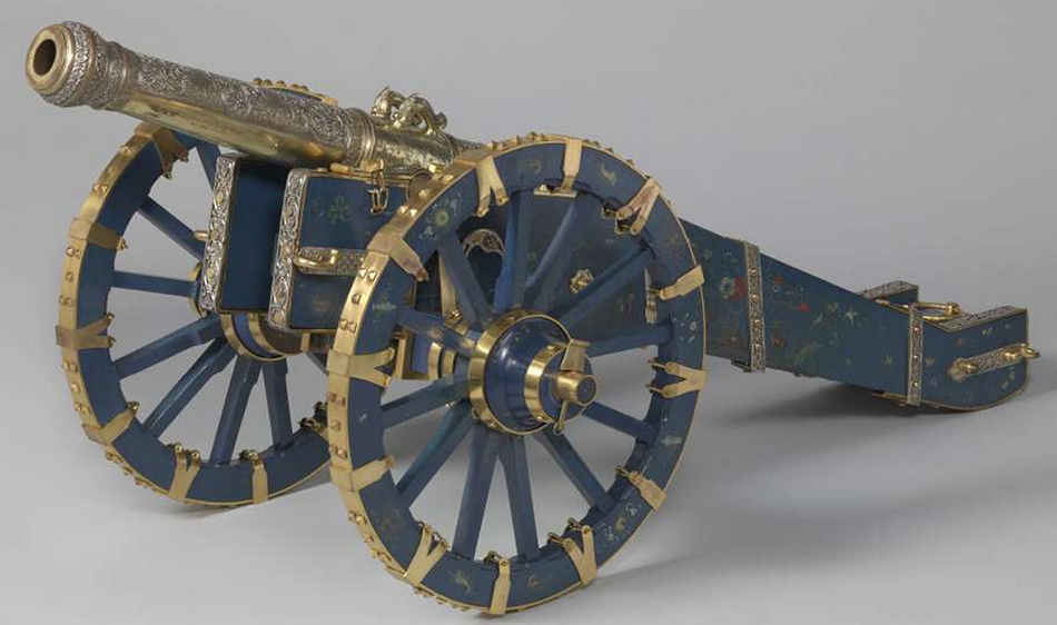

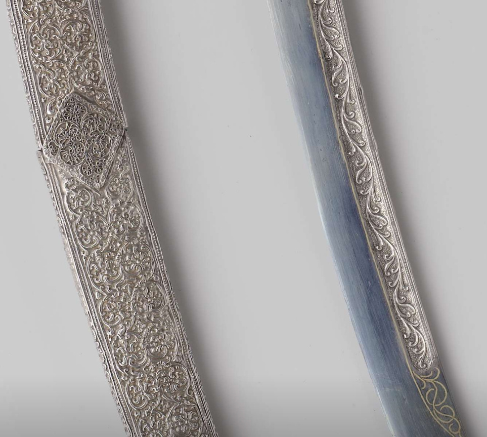

For interest below ~ Portrait of King Rajasingha II of Kandy (1608-1687) (Reign 1635 – 6 December 1687)
Ibrahiim al Balooshi.
