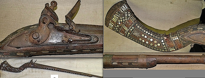

First is a collage of the seller's photos.

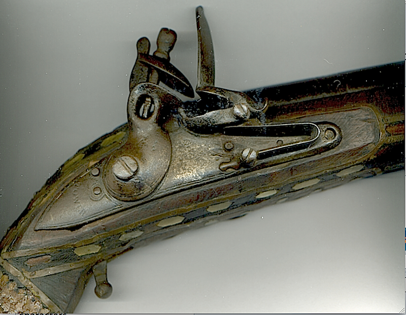

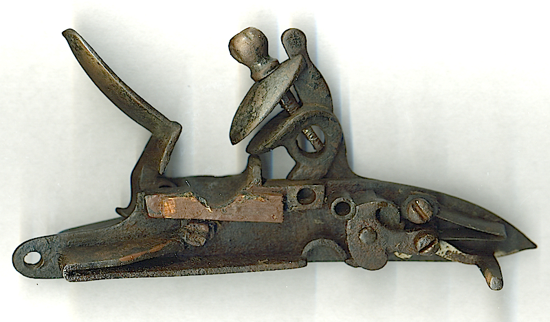

Next the lock, analyzed by a kind (and tactful) friend on the British Militaria Forum thusly:
the lock may have begun its days as an Ordnance India type 1. I don't know where the cock came from but it isn't original. Someone did a little extra engraving around the sear screw on the front of the plate. I don't think the tumbler is original, and probably due to the differences in where the replacement cock sits on the stop, the main spring is perilously close to going off the edge of the tumbler. Surprisingly the springs and screws look right. Someone at some point in time took exception to the crown.

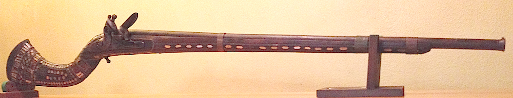

Next a view of the entire assemblage after cleaning of accumulated dirt and dry red rust.

The lock is the 1793 India pattern type 1. The double line around the sear screw is slightly unusual but presumably even ordnance contractors were permitted a small degree of self expression. Normally its a single line and was omitted altogether on the 1809 type 2. The cock is 1809 type 2 , Their isnt anything inconsistent with this since the basic locks are the same and after the end of the Napoleonic war the Ordnance system had a vast stockpile of parts to use up . I have one stamped crown V.R. so even as late as the 1850s the Tower was still assembling these locks for use in far flung corners of the world. And yes . the spring is about to drop off the end of the tumbler , but this is generally just wear and tear. Hope thats helpfull.

Oof! That's a hefty-looking barrel, Berkley. Looks like a nice piece though. The mother-of-pearl's probably recent but quite artistically done, which is always satisfying to see. What sort of dimensions is she?

Raf, thank you very much for the further information on the lock. That is very helpful indeed.

Trenchwarfare, I feel well pleased then, since I was the only bidder for this "North African flintlock musket" and got it for the opening bid - well under $500.
