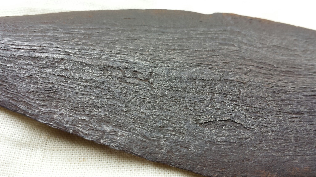

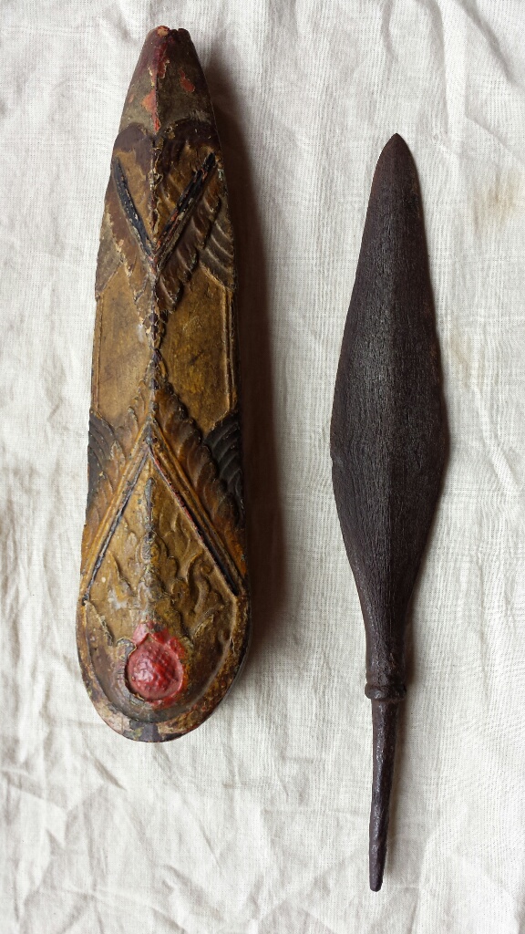

I recently acquired this spearhead and sheath. I honestly know nothing about it and would appreciate all comments. Where is it from (I'm thinking Lombok), and how old do you think it is?
The scabbard is lovely, showing signs of real age. Sadly there is some recent damage. There is a (very) little rust on the blade, what is the best way to deal with this? I am imagining that steel wool and oil would NOT be the best approach with a blade with pamor like this!

nice piece. I'm a rank amateur at this stuff so can't help with i.d. and age etc. But I think Mr. Maisey posted recently on updated cleaning methods he uses for cleaning keris. He mentioned that the Golden Circle Pineapple Juice used to be his cleaning solution of choice but due to a recipe change of the product he has now switched to a vinegar solution.
I'd recommend searching for vinegar de-rusting posts and seeing if vinegar might be applicable to your item.

nice tombak and more nice to have the scabbard, although I think that the tip of the scabbard is missing. How long is the blade without pesi (tang)?

I think that your tombak is from Java, age difficult to say. A cleaning with lemon juice will remove the rust but you can use vinegar as well. A warangan (traditional stain) will bring out the pamor.

I would also add that oil and #0000 steel wool will NOT hurt the pamor of this blade.

The dimensions are:
OA Length: 300mm
Blade length: 220mm
Blade width (max) 47mm (6.3mm thick at this point)
Weight: 158g

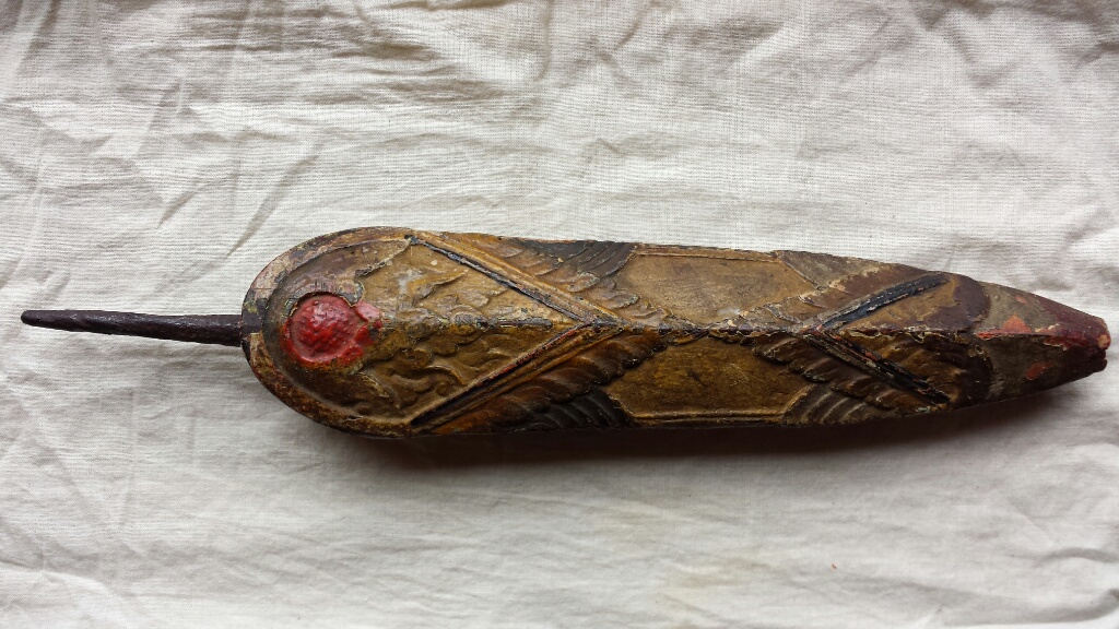

As you suggested, sadly the tip of the sheath is missing. If I can get a better idea of the shape of the missing piece I may be able to make something to replace it (although I would certainly not permanently attach it).

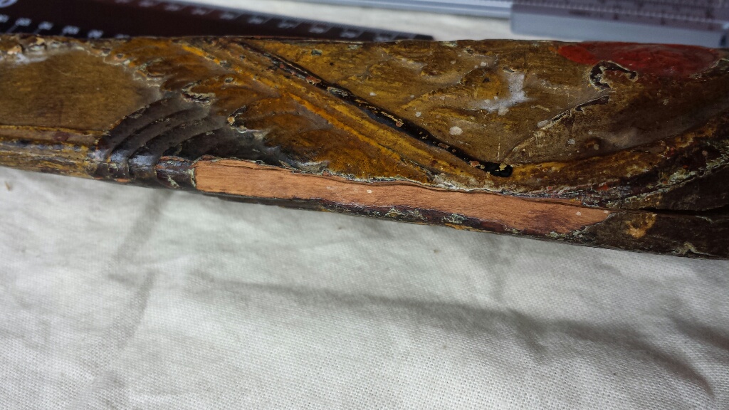

More unfortunate is that a small portion of the sheath has been lost, probably quite recently (see pic), I contacted the seller in the hope that he may still have the missing piece, but sadly he didn't. I am not confident with that sort of repair so I will have to leave it as is (and mutter under my breath every time I notice it).
I was hoping that the carving and painting style may indicate it's origin/age. It has many coats of paint, and seems to have been a variety of colours during its life.

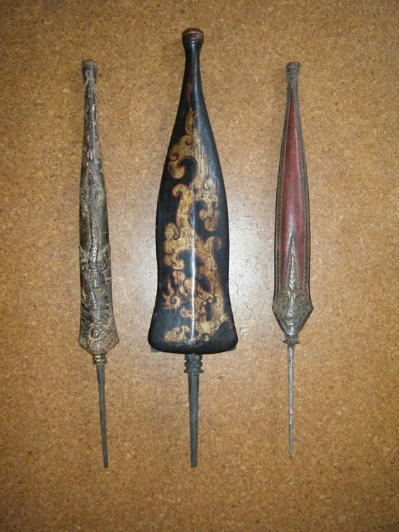

so it's bigger as I thought. Like I write before, I am nearly sure that this tombak is from Java. When you want to have restored the sheath contact me. The tip of the scabbard will have looked similar like the shown examples.

Detlef, would you please email me some close-up pics of the sheath tips? From mine it seems they are constructed separately from the rest of the scabbard and attached later. I would love to have the scabbard properly restored, but I fear that the cost (including return postage to Germany if I used your restorer) would be more than the item is worth.

I doubt that this blade can be considered to have pamor. Pamor is the outer skin of a blade that has a core. This blade does not appear to have a core. It believe that close examination would reveal that what we can see is a simple blade made of iron, the grain in the material shows that this iron has been worked in the forge, ie, forged out, folded, welded a number of times to get rid of impurities and make it useable.
Sometimes a blade will use plain worked iron rather than pamor as its outer skin, in such a case we would call that iron outer skin "pamor sanak".
I've looked long and hard at the pics of this blade, and the only rust I can see is slight discolouration in a couple of places. I'd soak in WD40 for a week or so and then give it a brushing with a hard brush, maybe a bit of steel wool on the end of a sate stick could be used on some of the spots. If the rust is worse than I think I can see, then maybe a soak in vinegar.
This is an old tombak with a somewhat scarce form, but it is of very ordinary quality.
Personally, I would not bother with restoration of this scabbard, but having said that, it is totally restorable, and easily so. All you need to do is attach a new piece of wood to the tip with a mortise & tenon joint, recarve it with a little finial similar the ones Detlef has shown, and match the colour. The little missing piece on the side can be repaired in a similar fashion. I'd probably use Aquadhere for the tip, and 5 minute Araldite for the little missing piece on the side, but I could well opt for using Araldite on both joints, depends on a number of factors what adhesive I'd use.
