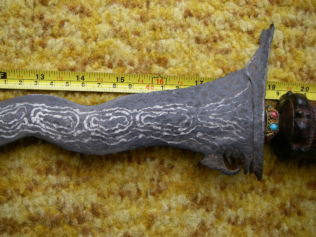

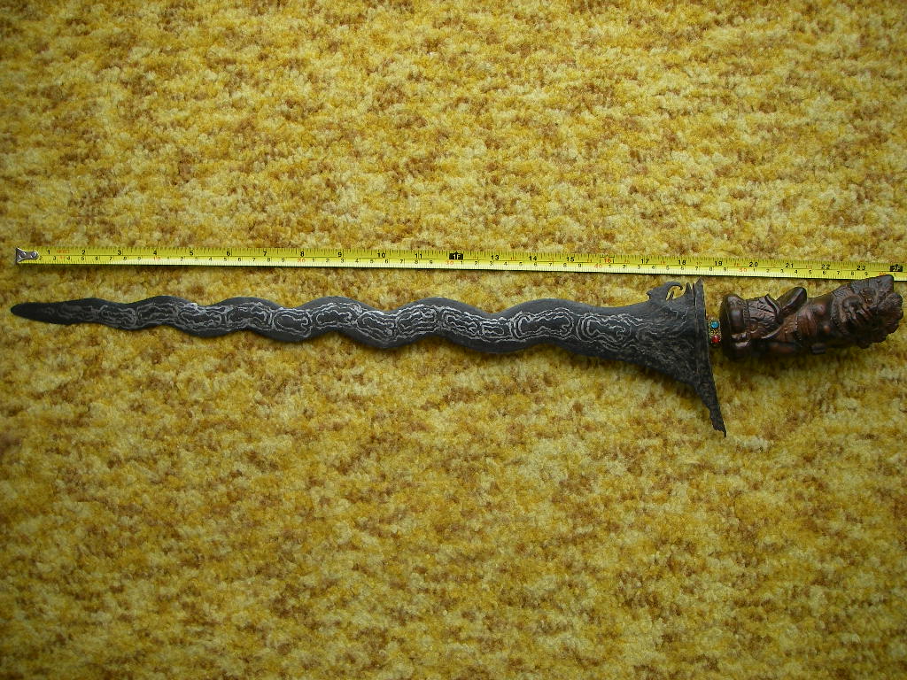

Greetings all,
I have just now acquired a Keris which seems to me to be larger than normal. The seller (who probably knows even less than me!) thought that it is ceremonial rather than for use as a weapon. It is 25 inches long. The blade seems rather thin for use as a weapon. The Keris appears to me to have some age.
Any comments at all, good or bad, will be welcome. I paid very little for it, so not too worried about criticism.
Brian

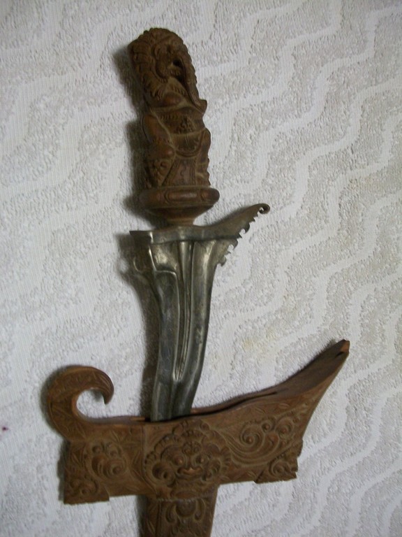

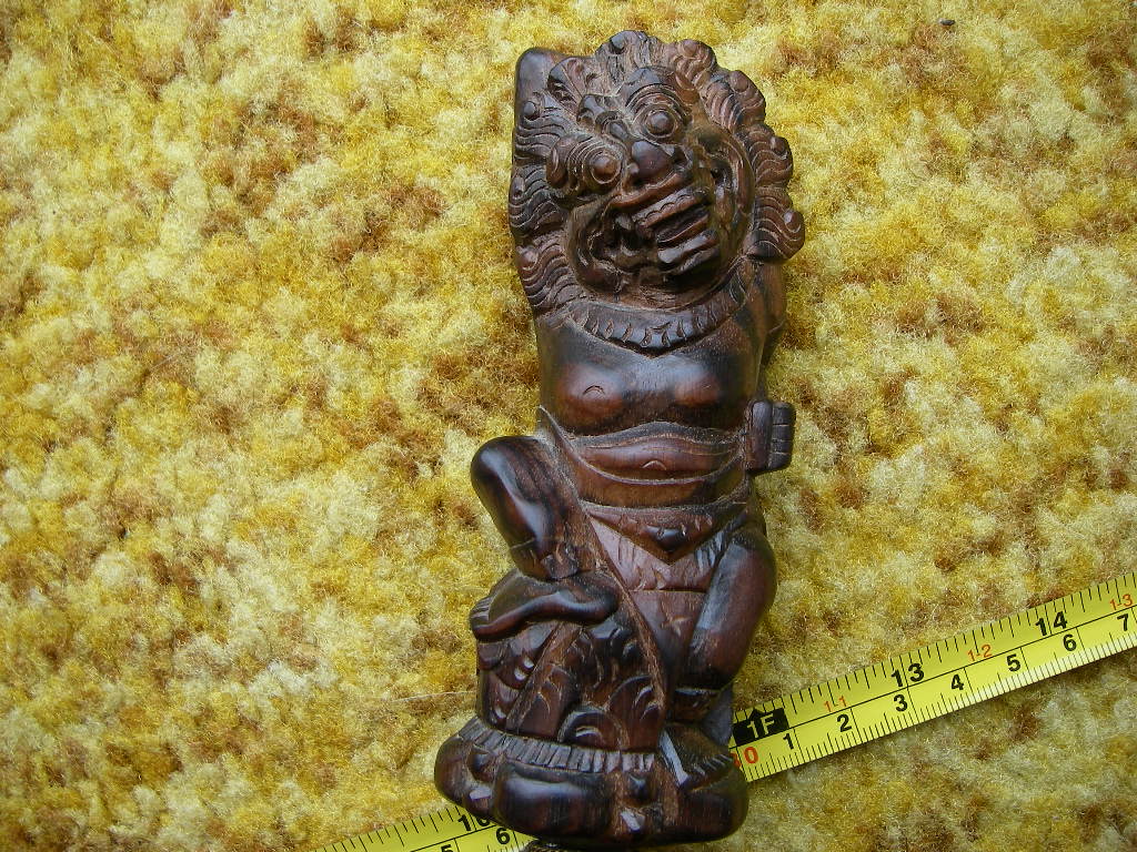

A Balinese kris with the hilt in the form of Naga Sari (spelling?) who is a Balinese rice demon.
The dress is of recent manufacture. Not sure about the blade - I'll let the others answer that one.

Sorry, bad news. This is a typical balinese tourist keris, the pamor is not a real one. Handle is nawasari in correct spelling.
Old 14th October 2013, 03:46 AM   #4
Posts: 7,297

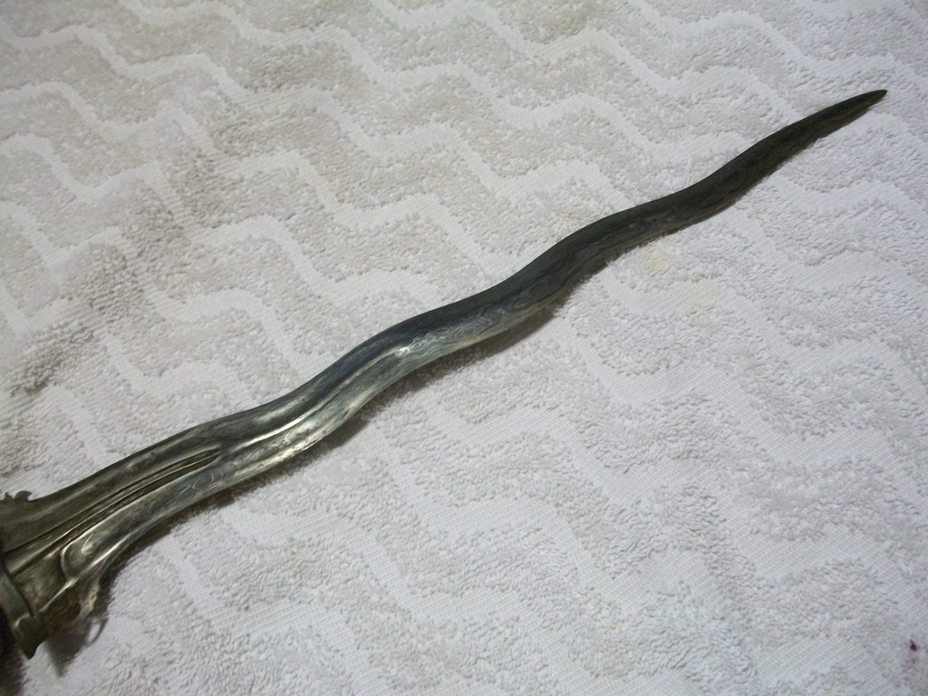

I am afraid i am in agreement with Detlef. The pamor pattern here is fake. It has been painted on. This is a somewhat better attempt for a tourist keris than some. The form is a bit better and there is a separate gonjo, but i would still say this qualifies more as a "keris-like-object" (KLO) than the real thing.
Old 14th October 2013, 04:16 AM   #5
Posts: 7,228

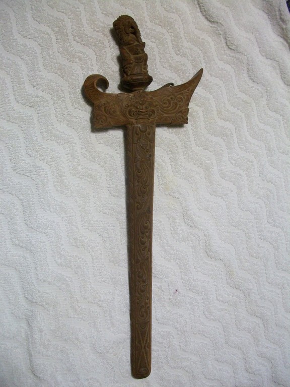

I'm sorry gentlemen, but based upon what I can see in the photo, I am not prepared to give this an unqualified designation of "tourist keris".

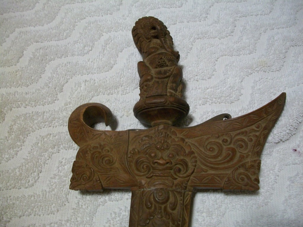

Yes, the scabbard and hilt are definitely manufactured for the Bali souvenir market, but not within the last few years, I'd place this work around 1970-80.
The blade is probably a plain old Balinese or Lombok blade. I've only got a photo to work on here, but I have never, ever seen a blade produced for the souvenir market that has had as much work put into it as this one. From what I can see, this is a genuine keris, however, a rather plain one. We must not forget that the vast bulk of keris were made for the vast bulk of people and the vast bulk of people did not have vast bulks of money.

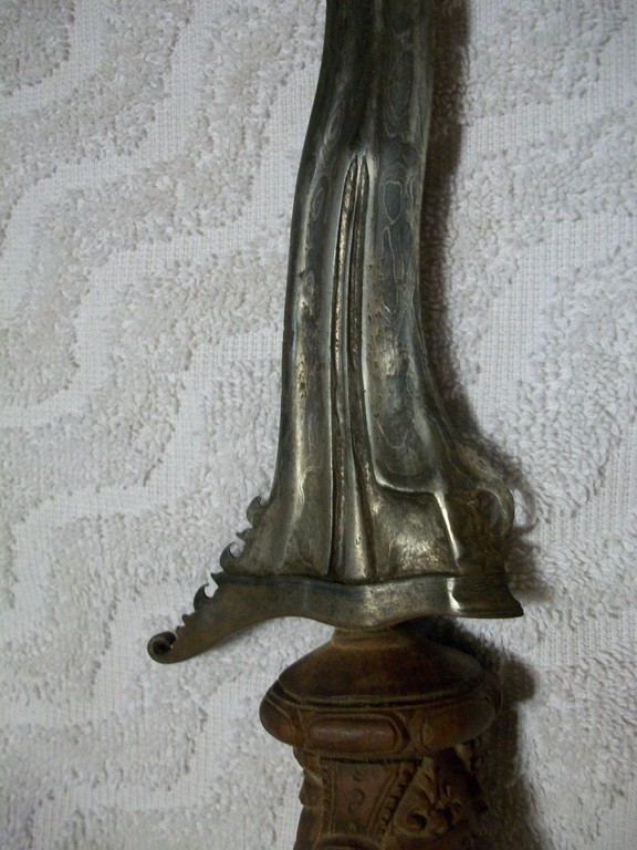

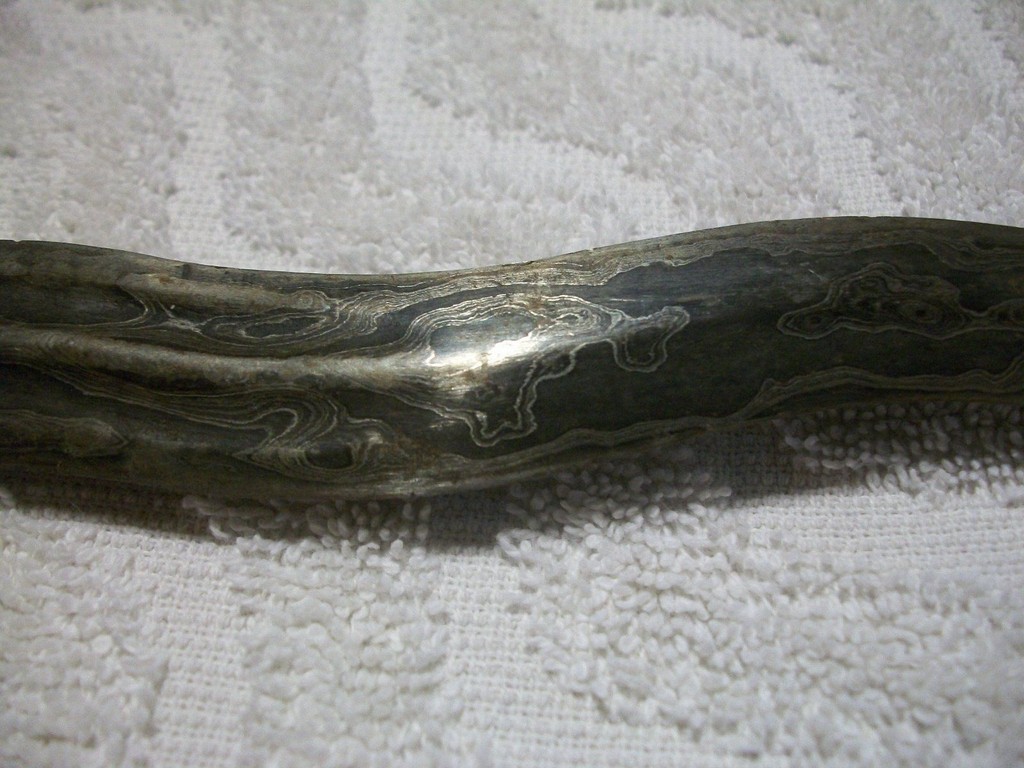

However, to improve commercial appeal the "pamor" pattern has been produced by batiking the blade --- the pattern applied with wax, the blade stained, the wax washed off with boiling water.
In fact, I have now come to believe that keris like this one do have a place in a well balanced collection. Decent ones haven't been around in Bali for quite some time.

This style of ugly scabbard and hilt was still made during my last visit to Bali in 2007 but I agree with Alan that the blade seems to be a common quality one with some age and without pamor which was "treated" to make it more attractive. Personally I would try to clean the blade in vinegar which should remove the residual rust and fake pamor, and stain it again.

Yes Jean, still made, but of very poor quality.
The early ones could often be very good examples of skilled carving.

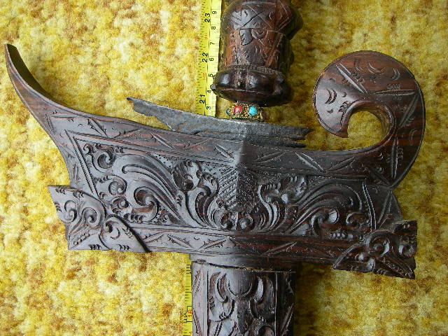

The dress is a better carving than some of the examples i have seen of this dress form and i am of the mind as well that a good example of this dress does have a place in a well balanced collection and indeed have one with a much better blade in my own collection. While this form has become synonymous with the classic tourist keris i have also heard it referred to as "dance dress". I have thrown the question out before as to whether or not this could be the origins of such dress, but have never received and definite confirmation on that question.
Brian, i am with Jean in the suggestion that you try to clean and restain this blade in order to remove the nasty fake pamor.

I completely agree with Alan.
It is one of the better examples I've seen. And I've seen a lot of these cheap fake kerisses on the Dutch Indonesian markets with blades cut from sheetmetal.
Fake pamor? Yes and no. Probably a pamorless blade that turned into a pamorblade by the batik treatment.

clean the blade and, if possible, etch it. A real pamor may appear.

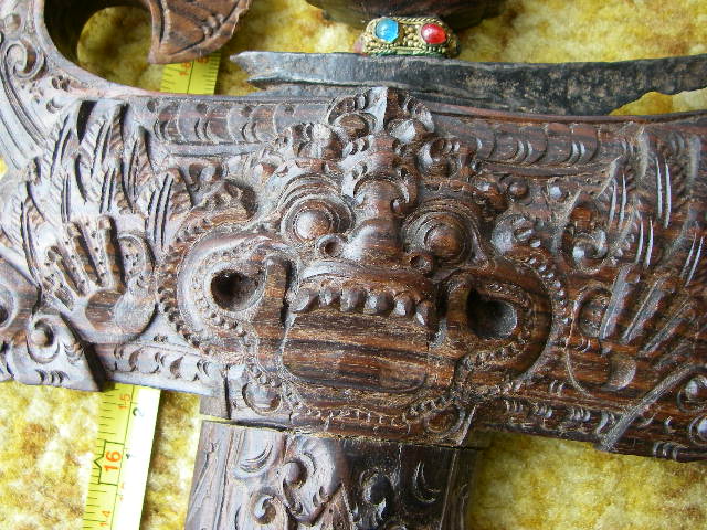

Never knew that the backside of these wrangkas were carved with such nice motives.
Thanks for sharing!

GIO, while you are most certainly welcome to your personal opinion you may want to consider putting this into Brian's perspective. He is a general collector of weapons who only very casually collects the occassinal keris. He paid very little for this particular example. I doubt he is looking to spend much more to create an "ideal" example of a Bali keris. Given the quality of the blade itself it also wouldn't make sense even to me as someone who specializes in the collection of keris to throw much money at redressing such a blade when it has serviceable dress already. Your suggestion that he throw away the hilt and sheath seems a bit extreme to me. Cleaning and restraining the blade certainly seems worth the effort to return some dignity to this keris, but i am in agreement with Alan that even this apparently touristy style of dress has a place in a well rounded collection. This particular one is actually of better carving than most that i see of this type on the market. I am still left unsure of the origins of this particular dress type and don't know if it was ever acceptable for indigenous ethnographic usage, but as VANDOO points out it is a style that has been in existence for at least 50 years. To properly redress this blade would cost hundreds of dollars and Brian seems happy with the look of the ensemble as a display piece so i can't see why he would want to spend more money than he paid for the thing redressing it.

This is a non-traditional style of wrongko that does not fit any purpose in Balinese society --- except to sell to foreigners. There is a Balinese style, that is usually associated with a Balinese settlement in Madura, that echoes this scabbard style, it has a metal mask of Boma on its face.
With the early ones that were made, and through to the 1970's, maybe even early 1980's, old blades very often had this style of dress made for them, simply so they could be sold in the souvenir shops. It was not a re-fit job, not a matter of making the scabbard and then fitting a blade, it was a process of:- acquire blade, make dress, sell to tourist.
The uwer on this keris will be found to have plastic "jewels". It looks OK, but the "jewels" will be little bits of plastic.

The reason that the early examples of this type of dress used old blades, sometimes of rather acceptable quality, is that way back then keris in Bali were very much undervalued.
In the 1960's and 1970's the value of a keris in Bali was next to nothing.
So, people had old blades hanging around, that had no scabbard or hilt, and thus were unsaleable to the tourists as souvenirs, because the tourists, being mostly westerners, did not understand that the true value of the keris, both monetary and spiritual, was in the blade.
To make these old blades saleable they were given to the carvers in Mas who developed a form of dress that displayed the carvers' skills and which was attractive to the visitors to Bali as a souvenir.
Eventually the real blades ran out. There was now a market for these souvenir keris but no real blades were left to fill the scabbards.
So the Balinese people began to produce keris blades made from flat iron and give this flat iron a false pamor.
The tourists didn't care, they were buying the carving, not the blade.
People go to Bali now and come home with their suitcases full of clothes with prestige labels --- all fake of course, but in the best examples as good as, or maybe even better than the originals. I know two professional women who go to Bali every six months to update their wardrobes.
Factories are set up to produce the famous brands of surf clothes. Factories that the Australian owners then go to Bali and burn down, only to see them in production again in 6 months time. Or sooner.
In Bali, as in Indonesia in general, fake everything floods the market. You really do need to be very, very skilled and knowledgeable to buy any genuine article of any kind from an Indonesian source.
But back in the 1960's, 1970's, and even as late as 1982, it was very different. If you went to Bali for a holiday you always took your old Levi jeans and a couple of second-hand surf towels. A pair of Levi jeans would cover a week's accommodation in a homestay.Including breakfast.Black rice pudding or banana pancakes.
You could exchange the towels for the other comforts of home.
When we consider anything at all to do with keris we need to consider not the keris, but the condition of the society at the relevant time.
This is as true of the recent past as it is of the distant past.
Don't ask your questions in terms of just the keris.
Ask your questions in terms of the society.
