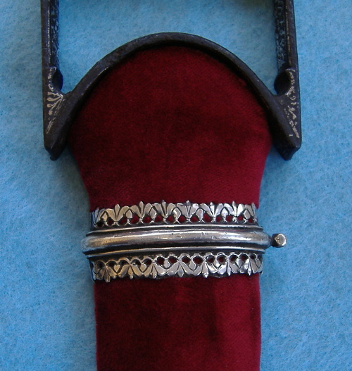

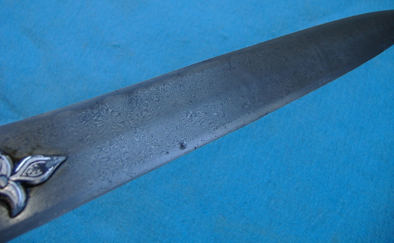

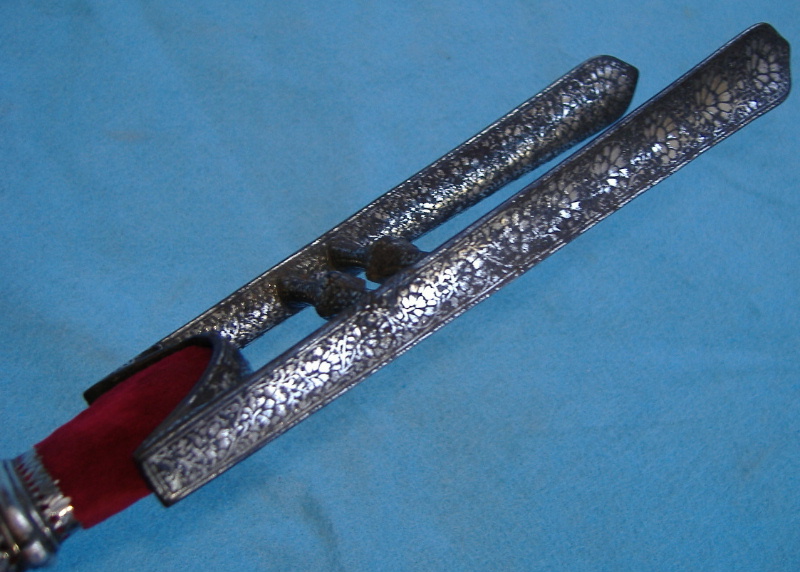

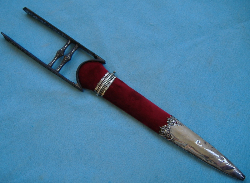

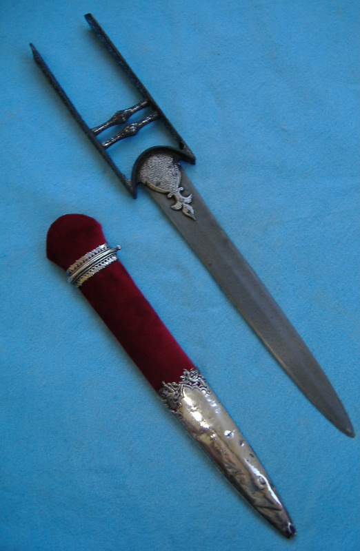

I just bought this katar last weekend, and the seller and I both agreed it could use a little work to look better, but it clearly had a very good, old wootz blade of very high contrast, and just short of being a ladder pattern. Much of the silver had tarnished black as had the scabbard fittings. The scabbard's fabric had dry rotted and was hanging on in tatters.

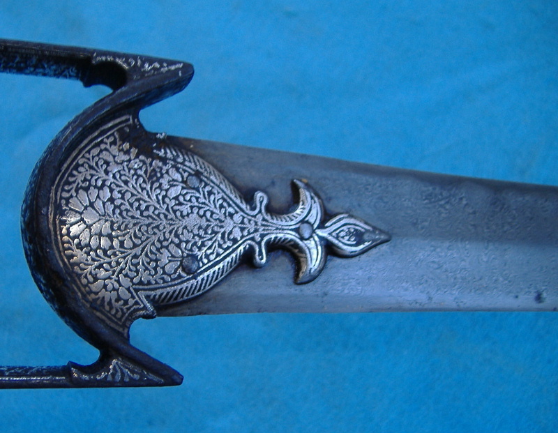

Not a terrible amount of work was involved in revealing more of the floral silver work.

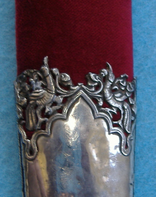

The scabbard was a different story....and was a lot of work to build up the areas of broken wood and recover it. I still need to let the velvet fade a little for a more natural appearance. A polish revealed gorgeous silver fittings. I especially like the heads up peacocks that line the top of the chape.
I believe this katar to be at least early 19th century and perhaps older. I am anxious to hear what others think about its age. The blade looks custom made for it and is not a blade from a broken sword or a foreign blade.
Sorry I didn't take a "before" pic, but believe me, this is an improvement over its original look!

Hi Charles,
A quick answer, before I shoot out for the evening.....
Nice piece - my gut tells me 18thC. The quality and amount of silver work applied to the hilt, is what I'm going by.
The size and proportions seem to reflect early katars found in the South of India - in fact there is where I would place it - possibly the Deccan plateau.
If I have time later I will have a look through some books and try give you info on the floral patters. But they look distinctly Moghul, and the silver peacocks look Southern/Deccani.
So I suppose that's my synopsis - 18th (late 17th?) from the Deccan Plateau.

Best South Indian katar I've seen.
Question: Never seen a South Indian katar with wootz. Is this common or unusual?

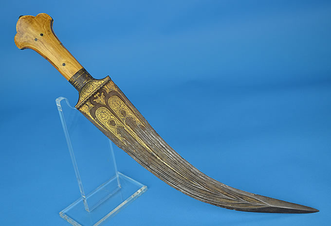

I'm not sure what your question is, but my email was me thinking out loud, so let me say clearly where I think it is from. I see influences from early South Indian Katars (Tanjore principally), but I think this has more Islamic influence, and therefore I would place it coming from the Deccan.
I think the Deccan makers were good at fusing North and South together. I think the dagger I picture below is again from the Deccan, but takes the tiger tooth hilt from the North, and the blade from the South.
Runjeet

Excuse me if this is a ridiculous question, but could the hilt be Bidriware? It seems an obvious material for a decorated hilt but I can't say I've seen many, or even any; perhaps it is too brittle.
I would be interested in opinions.

Runjeet, my point was, that some use the term South India for everything south of Rajasthan - and I find that wrong.
I agree with you that it is Deccani, and to say 18th century might also be right.
Your Tiger Tooth is interesting, as I think it could be from South India, and not from Deccan, due to the decoration on the blade.
Does the decoration not show two peacocks, maybe not easily seen if you don't know what to look for, with their tails meeting in the middle of the blade to form the cypress/tree of life?

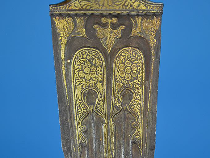

I also agree about the generalisation of the term South India - there is obviously a geographical and technical answer to what is South India, but historically I would certainly consider the language spoken and the race of people (ie. Dravidian).
I think you are right about the Tiger Tooth - I'm sure you noticed it shares the same blade style found on South Indian hooded Katars- but I have to admit you have lost me a little on the peacocks - I have attached a close up for you to examine and if possible mark where you see them.
Kind Regards,
Runjeet
Runjeet Singh is offline   Reply With Quote
Old 8th October 2013, 03:33 PM   #11
Jens Nordlunde
Jens Nordlunde's Avatar
Location: Europe
Posts: 2,718
Runjeet, I think it is a pity to change the discussion on Charles' thread, so I will make it short.
The decoration on the blade, is not ment for the on being stapped to admire, but for the one holding the dagger. You will have to turn the decoration 180 degrees. If I am right the decoration on you dagger is very stylized. The peacocks turn their back towards the edge, and their heads towards the middle of the blade.

Now that we are back on the katar, I'll ask again:
Is wootz common for this type of katar or unusual?
I have not seen any South Indian (or similar katars) with wootz.
Old 9th October 2013, 01:26 PM   #15
Jens Nordlunde
Location: Europe
Posts: 2,718
Sorry, you should have had an answer earlier, but I suppose others could have stepped in and answered your question.
Different types of katars were used in south India, but I suppose you in this case mean katars, where the blade is riveted onto the hilt.
A lot of these blade were of European origin, and not made of wootz, but Indian blades were also used, and in this cases it is not unusual to see blades made of wootz.
