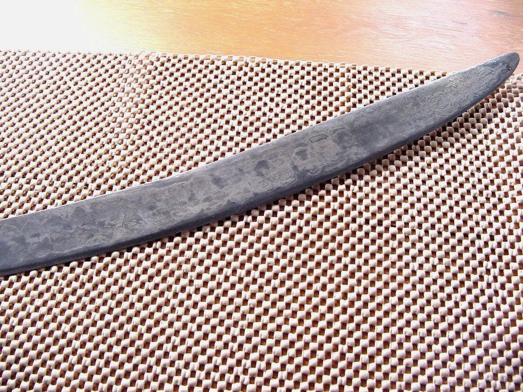

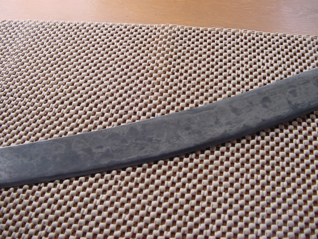

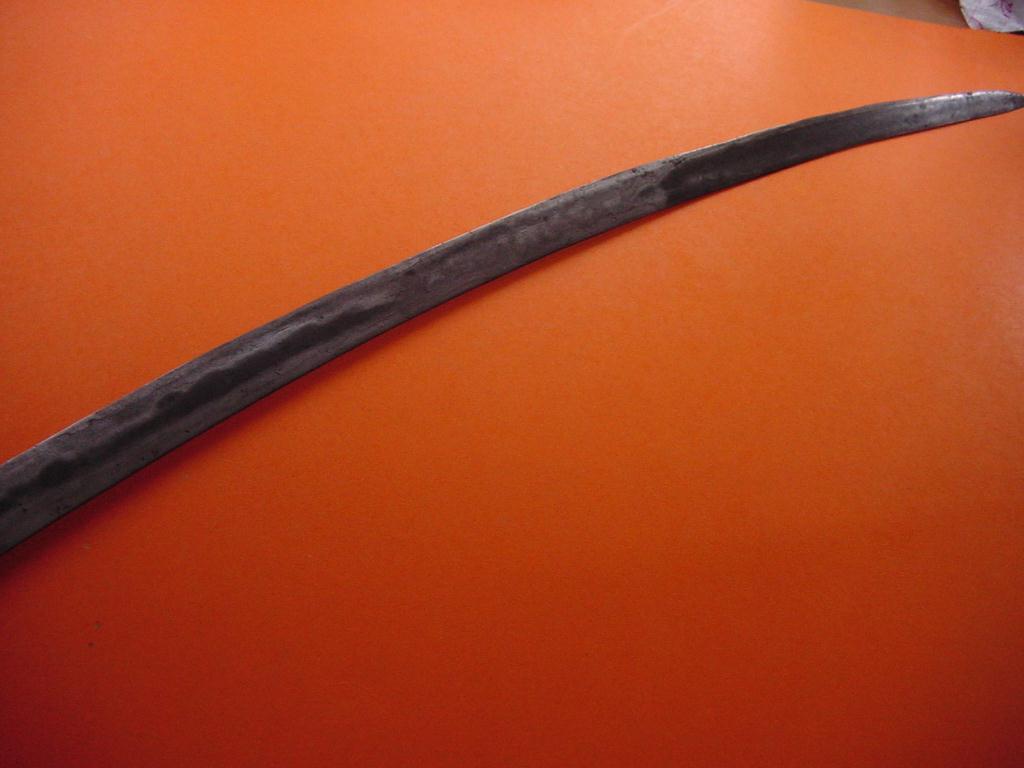

I'm etching this sword, but I am having some troubles. I followed all the instructions found here, and it works fine, I see the wootz pattern appear, and once I stop the etch, the blade just turns a dark grey color, and the pattern would disappear. I tried polishing the blade with a cloth and oiling it and cleaning this black residue that had built up on the blade, but still no luck getting the wootz pattern to appear again. Can some one tell me where I am going wrong?

1st I lightly sanded the blade by oiling it and rubbing it with a Scotch pad (green scab pads) then cleaned up the oil, and used another piece of pad with soapy water and cleaned the oil while sanding the blade more. once done I washed the blade with hot water to rinse and dried it off, by this time the blade was nice and smooth but it did show some pit marks. I tested with a weaker solution first slowly adding more acid until I could see the solution is getting the desired affect. By this time the blade was starting to darken up and the pattern was showing, all this time I kept the blade evenly wet with the solution. To stop the etching I used Windex for the ammonia, and then washed off with water immediately. I could see some yellowish orange color appear after the rinse so once I dried it I sprayed the blade with WD40. I wiped with paper towel to remove the gunk, and also used a nylon brush to clean up the gunk. I used a CLP to oil the blade and an old sock to polish, still going at it and still nothing.

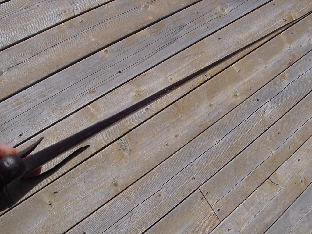

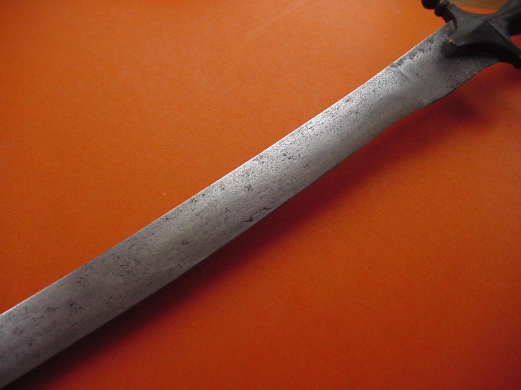

Hi, This sword had not been etched previously and showed no pattern. A phosphoric etch showed promise, but on cleaning nearly all contrast faded away. If your etch is too concentrate you get that blacked scorched effect.
I found on such low contrast I had too go with that and polish lightly with Brillo
pads both regular and non scratch followed by Maas a polishing compound and lightly stop at desired effect. currently still working on this one to even it all out. Keep going but watch out to avoid excessive pitting. Steve

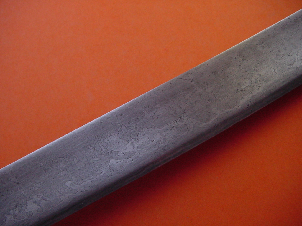

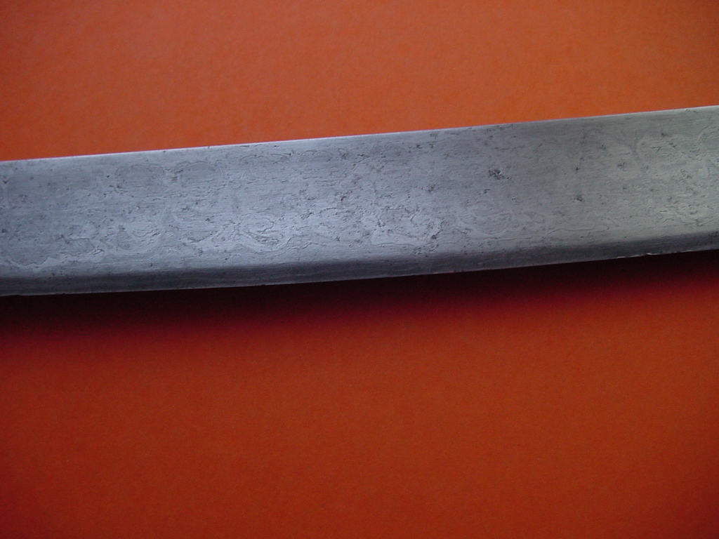

Hi, A second etching victim this one is again low contrast. Etching produced the blackish areas probably where this extremely thin blade was tempered for strength. This is second or third etch per each side. At first it came out very crystalline looking. I cheated and besides the polishing compound used the well worn 1500 and 2500 sand paper used initially to polish the rusty blade. Go slow without to much pressure. You might give us some photos, good luck. Steve
Any future etching will be with a more diluted etch.
