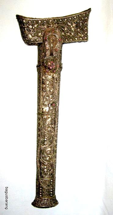

saw this in one of the auction sites (auction completed).
So beautiful.Mykeris

Hello Mykeris,
This style of fancily decorated silver sheath or pendok is a recent fashion, and it is applied to both Bugis and balinese style krisses.... Don't regret it, you can easily find similar pieces on the market if you wish so.

Frankly, the work on this first example that MyKeris posted looks like a hot mess. The workmanship is really poor on this piece, no where near the quality of this older example that Jean has just posted. It is also far too much in regards to style. I much prefer the understated and more elegant effect of this last example.

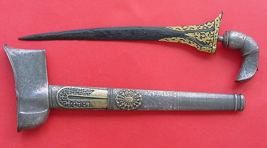

I have attached photos of two pieces with toli-toli, One is of a more recent make and one is quite old.
I believe we would be hasty to conclude that earlier toli-tolis are not either chased or embossed, but wire filigree. As always things are not always what they seem top be, especially when it comes to keris.

The first example is of a very recent make, I picked it up in 1998, and it was purchased in and shipped from Lombok. The second example with the kinatah emas blade is different in that is has some age to it, it is estimated to have been made early to mid-20th century. I purchased it privately from a Canadian collection.
The recent pieces seem to start showing up on the market in the late part of the last century, and just checking EBay and others, they are not hard to find in various qualities.
