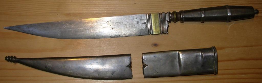

hello together
my newest knife is this beautiful piece. the handle and the sheath is made of solid silver, the age I guess between 1880/1900. it certainly can not be classified, but I think rather that it is Spanish. could it be French? I see similarities with the Corsican daggers.
who has a different idea, please report.
Yours sincerely
Chregu

Gavin Nugent
Gavin Nugent's Avatar
Posts: 2,818
I too think Spanish, perhaps Gaucho....There seem to be both Brazil and Argentia design aspects at face value....I am impressed, this is a nice example, one I would be proud to have in my South American Gaucho collection....as many have said before, if you ever get sick of it let me know!!!

chregu
chregu's Avatar
Join Date: Feb 2010
Location: switzerland
Posts: 299
Hello freebooter
had this knife for only five days, it did not even tired! smile.
what do you think about age, 1880-1900, or earlier?
if you're Gautcho collector, then you certainly like these knives too! Smile.
greeting Chregu

ingelred
Location: Moenchengladbach, Germany
Posts: 62
Hello Chregu,
in my opinion it is Brazilian.
When You compare the knife to some knives that are depicted in "El Gaucho y su Chuchillo" the brass inlay in the blade seems to be quite common fot Brazilian Gaucho knives.
Best regards, ingelred

Héctor
Join Date: Apr 2013
Location: Rio Grande do Sul - Brasil
Posts: 3
Olá a todos, Chregu a faca apresentada é com certeza brasileira, mas não é gaúcha. É procedente do estado de Minas Gerais, na parte central do Brasil. Seus traços tem uma grande influencia das facas oriundas da região mediterrânea, em especial a Espanha. Assim como muitas laminas que foram produzidas na região neste período. Quanto a idade da peça, baseado em outras laminas semelhantes desta região, suponho que tenha sido feita entre 1860 a 1890.
Google translate;
Hello everyone, Chregu the knife is presented with certainty Brazilian gaucho but is not. It is coming from the state of Minas Gerais, in the central part of Brazil. His features have a great influence knives originated in the Mediterranean region, in particular Spain. Like many blades that were produced in the region during this period. As the age of the piece, based on other similar blades in this region, I suppose it was made ​​between 1860 to 1890.
Héctor is offline   Reply With Quote

chregu
chregu's Avatar
Join Date: Feb 2010
Posts: 299
hello together
many thanks for your help.
it is now clear to me, I will not sell it because I do not have a knife from brazil! smile.
again many thanks to you all.
greeting Chregu

Gavin Nugent
Posts: 2,818
Hi Héctor,
Thank you for another informative post on South American knives.
You prove to be vey well versed on the subject and I personally look forward to more replies as these interesting knives surface.
Gavin
