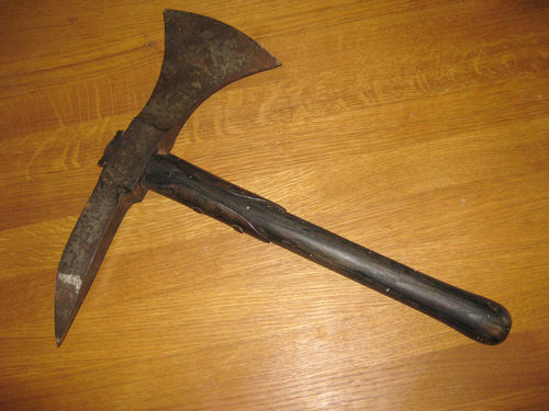

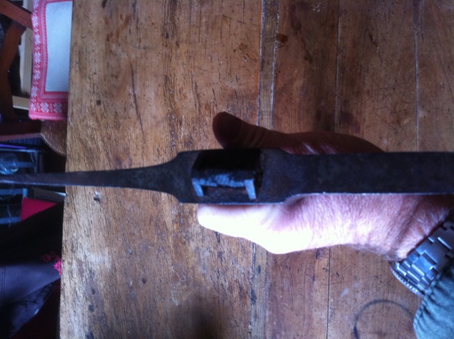

Gentlemen,
I thought this axe was definitely a French Boarding Axe but now I'm not so sure. Your opinions would be appreciated.
Thanks.
Old 12th February 2013, 05:22 PM   #2
M ELEY
Location: NC, U.S.A.
Posts: 2,220
Very Nice piece! Definitely French, based on the squared eye, forward/rear facing langets, bearded blade, etc. Again, this is a variation of the hache de borde, I'm assuming private purchase (no govt markings?). Haft has been radically shortened, as was typical for these as they were used well past their prime (essentially, the first ship fire axes WERE old boarding axes). The spike on this one is hefty and down-curved, allowing for use as both a pick, prying tool and gives it the distinct ability to drag away fallen lines. I'd say this one is the real deal. Where do you find your items, my friend?!! I need to start shopping there-

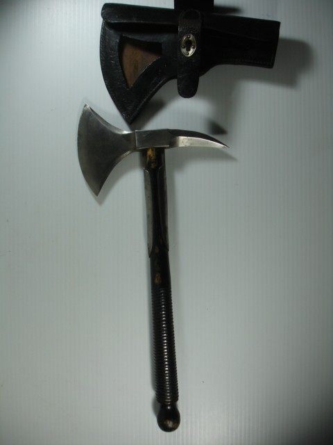

I have to say that it looks like an early 20th century central European fireman's axe to me, but these can be problematic to place as they are somewhat 'related' (Boarding/Fireman's/Sappers......)
http://www.vikingsword.com/vb/showthread.php?t=16469
Have a look at this completed eBay listing for an axe described as an Antique German fireman's axe:
http://www.ebay.co.uk/itm/ANTIQUE-GE...-/360523052060
If yours is a French Boarding axe then what sort of date, early 19thC?
It looks very clean and machined to me, that also makes me think 20thC.
Like I say though, these are problematic at best. And your axe is certainly very similar to some definately genuine French boarding axes of the first half 19thC that I've seen.
Don't suppose that there are any stamps or markings?

Thanks guys, always good to get your input. Mark, you are right about boarding axes - don't see one for months and then several come along. Although I'm beginning to wish I'd stuck to cutlasses!
The jury still out on this one as Atlantia has a very good point the lines are very well machined. There are no markings to give any further clues.

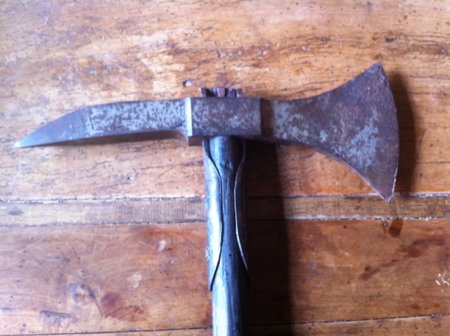

I wondered if the langets were significant as they extend through the head and butt against the top. I associate that with boarding axes and a web trawl does not reveal it as a common feature among fire axes - could be wrong of course!
Any thoughts?

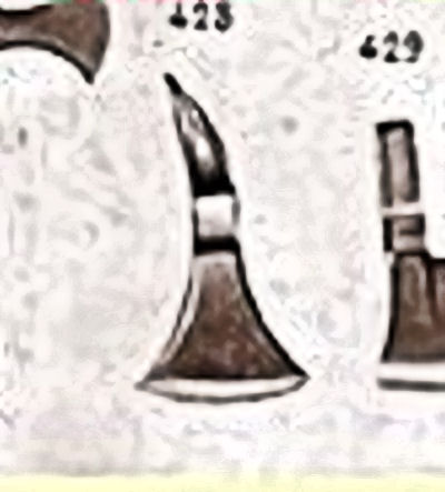

I remembered a good post by Billman a while back on the subject of french axes.
Note #428 in the picture below (Billman says 1920s onwards)
http://www.vikingsword.com/vb/showpo...96&postcount=5
Not exactly the same but it certainly shows the 'problem' with these axes.

My points exactly when it comes to these types of items. This is a tricky one and I just can't be sure one way or the other. The German fire ax is extremely close in design, but not an exact replica. The one displayed at the top of this thread appears to have more legitimate aging. Although the head is cast, this doesn't necessarily exclude it as a boarding tool. The spike is longer and four-sided. Frustrating to pin down for sure-
The pics by Billman are good, but need more clarification. Are we saying all of the ax headed pictured in that catalog are post-1920? In that case, the conclusion is that all earlier forms of axes were being reproduced into the 20th century and any collected pieces would have to be judged on an individual basis. After all, the catalog picture is showing us everything from shingling axes to tomahawks to hammer-pole axes, many of the patterns made in the earlier centuries...

Thanks gentlemen.
I think this axe remains in the 'not sure' locker for now.
Although Gilkerson covers the 'standard' Scandinavian, British, French and US patterns he also reminds us that merchant vessels and privateers had their own armouries and that even government warships could restock using the local blacksmiths of what ever port they were in if the need arose.
So I guess it's always going to be hard to decide on the ones that look the part, are the right age and not of the 'standard patterns' - keeps things interesting though.

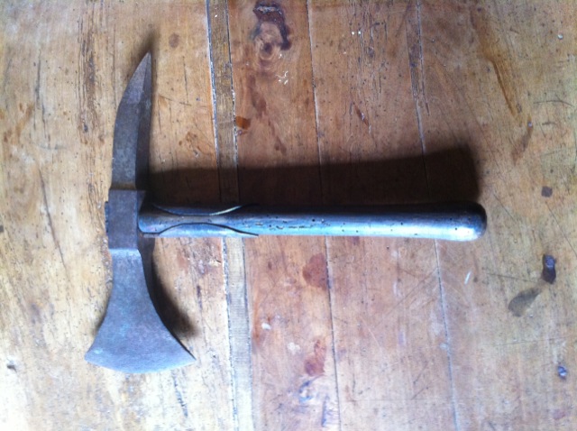

Intresting as it is identical to yours in all ways so we are clearly seeing a 'type' or pattern. The handle seems original as well. Also a very similar level of preservation and general condition.
Just finished on that well known site:
axe
So clearly some people DO see this exact type as boarding axes.
