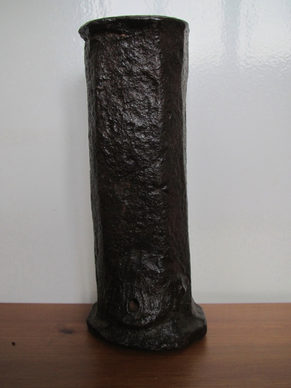

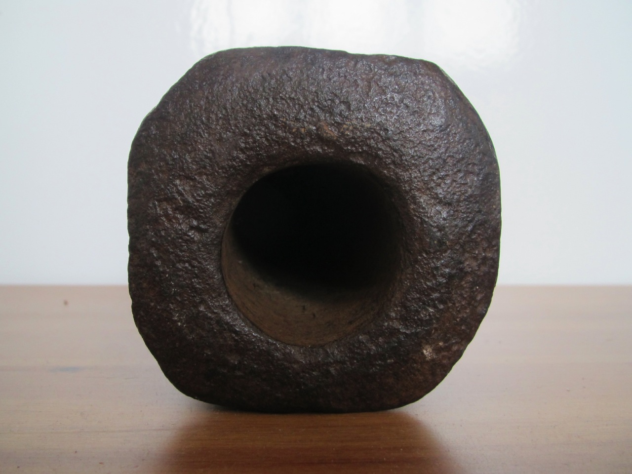

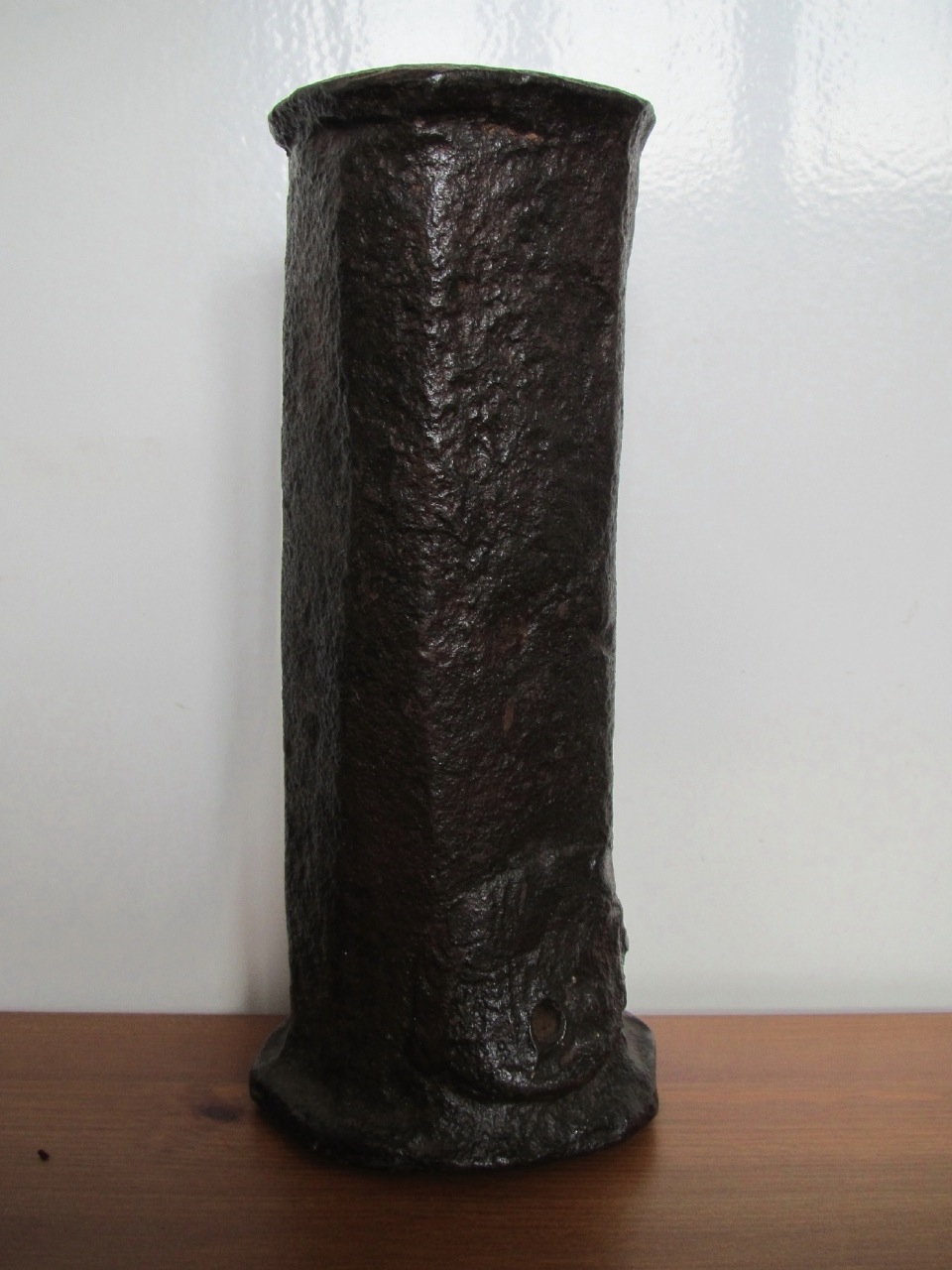

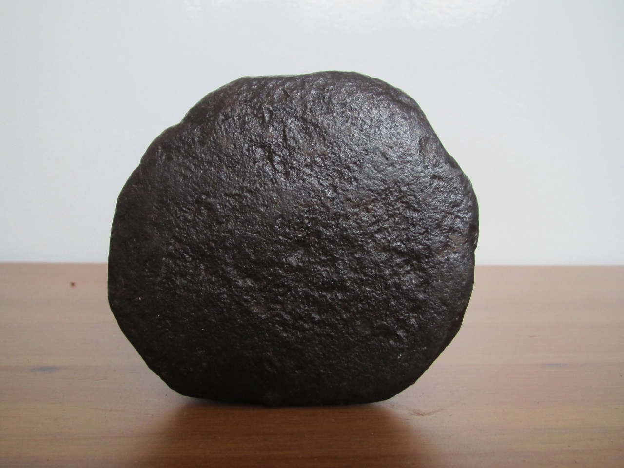

Hi Folks,
Is there any body who can help me to identify this iron cast barrel?
total lenght: 24,5 cm
largest diameter : 10,5 cm
mouth diameter : 9 cm
inner diameter of the mouth : 4 cm
weight: 7,4 kg
Very great patina
Is this a early late 14 th/15 th handgonne or a signaling mortar used by boats and harbors to signal each other. They would shot a different color signal depending on what they wanted to say
I read a thread depicting such barrels and Mathlock's collection but I am not sure at all.
Is it a valuable and rare piece?
Thanks a lot

Hi Alain,
A pity Matchlock will be absent for a while.
Your piece is very interesting; its dimendions are similar to my example posted HERE
While mine was considered a hand cannon and not a signal mortar, having to do with particular details for which Matchlock (for one) is a better judge,
i wouldn't advance on what yours is. The caliber and barrel thickness would suggest a cannon but the basis and touch hole with that slight lip (a repair?) suggest a (standing up) mortar.
I would agree is an old and very nice piece in any case. Naturaly cannons (handgonnes) are more rare, being much earlier than mortars; also the value depends on that.
I hope this helps and that i am not talking nonsense.

Hi there,
Sorry for noticing that remarkable barrel only tonight; I had to stay in hospitals from Sept. 2012 through late April 2014.
This, in the author's opinion, is the barrel of
a High Gothic wrought-iron handgonne, ca. 1390-1400,
closely comparable to the specimen preserved in
The Michael Trömner Collection:
and re-attached down here:
http://www.vikingsword.com/vb/showth...0+wrought-iron
http://www.vikingsword.com/vb/showth...nd+cannon+1400
http://www.vikingsword.com/vb/showth...ht=barrel+1400
In its early working life, it may still have fired gun arrows:
For igniting irons and linstocks used to set off those guns, please see:
http://www.vikingsword.com/vb/showthread.php?t=10029
Obviously, the rear end got of your barrel heavily swamped secondarily, for using it as a noise maker standing upright, or a door stopper - in the end.
The latter can still be found in alpine regions like Austria and Tyrol;
it happened to most of those 600 year-old earliest wrought-iron barrels.
In the aspects of historic weaponry, they are only important, and valuable, when preserved in unaltered original shape.
The bottom attachment depicts the so-called Bern gun, retaining its original stock; the hook is is a working-life addition of ca. 1430-40; preserved in the Historisches Museum Bern, Switzerland.
Michael Trömner
All photos copyrighted by the author, except that of the Bern gun, which is copyrighted by the Historisches Museum Bern.
