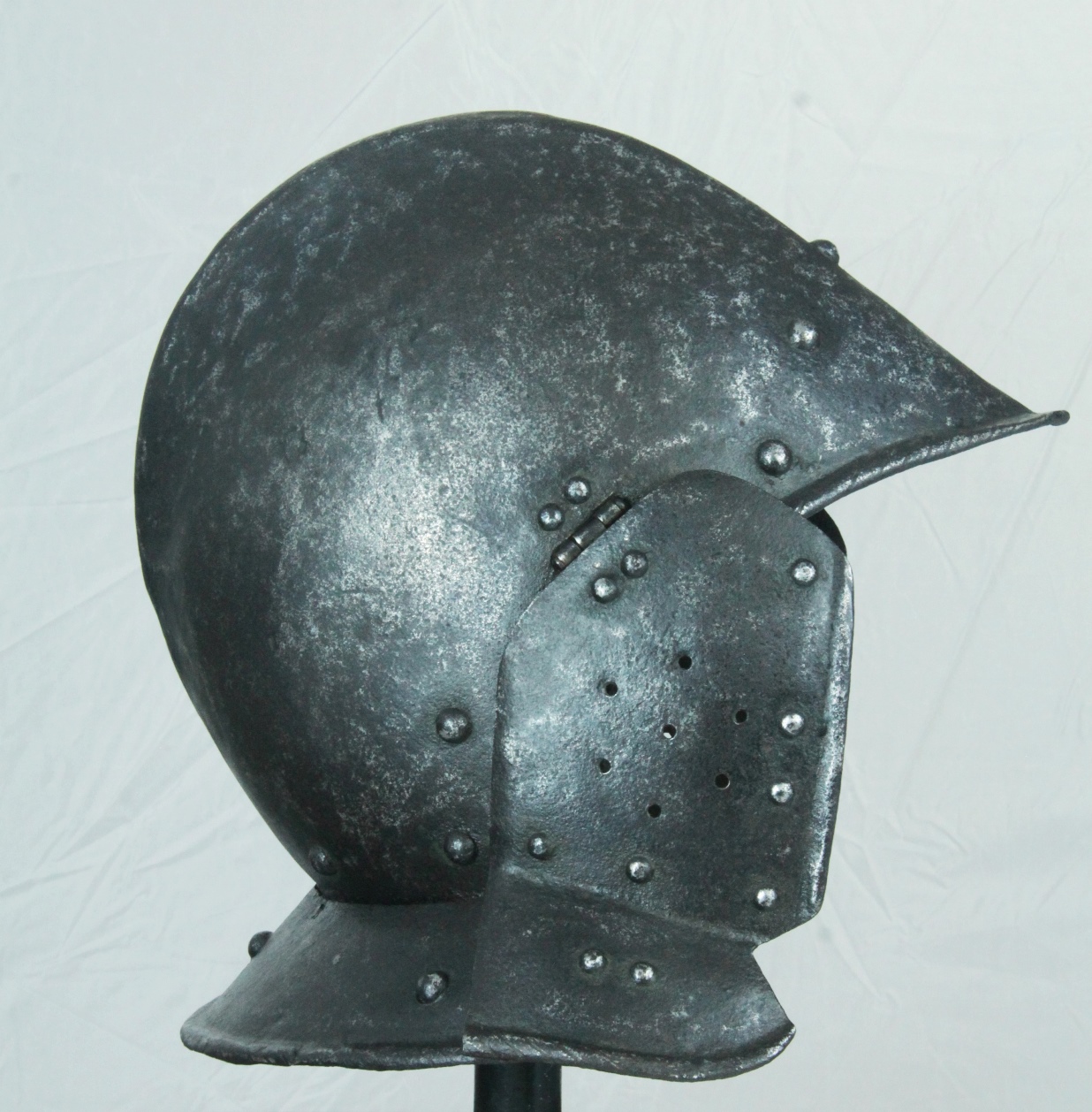

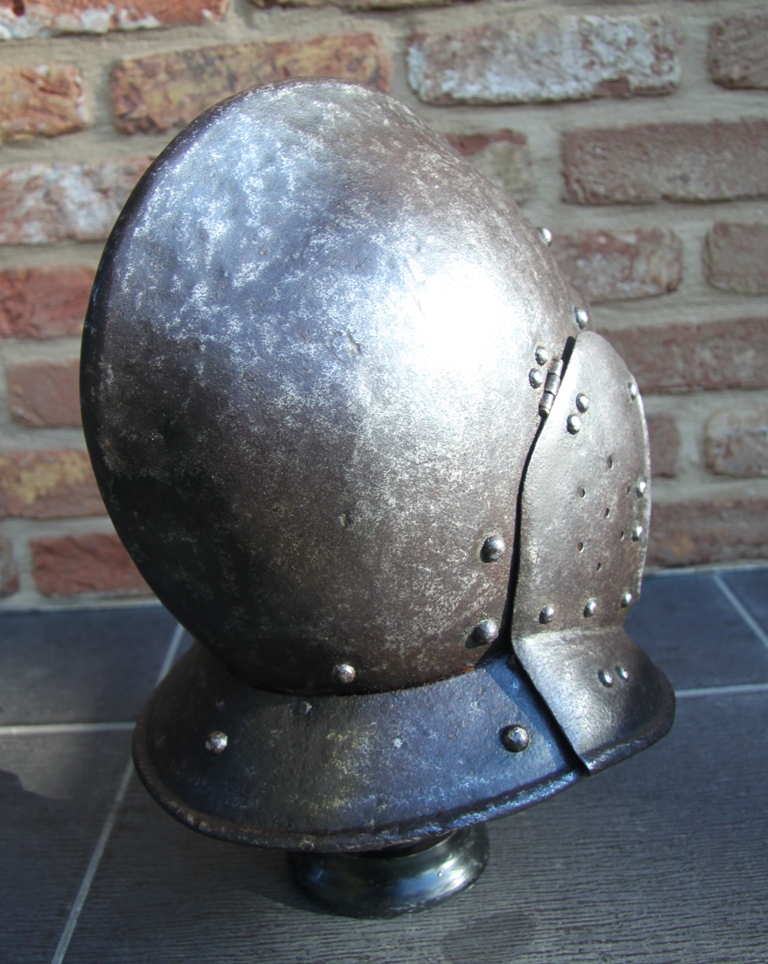

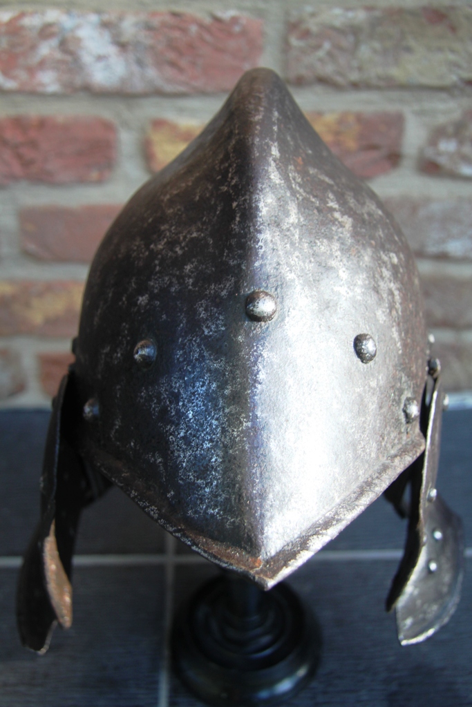

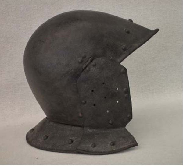

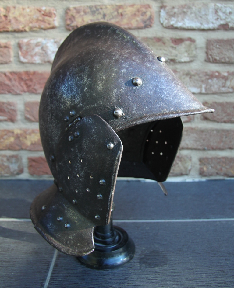

Hi everybody this is my last buying and I would like to know more about this helmet ,I have seen a lot of burgonet pictures but I could not find similar exemplar in order to determinate origin and period .
I hope that I could find in this forum those information’s.
Any comment on it will be welcome
Cerjak

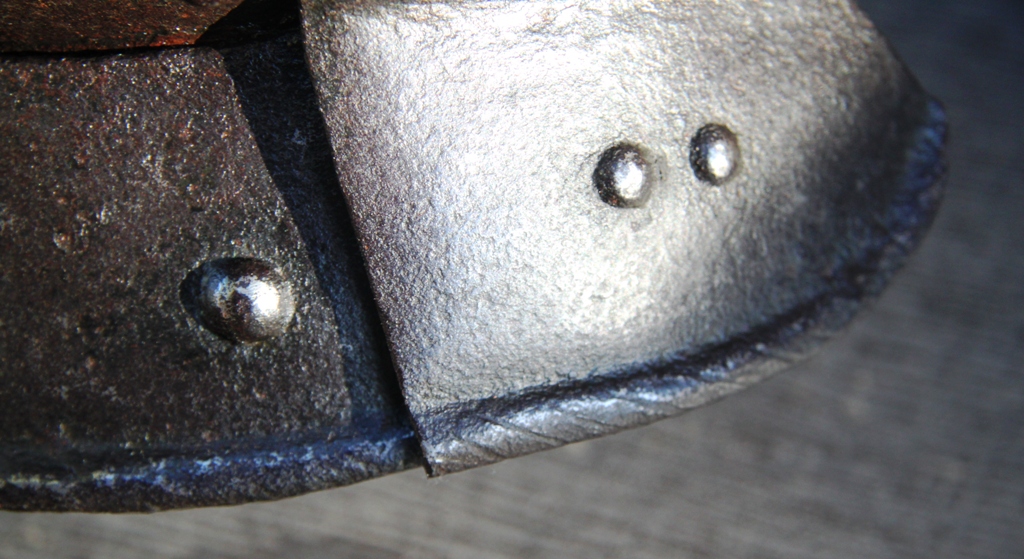

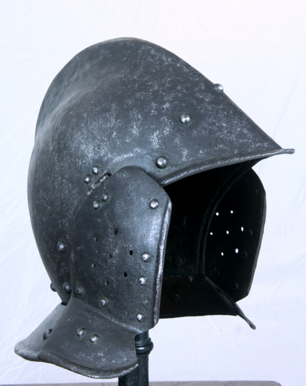

Default more photos
mores photos

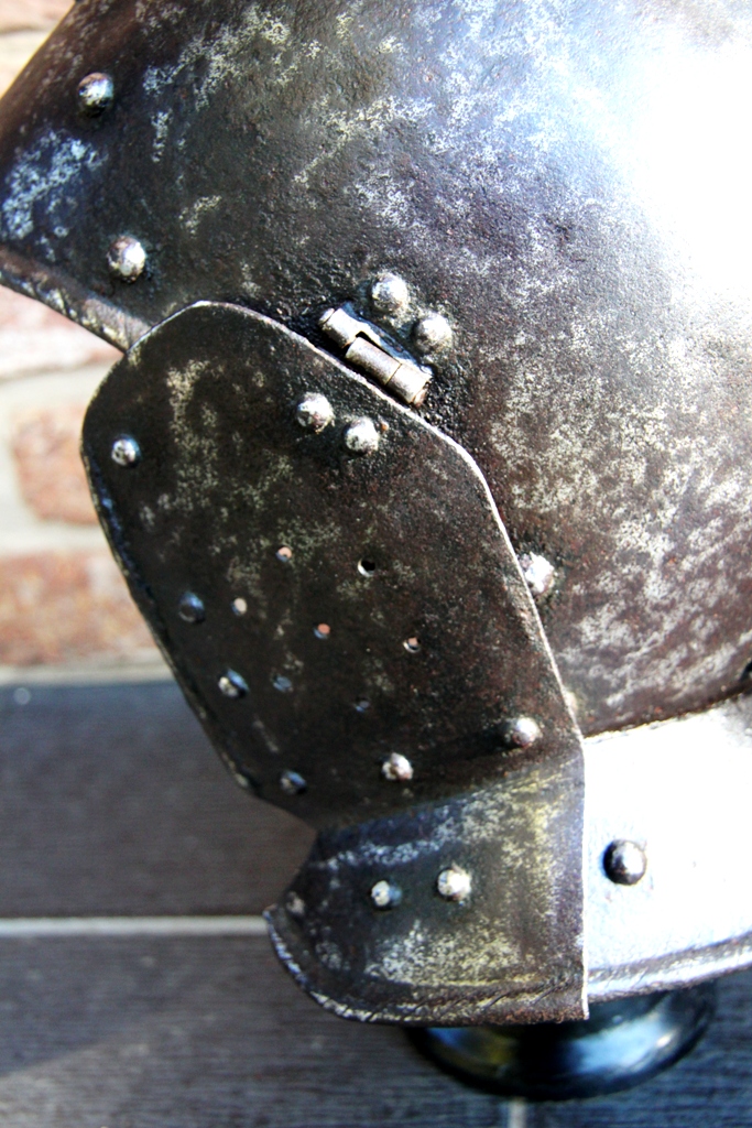

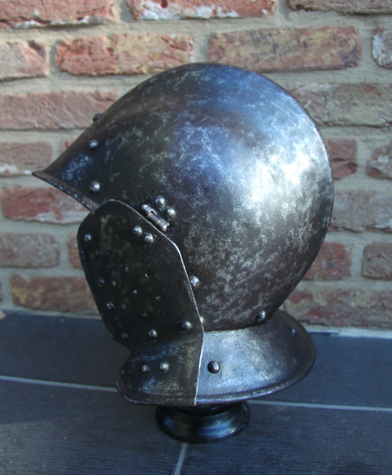

Default more pics
more pics

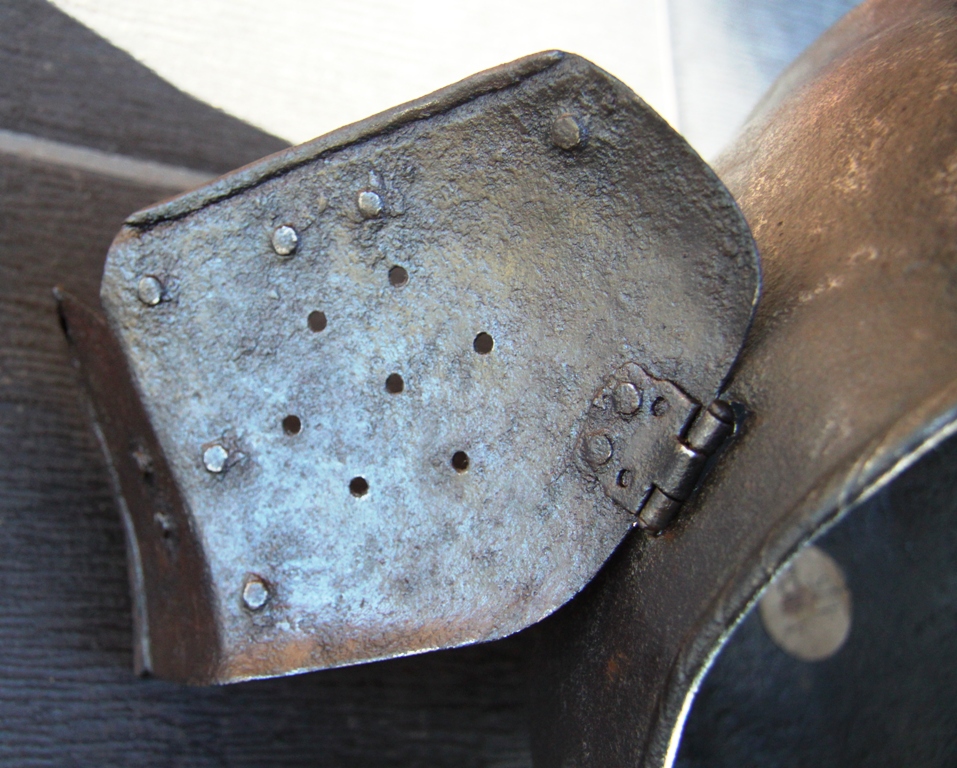

I would be interested in folks opinions on this as well. I have one of nearly identicle form, missing its cheek plates and with lots of rust. I've seen a number of this style on ebay over the last ten years ( there was one on just last month ) which has made me hesitant on dating/authenticating ( I paid next to nothing for mine so no tears if its not legit ). There is one of this style in Europäische Helme identified as being Flemish. Mine does not have as pronounced a crest/comb as this but otherwise is identicle. The rivets which should carry the leather lining band to which the helmet liner would be sewn just being flat piened, that is no cut washer to hold leather, simply piened flat to the inner surface of the metal has always given me pause as well. Looking forward to hearing folks thoughts.

Wonderful helmet 100% German .Nice to see a complete original piece

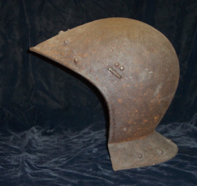

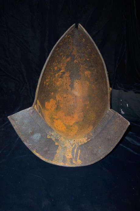

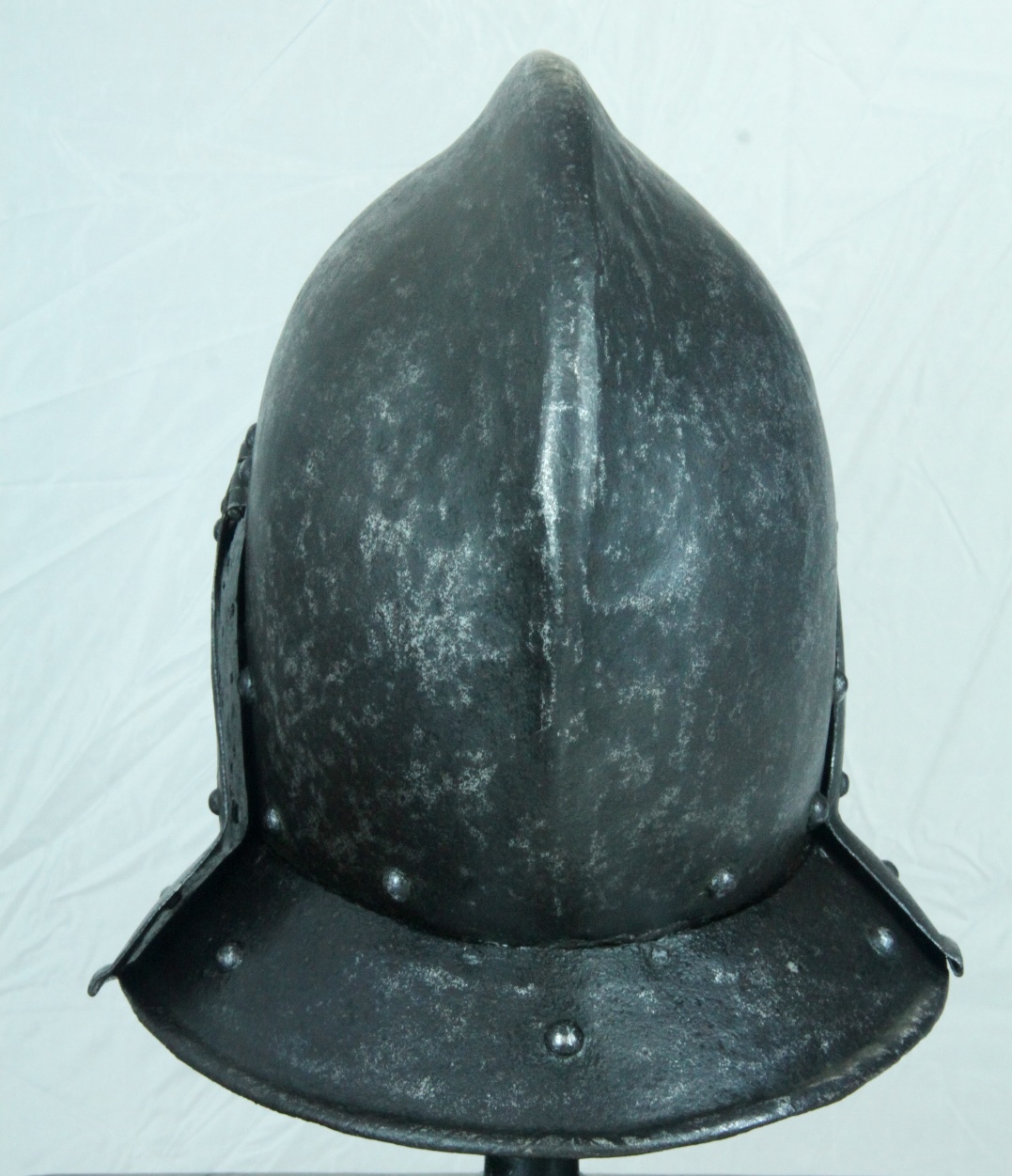

Thread resurrection. This is the one I have, mentioned earlier in the thread. Due to the uncertainty of authenticity mentioned above i've never done anything with it beyond oiling. Said oiling has never made that odd orange rust patch ( looks like active rust ) go away, its always remained brighter in color but the metal is in the same condition as the darker " in active " rust. There is roping faintly visible along sections of the rolled and counter sunk borders. As mentioned earlier and visible in the profile picture there is nowhere near as pronounced a comb, in fact I would call what my helmet has more of a medial ridge.

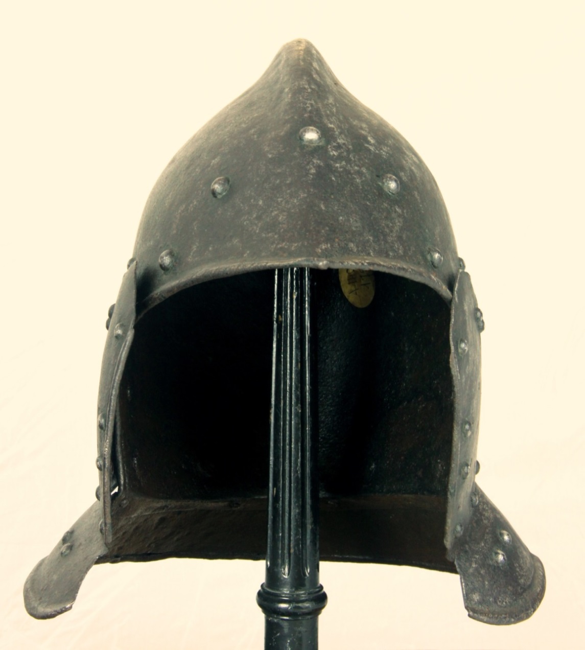

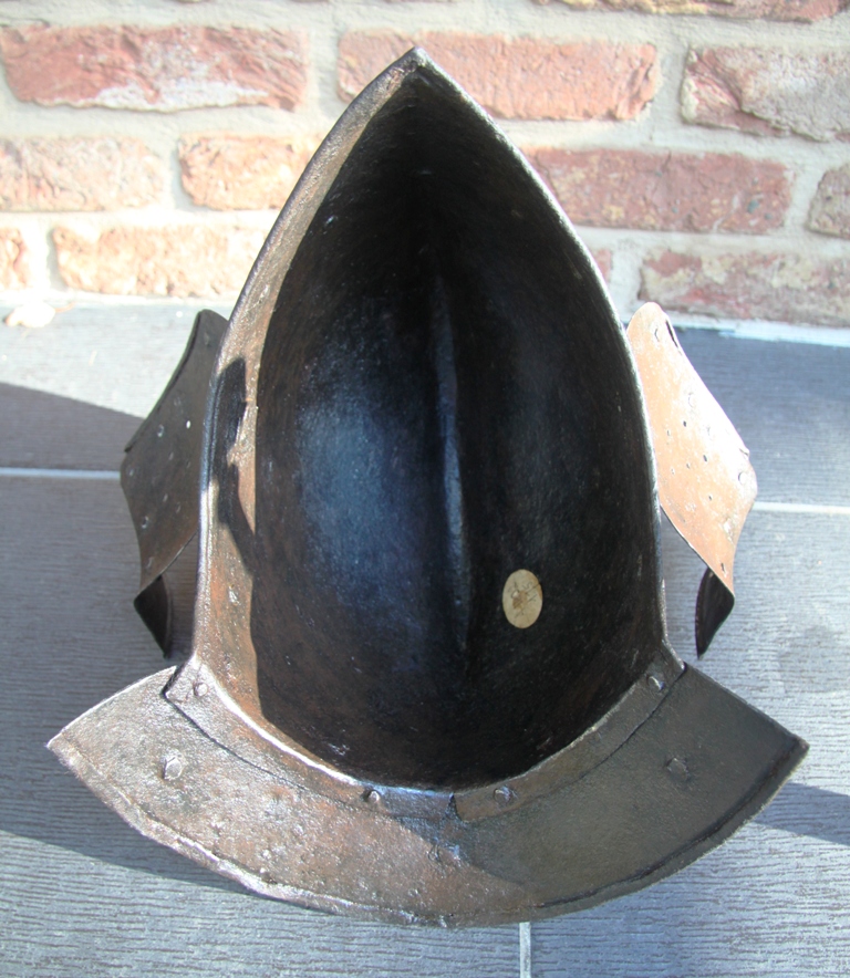

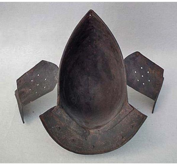

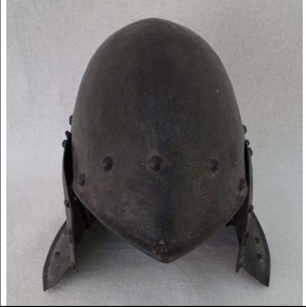

I Found some pictures from a very similar examplar said to be 16th century European Burgonet helmet circa 1550-1600
It is realy amazing for me to think that this two helmets had been in the same place few centuries ago...

Jean, excellent pics. I wondered how similar the missing cheek plates mine were to the ones your had, Maybe if I get a little free time ( free time whats that, who am I kidding ) i'll try making up a set of replacement cheek plates based on these pics to rest with the helmet ( just to sit beside it. It retains half the original hinges and I would not think of removing those ).

If you need better pictures from the cheek plates let me know it will be for me a pleasure to send it to you

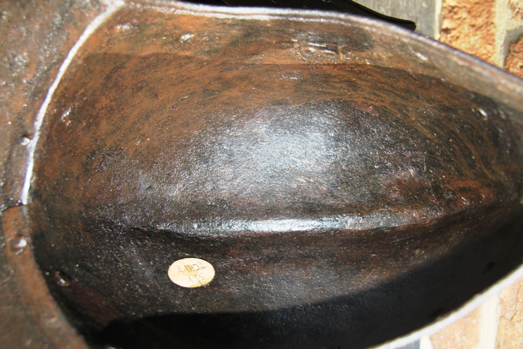

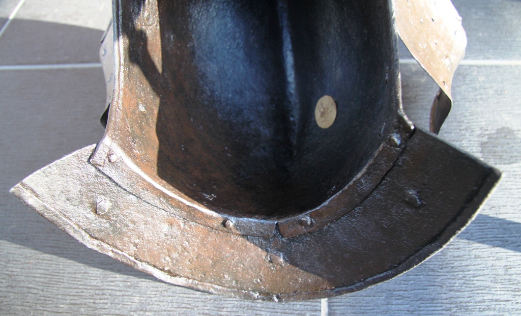

additional pictures
